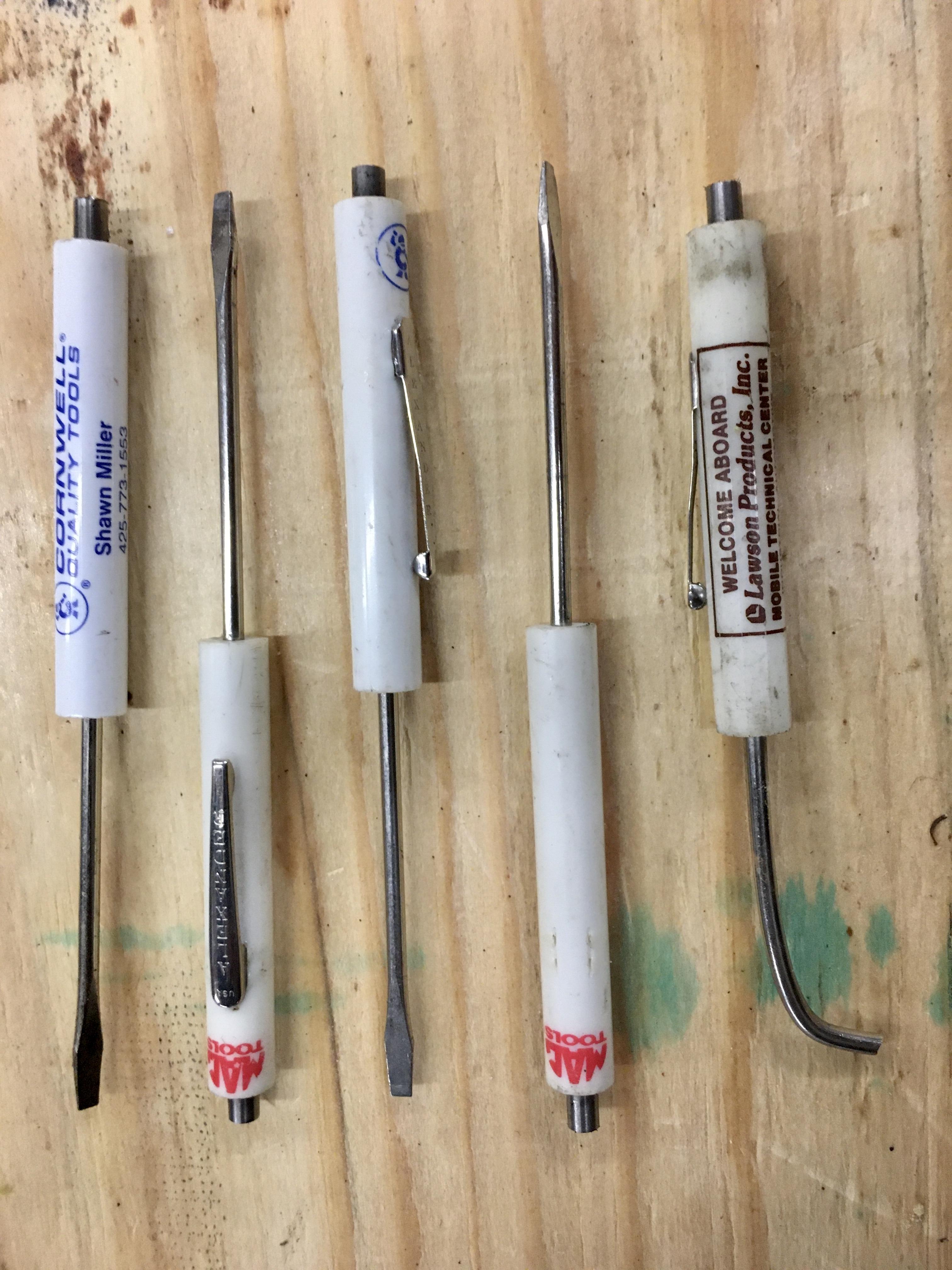

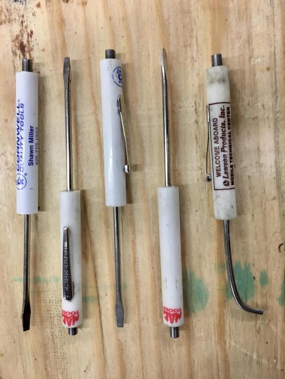

I use a small flat tip screwdriver, like all the tool guys give away.
Like one of these:

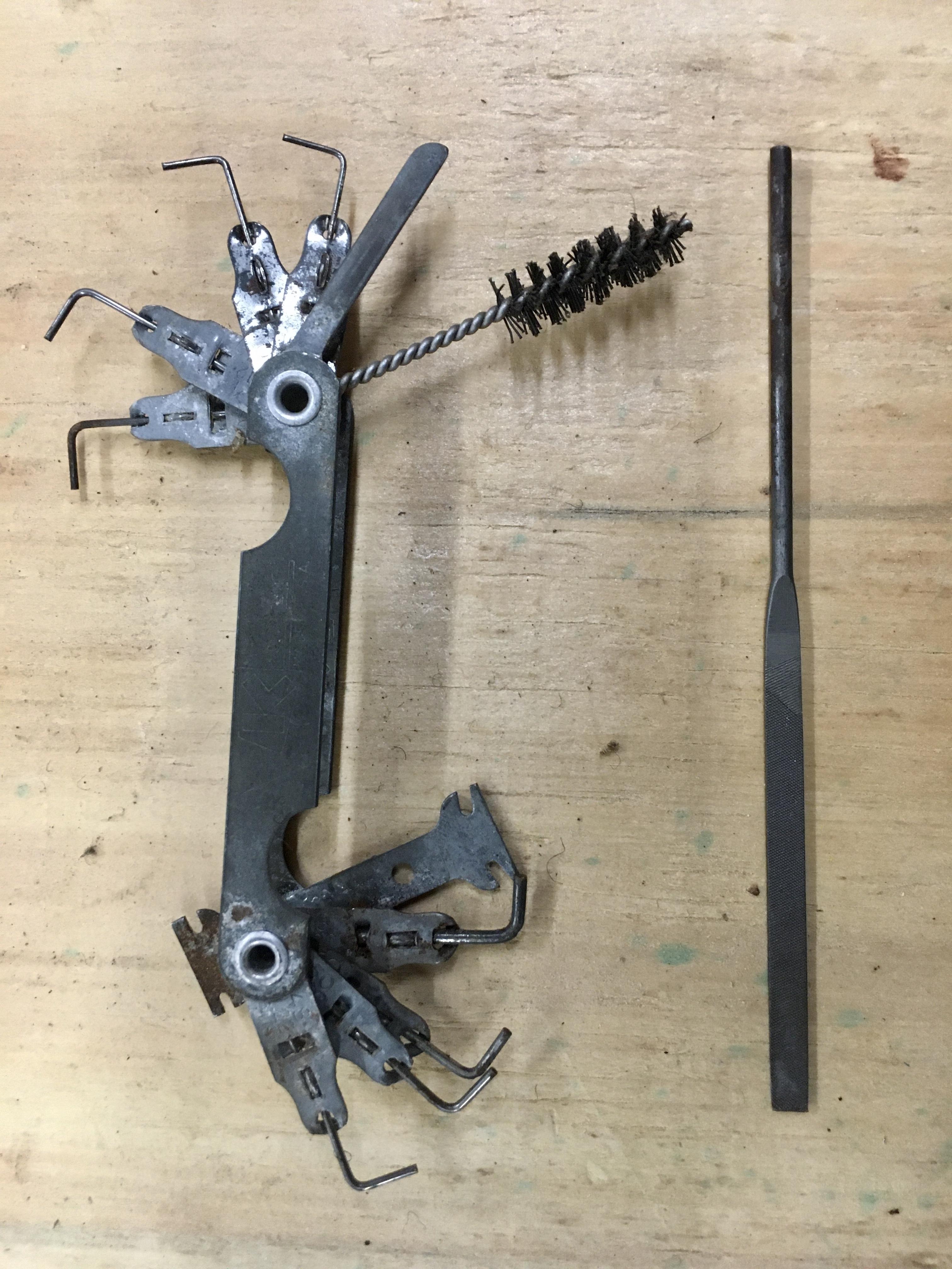

The file is a point file, fine double cut, parallel faces. Points only need filing if they get burnt and eroded, and only as a stopgap until a new set can be installed. Never file new points. Also use a clean tool when setting the gap, any oily residue will ruin them.
The other tool can be used to set plug and point gaps, the wire brush for cleaning the wire sockets in the distributor cap and coil center post.

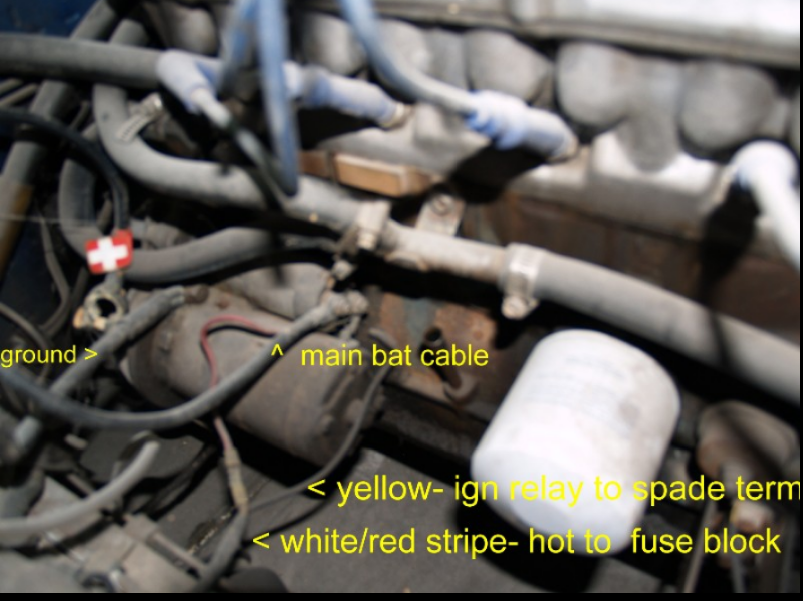

ROUTE OF WIRE..
attached is the rout of the power wire.. as shown in red it goes from the starter motor red wire.. and goes straight to the ballast. ( the yellow wire on ballast )... is that correct ??  or is it missing something that is causing no spark??  or does it need to go to any igniter or anything before going straight to the ballast??
or is it correct??

ROUTE OF WIRE..
or is it correct??

Not sure what  that means.. the negative to the battery was from the wire harness i believe..should we have another wire off the negative battery post to another ground??
the ground off the negative was there.. but possibly when we chopped out the two X out units of junk. we may have chopped that ground,,  if we chopped that ground, will it stop the engine from starting????gr.jpg

@Shawninvancouver, the battery negative cable should have two wires, a large diameter one (4 or 2 gage) that goes to one of the starter mounting bolts, and a smaller diameter wire (10 gage) that goes to a bolt on the firewall near the battery.
Grounding is very important, all grounds must be clean and tight. Given the amount of corrosion in the photos you have posted, it would be a good idea to go through every ground and clean them up, and ensure they are tight on reassembly (don’t overtighten and break off the fasteners).
When using your multi meter, use the alligator clip lead for the negative, connect it directly to the battery negative terminal (assuming the battery is connected correctly). using the sharp probe on the positive lead, push the point hard into the point you are testing for voltage. For simple continuity tests, use the pointed probes on both leads to contact testing points.

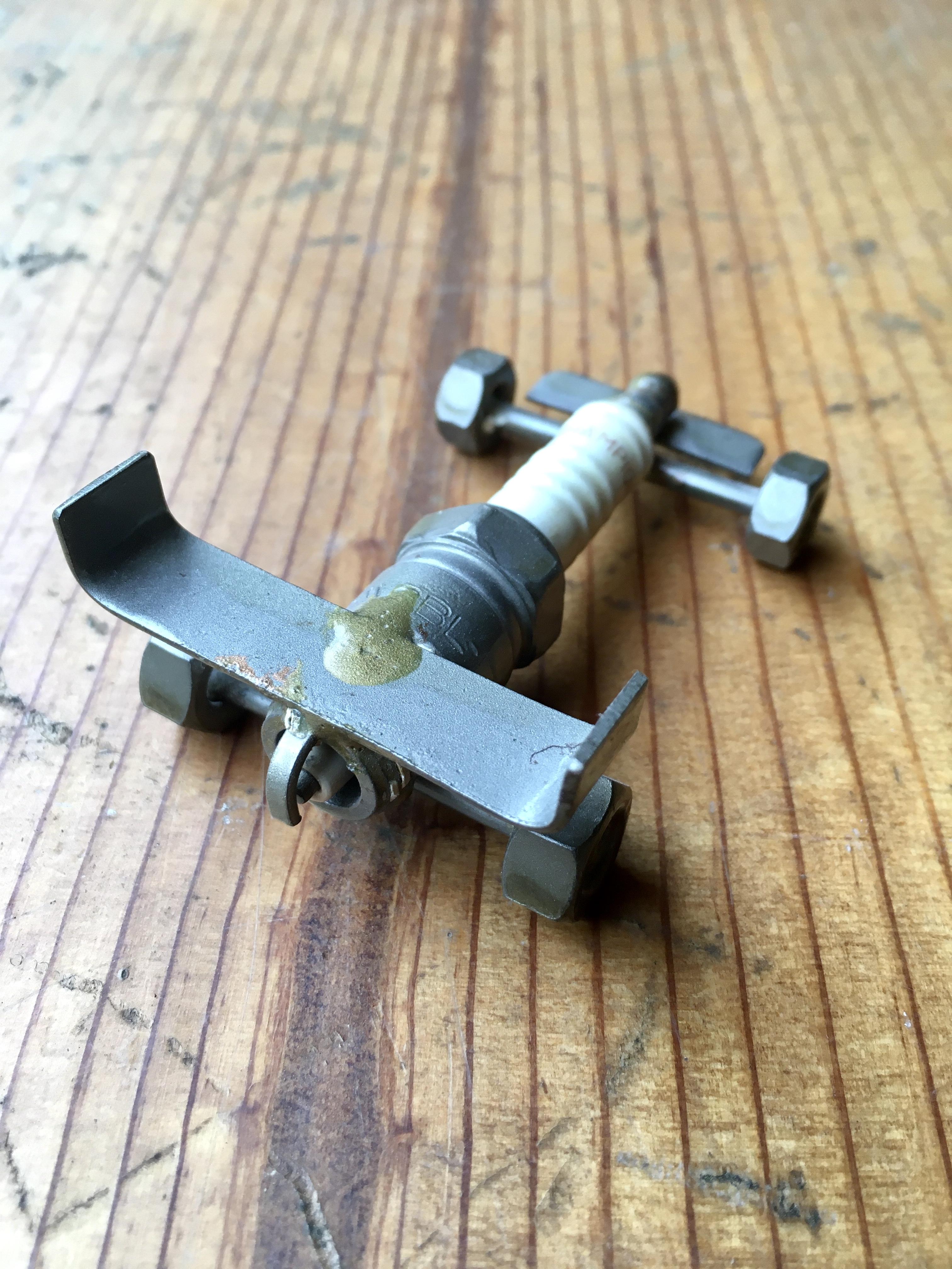

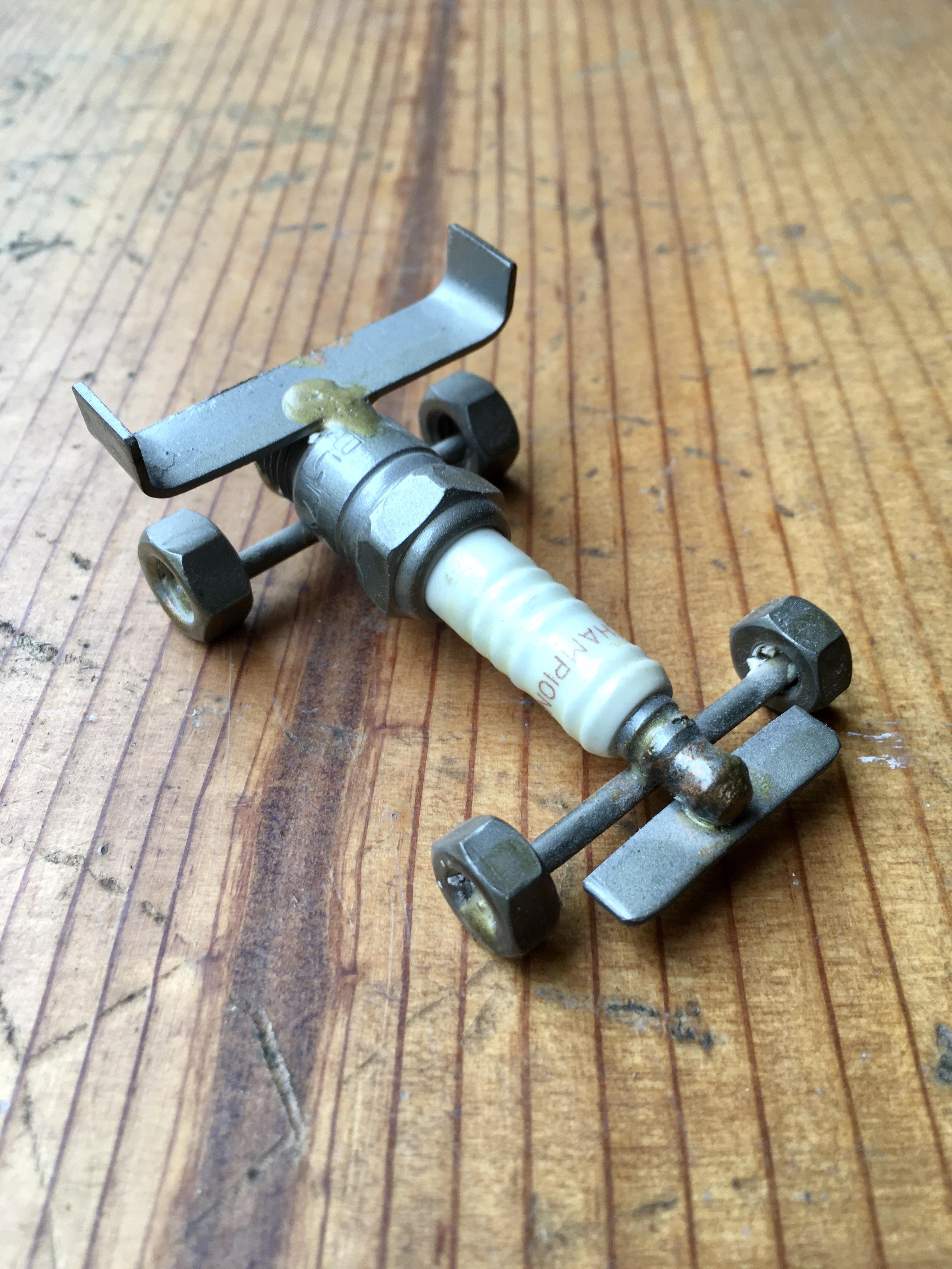

Full disclosure:
The spark plug I used for this one is a tapered seat plug that actually came out of a late 1970's or 1980's era Chevy 350. I replaced several hundred over the 30 years I worked on the fleet at a public electric utility. I made dozens of these things on my lunch breaks, gave all but this one away.
