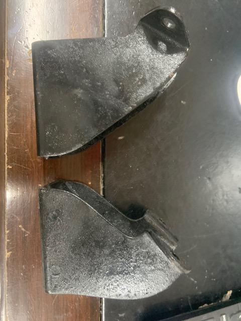

Cant believe i didnt label these.
any idea which is drivers side and which is passengers?

The Z engine is tilted to the right side (13 degrees I believe) so the longer bracket goes on the left, the shorter one on the right.
