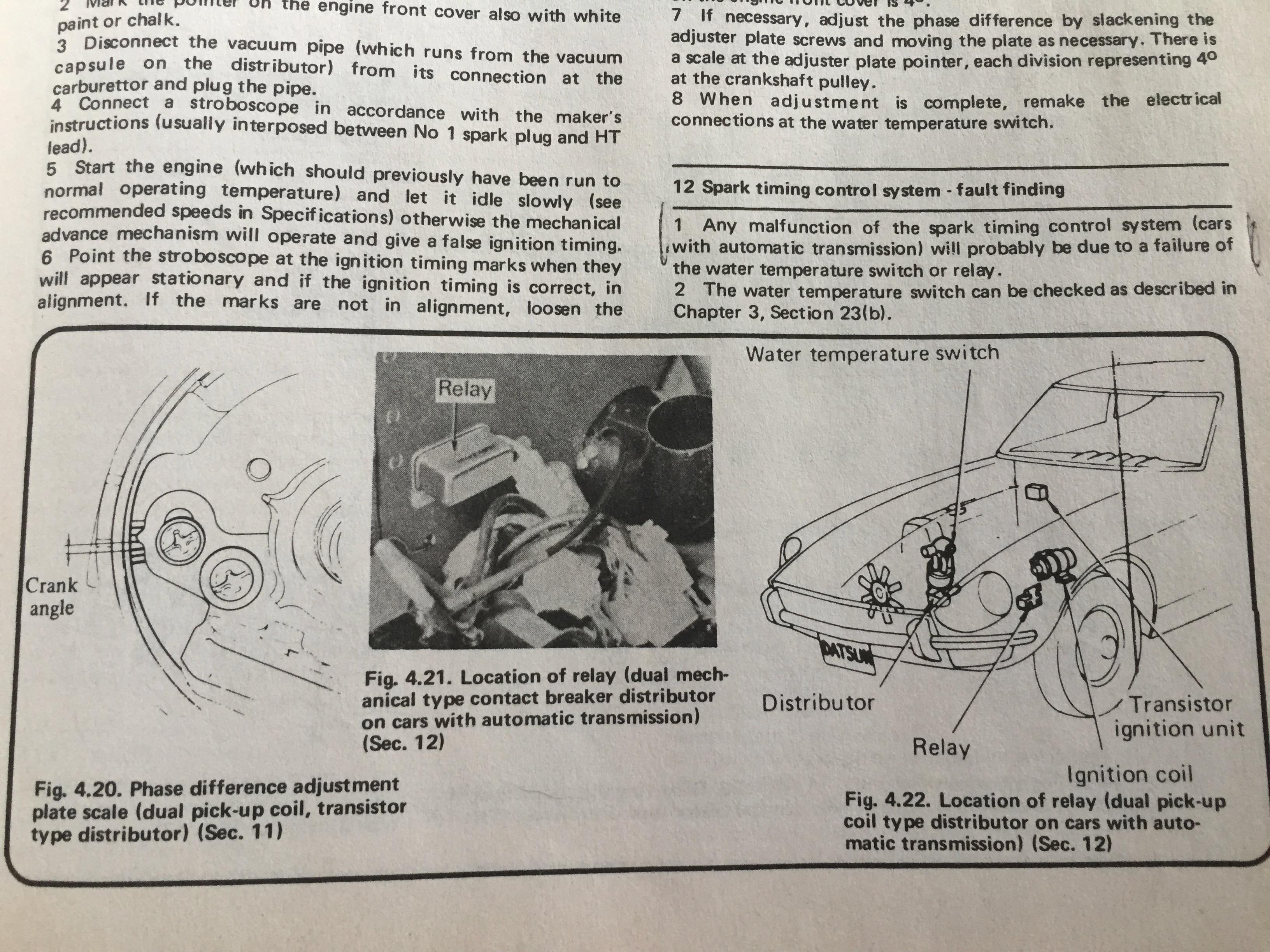

There is a single wire coming from my water temp switch and it looks pretty unhealthy and under tenstion. Wire goes up to the coil/ relay. (see diagram) It is suppossed to affect timing when car gets to operating temp. Its resistance changes with temp.
Sorry, I've never seem that system 🙂 what happens if you unplug that switch?
