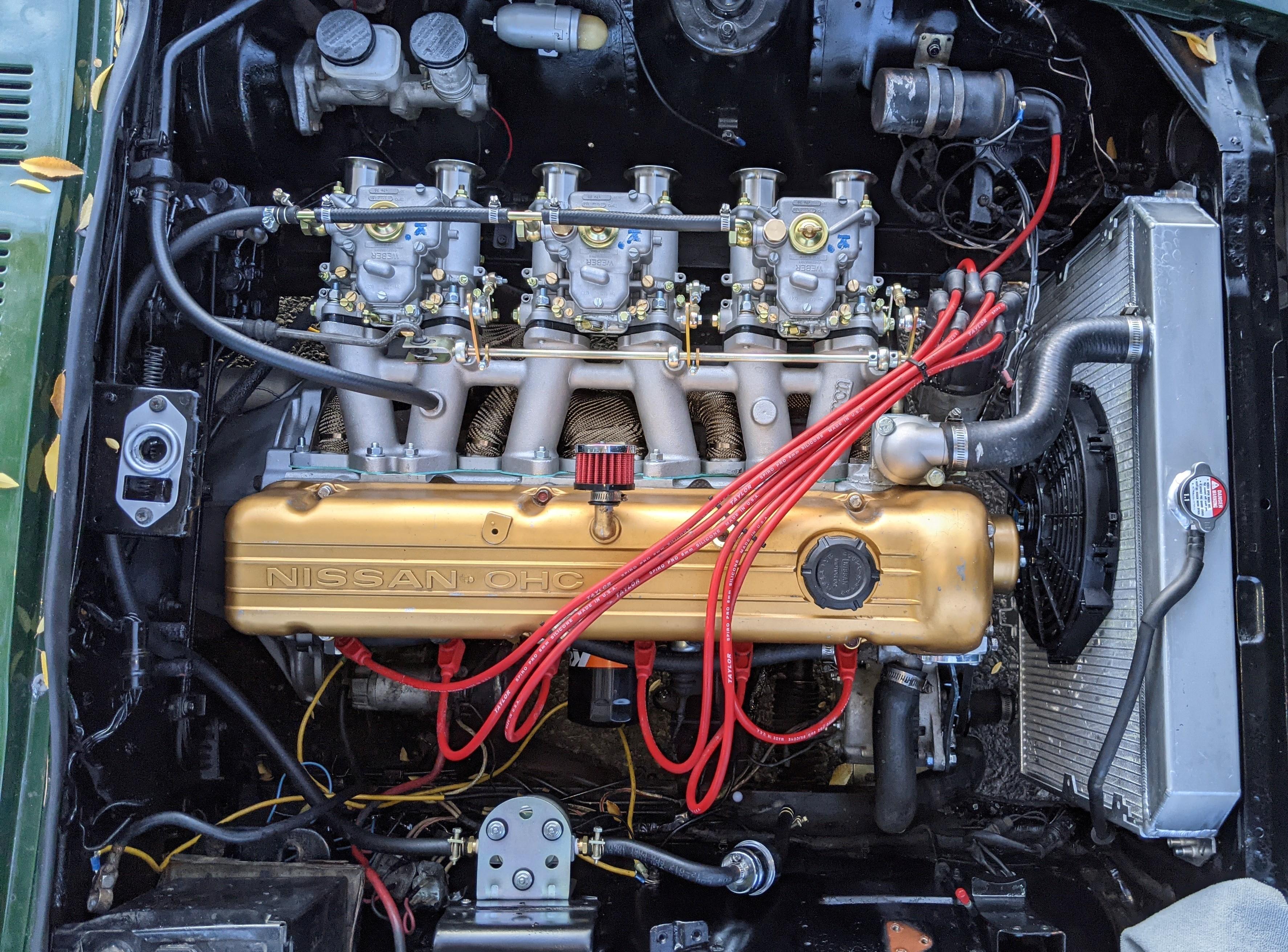

Hey guys, back with another question. Recently switched over to Triple Webers back in December. Loving the setup so far, still in the process of tuning them as they don't like open throttle in lower rpms. I am currently having an issue with starting the car after driving for a couple minutes. The car starts up pretty good for three carbs when cold, usually starts right up on the second crank. However she will not start after driving for a while and hot.
Example, I drove the car recently for about 20 minutes, pulled up to a gas station to fill up the tank which took approx 2 minutes to do, then I try an start my car right after and the car wont turn on, doesn't matter if I open the throttle a little or all the way open it just struggles to start. I had to sit and wait about 10 to 15 minutes to finally get the car to start again.
Is the gas evaporating in the webers and I just need to prime a little longer to refill? I currently do not have a heatshield in between my webers and headers but my headers are wrapped.
My first consideration is to make a heatshield for the webers and add heat reflective tape at the bottom of each weber also. Should this be enough or are there other things at play here?

Heat soak.  The proximity of the exhaust manifold causes the fuel to evaporate.  Add a heat shield and also change your fuel routing so that the fuel recirculates rather than dead-heads and you should notice an improvement.
I haven't had this issue with my unshielded triples over wrapped headers so I'd look elsewhere.
Are you able to mount an inline fuel pressure gauge to monitor pressure? Have you popped the inspection lids to check bowl fuel level with vernier calipers cold and hot?
If fuel never differs and is always good it's not the fuel.
To your comment about throttle at low RPM, would that be at 1,700-2,000? Say, every time you come around a corner in regular traffic?
If you open the throttle fully and crank, will it eventually start? Say after 5 seconds of cranking with the pedal all the way down. If you open the hood before the hot restart, do you notice fuel dripping from the air horns? This sounds like a flooding issue either due to fuel siphoning, too rich of a mixture, or both. If the car restarts with the throttle floored, then we can look deeper into why it might be flooding.

I have a custom heatshield in the works as we speak. I figured heat must have some part take with this issue. I have three friends with triples, none of them run a return line but they don't experience the heat soak issue I do. All three of them however have a heat shield and an msd ignition. This week I should be installing the custom heat shield and msd ignition.

I have seen people run no heat shield or even wrapped headers and still run their cars fine without issues. I can mount a fuel pressure gauge. I will order one sometime this week. I have not checked the fuel level. I am still pretty new to webers so still learning the ins and outs.
And its pretty much any rpm below 2500 but this issue was resolved after my friend put some new jets in and retuned the webers

It starts after about 15 to 20 seconds of cranking sometimes. Other times no luck. Doesn't matter if my foot is fully to the floor or not, it struggles to start. I have not noticed fuel dripping but I did in the past when I first got my weber

You should first check your fuel level. This is best done by removing one of the main jet stacks and measuring from the shelf down to the fuel. It should be no less than 25mm. When you do that, also record your main jet/etube/air jet as well as idle jet. What's your displacement and cam?
My Z has no heat shield and no header wrap of any kind, I have no issues with hot starts although I typically crack the pedal a bit. This is typical of a carburetted car.
Popping out the floats and measuring their distance to contact with the needle is a good measure too.

Next time I get to driving the car I will leave the throttle open for 10 seconds flat and test the results of that again. If anything I think the fuel level is fine because the car starts right back up when cold without me even priming the the fuel pump. I will check however when I get to drive the car again. It's an L28 with a stock E88 head cam.

I can confirm that before upgrading to the MSD, holding the throttle wide open and cranking for about 10 to 15 seconds would get the car to start. However I completely solved the issue by upgrading to an MSD Ignition 6AL. Now the car only takes about 2 to 3 seconds to start when hot which seems pretty normal for me with triple weber. A lot smother acceleration now at top end especially and also noticed less fumes in the car. Definitely a worthy upgrade.
