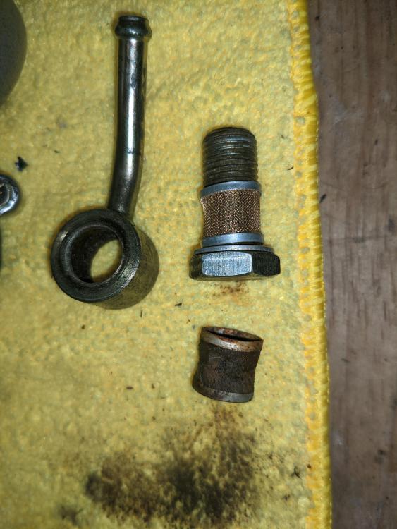

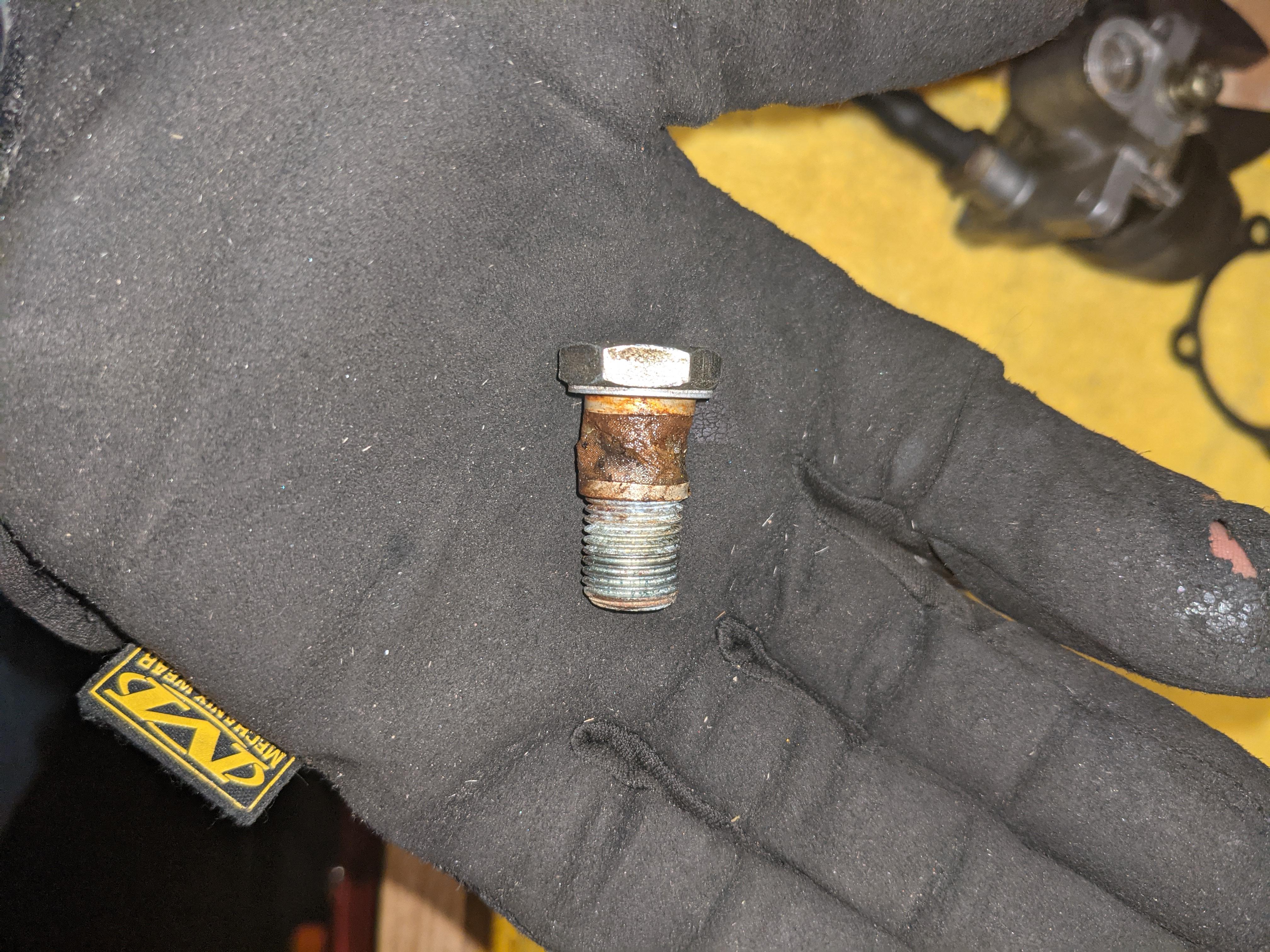

April 5, 20214 yr comment_619231 Can you confirmed there is no debris that is holding the float open? There are two in line filters within the banjo fittings on the float chamber. Mine were full of crud, kept causing overflows on the rear carb. I would check that. The pump you have seems to have an OK range of PSI for SUs. 2000 idle is a lot, shoot for 800-900. You modified cam might want to make it go a bit higher. get your floats adjusted correctly. One you have the floats set then you can use the guide, otherwise the guide won’t work! Link to comment https://www.classiczcars.com/forums/topic/64813-l28-w-su-carb-intake-manifold-vacuum-leak/?&page=2#findComment-619231 Share on other sites More sharing options...
April 5, 20214 yr Author comment_619258 I don't think so. When I manually move the float up while blowing on the fuel tube with my mouth, I can feel the valve close. I cleaned out the banjo and put new fuel filters in recently. The modified cam might make it want to idle higher, but not 1000RPM higher (I'd hope). "get your floats adjusted correctly" - any recommendations vs what I'm already doing? Link to comment https://www.classiczcars.com/forums/topic/64813-l28-w-su-carb-intake-manifold-vacuum-leak/?&page=2#findComment-619258 Share on other sites More sharing options...
