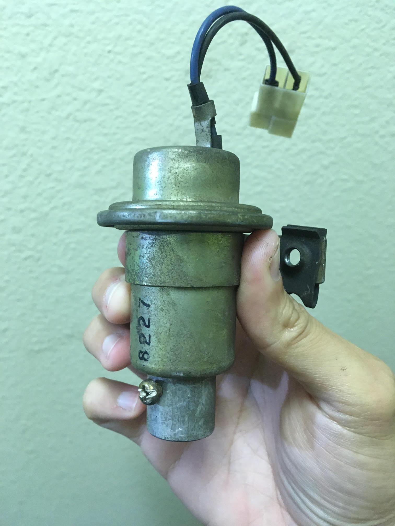

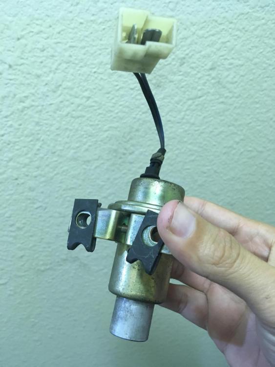

Is there a photo of the altitude switch?  Searching only turns up wiring diagrams, and there wasn't one on eBum, but I think it has a cylindrical body...
Edited by TomoHawk
I think that there's a drawing at the front of the Engine Fuel chapter of the 280Z FSM.  An exploded view of all of the EFI components.
Yes, one terminal has power and the other goes to the ecu I'm guessing.  Here is a couple pics of the one I pulled out of my car:
Edited by chaseincats
Thanks a lot.  I just haven't seen one under there, and I've been under there a lot.
In section EF (Engine Fuel) it connects to pins 9 & 12.  The sensors don't use a common +12V, so the ECU is supplying the 12V on one pin.
