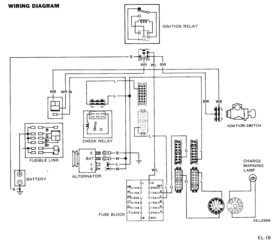

The black fusible link carries the current from the alternator to the battery.
If you haven't done so already, download the EL chapter of the FSM: http://xenonzcar.com/s130/FSM/1982/EL.php
Also check the resistance from the battery negative post to the ground post on the alternator. Bad grounding can cause lots of problems.

Which side did you check?  Check the wire that feeds the link.  Looks like a white one.  And it connects via a plug that could be disconnected or corroded.  Follow the path back to the 15.1 volts.
The FSM is available here on the forum also.  https://www.classiczcars.com/files/category/14-280zx/
