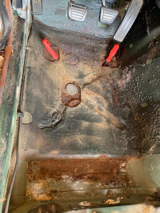

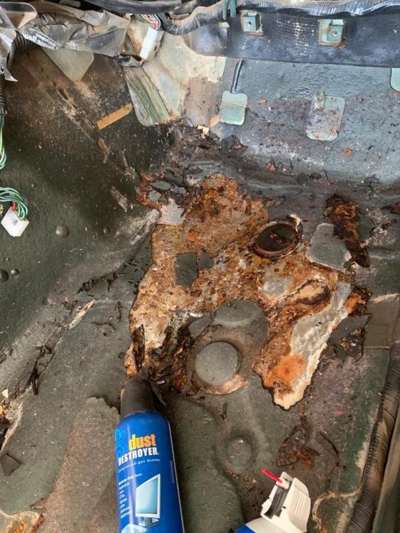

Replacing the interior of my 280z once it’s done getting painted. I might have to replace the floor panel on drivers side. Passages I’m not sure. If I don’t have to replace the passengers side floor panel is it worth removing all the sound deadening and replacing it? 68ab9df1f3e82c2975f6079323f506f8.jpg

In my opinion, if your already getting the driver side replaced, pull up the passenger section and check how it is. It’s better to know what’s under.
I replaced the sound deadening with something like dynamat.
Get a few pounds of dry ice. Let it sit for a couple minutes, then smack it with a hammer. Works great. Fun, too.
Goof Off (not Goo Gone!) will take off any residue. It's one of the stronger solvents you'll find on store shelves, take proper precautions.
