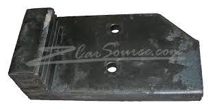

QQ: For the Differential Skid Plate / Weight that attaches to the Front Differential mount, does the thicker end on the left hand side of the photo face rear-ward or forward. I have it oriented with the left hand side facing rear-ward, but I am getting a little clunking when shifting.

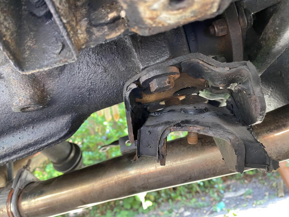

In my experience clunking when shifting is a diff mount insulator that’s past it’s best. Basically, the nose of the diff lifts when you accelerate, then when you cut the power with the clutch mid shift, the diff “falls” backdown and clunks if the rubber has let go or gone soft. On mine I found that it looked perfect but was completely dead when I took it off. The worst scenario I had a few times was changing up at 6.5k rpm and hearing a very LOUD BANG + feeling a momentary deceleration like touching the brakes - as the input flange kissed the ARB!!!!! [emoji33][emoji33][emoji33]
