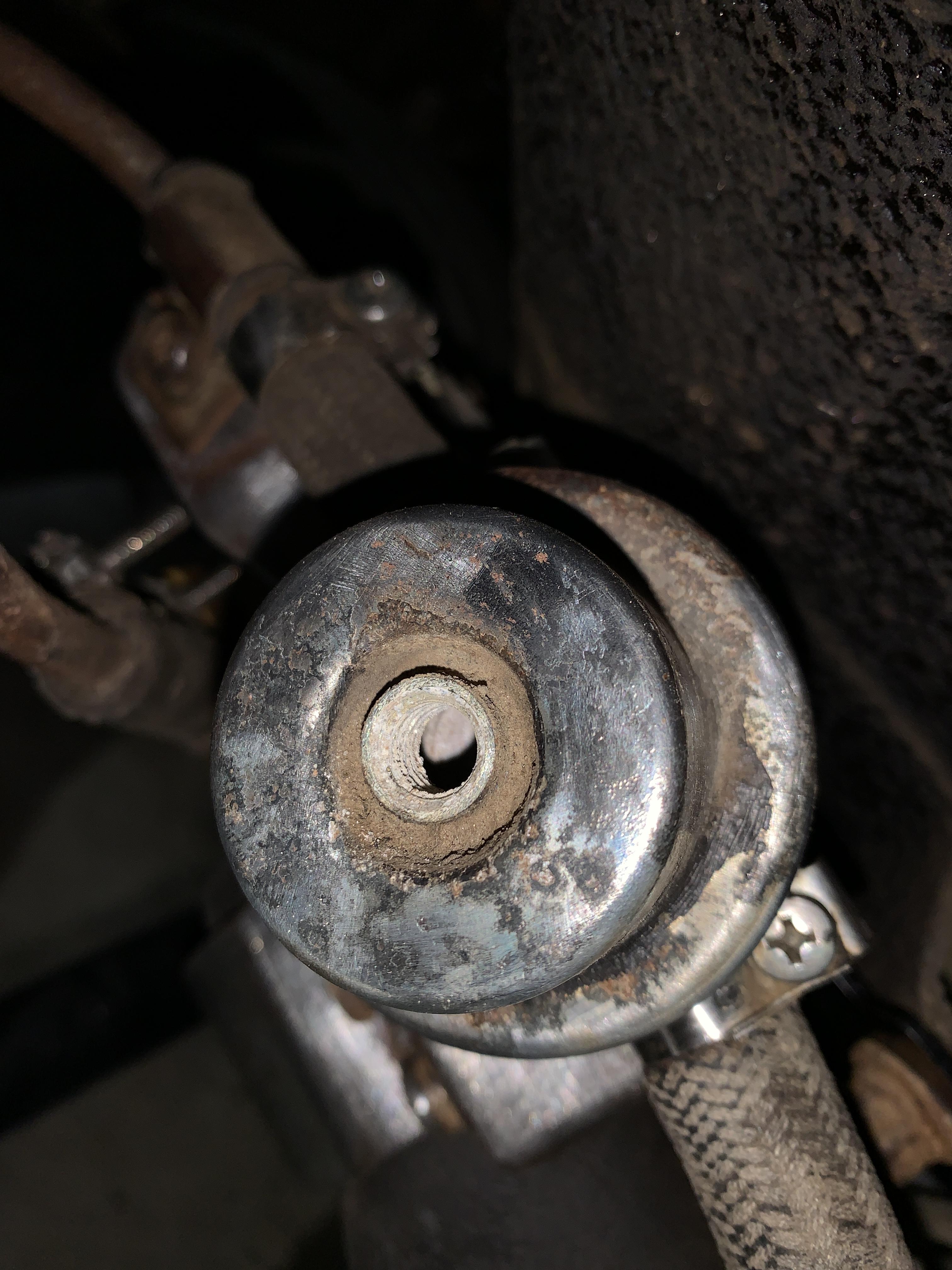

1977 280z. Been sitting since last year. Tried to start it this week, but I can’t get it to turn over. While I was making changes over this summer, I knocked off the fuel line to the fuel pump and it drained dry. I think the issue is air in the fuel lines. I am getting a louder than normal fuel pump noise and the fuel damper is empty, but I tried to loosen the fuel hose after fuel filter, there is pressurized fuel. Any ideas for what to test? If it is air in the fuel lines, what’s the best way to to purge?

The videos are essentially just pictures.  Nothing happens in them.
When you say "turn over" do you mean start or fire?  Or do you mean the engine does not spin when you turn the key to Start?  Usually the word "crank": is used to talk about the engine crankshaft spinning, and "fire" is used to talk about spark causing combustion.  "Turn over" means crank.  Crank, spark, fire.

With regards to the videos, apologies. You guys always pick up on crazy things I don’t hear, so I figured I would share in case there was extra data you could gleam from it. Any photos That are helpful?
With regards to “turn over”, the system doesn’t crank. When I turn the key to start, I can hear the  pump running in the back and I can hear a hissing noise in the front near the injectors, but the engine doesn’t crank.

The hissing noise is probably fuel passing through the fuel pressure regulator.  That's good.
