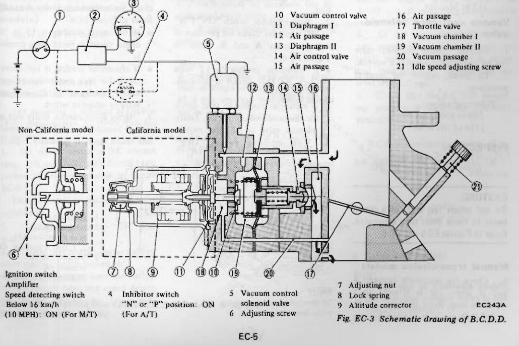

Here's a pic showing the linkage and the dashpot. To increase the engine speed, you push down on the linkage here. So to return to idle, you pull up:

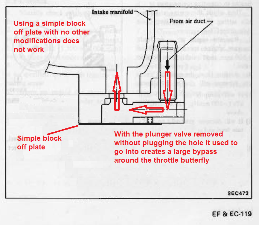

Okay, I so was pretty sure that my BCDD was gone so I ordered a block off plate, used silicone gasket maker, and installed the block off plate. When I start it now, the idle immediately goes to 1750 rpm and cannot be brought back down. the AFR is reading 11.5 so Im pretty sure its not a vacuum leak, that and it would take a pretty obvious vacuum, leak to raise it 1000 rpm. Am I supposed to block off any vacuum lines for the BCDD? What's going on? It has to be getting extra air from somewhere!
Here is a post that Captain Obvious contributed that fixed my same issue. I plugged both holes although only one is necessary with tapered rubber plugs from Ace hardware. Covered each with high temp silicone. These can be removed if necessary if needed. Here’s the diagram. Thanks CO!!
Yarb, My pleasure.
Pochie45566, so as mentioned above... You can't just slap a BCDD blockoff plate on there and call it a day. Doesn't work.
And your A/F ratio is 11.5 at 1750 RPM under no load? I'm no expert on the subject, but that's something that probably needs some attention as well.
