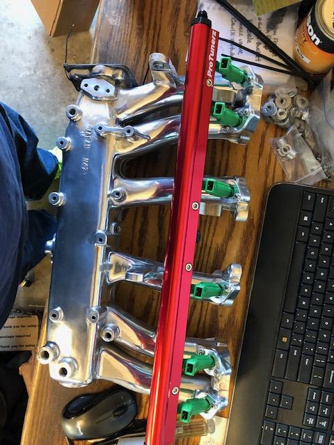

October 19, 20204 yr Author comment_608531 Started dressing up the intake. The Protunerz fuel rail is a beautiful piece but as you can see, the mounting bracket comes up well short of the stud coming out of the head. No problem. I'll remove and replace the stud with a longer one. Link to comment https://www.classiczcars.com/forums/topic/64413-just-another-damned-z-car-project-thread/?&page=8#findComment-608531 Share on other sites More sharing options...

October 21, 20204 yr Author comment_608626 Spent the day chasing threads in the intake manifold and solving the fuel rail mounting problem. It will work, but I need to pull the upper outer two mounting studs from the manifold and replace them with much longer studs. Like 50mm maybe longer. As you may be able to see, the mounting flange falls well short of reaching the stud. That's why I thought the Protunerz peeps had lost their minds when they told me I maybe have to use spacers. (To their credit, when I contacted them, they got back to me within an hour or two and gave me the idea to use longer studs.) So now, the fuel rail is mocked up using bolts instead of studs as I don't want to put it on the engine yet. I also mounted the heat shield and put the 3M heat tape on the header side for additional heat deflection. On the plus side, I was able to find 50 - 60mm X 1.5 studs at McMaster Carr. Edited October 21, 20204 yr by conedodger Link to comment https://www.classiczcars.com/forums/topic/64413-just-another-damned-z-car-project-thread/?&page=8#findComment-608626 Share on other sites More sharing options...
