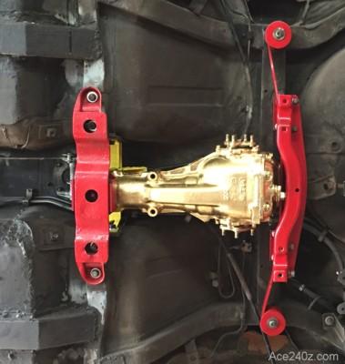

July 30, 20205 yr comment_603546 clay take a look at this: http://ace240z.com/rt%20mount.html Edited July 30, 20205 yr by heyitsrama Link to comment https://www.classiczcars.com/forums/topic/64288-mustache-bars-and-rear-diffs-advice/#findComment-603546 Share on other sites More sharing options...
July 30, 20205 yr comment_603547 That's a good find. I think the reason is not quite right but the fix looks right. Who is that guy? I inserted your link so that it clicks through. http://ace240z.com/rt mount.html Not really correct - "As it turns out, the transmissions for a '70 and '71 240z were mounted slightly back than with subsequent years. " Edited July 30, 20205 yr by Zed Head Link to comment https://www.classiczcars.com/forums/topic/64288-mustache-bars-and-rear-diffs-advice/#findComment-603547 Share on other sites More sharing options...
July 30, 20205 yr comment_603548 1 minute ago, Zed Head said: That's a good find. I think the reason is not quite right but the fix looks right. Who is that guy? I inserted your link so that it clicks through. http://ace240z.com/rt mount.html Not really correct - "As it turns out, the transmissions for a '70 and '71 240z were mounted slightly back than with subsequent years. " Hes some dude with a Z, http://ace240z.com/who.html I wonder if hes on this forum, i dont see anyone under Ace. He seems to be doing a lot of work on his car http://ace240z.com/current.html . Link to comment https://www.classiczcars.com/forums/topic/64288-mustache-bars-and-rear-diffs-advice/#findComment-603548 Share on other sites More sharing options...
July 30, 20205 yr comment_603549 Looks like he's a zcar.com guy. Zcar was barely alive a few years ago, haven't been there much lately. "The various members of Zcar.com contributed valuable guidance." Link to comment https://www.classiczcars.com/forums/topic/64288-mustache-bars-and-rear-diffs-advice/#findComment-603549 Share on other sites More sharing options...

July 30, 20205 yr comment_603552 I took a closer look at his solution and I think that there are other ways to get it done. But it's good to know what the problem is. Link to comment https://www.classiczcars.com/forums/topic/64288-mustache-bars-and-rear-diffs-advice/#findComment-603552 Share on other sites More sharing options...

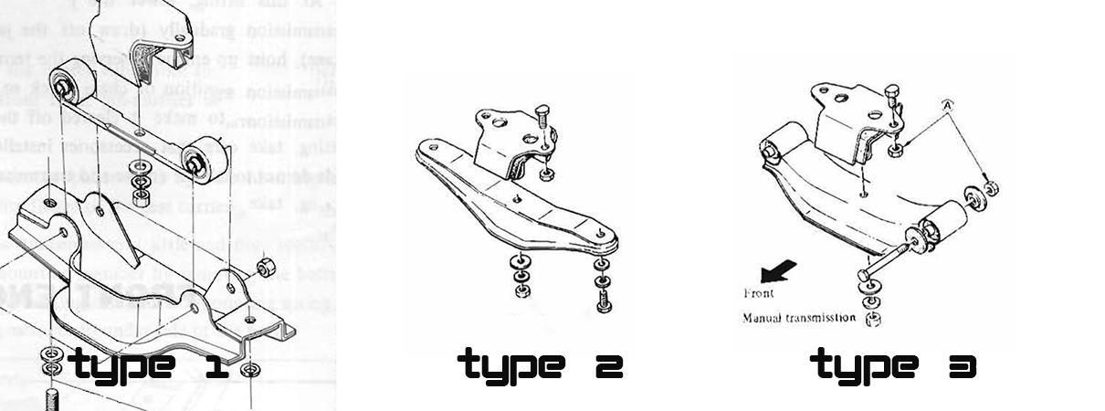

July 30, 20205 yr comment_603553 I think you'll run into different style transmission mounts, based from what @Zed Head observed on Ace's website a different transmission position and from https://technotoytuning.com/nissan/240z/z-type-3-transmission-crossmember-l-series And possibly different sized outer tie rods, but thats for another thread.... Theres another picture on Ace's website that shows the underside. @Clay C did you happen to get the mustache bar from the 260z? Edited July 30, 20205 yr by heyitsrama Link to comment https://www.classiczcars.com/forums/topic/64288-mustache-bars-and-rear-diffs-advice/#findComment-603553 Share on other sites More sharing options...
