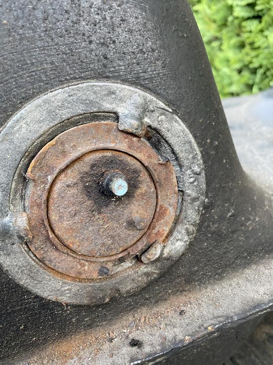

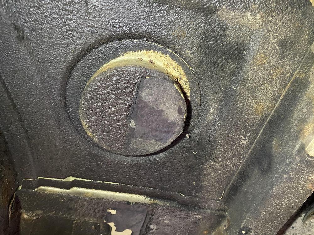

Also given my sensor is at the front and now with the fuel tank off, I can confirm your nifty access hatch is of little use on mine and is therefore this shape from under the car ...
Ewwwwwwww!!! That's got to be worth a quarter tank at least! Maybe a third!    LOL   Woof!

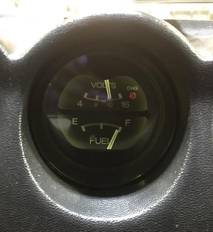

LOL!!! Well this is how close to F it used to get, quite surprising really!
58f3eea7301d2d9eb4ce1e7e833959c9.plist
So I’m expecting serious overshoot when cleaned up ;)

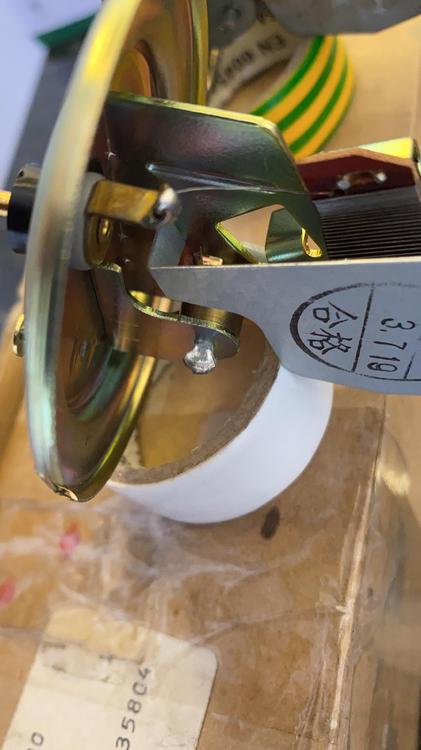

I discovered that the fuel level sensor was leaking on the live terminal where there is insulating plastic, remember this photo?
9a92a4f080aba7419e1b3251c8266073.jpg&key=d72222c31ef873f1c1a9b398ed0ca43dded1c6c92346c6701aaf2684c289f2ec

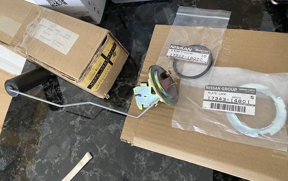

To confirm it, I hung the thing from the float over night, with the “bowl” bit filled with self penetrating oil. The next day there was ample oil on the other side to prove it’s no longer air tight. I could have repaired it with fuel resistant mastics but I started to look at the cost of a new one. Utterly HORRENDOUS prices. Over £300 for the right shaped one. Then one appeared on eBay advertised for a Datsun 510 with very similar kinks etc so I took a punt at £40!

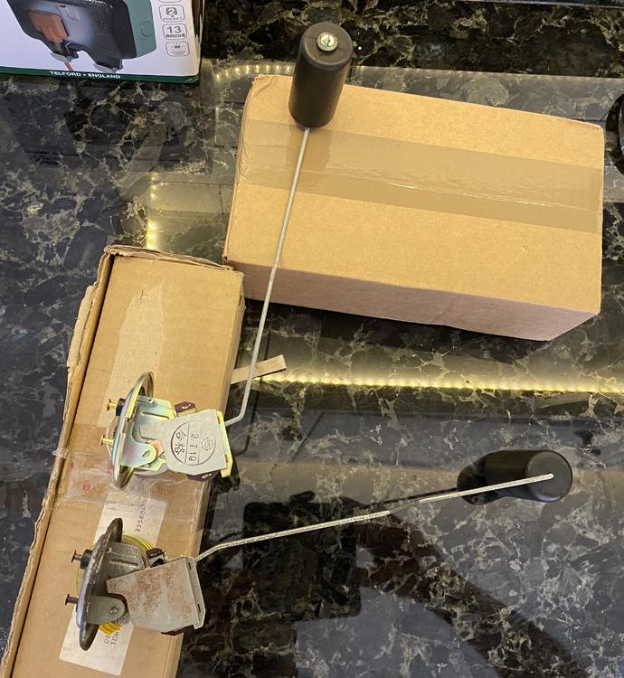

Today, this little package arrived ...
ac73b658c32039656bc8522ecd4b5481.plist&key=9444a84ac099c6dc8a7239efdbc7f5bc54399971e2545dc3f4a1a9cecc5c01e7

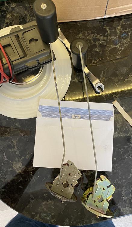

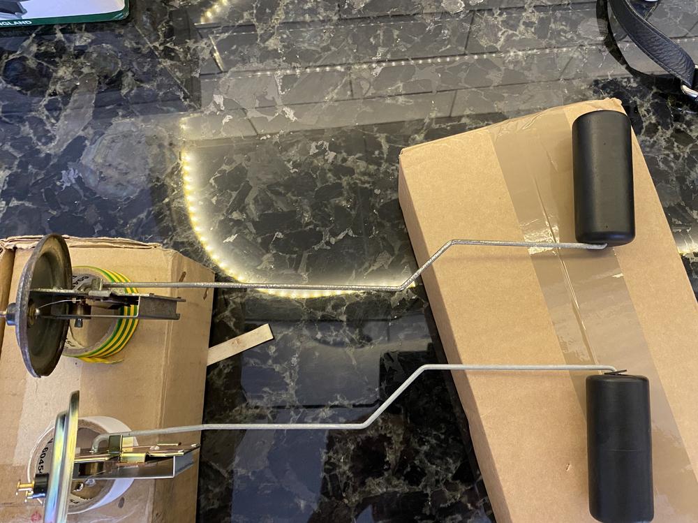

Now you can see the differences below:
4977172959488749d8c3f5924038d8b0.plist&key=e6524ec60439ab597b05901e64768257caf4701ad5795bff616a758c15ef4b35
7bbeb1e9a61dddadbf63b92f99165977.plist&key=971898c09be7b2e87253f92501bb132bac1b767571caa2f5bf3f46a7d1d23c20
The resistances however are virtually identical +/- 1/2 an ohm. 10.8 ohms full, 88.5 ohms empty.
I was tempted to move the rod and float from one to the other but decided that as it involved cutting the squashed end and re-calibrating, I was going to have a go at bending the new one first.
3c1d4b51cebe26d83057c5bc6bca1c89.jpg&key=98640718b08b3a54168a32493b318719a60e0f73a8e3ff2d5dded4a97c79a4b4
I straightened up the first kink on the new one, measured the length of the same king on the old one and bent it in the same place as the 260z sensor. The end result? Ignoring the parallax of the iPhone lens, it turned out utterly perfect. It even sorted out the difference in length - they are now identical in length also.

Wow that's a real win! Way cheaper! So (other than to different arm shapes) does everything else look the same? Same mounting bases and everything else?
Can't wait to see how it works on the gauge.
Clever boy!  What a great idea, thanks for letting us know.

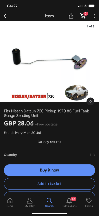

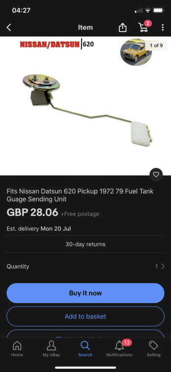

Thank you sir. - glad to be of service. BTW, found an even cheaper solution on eBay. A Datsun 720 or 620 sensor would have also done the trick at £28 posted!! I would bet my left testicle* that the ohms will be the same on all these sensors as the main unit is identical, just the float and bends are different.
https://www.ebay.co.uk/itm/164126554844
