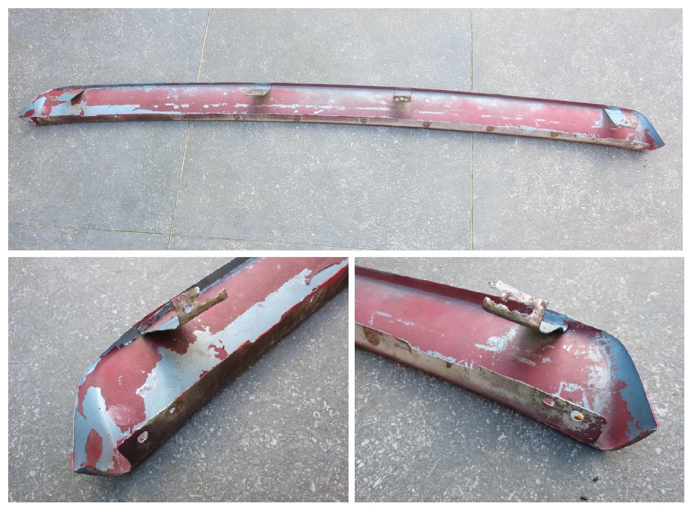

My advice on the bumper swap. Be carefull and take your time removing the rear bumper gap shield. It is spot welded to the body and easy to destroy while removing it. If you decide later to restore it to original, you will need it. Mine is stored away for one of those "you never know" moments.RearBumperShield-1.jpg
280Z's aren't the collectors items the 240Z's are, but as time goes on you never know. The collectability factor will depend on its originality.

Good point, any tips on a clean removal would be welcome! Thanks guys!

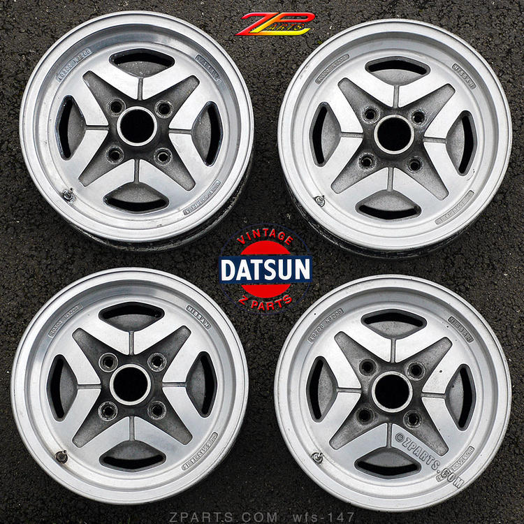

Good to excellent condition examples of those wheels are quite rare and will involve serious coin to knowledgeable sellers and buyers. Good to excellent condition centercaps are even rarer. Keep them! Consider finding a set of caps that will fit for daily use and preserve your originals for special occasions.
Back in March of 2018 I posted this regarding these wheels (although I have a set of the original caps, the caps shown below are not correct for the wheel but I like the fit of them more):
"Being a "4 spoke 'old school' fool" for wheels----
I had been intrigued for some time by this statement from Eric Neyerlin on his website: (www.zparts.com)
"This wheel (pn 40303-N3200) is the only OEM wheel that Nissan specifically produced for the 70-78 240Z-260Z-280Z (S30) models world wide.  Nissan parts catalog shows a 4/73 production date for this design.  Though common to most S30 models sold in Australia, Canada? and Europe this wheel was not offered stock on any US imported Z  cars except for one year on the 1977 Black Pearl special edition model.
Now, 46 years after the 240Z models were first introduction, this rare factory wheel is increasingly regarded as the the only true, period correct, vintage factory aluminum wheel to put on a meticulously restored S30 model, apart from original, model year correct, steel wheels and hub caps common to US models."
Well---OK---
I'm in-------
This is one of the set of 6 that I recently purchased.
All of the wheels are in truly incredible condition, extremely clean inside and out and 4 of them are polished very well.
I had a NOS set of center caps on hand from years ago that were destined for use on a set of "iron cross" wheels I owned at the time.
The caps fit perfectly on these wheels and I've always liked the factory Nissan "acorn" style lug nuts with the captured washer. A substantial nut with positive fitment between the wheel and the lug.
If the stated original production date of 4/73 is correct, then it is entirely conceivable that my 6/73 240Z could correctly have worn these in that same year.
As period correct as I can get for this car and I don't have to risk losing my hubcaps-----been there and done that."

Excellent info and a great read. I will clean and polish those wheels to really see what kind of condition they are in. I can't find anything online to see what kind of value they have. I can't really seem to find any for sale.
You won't easily find complete sets of them. That is part of why they are expensive when you do.
Eric Neyerlin's site is the only place I have seen them listed and offered for sale and they are a bit pricey at a grand plus shipping.
http://zparts.com/index.php/shop/wheel-showcase-1/

The way I removed mine. First remove bumper. I then drilled out the spotwelds on the four supports with a spotweld cutter. That made it possible to lift up the shield enough, it will deform a little and the drill out all the spotwelds along the top lip.
You can see the holes I drilled in mine in the photos above.

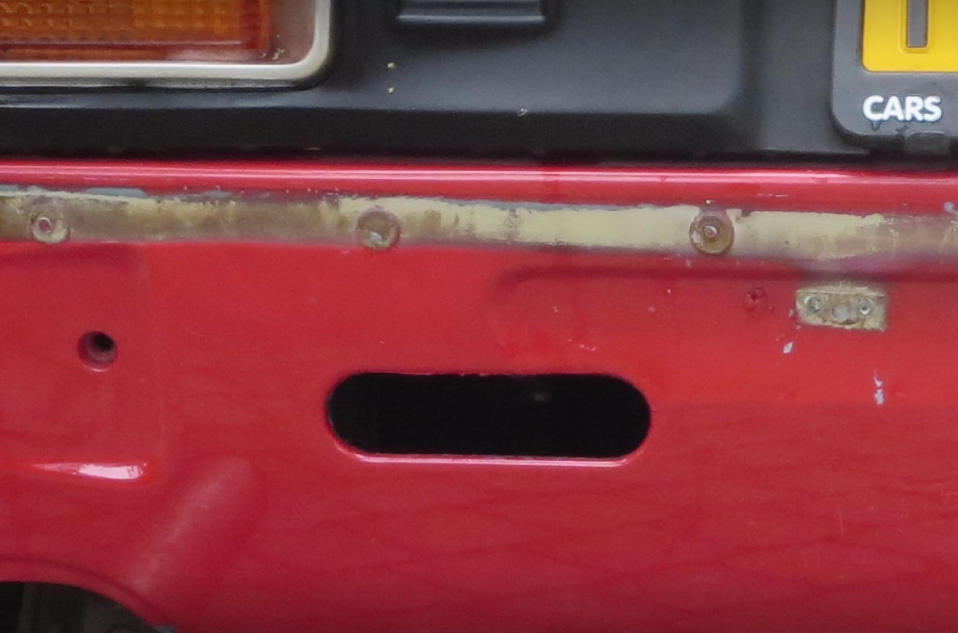

The valance panal has dimples (round sections that sticks out about 1 mm) where each spotweld is located. You will need to do some panel work to remove them or leave them, but they will be visable even with a 240Z bumper. I see if I have a photo of what I mean.

Thank you for this info! I will make it my project this weekend since I will be finishing up my rough sanding this weekend too. Thank you for the photo! It helps a ton.
