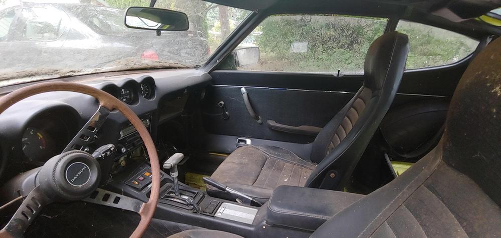

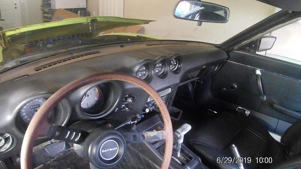

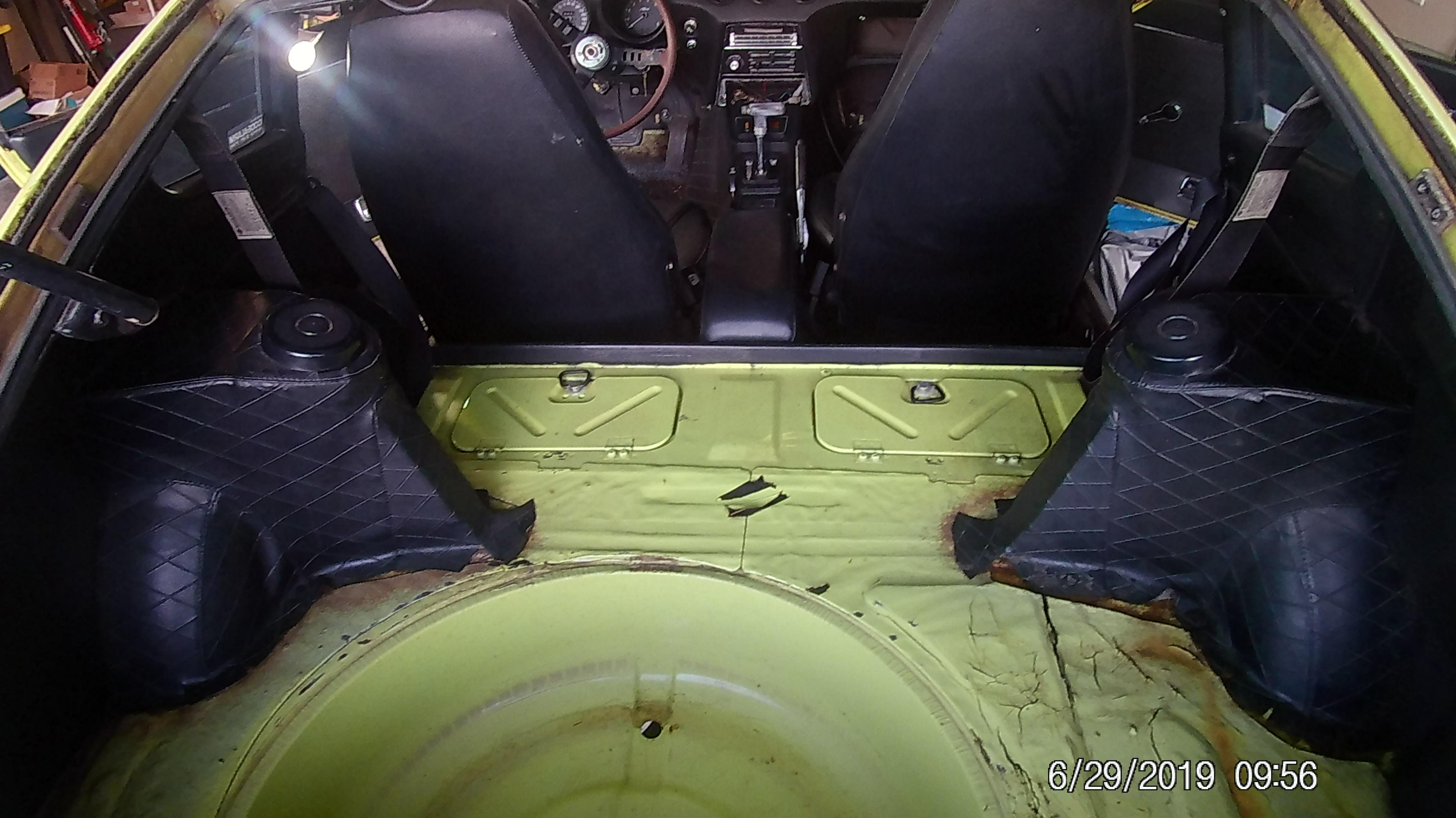

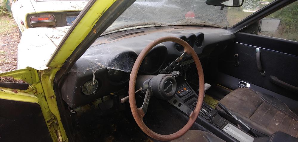

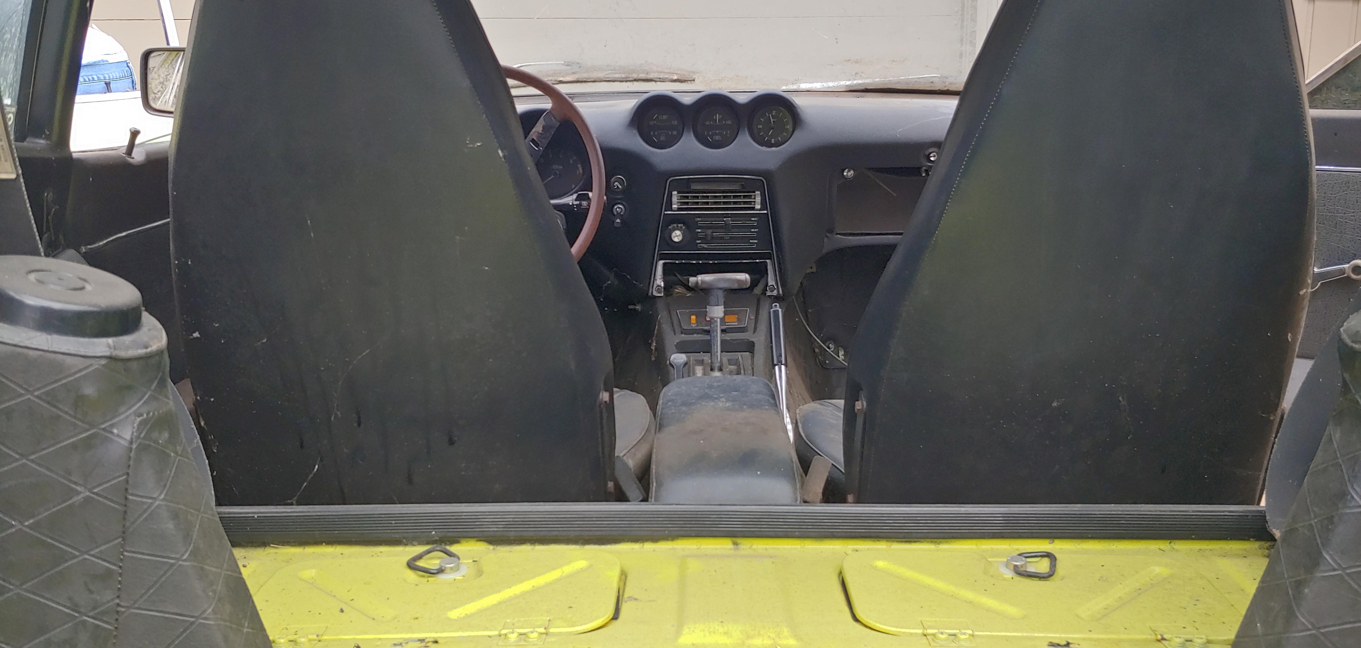

Wiped Down Interior  (Before / After)

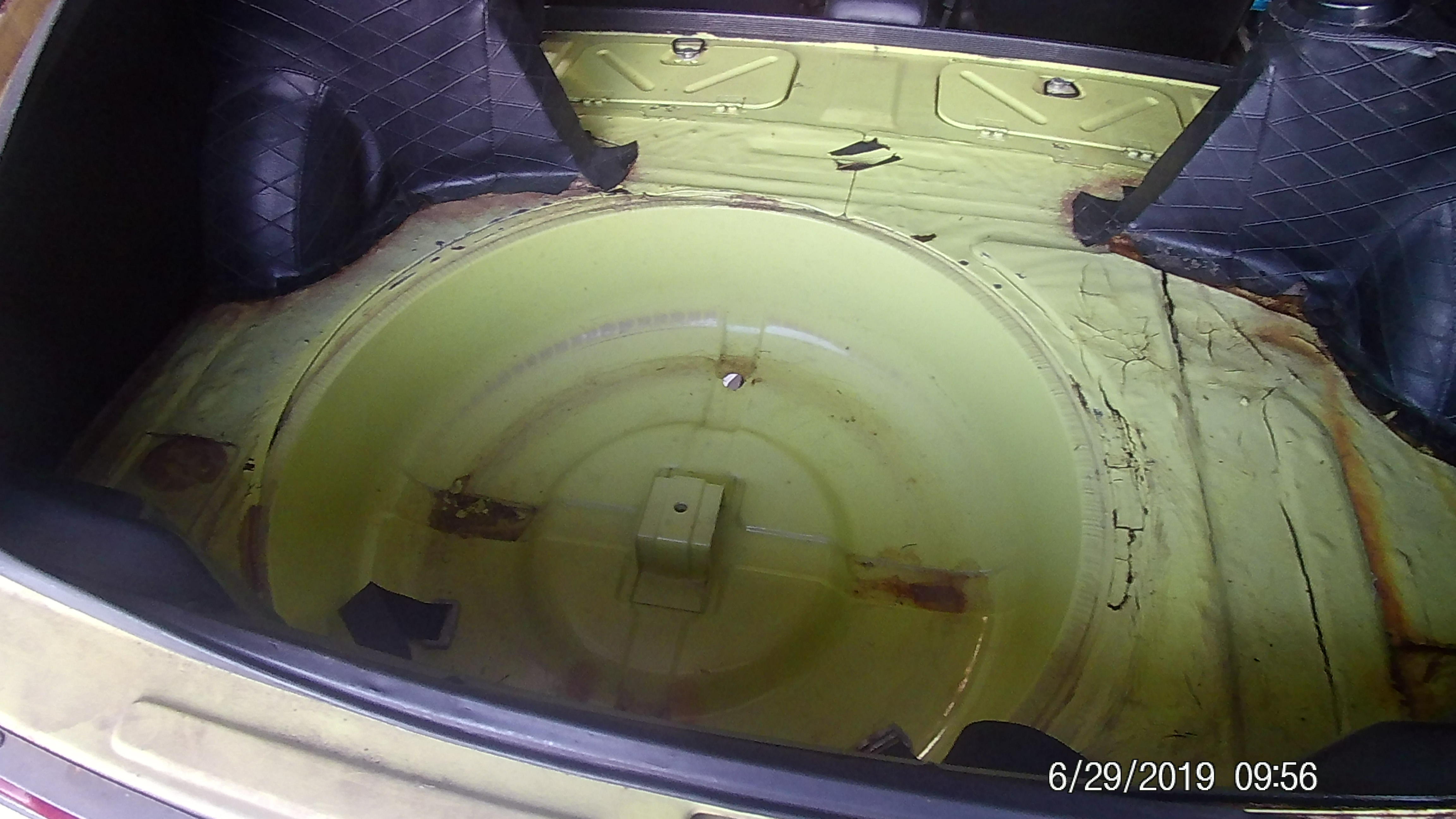

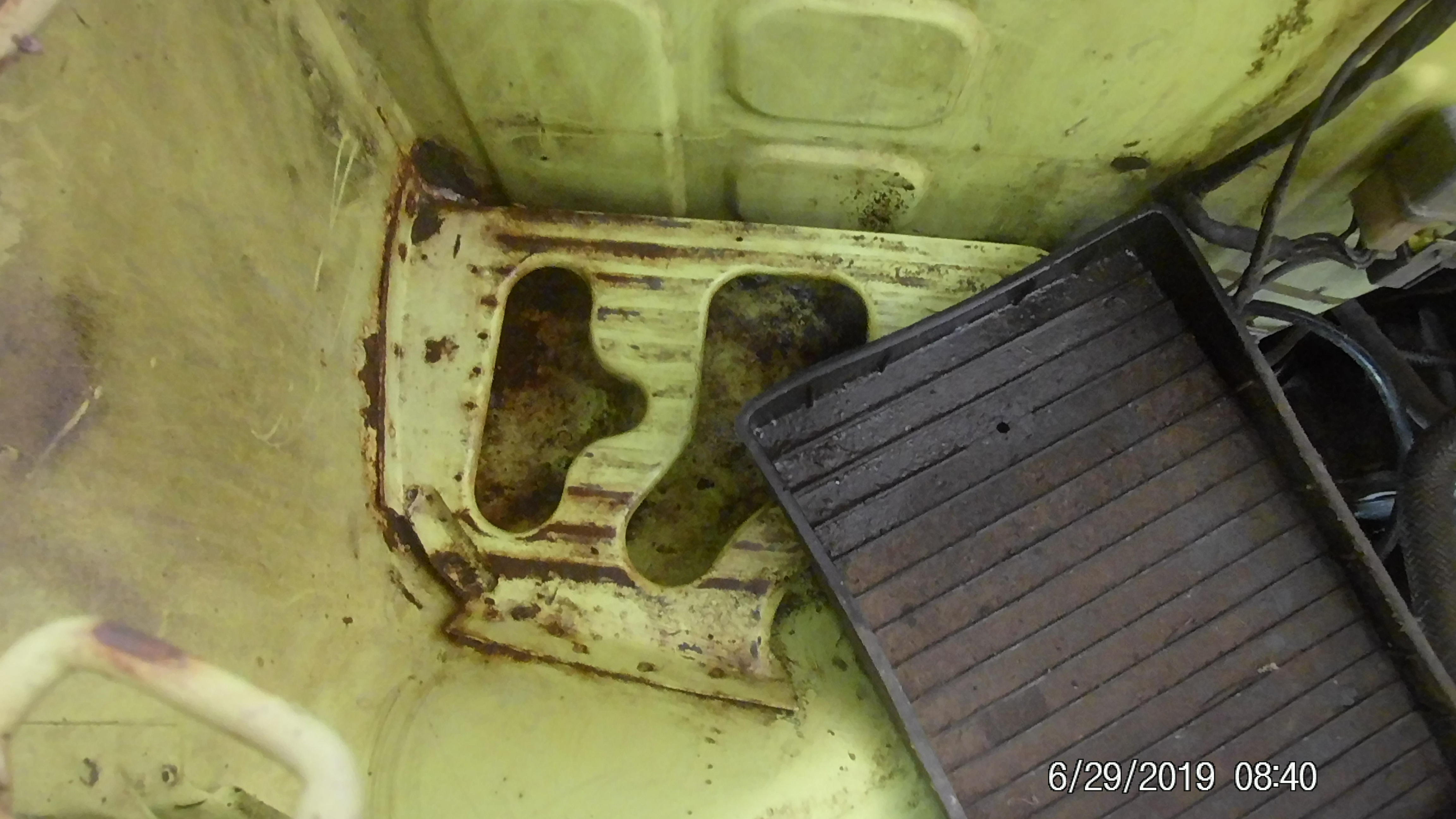

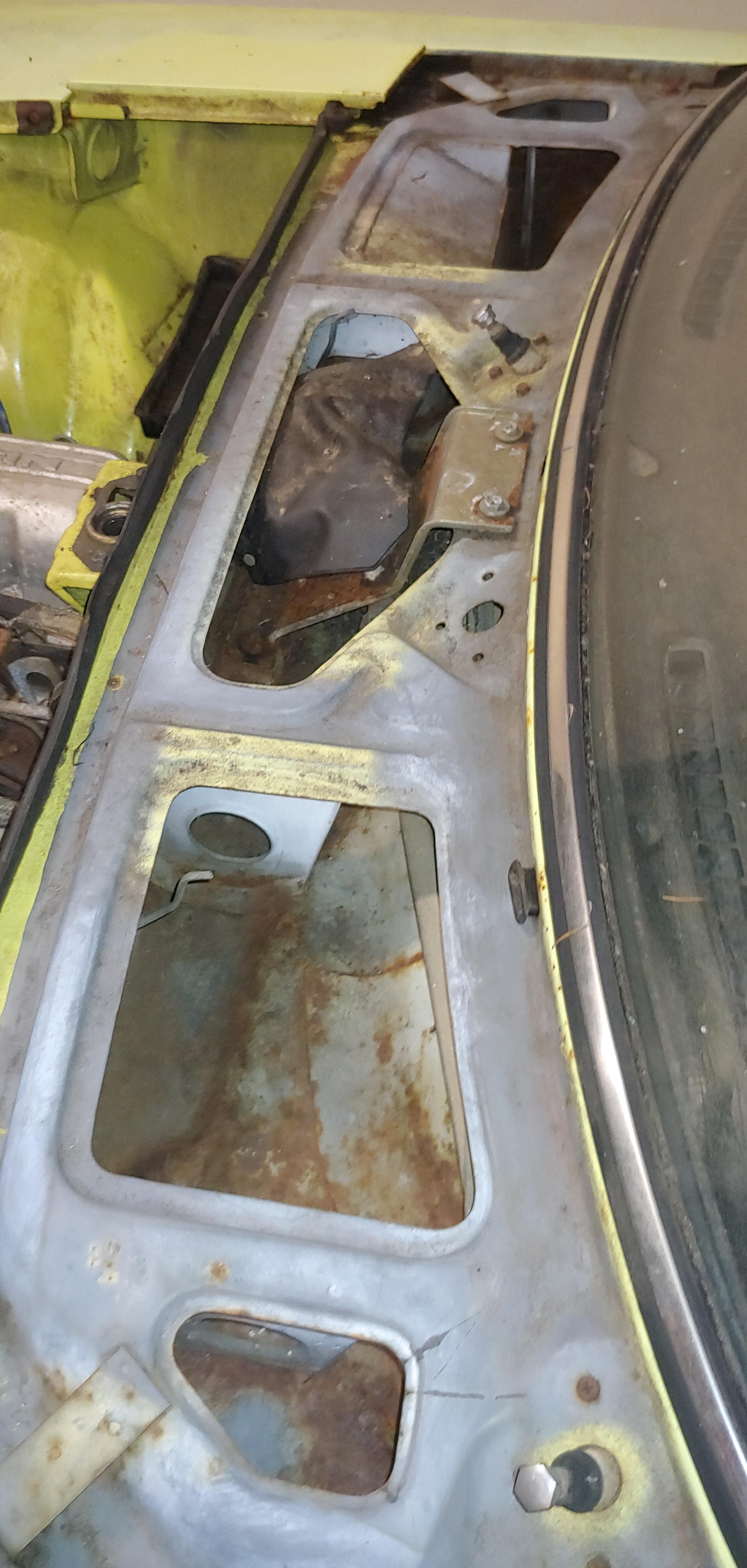

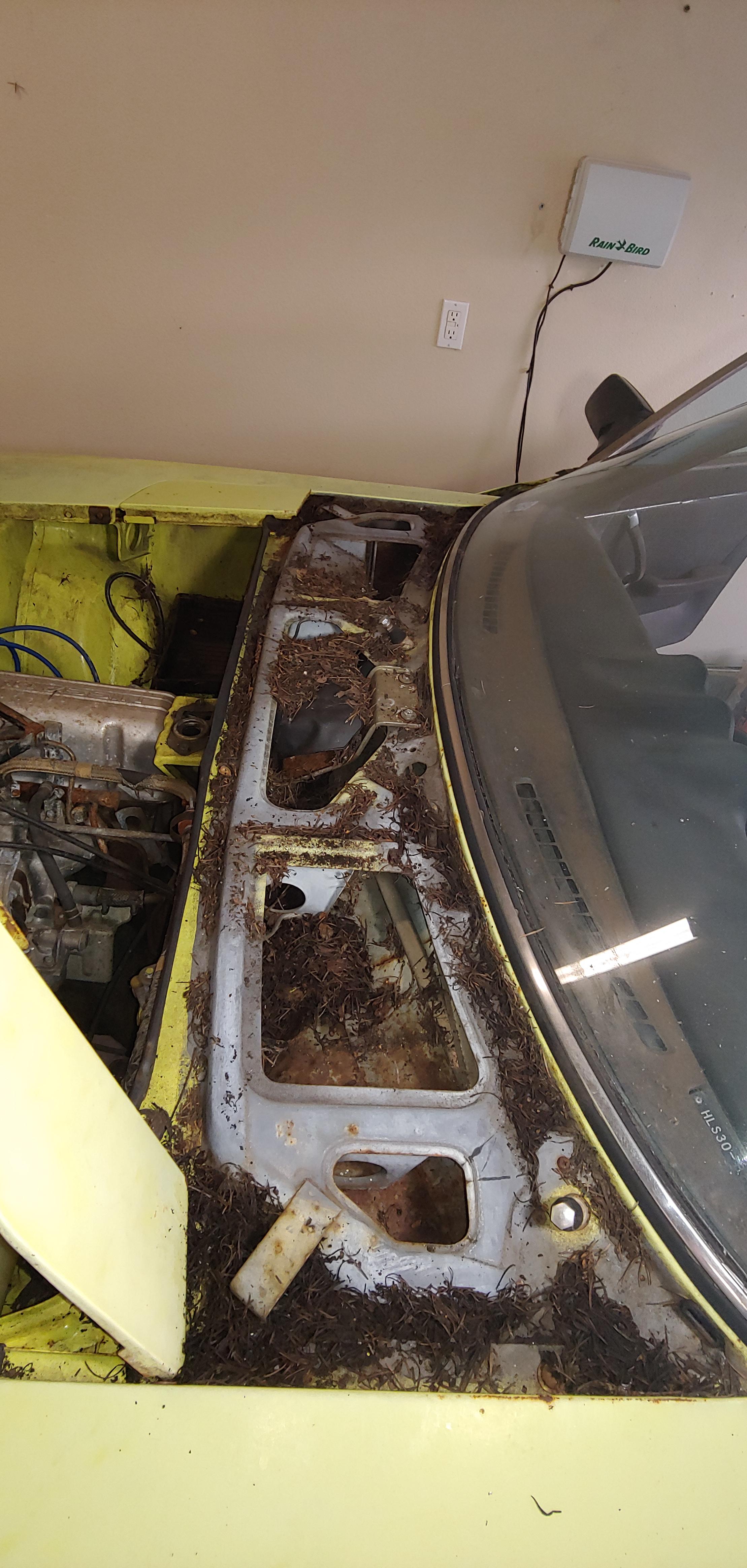

Cleaned out pine needles under wiper motor plate and vacuumed battery tray

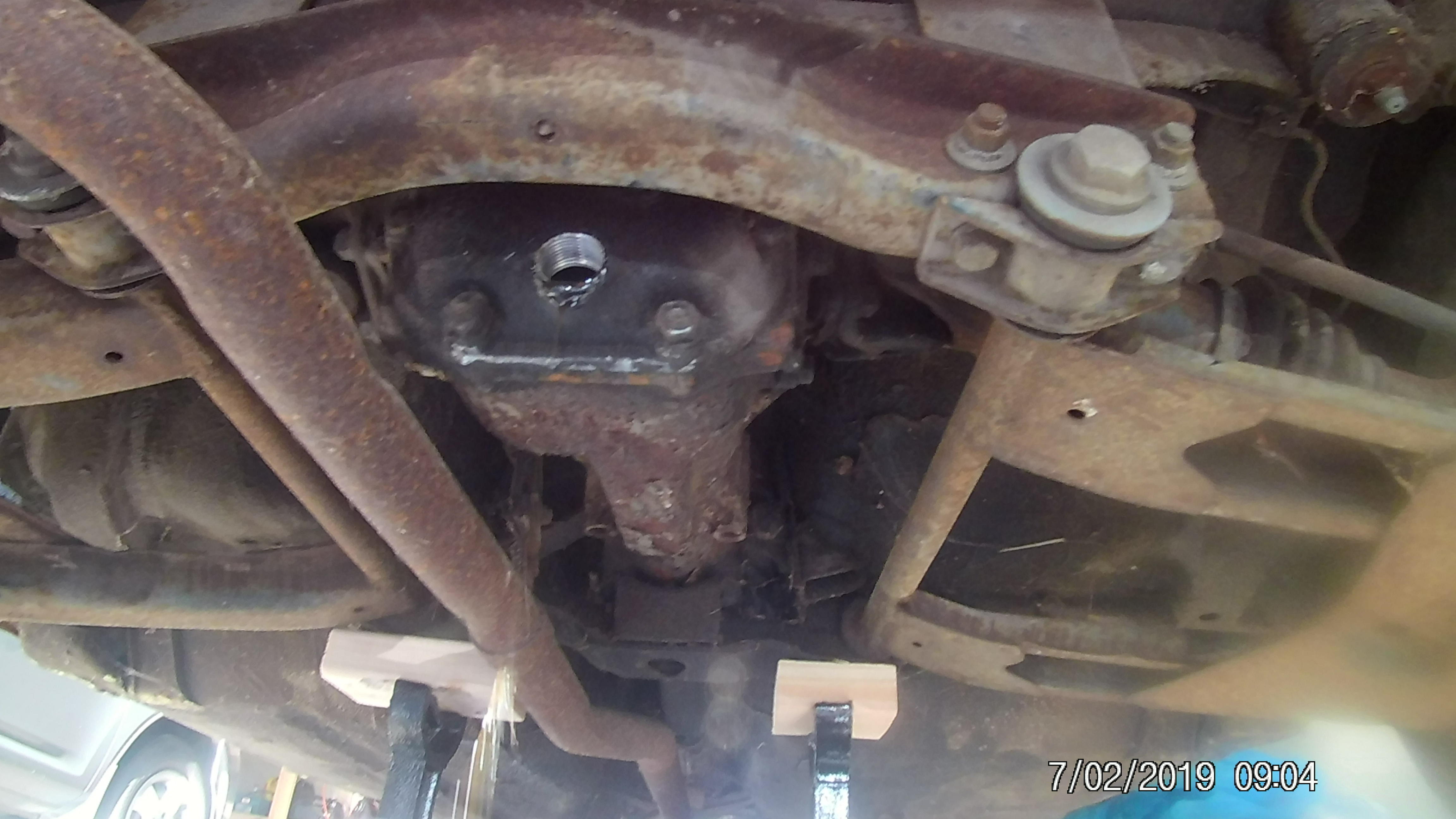

Changed the diff fluid

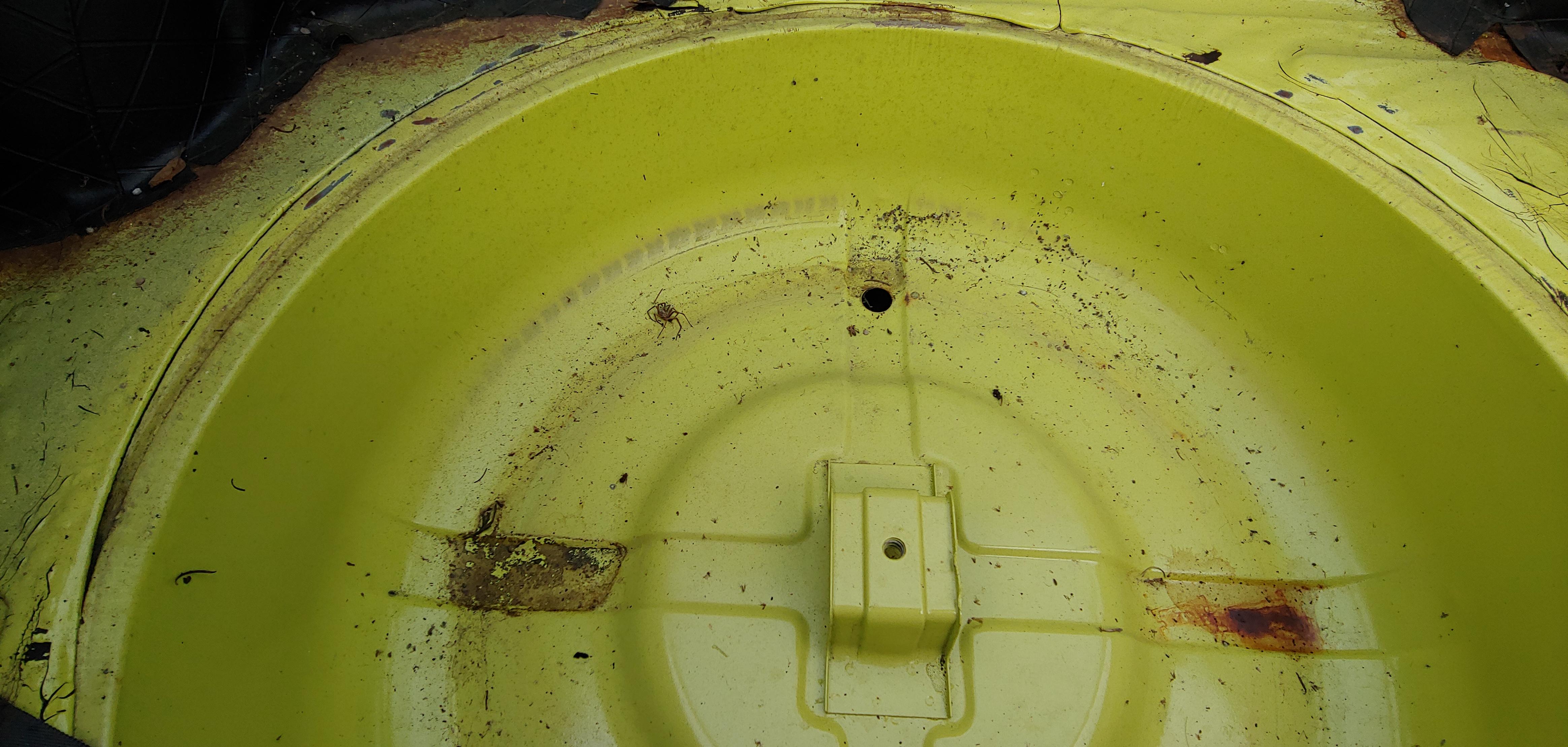

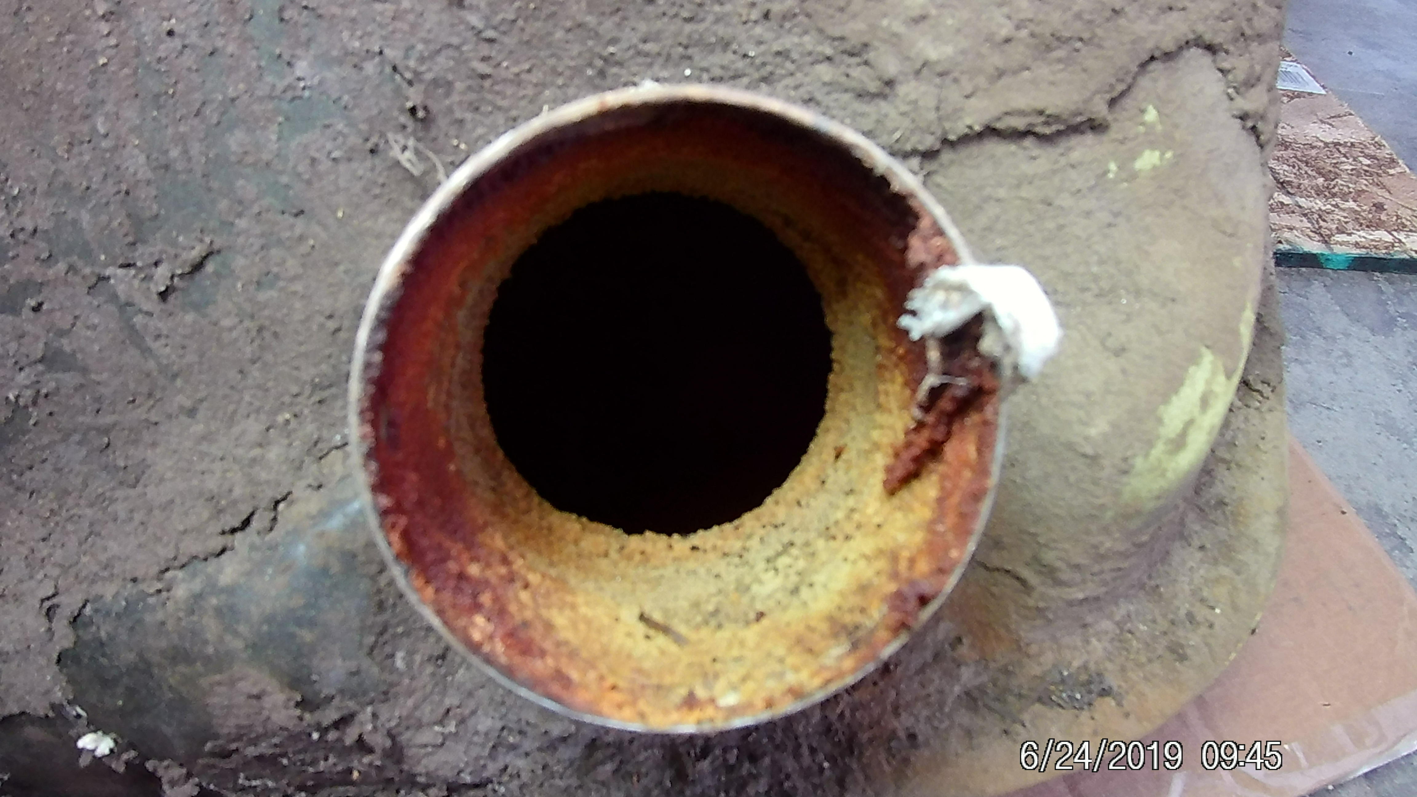

Removed the fuel tank, most of the fuel tank hoses were rotted away, including the "Fuel Tank Filler Neck", and the "vent hose, ordering replacements soon.
Drained fuel,  looks very orange..
Rust is the worst at the inlet, I think this is because the filler neck was rotted through. Drained remaining fuel and will try to re-seal tank.
Need to clean and reseal.

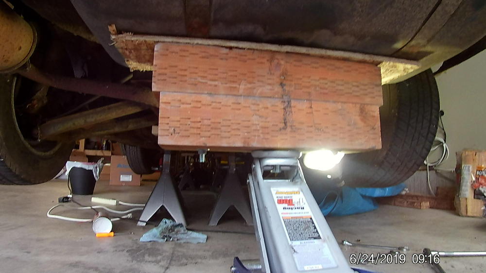

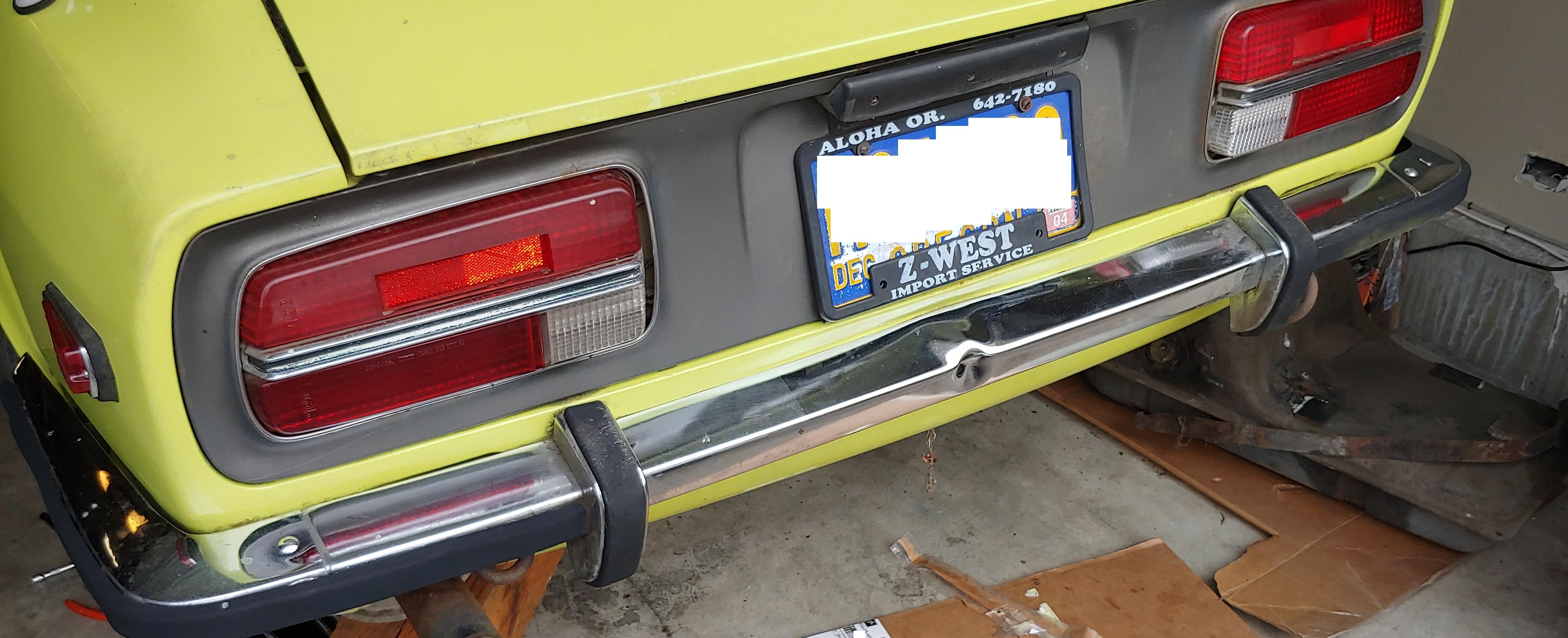

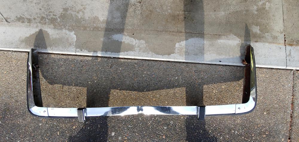

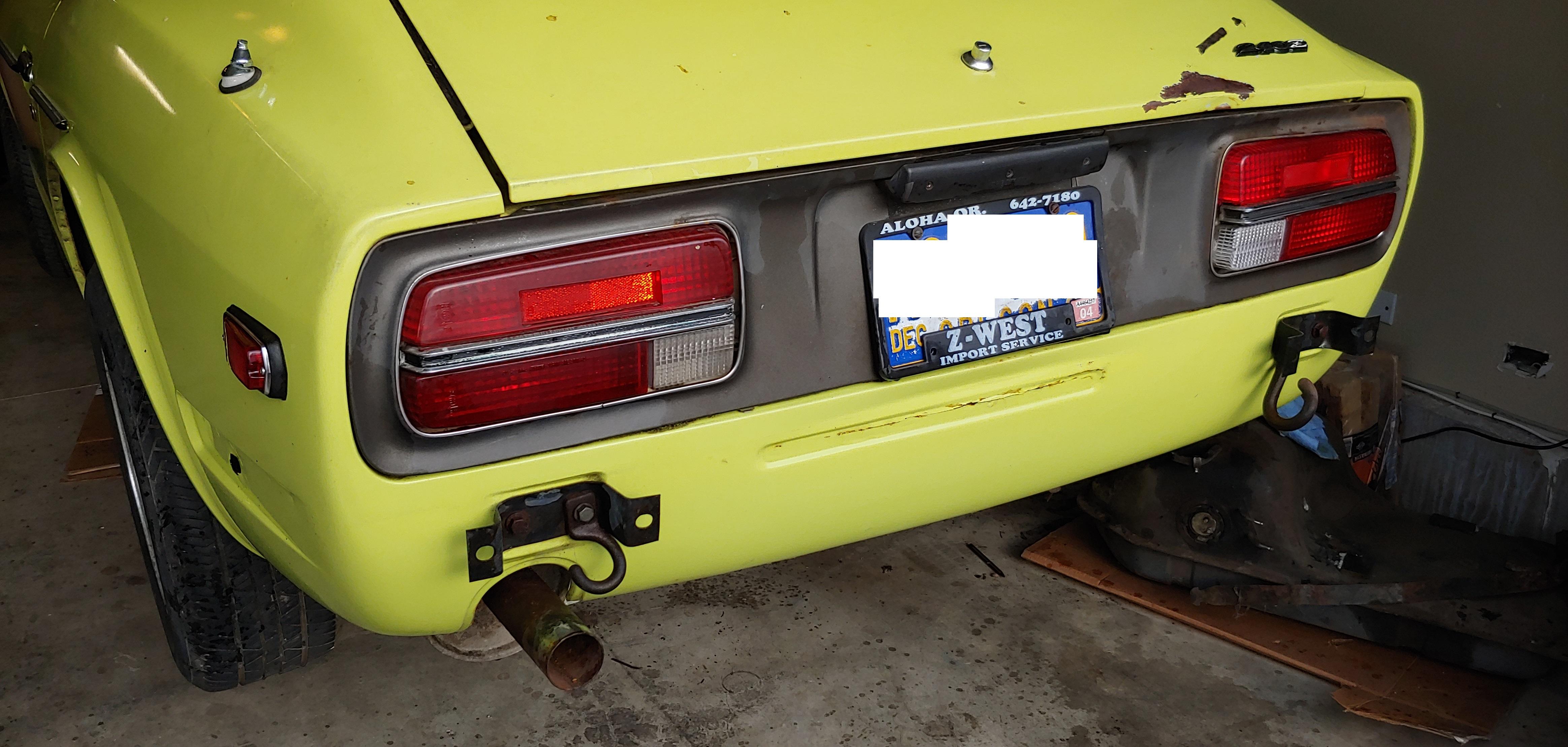

Removed Rear bumper since it is damaged and little easier with the tank out.

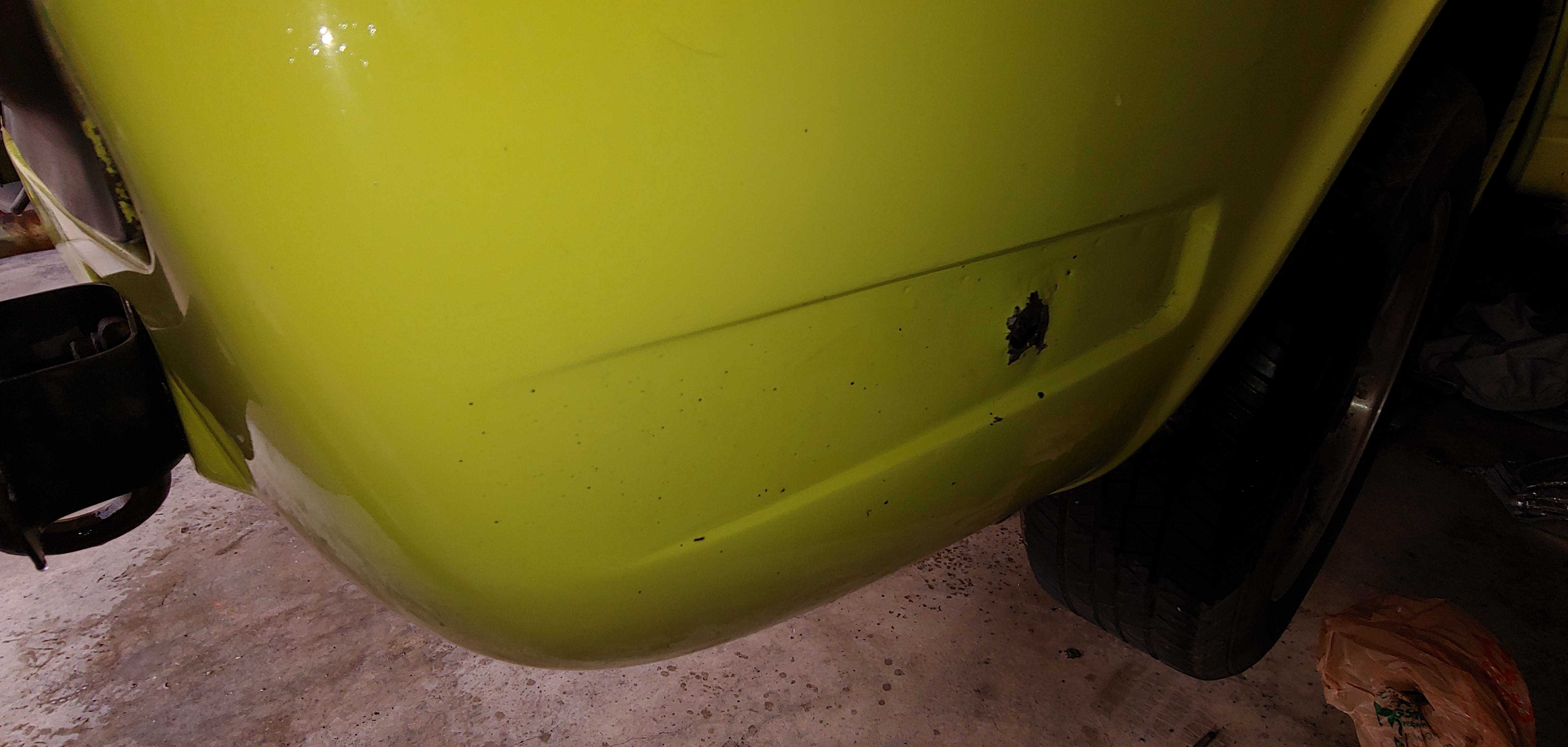

Minor damage directly below license plate, notice black line. This is cracked paint and rust.
Picture doesn't do justice, bend it pretty ugly.

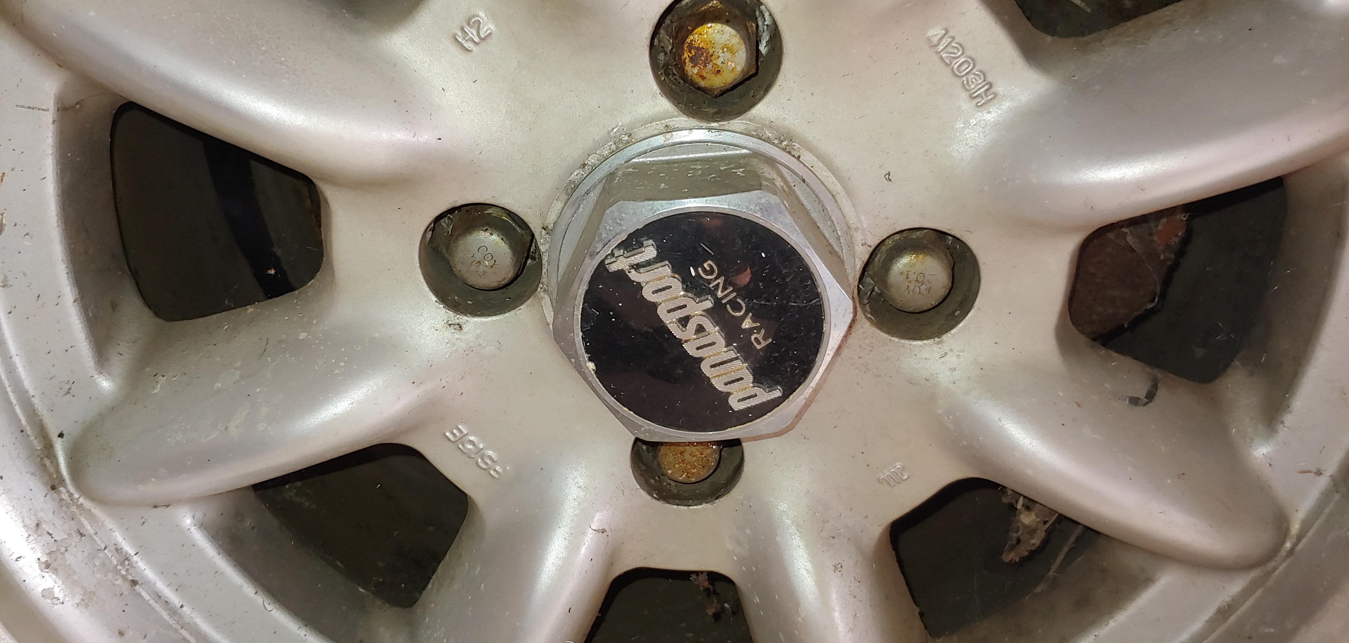

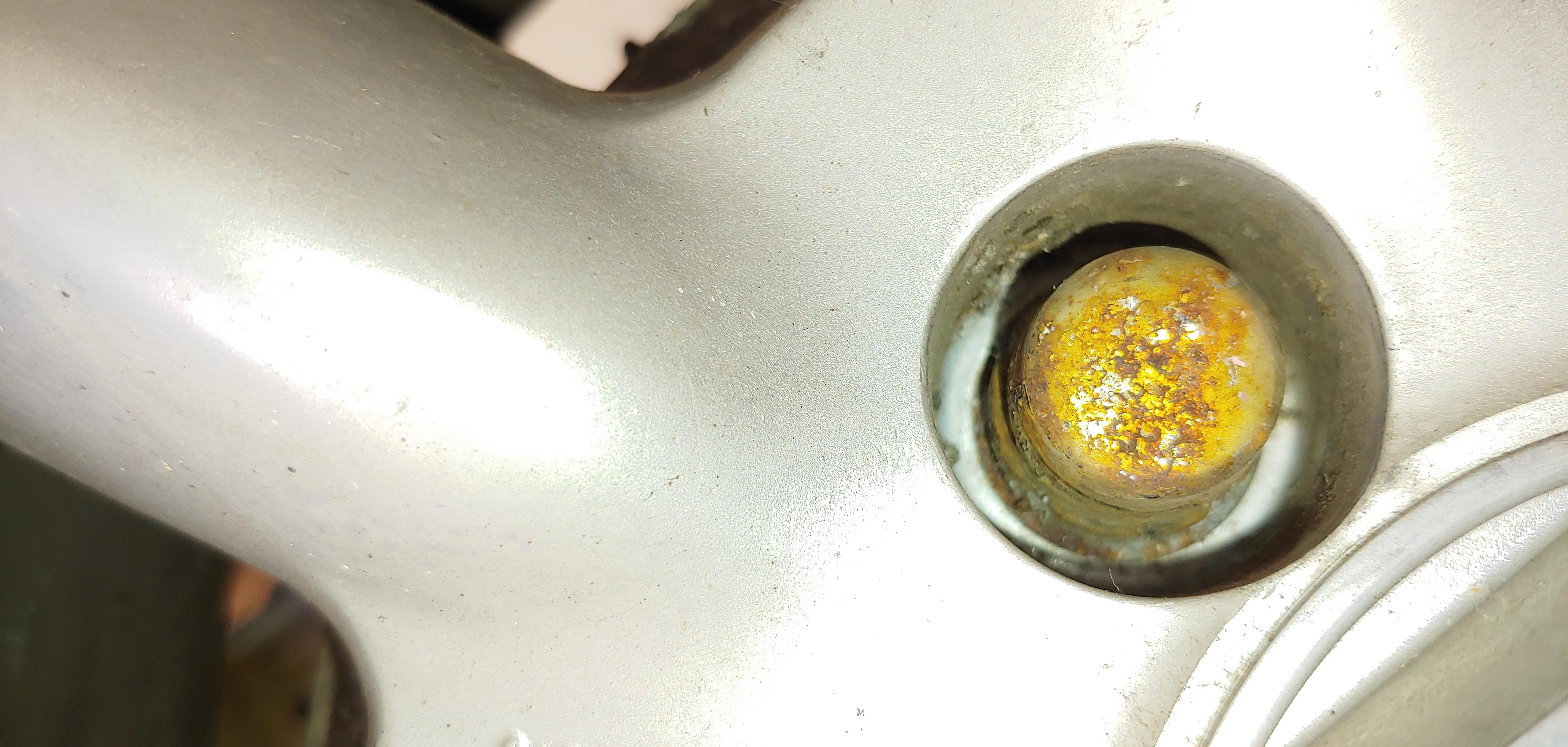

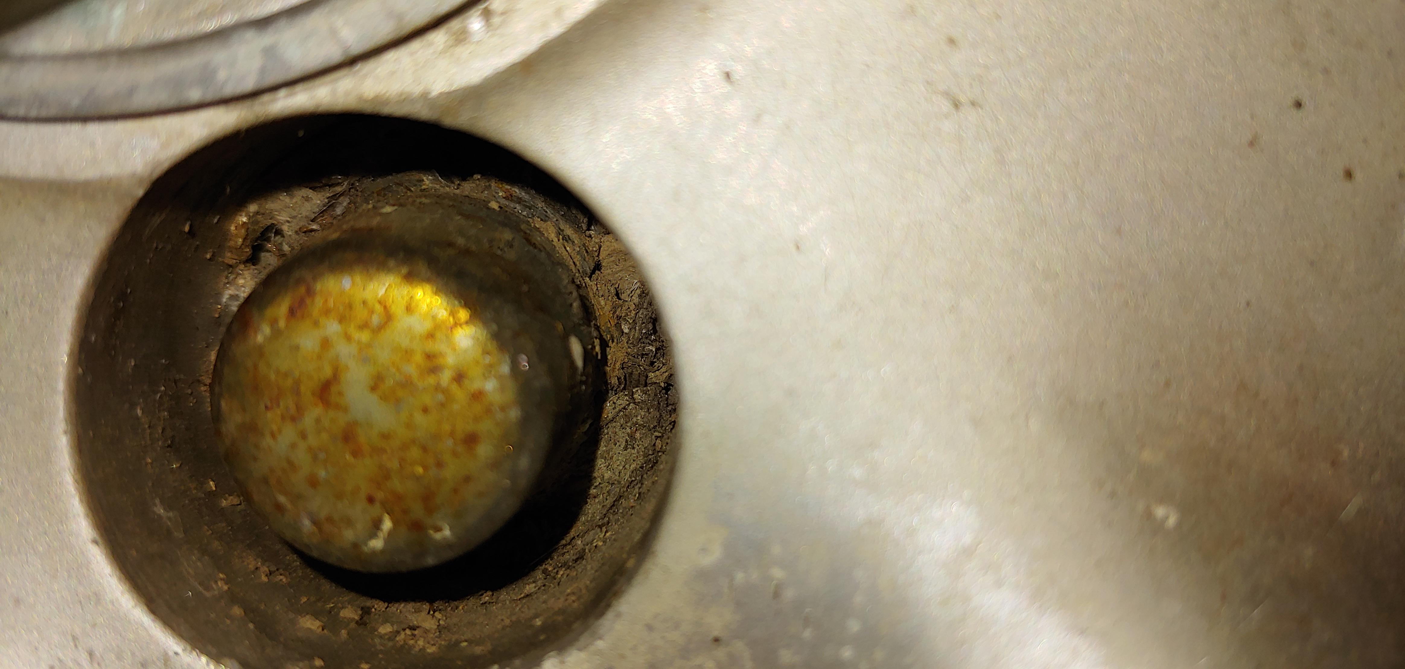

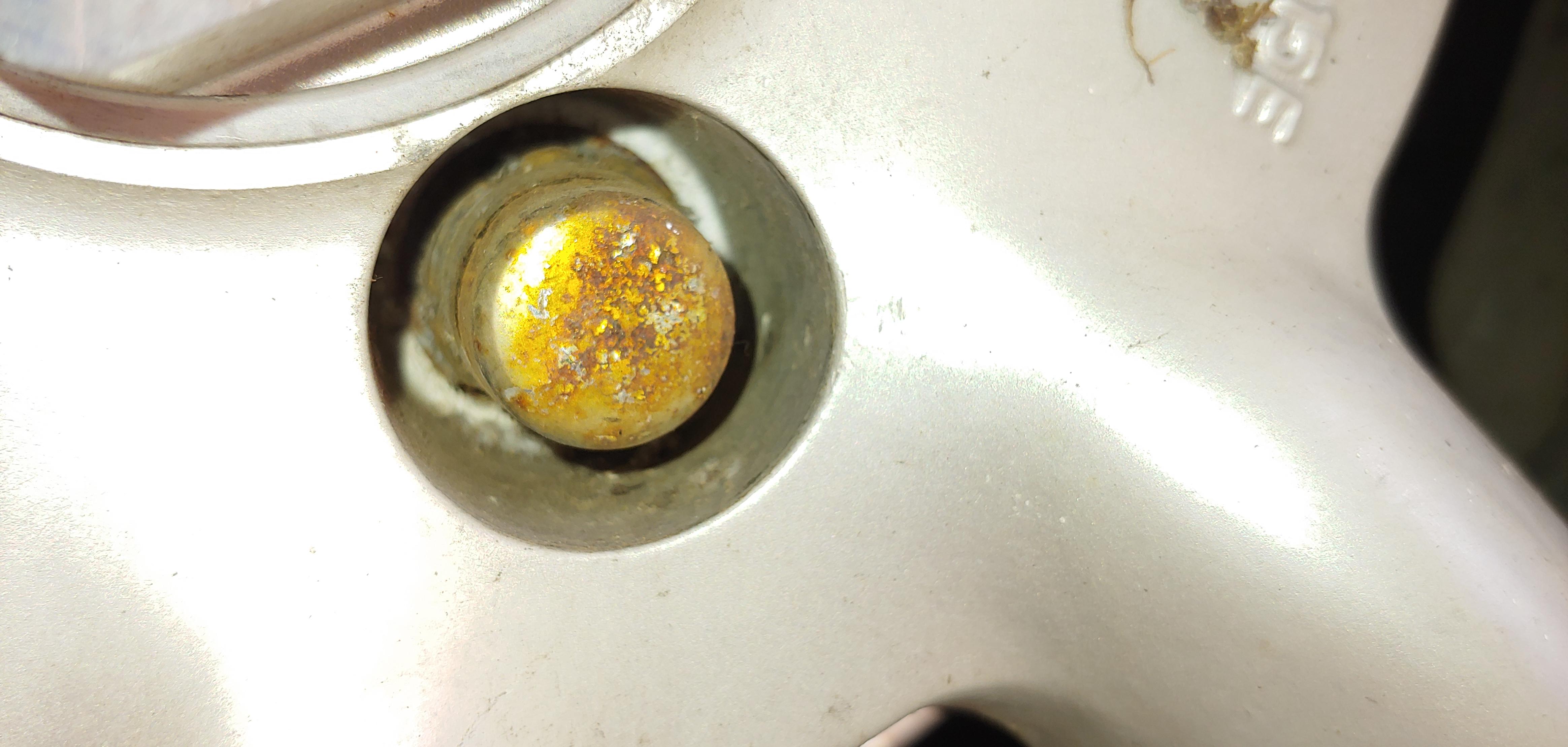

Having trouble removing wheels, without wheel lock key. Trying decide which lug key I need to buy. Anyone seen this style before???
20200421_180826.jpg20200421_180829.jpg20200421_180839.jpg20200421_180842.jpg20200421_180847.jpg20200421_180851.jpg
Hard to get good pictures, I may have to get a universal tapered style removal lug tool.

If you still have that panel off and haven't already done it, take your air gun and blow out the drain.  I bet yours is stopped up.  When it's open you can feel and hear air blowing out above the passenger's front tire.  Looks good!
I had a huge mouse nest in mine on the right side. The drain is rather large and empties out directly on the inside of the fender thus all the corrosion in that area on every S30 made.
