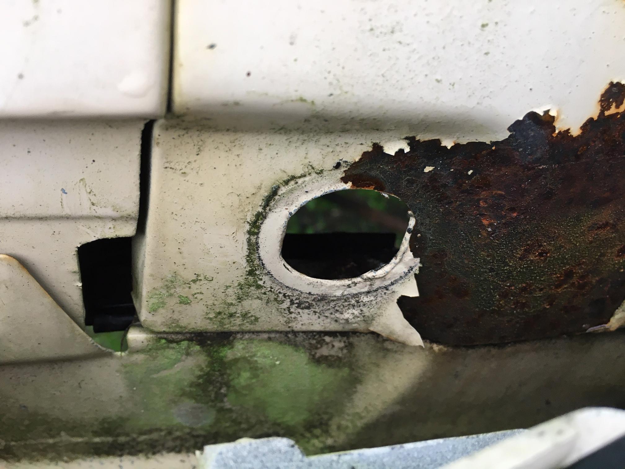

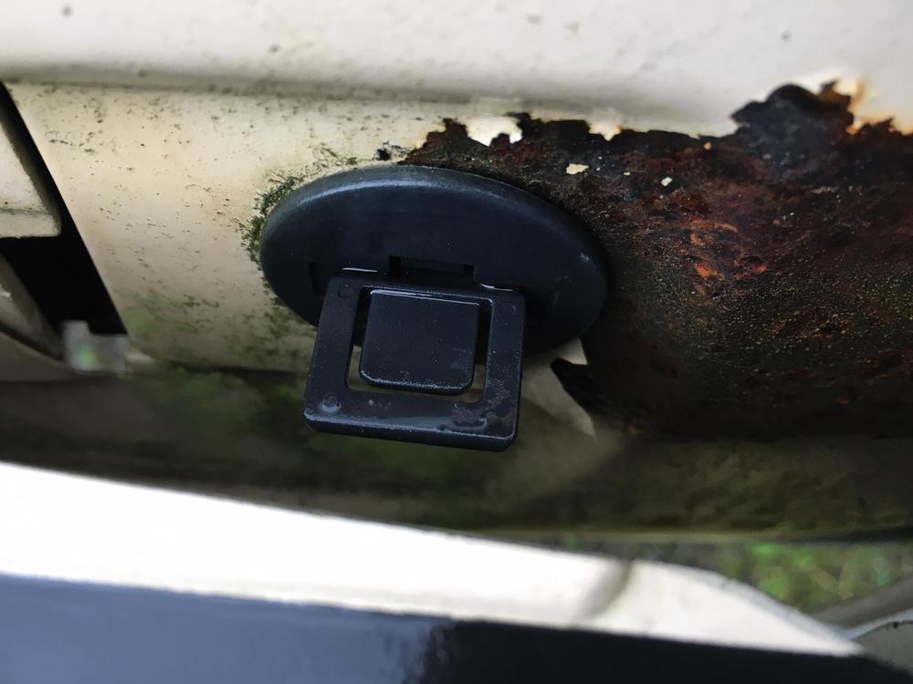

January 31, 20205 yr comment_591940 On 1/29/2020 at 11:31 PM, dutchzcarguy said: Today i'm busy with the front bumper indentations in the front fenders.. I can't see those in your pic's, are there indentations behind the end flaps of the front bumper (on the sides, the ends of the bumper) ?? see the right-under corner of the fender.. Maybe you can make a (close up) picture of your front left bumper side for me, it would be very nice! I think this is what your are referring to @dutchzcarguy? There is a large hole that takes a plastic plug which in turn holds the fender extension. There is an indentation like the one in your pic from above^ Pardon the rust, but it is a parts car. '82 Link to comment https://www.classiczcars.com/forums/topic/63500-new-guy/?&page=2#findComment-591940 Share on other sites More sharing options...

February 1, 20205 yr comment_591964 14 hours ago, Stang said: Mine doesn’t have a hole there. 12 hours ago, Terrapin Z said: a large hole that takes a plastic plug THANKS GUYS !!!!!! This time the right pictures, thank you very much! I didn't know that there was a plug in the big hole! It's not completely round i see now.. could be that the EU model does not have the plug, iv'e had 3 280zx's but never seen those plugs.. (i think i put in a normal rubber plug like in the floor..) My bodyshop guy will be very glad with those pic's, thank you! Link to comment https://www.classiczcars.com/forums/topic/63500-new-guy/?&page=2#findComment-591964 Share on other sites More sharing options...

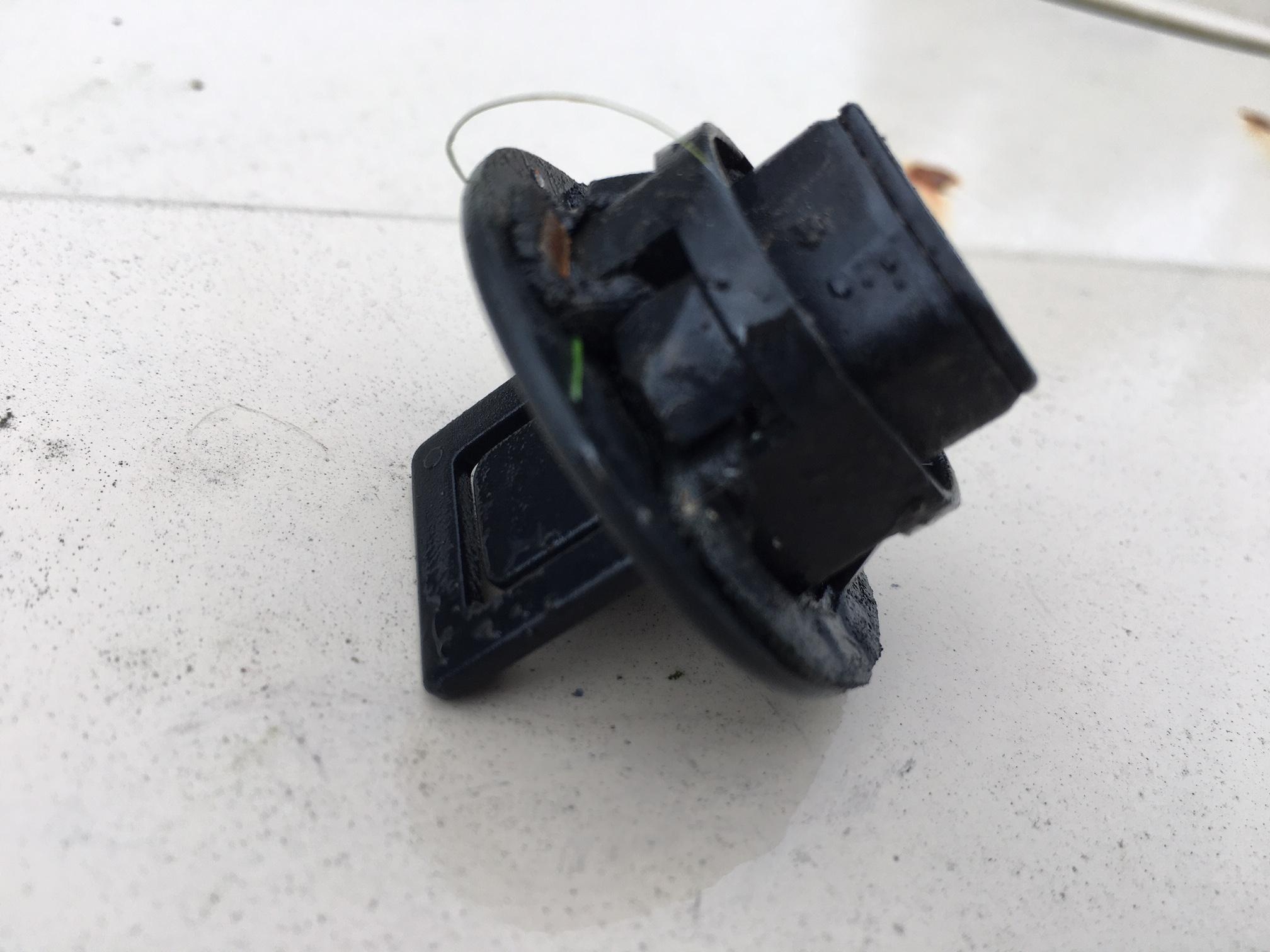

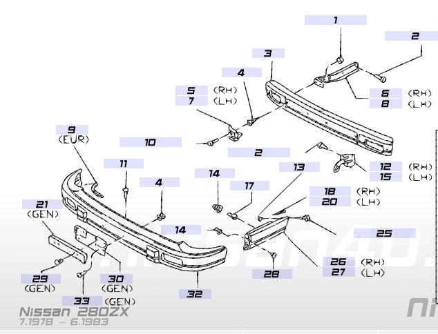

February 1, 20205 yr comment_591976 2 hours ago, dutchzcarguy said: THANKS GUYS !!!!!! This time the right pictures, thank you very much! I didn't know that there was a plug in the big hole! It's not completely round i see now.. could be that the EU model does not have the plug, iv'e had 3 280zx's but never seen those plugs.. (i think i put in a normal rubber plug like in the floor..) My bodyshop guy will be very glad with those pic's, thank you! There are two flat sides where the plug goes into the fender vertically, to orientate the plug so the clip flat parts are horizontal. The clips hold a tab on the fender extension. There are supposed to be two parallel tabs on these. One is broken off on this one. Look at your bumper piece and see if there is a tab there. I expect if your cars had the holes they should have the plugs. (Clip from EU parts parts manual) Both parts are discontinued. Link to comment https://www.classiczcars.com/forums/topic/63500-new-guy/?&page=2#findComment-591976 Share on other sites More sharing options...
