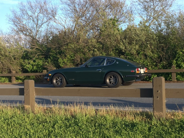

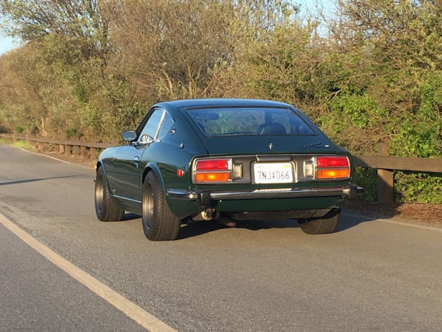

Hi Jeff, I haven't had any problems getting a socket in, I believe it's a 19mm but it's been a while since I've taken the wheels off. I typically use sockets with protectors on them in any case. I'm running 15X8 Watanabes (ET0) with 225/50-15 tires without issue although my fender lips and valence are trimmed. Camber is -3° front/-2.3° rear.

That looks really good!!! I love the Euro tail lights! What are you running for lowering? Coil overs, Eibachs...?

AGREED! Wow, your car is beautiful! Great stance too! Is that a 260? Love it! My old 73 240 was a similar color.

Thanks! It's on sectioned struts with Bilstein inserts and height adjustable coilovers. Camber adjustment is via bolt-in DP Racing camber plates, they've only got 4 discrete positions but they're well thought-out and compact. Plus, zero mods required on the body and I can still go +/- from the current settings. Don was great to work with as far as ensuring fit with the Bilsteins.
Thanks, appreciate it! It's an early 260, correct. The color is allegedly a Jaguar BRG but was originally "baby poo yellow", as described by the previous owner.

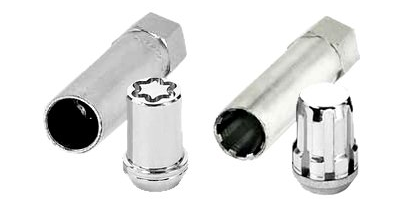

FWIW I have a set of Rota RB's on my 77, with a set of McGard lug nuts.  One is locking on each wheel.  Very high quality.
https://www.amazon.com/gp/product/B0006HOVJI?pf_rd_p=ab873d20-a0ca-439b-ac45-cd78f07a84d8&pf_rd_r=9R1Q7RP1KCPKPJHGNDT4
FWIW, I have a personal preference against locking lug nuts. Anyone with a common wheel lock removal tool can still get them off and for the 99.999% of the time that my wheels aren't being stolen, a special tool is needed to remove them for service. Wheel locks are also typically not impact gun friendly. My Z is parked in the garage and I don't typically leave it in places where there's a good chance it'll be put up on blocks. Insurance will take care of things out of my control. Everyone's situation is different, just providing a perspective.
