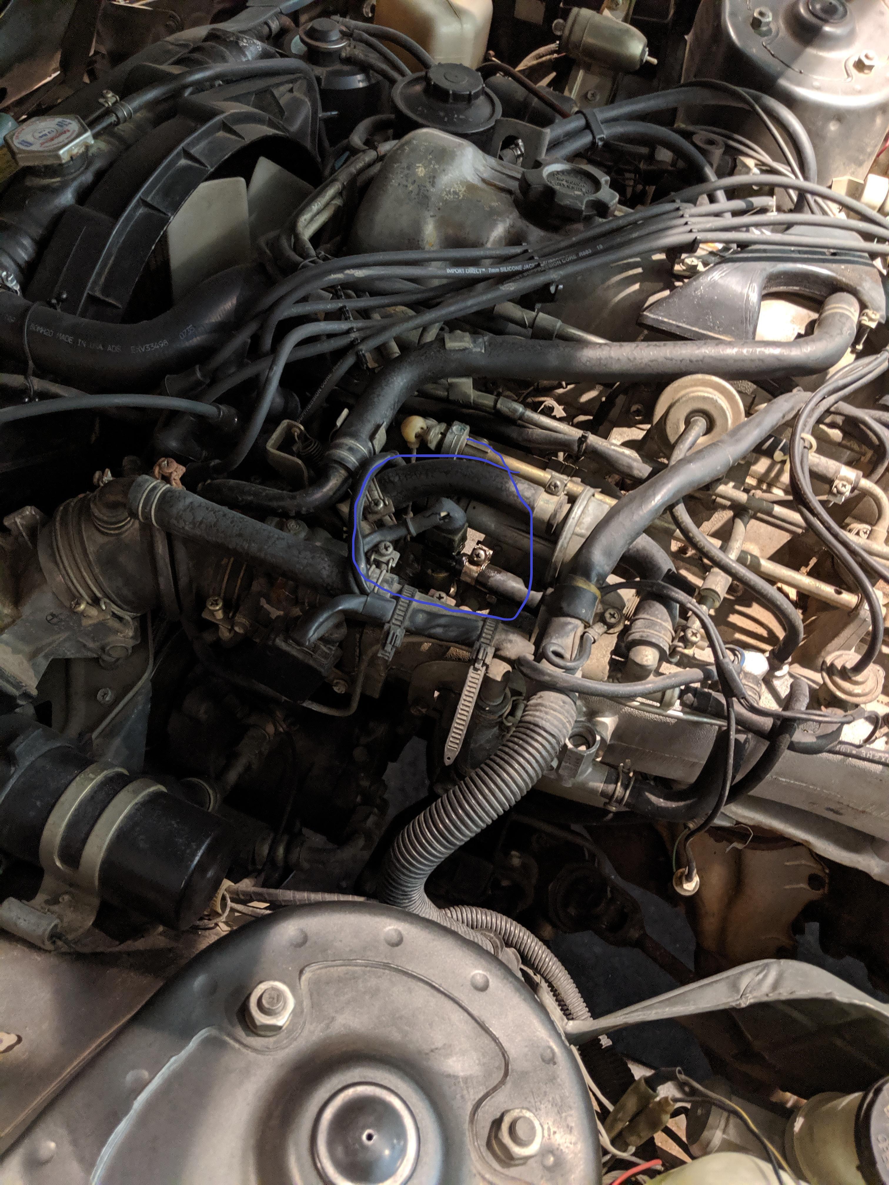

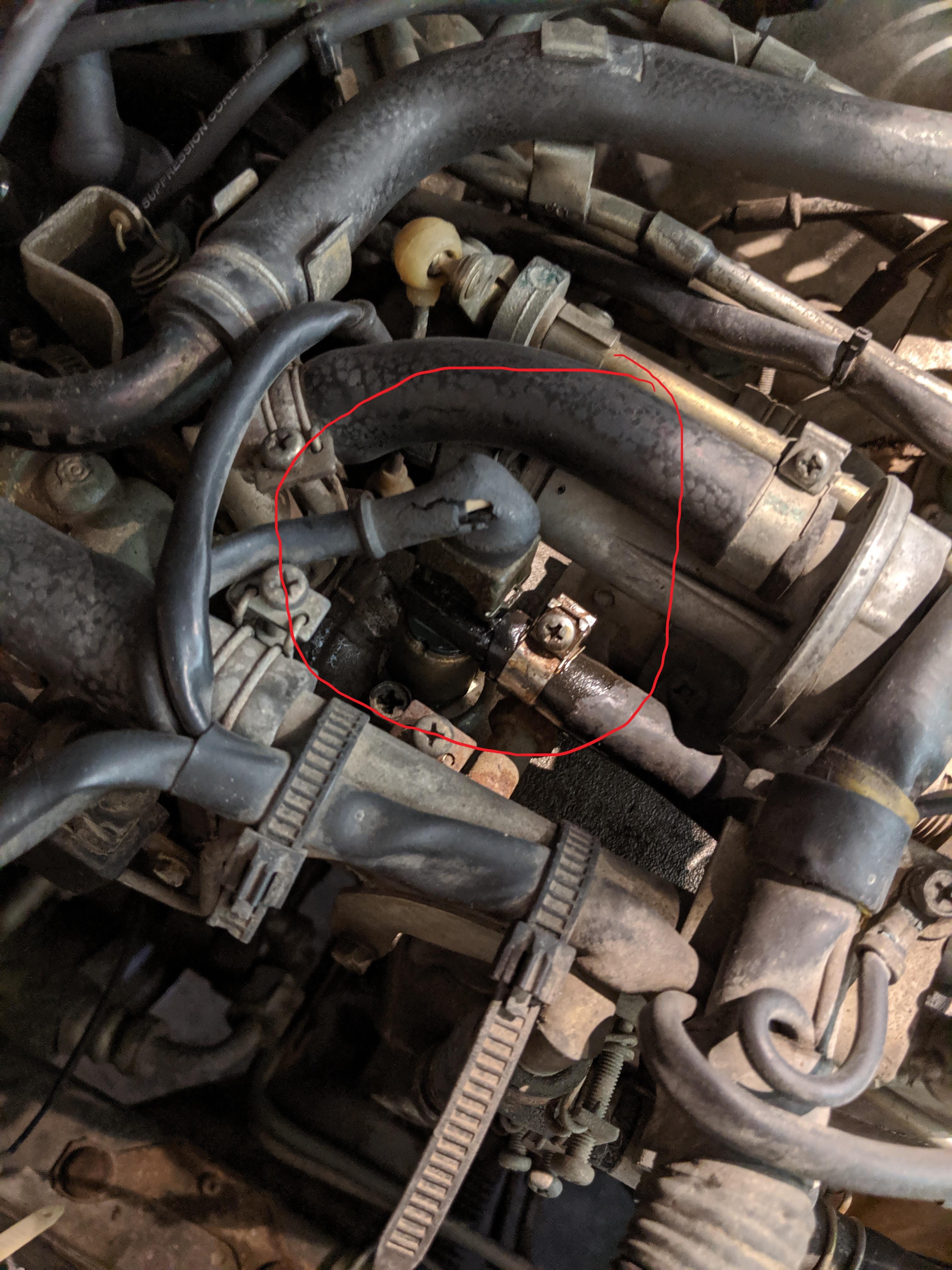

I have an 1983 280ZX. For a while it has been sporadic on starting. It will crank for a while and eventually start, but sometimes it takes a while. I have noticed the smell of fuel as well. I don't see any leak at the fuel pump and the fuel pressure regulator does not have fuel coming through the vacuum line either. The injectors don't seem to be leaking. This weekend while I was working on a separate issue I finally think I found the source of the leak - but I am not sure what the part is. Can someone take a look at the pictures and let me know what this is?
The part in question is the cold start valve but, that may not be leaking. From what I can tell in the pic the fuel hose is wet. So it can be the culprit. Try tightening the hose clamp and see if that takes care of it. If not replace it with the proper EFI rated fuel hose. And if that isn't it, it'll more than likely be the CSV
Could also be the result of hard "cold" start ups depending on how much fuel is actually leaking out.

Yeah I did clean my cold start valve (CSV) and after putting it back in, it leaked as well due to old hose/clamps (and because the previous owner not using FUEL hose here).  A quick trip to parts store to get a few inches of fuel hose (I believe the Inside diameter was ~8mm) and some new clamps fixed the leak right up.
You might be able to swap the hose without taking the CSV out of the intake manifold, but it's probably tough/impossible.  If you do unscrew and remove the CSV, there will be a gasket in there that you may want to replace.  Right now I'm running without a gasket: since the intake is under vacuum, I doubt it will leak fuel there, but it may let some extra unmetered air through ?‍♂️
