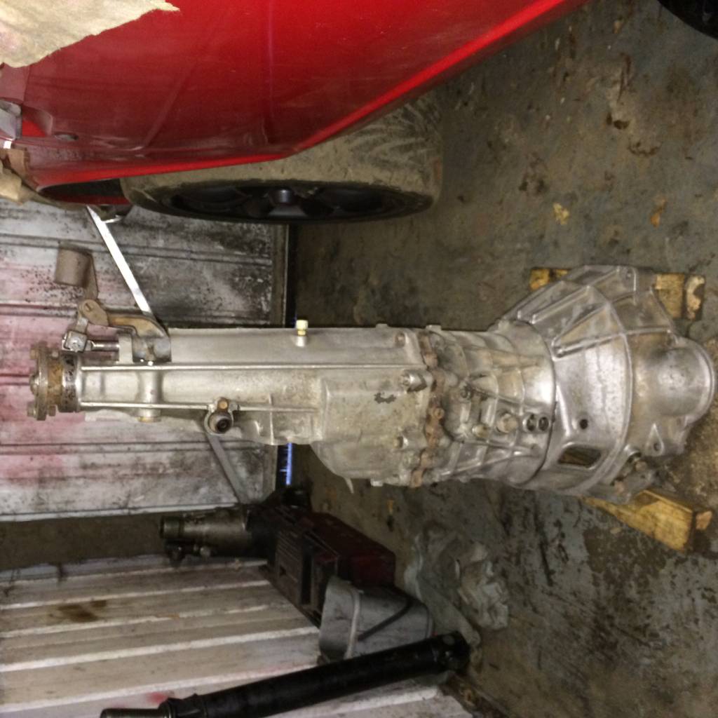

I'm starting to understand that the 71C:swap is not an option for me because my 71A-trannies are too old. I'm not 100% sure that neither of them is a 71B. How can you tell?
I think that those are 71B transmissions.  Your Europe market cars had 5 speed options throughout the years, we didn't here in the States.  Looks like one has a steel front cover (older) and the other has aluminum, from the casting shapes.
So you have several ways to get a 5 speed back together, but the wider/stronger gears only came in the later year 71C 5 speeds, somewhere around 1994 I think.
Are there teeth actually stripped off 3rd gear from too much torque, or are they just damaged from grinding up bits of metal?  The transmissions can fail in many different ways, one common way is for the adapter plate bearings to fail, letting the shafts move around.  What else as on the drain plug magnet?  Maybe you just have a worn out 5 speed, not an over-powered 5 speed.  You might not need stronger gears.
I think they're fs5c71b boxes. I'll dig out a pic of a fs5c71a shift linkage. It's quite different but anyway, the huge giveaway is that the case is in 3 pieces and the B boxes are in 2 pieces like the C boxes.
Edit: looked again and they've got brass synchros so they're fs5w71b

The photo is two 5 speeds, but are they both widd ratio 280Z or close ratio 280ZX? See "How to" doc on how to tell the difference.
How to - F5W71B Wide and Close ratio transmission.pdf
