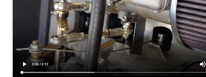

Need some Help... The issue I'm having is idle hanging up around 1500.  It will lower to normal (900 rpm) if I blip throttle.  Getting tired of doing that in traffic. Middle carb is hanging , but only when engine is running. Carbs open and fully shut very smooth when engine off. Vacuum holding plates open?. Maybe it has to do with the balance tube on the cannon manifold. all carbs have been rebuilt.  I swapped carb position and problem stays in middle carb.  I heard the cannon manifold suck.  Does anyone have some helpful info for me?  TIA.

@Zed Head  I have a cable set up, so pulling up on pedal does nothing for me .  I'll check again for air leaks. Thank you for your time
Hey @duffman  I tried removing the center post last year and it did not help at all.  Good luck. I just order a external spring linkage though pierce manifold (Search DCOE external spring on google) hopefully that solves it. If not I'm buying a new manifold.   I 'll let you know.
That tells you that the binding is at the throttle linage on the manifold, not at the cable or the pedal.  You can extend the the thought process and push on the linkage with your finger.  Open the hood and poke around and you'll probably realize something.
Your picture shows that you have quite a bit of slack in your cable.  Seems like a good tune of the overall system might help.  Lots of adjustable bits there.
