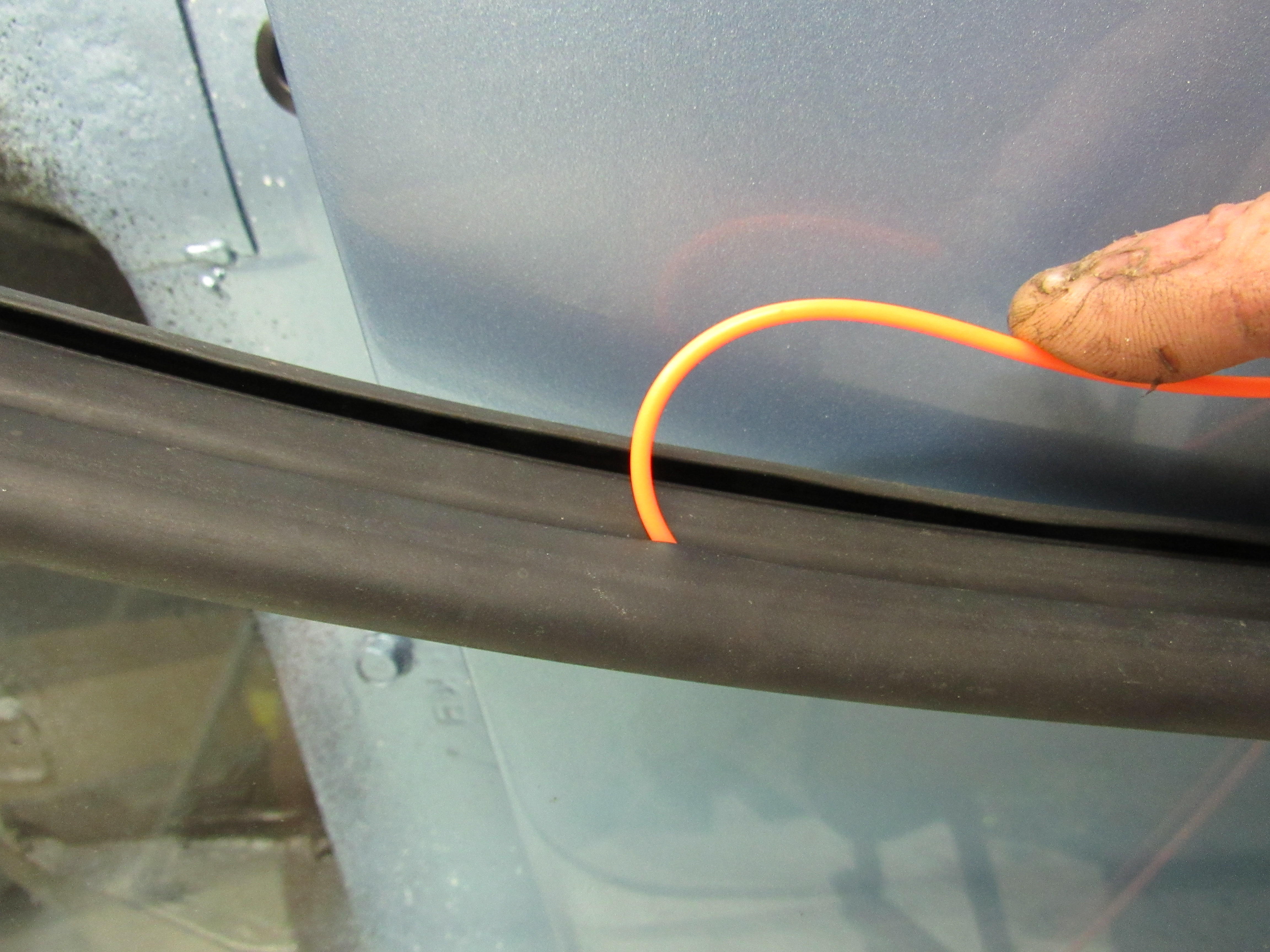

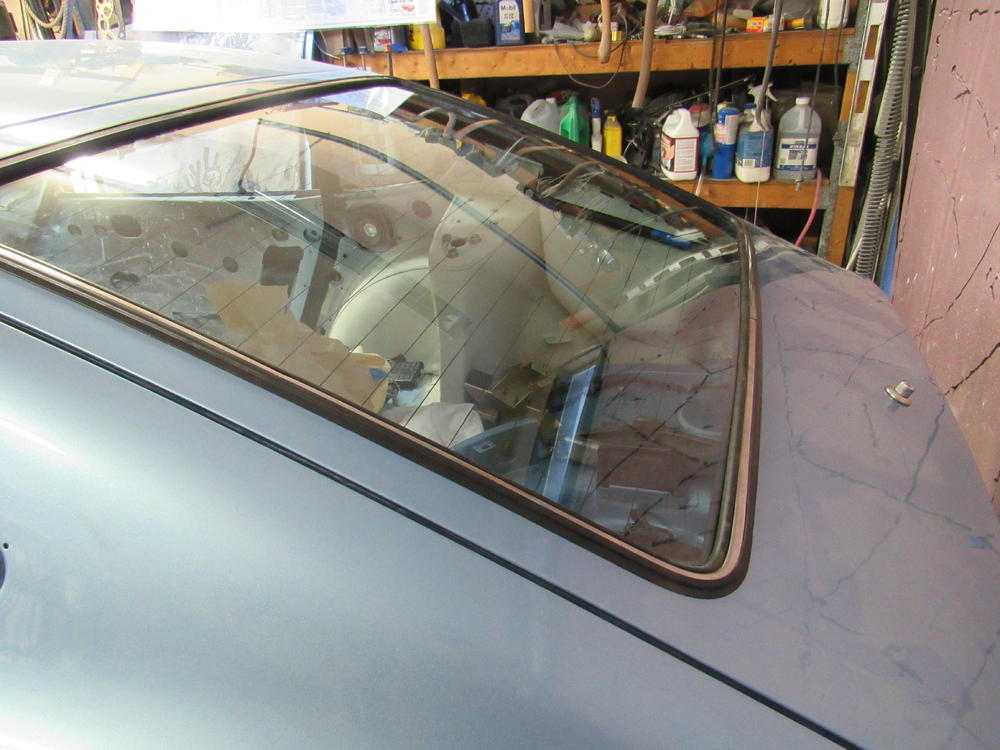

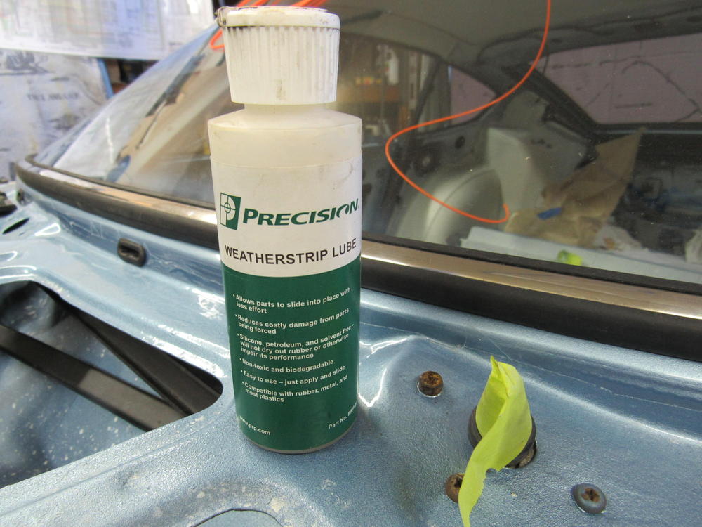

I use the lube from Precision, this is the third car I have used it on and still have more than half left, another benefit of the monofiliment  is with a bit of pressure you can just roll it into the chanel , just popped in the rear glass the this afternoon and will do the windshield tomorrow.
