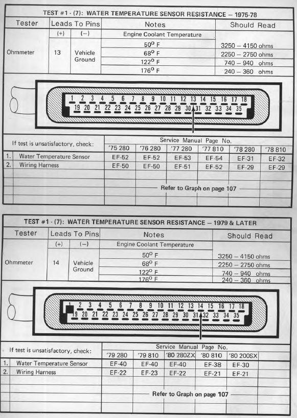

On 6/28/2019 at 2:31 PM, EuroDat said:
You could have a couple of issues that cauld cause an overfueling problem.
Most common are leaking injectors, leaking CSV or a bad temperature sensor or wiring going to the temperature sensor. The more resistance the colder the ECU thinks the engine is and compensates with more fuel.
You seem to be getting a lot more fuel than a faulty temperature sensor would allow, but doing the checks will confirm or dismiss it. When you check it, do the check at the sensor (sensor to ground resitance) and than again at the ECU connector (Connector pin 13 to ground resistance) They should be the same. Refer to the bible for the correct resistance for temperature range.
Note: Use the 1980 Bible. It is for all models 280Z, 280ZX en 810 Maximas up to 1980.
The other book is for the 1974 to mid 1976 models.
Does the battery have to be connected for the tests?
not for the test listed above, some test will have you set up for resistance, some for voltage. The resistance test, no battery. the voltage test will be battery and key on and sometimes key start.
The FSM will detail the setting for you. There is a start enrichment test that requires the battery connected and the key to the START position.
I was getting no reading for the resistance test is why I asked
