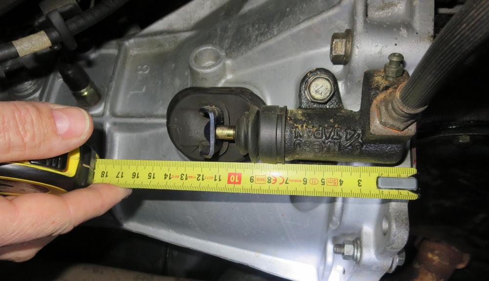

Measure the fork position in rest. From the front of the transmision bellhousing to the clutch fork should be around 115mm. If you measure 120-125 then the clutch fork will bind on the transmission housing before releasing the clutch.
Edited by EuroDat
Photo of clutch fork measurement

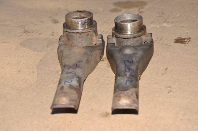

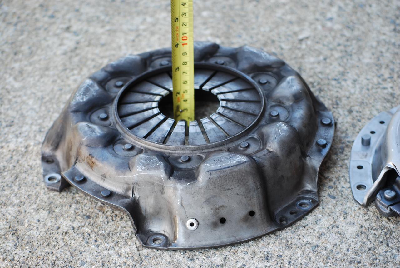

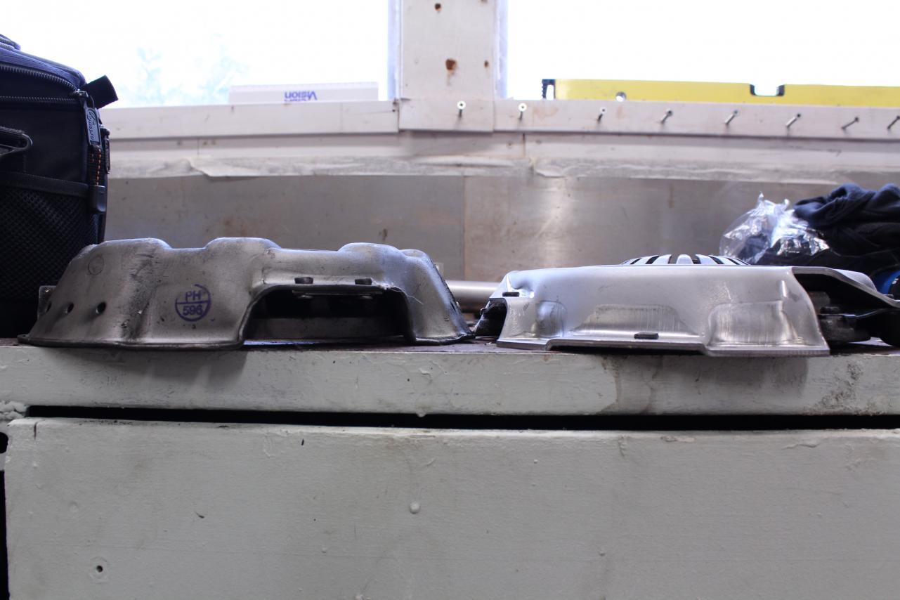

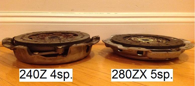

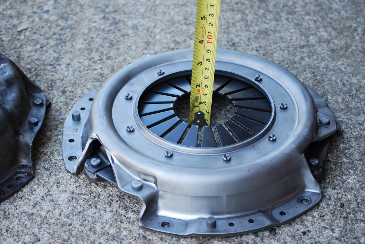

The problem is that the aftermaket industry doesn't really know the difference between all thedifferent models and pressure plates. 240Z up to 72, 240Z after 72, 260Z, 280Z and 280ZX up to 81, 280ZX after 81 and Maxima 810.
See attached photo's. Btw, They are not my photo's. Other people having similar issues.
