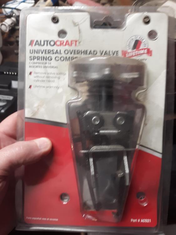

Can someone elaborate in the correct and safe procedure to remove the cylinder head and replace the broken or torn valve seals on cylinder 4? I watch a video on youtube of a guy inserting a rope inside cylinder 4 and a special tool to decompress the retainer spring. I guess its.better to remove the complete head. Also which gaskets will i need to replace?
I don't see the need to remove the head. Either way you'll have to come up with a valve spring compressor. IF, the compression is satisfactory in all cylinders, leave the head on. Removing it may open a Pandora's Box of broken bolts and studs. The rope in the cylinder and the lever action spring compressor is the easiest method of changing the seals. Watch several different videos until you can't find anything else to learn and then go for it. That's what I do.
I agree with Mr Maras. You are only focused #4 so I assume you'll pull the head for that one cylinder? I would take the easiest route and try the rope technique first. He's right you'll need a valve spring compressor. The first time I had to do that I bought a $15 from a chain store. It worked for me.
