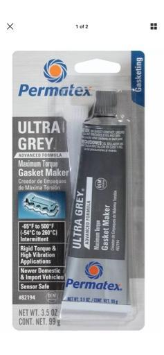

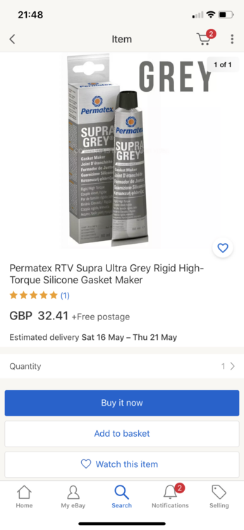

Neither of those are what I recommend for gasoline intensive applications. Both of those are the grey RTV silicone that I used to use everywhere before I discovered the MotoSeal. (The Ultra Grey is what they cell it here. And from what I can tell, the "Supra" (not Super) is what they call it elsewhere on the globe but it's the same RTV.)

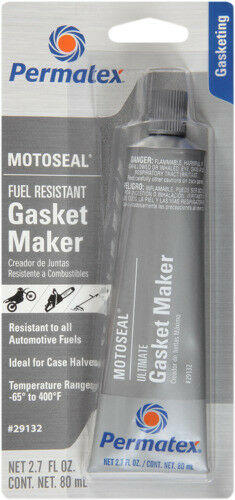

I took a look at ebay UK and found the stuff, but I didn't find anything IN the UK. It's all shipped from the US or Lithuania. I'm guessing they don't sell it in the UK.
Here's a pic from your ebay of the MotoSeal:

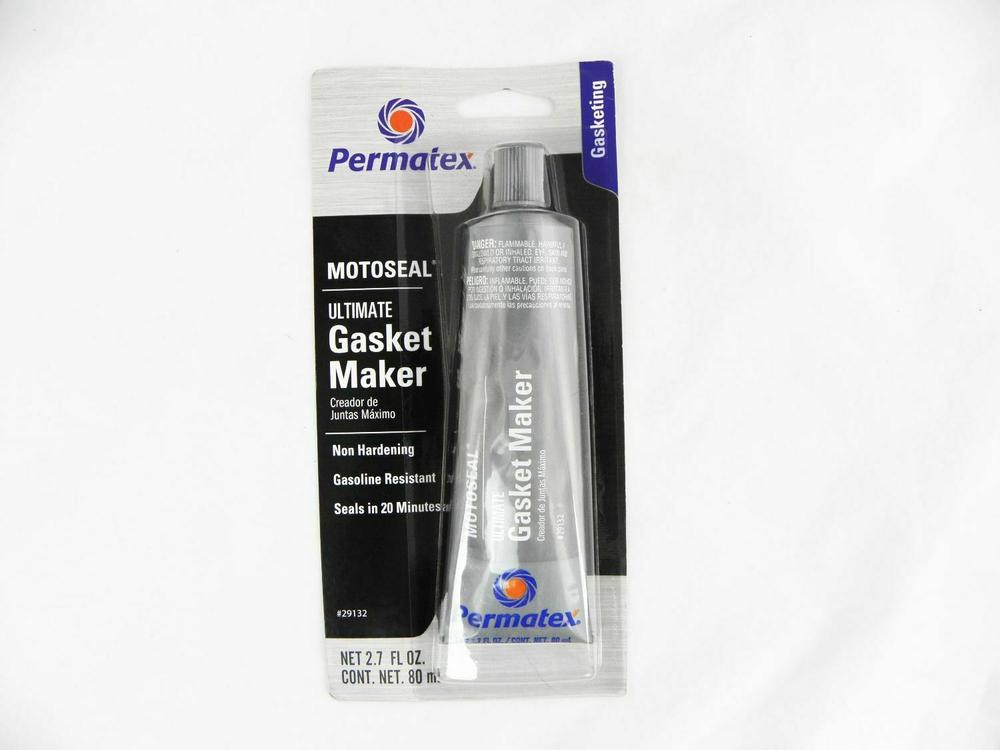

And another pic of the same stuff in a different package:
The trick is that the Motoseal is not an RTV (like the Ultra or Supra Grey stuff). Instead, it is a solvent evaporation cure based sealant and not a silicone.
Once the solvent evaporates, the rubbery solids remains are not particularly soluble in gasoline. According to the MSDS, it mostly uses the following:
XYLENE
2-BUTOXYETHANOL
ETHYL BENZENE
If you can't find that brand name, there's got to be something within your shores that is similar. Finding it is the trick though.
