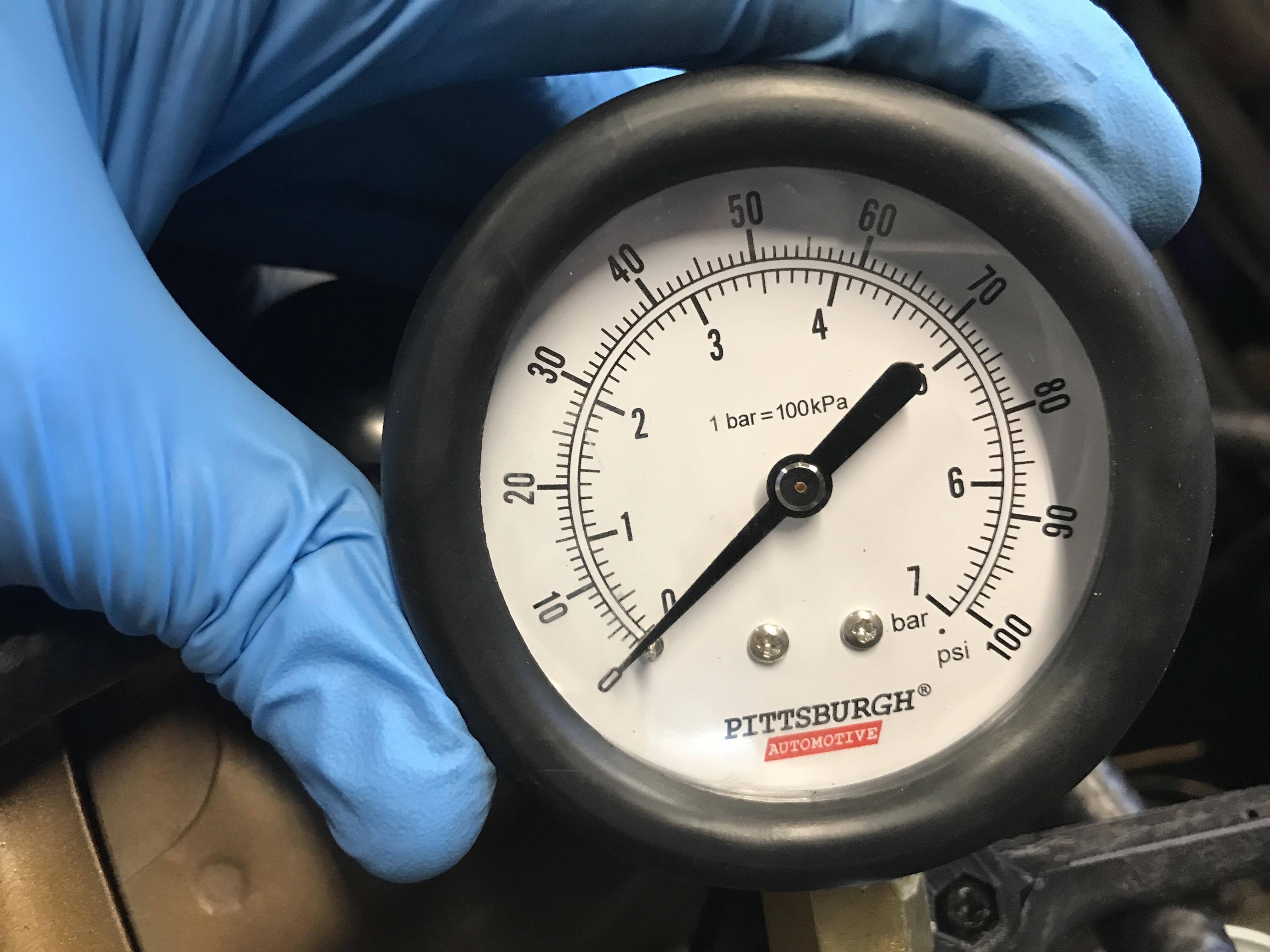

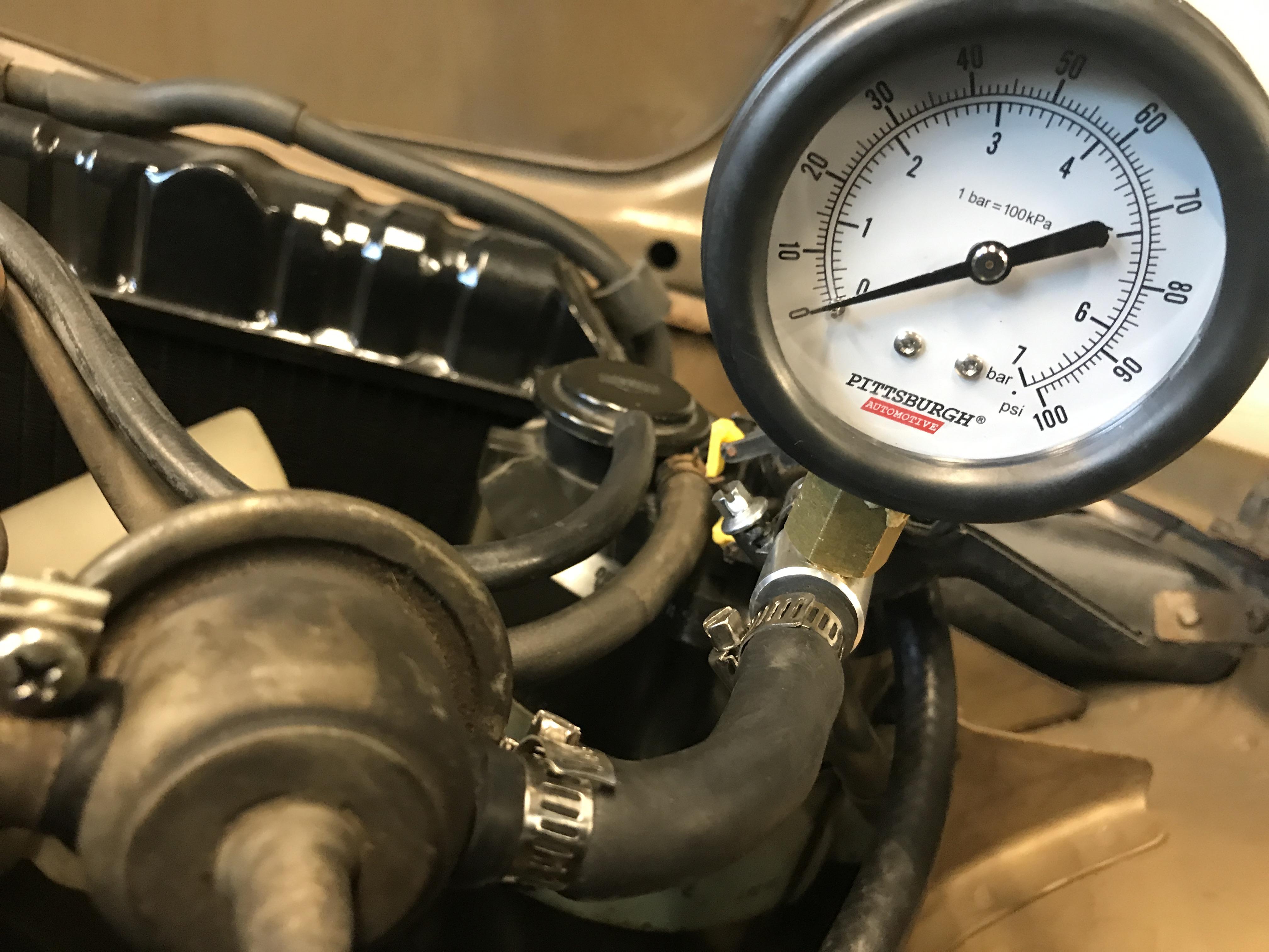

I think that we've all been just farting around with a bad gauge the whole time.  Pittsburgh is a Harbor Freight brand.  It's been fun.  I have three gauges in my garage, two good ones and bad one (but with a known offset).

Actually it's a sign of inconsistency.  The gauge was stuck at 3 for a while, then it's at 0.  It fits the overall randomness of the readings from that gauge.
OK so as to the gauge and it's consistency..... I GET IT.
I will borrow one from Pep Boys tomorrow and see if I get different results.
Flogging a dead horse on that point.
24 minutes ago, mbz said:
Again......
You're not really winning anything by showing that your previous posts were unclear.  You're just showing that what I said was right.  The needle stop is zero.
