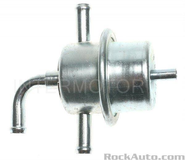

April 9, 20196 yr Author comment_572964 54 minutes ago, Patcon said: I have a NOS 22670-F5101 sitting in front of me if you are interested. I believe it is what you are looking for but confirm that I looked up that part number, and while it is for a Datsun Z car fuel pressure regulator, I cannot match the part number with any known part numbers for the FPR on a 1976 280z. The corresponding part numbers I could find are: Alternate/OEM Part Number(s): 13531260789, 22670N09800, 22670N4200, 22670N9800, 22670N9801 Does it look like this...? Edited April 9, 20196 yr by mbz Link to comment https://www.classiczcars.com/forums/topic/61841-1976-280z-engine-runs-rough-then-dies-will-not-idle/?&page=15#findComment-572964 Share on other sites More sharing options...
April 9, 20196 yr comment_572965 1 hour ago, Patcon said: I have a NOS 22670-F5101 sitting in front of me if you are interested. I believe it is what you are looking for but confirm that That's for the 78 280Z and 280ZX's. One inlet.  Link to comment https://www.classiczcars.com/forums/topic/61841-1976-280z-engine-runs-rough-then-dies-will-not-idle/?&page=15#findComment-572965 Share on other sites More sharing options...
April 9, 20196 yr comment_572966 Zed is correct, only one inlet Link to comment https://www.classiczcars.com/forums/topic/61841-1976-280z-engine-runs-rough-then-dies-will-not-idle/?&page=15#findComment-572966 Share on other sites More sharing options...
