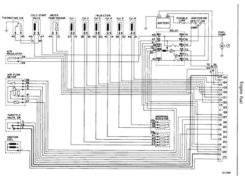

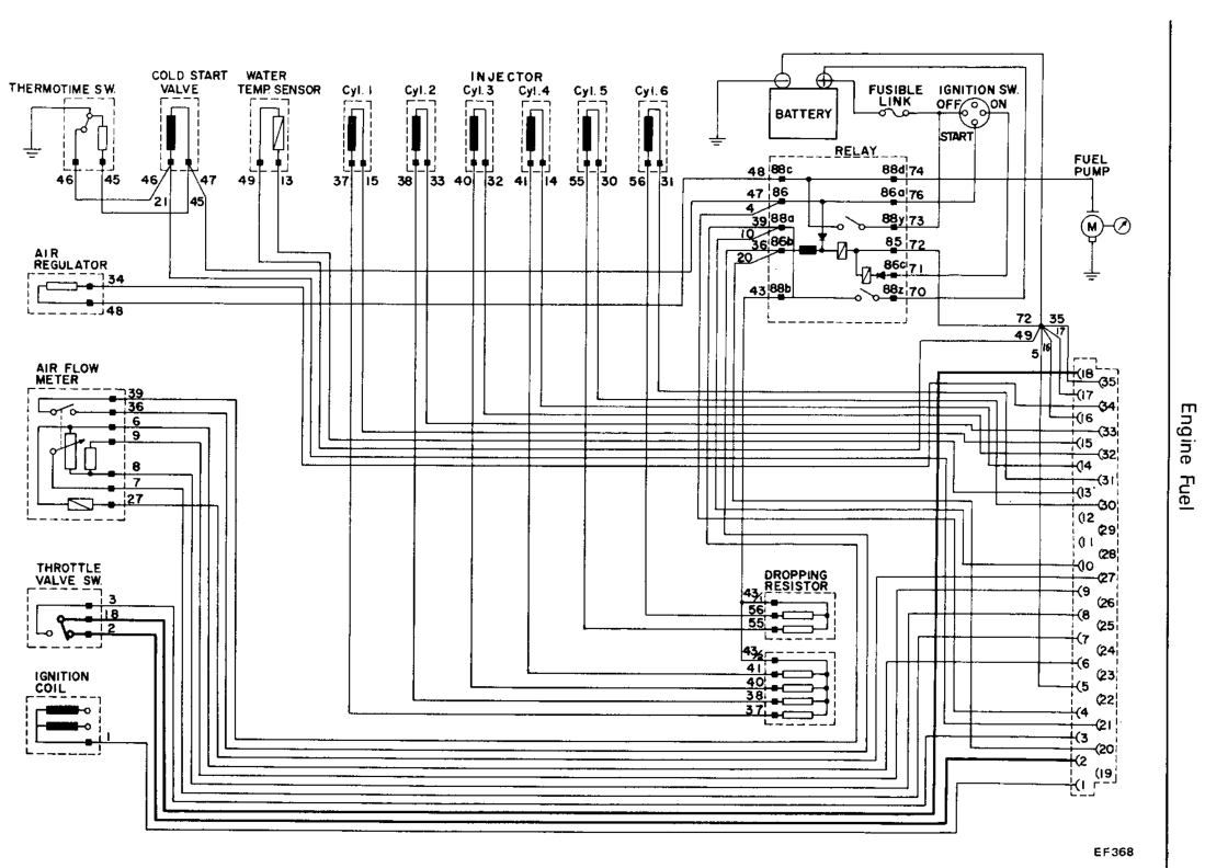

April 26, 20196 yr comment_574204 1 hour ago, Dave WM said: will look for it in the FSM, so its just a resistor from the - coil side same circuit that goes to the pin 1 of the EFI?. Its odd it like the richness to run but the 4 for the plugs look pig rich. 2 looked fine. Not sure how exactly it would explain your problem but if I recall correctly, power is supplied in banks of 2 and 4 and grounded in banks of 3. Although the diagram numbers imply 4 and 2 for grounding also, at least by the wire numbers. Can't remember for sure, CO knows. If the problem is electrical it might follow the plugs. Maybe switch a "fine" one for a rich one and see if it stays or follows. I used the funky looking factory resistor, with the two bullet connectors. I think it's 2.4 kOhms. Link to comment https://www.classiczcars.com/forums/topic/61835-engine-test-stand/?&page=6#findComment-574204 Share on other sites More sharing options...
April 26, 20196 yr Author comment_574208 I need to be more detailed to track exactly which plugs are fouling (beyond 4 of the 6, more like exactly which 4) so will do that to better follow the plugs. I know that resistor, I can measure it on my car, its the one that is located in the passenger side under dash correct? Something I noticed, the bad exhaust leak at the #6 (looks like a chuck of the gasket must have blown out). I reused an older gasket, I wonder if I have over leaks including intake or even leaks from the exhaust to the intake... Before I get too deep I am going to put a new gasket in there. will recap the issue good compression on all cylinders (160-165) all injectors firing what seems to be about the same (visual inspection with rail pulled and cranking engine to observe). new plugs that will quickly foul (4 of 6 that is) soft black carbon fully coating the entire plug after minutes of running all plugs sparking spark looks normal compared to normal operating engine fuel pressure 38 no vac 30 at about 18inHg (observed when car idle is managed) throttle position sensor tested at 36 pin (on at idle, off until about 1/2 then on again to full throttle) timing unsure but moving dist within range of adjustment helps depending on RPM (idle or throttle up). Seems to require very rich to start (often will only start after CSV fire even when warm) when it starts is missing badly like only running on 3 much throttling and messing with the AFM flay and it will suddenly "catch" like at least 5 or maybe all 6 will light off, from there you can throttle down and idles smoother, not perfect but much better. all this is with the water temp sensor disconnected. connected and it will not idle but will run throttle up just fine WTS tested at the 36 pin connector pin 13 and ground tracks resistance to temp in spec with the FSM. all unused vac ports are sealed (brake/carbon canister). all test for voltage and resistance of ECU done at 36 pin connector in spec per FSM AFM known good unit and tested again( 100 ohm and 180 ohm tested, air temp resistance tested, voltage divider circuit tested with 9v battery and analog meter, no breaks normal looking sweep) ECU known good unit. All this leads me to a air leak issue of unmetered air, and the only place I can think of is that junction of the manifold to the head. What really baffles me is the super rich running condition per the plugs yet leaning (water temp sensor plugged back in) will kill the idle. I was focusing on the water temp sensor and the throttle position sensor but they test fine. one more observation, I don't notice any extreme black smoke while running, that's very subjective as to what it should be but you would think it would be very noticeable. Link to comment https://www.classiczcars.com/forums/topic/61835-engine-test-stand/?&page=6#findComment-574208 Share on other sites More sharing options...
