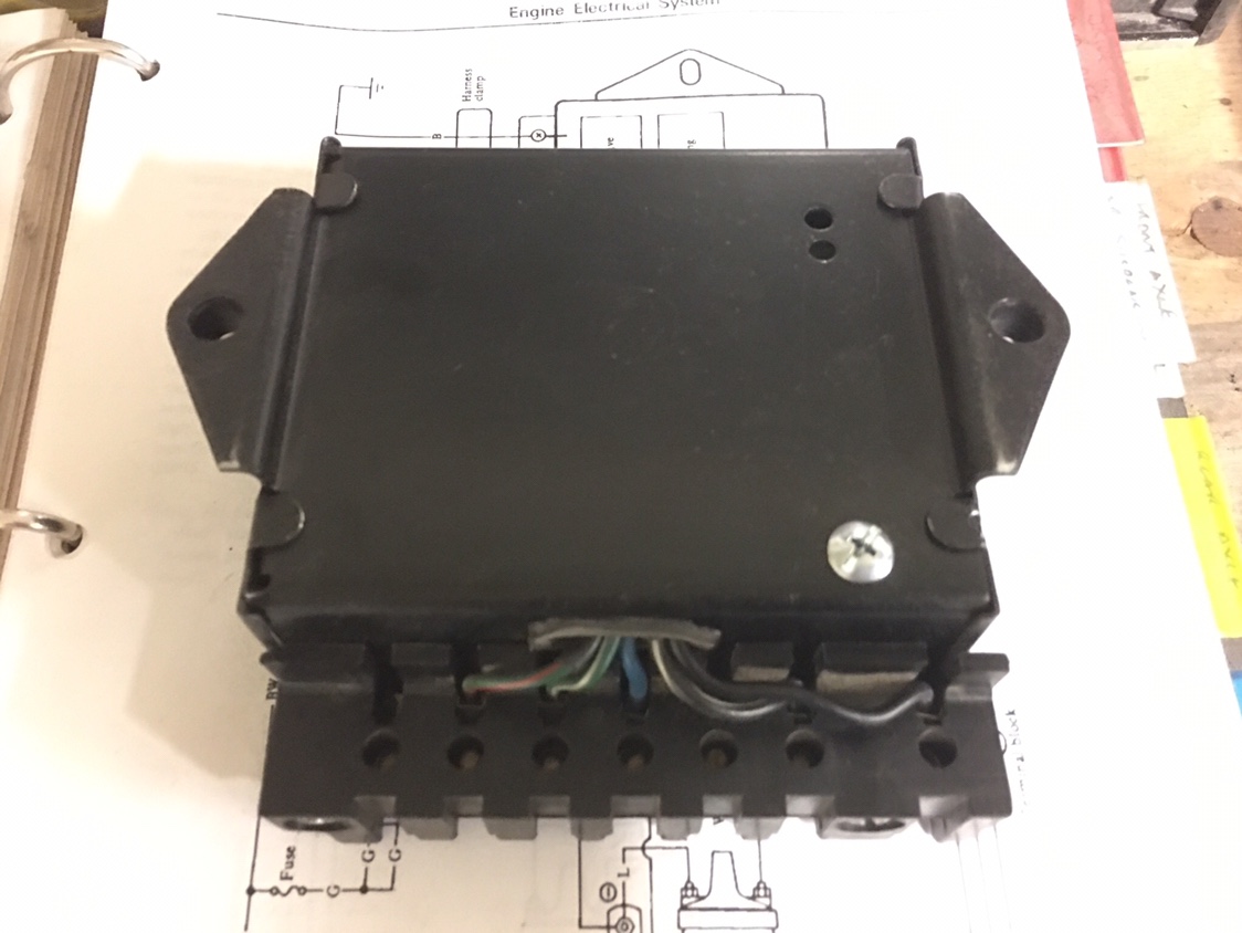

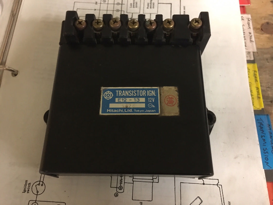

Selling my freshly modified 1976 electronic ignition box that has been discreetly modified with a modern GM HEI ignition system.
Since I am going Haltech and Coil on Plug, this system is no longer needed.

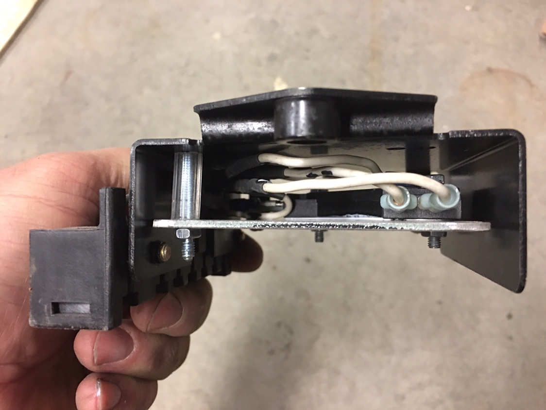

I built this from plans available in this forum using a GM style HEI ignition. Everything is tucked inside the case and looks stock for the purists!

Btw. It will work on all of the 280Z TIU systems up to Aug 77, it only needs one pickup. After Aug 77 they changed the terminals to a plug connector.

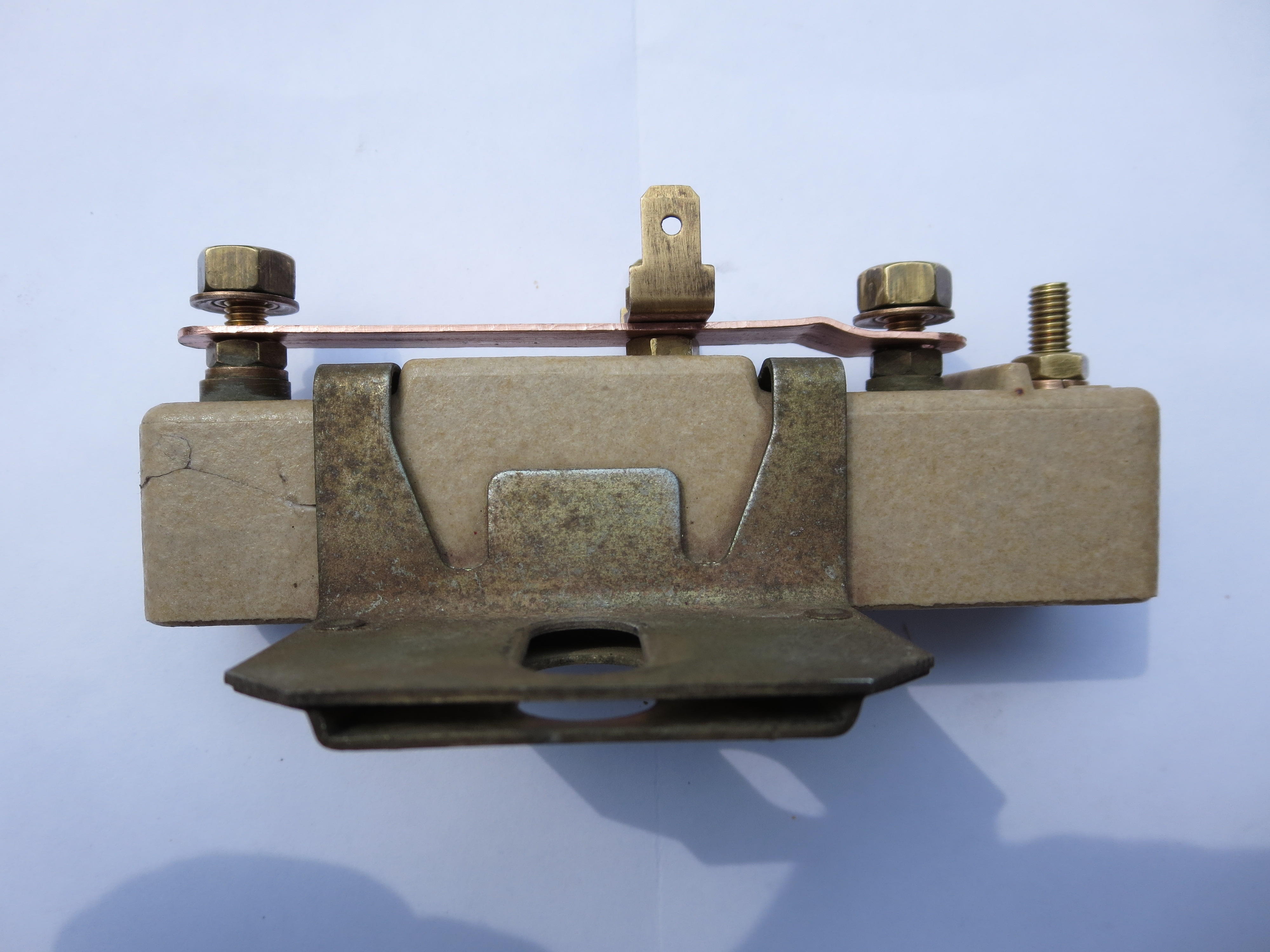

So one of the big advantages of using that GM HEI module is that you can remove the ballast resistor which results in a hotter spark, right?

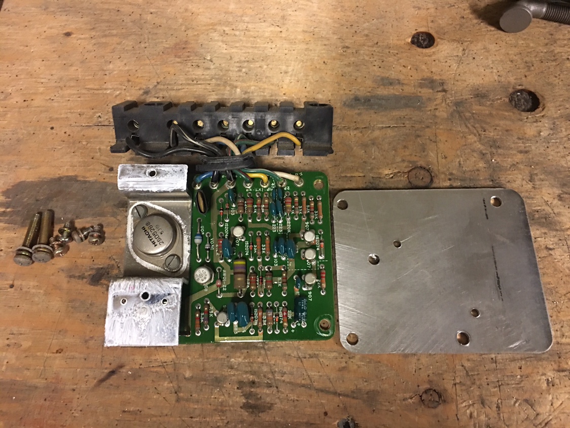

That is correct. Hotter spark, more reliable spark, less complicated circuit. The board I removed was full of resistors and old discrete components.
The heat sink plate is shown to the right. The holes locate the GM part and then bolt to the case. Heat sink paste in between.

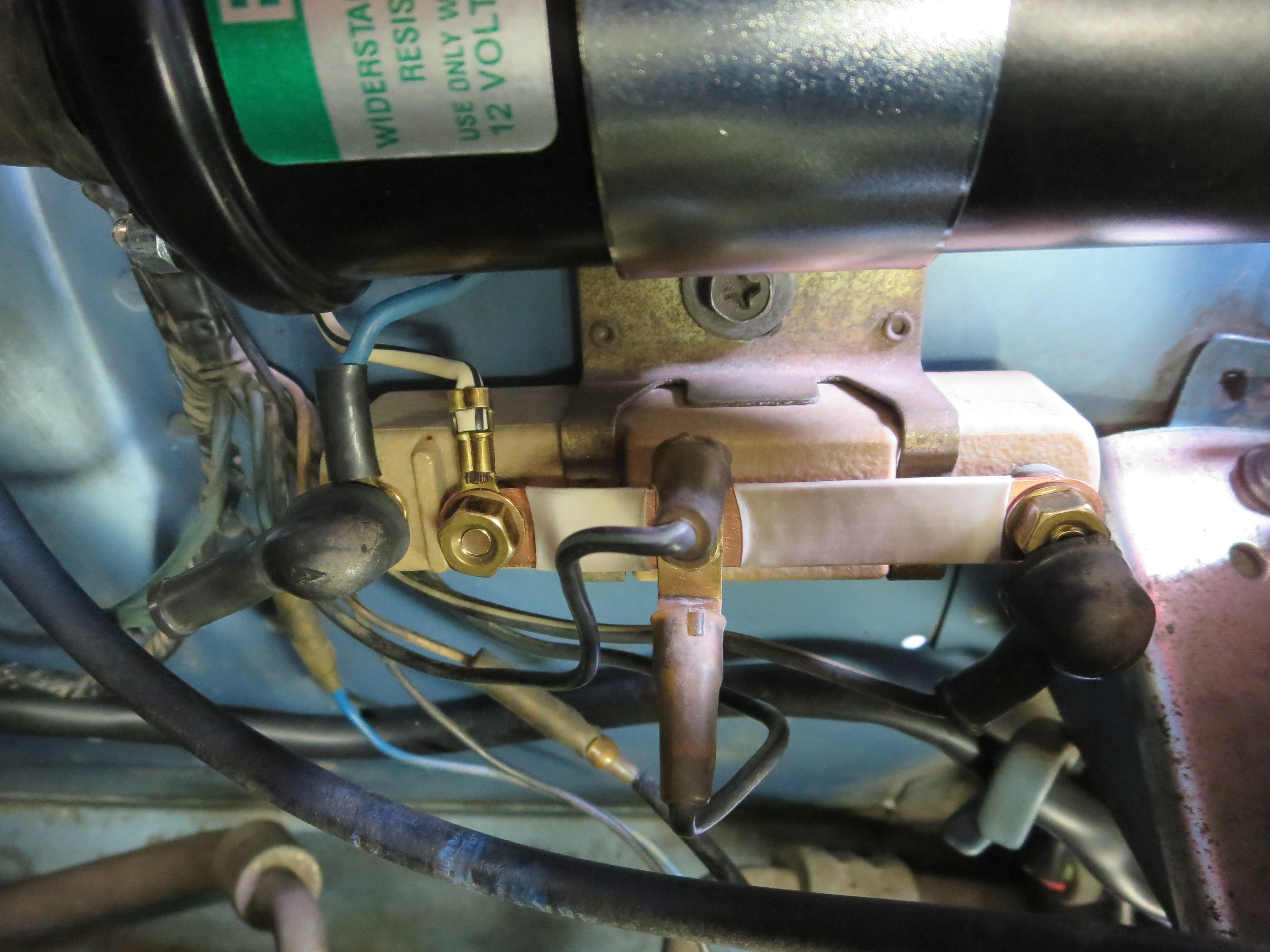

Yes, I left everything (Ballast resistor) intact and bridged it over so I could use a 12v coil when I did mine.
The coil in the photo was the old resistor coil, whicjh I changed shortly after the photo.
