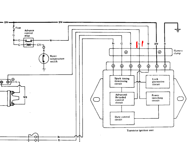

For the 260Z and 280Z, the reluctor in the distributor triggers the TIU. The TIU completes the path to ground that causes the energy stored in the coil to be released to cause a spark. This circuit for grounding is monitored by the tachometer for the pulse needed to indicate the RPM of the engine. In order to get the tachometer to function properly, you would have to modify the wiring so the wire that the tach uses to monitor the TIU is monitoring the ground leg of the Crane.

SteveJ is asking about the ignition module that your 260Z came with.  It's the finned aluminum thing by the fuse box.  The blue wire needs to be disconnected from it, at least.  Might as well disconnect all of them.
