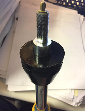

One of the projects that has suffered with the current situations is making a picture-gram of how the pieces go together on the strut just to add clarity. The sleeve and the bump stop go together like this image I took. I believe this was also described early on in this thread, but I never made it to making that diagram/image. Sorry about that. I'll make a real one soon with all the pieces.

Thank you also for validating the bump stop / spacer bushing orientation. Would be interesting to see how others find it - when I experimented with that orientation, I found that the bump stop would be crushed against the spring top hat when the whole thing is torqued up and I wasn’t sure if that would reduce it’s lifespan.

The steel bushing orientation was not discussed earlier in this thread , that’s why I posted the question . AK260 showed what he did for orientation , which seemed to make sense , but now you show the bushing flipped the other way . It would seem to me that AK260 has it correct to extend travel of the bump stop . It would be nice to get some clarity from KONI .
