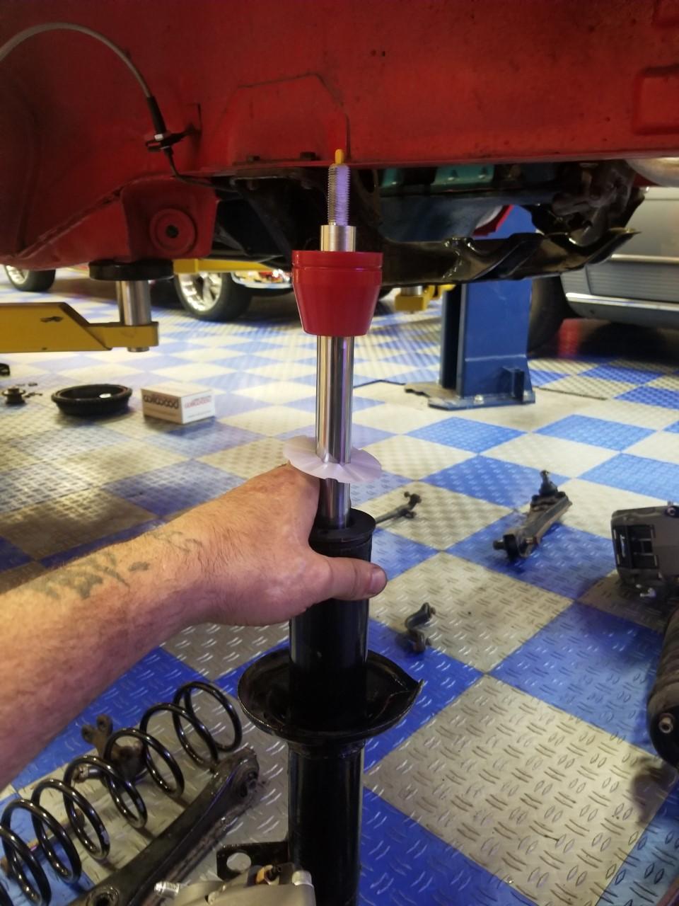

April 28, 20196 yr comment_574415 can i trouble anyone to tell me if i have this done correctly. i followed the directions as best as i could make them out. i was unable to finish because i needed a spring compressor for the Eibach's so i figured i would double check. gland nut gap is 3.3mm Link to comment https://www.classiczcars.com/forums/topic/61542-koni-sports-for-classic-zs/?&page=10#findComment-574415 Share on other sites More sharing options...
April 28, 20196 yr comment_574420 Now is the time to install a bellows or boot to protect shaft. I've never seen that white plastic disc before, what does it do? Link to comment https://www.classiczcars.com/forums/topic/61542-koni-sports-for-classic-zs/?&page=10#findComment-574420 Share on other sites More sharing options...
April 28, 20196 yr comment_574422 i dont know what its purpose is. it was in the package with the gland nut and other small parts. that placement is what i took the instructions to say. Link to comment https://www.classiczcars.com/forums/topic/61542-koni-sports-for-classic-zs/?&page=10#findComment-574422 Share on other sites More sharing options...

April 29, 20196 yr Vendor comment_574493 Those white plastic rings are called "bump plates" and they are intended as an extra layer of protection for the piston rod seals for when the car compresses fast enough for the bump rubber to make contact with the end of the damper body. The bump plates have two different designs, one a closed ring with a somewhat waffle shape and the other are flat and C shaped with a gap in one side. Because bump rubbers are round, fast moving, and soft to compress, it is defintiely possible for a bump rubber impact to the top of the strut to drive a puff of compressed air and possibly some road grit into and past the seal lip and into the damper. The waffle or C shape gives a path for this to just blow out to the side and help protect the seal that much more. Because KONI dampers are expected to last a very long time, some extra seal protection can be helpful for longevity. After tightening the gland nut, the first step of reassembly is to just drop the bump plate ove rthe piston rod then reinstall your bump rubber, dust cover, etc. The Miata forum thread calls the bump plates "packers" which is a relatively common name from the Oval Track Racing world where you might stack several of them to make bump rubber contact happen sooner for a number of possible reasons but you also risk handling and tire grip issues as well. The comment about them being related to an old, multi-piece style of piston rod seal is something that the poster has made up themselves. Yes, in the early to mid '80s there was a change in the seal design (I talked about ti earlier in this thread) but bump plates having some involvement with that is just someone interjecting their own assumptions. I have explained the bump plate installation and usage many times over 23 years but never heard that one before. Link to comment https://www.classiczcars.com/forums/topic/61542-koni-sports-for-classic-zs/?&page=10#findComment-574493 Share on other sites More sharing options...
