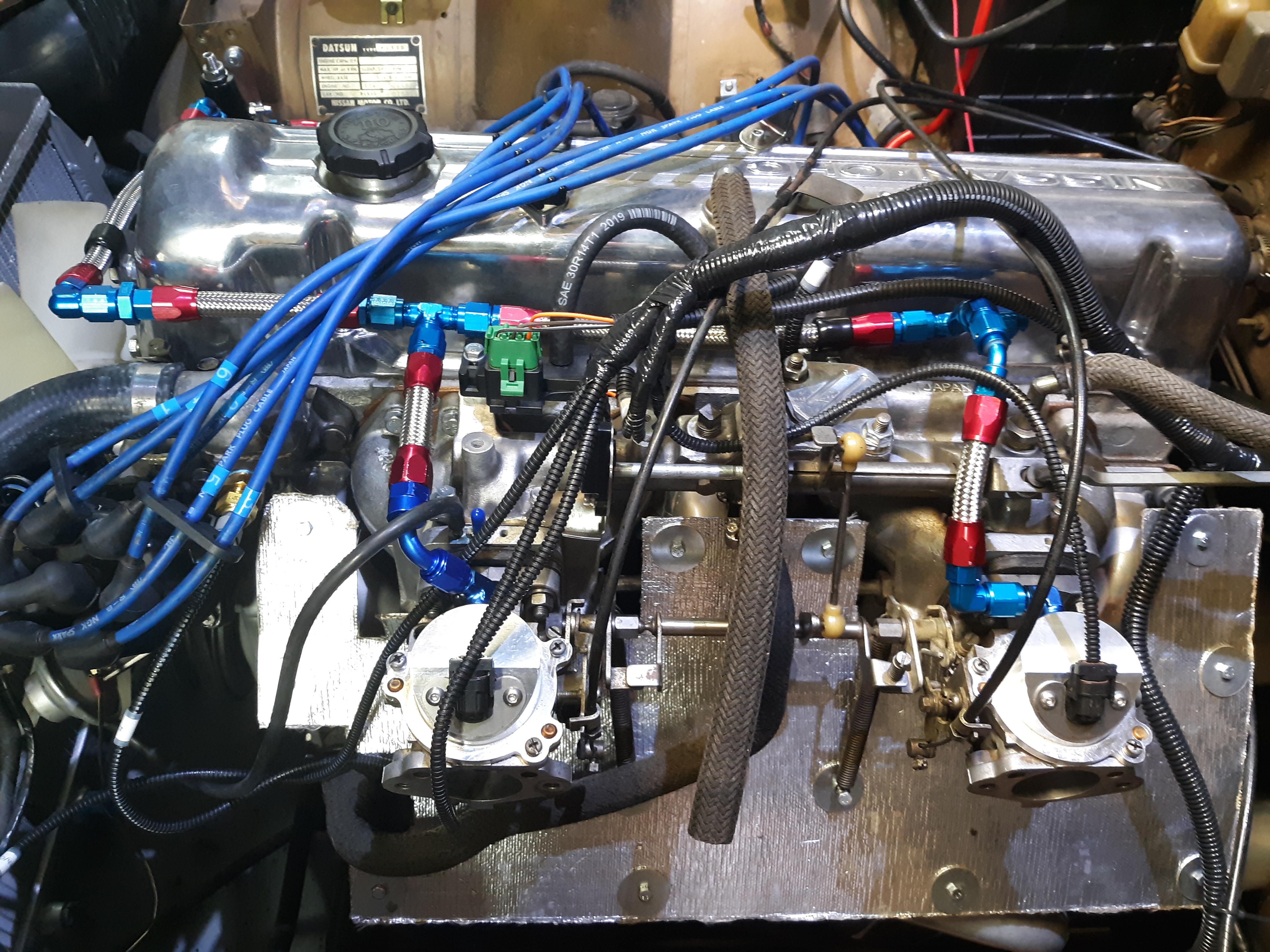

I also don't like how the fuel lines ended up at the TBI adapters.
Look at the bend in the line at the front throttle body. (I almost typed "carb".) Rick confirmed the fittings are 1/8 NPT, so I ordered 1/8 NPT to 6AN 90 degree elbows. Then I'll put another 90 on to point to the fuel rail. Hell, I have plenty of braided hose, still.

I got 6AN to 1/8 NPT fittings to replace the barb fittings on the TBI adapters. I could not put the back throttle body fitting at the angle I wanted because it was hitting on the base of the adapter before it was to the point I wanted, so I compromised. It looks a little kludged, but it doesn't leak. (If it looks stupid but it works, it's not stupid.)
