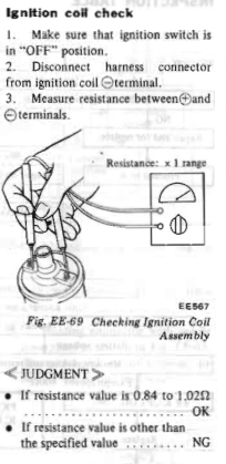

Your simplest route to best performance from the system is to download a 1979 FSM and match the coil specs, and spark plug gap.  A stock 00.84 - 1.02 ohm coil will give better performance than a Flamethrower probably.  Nissan balanced the parts, the module and the coil, for best performance.
