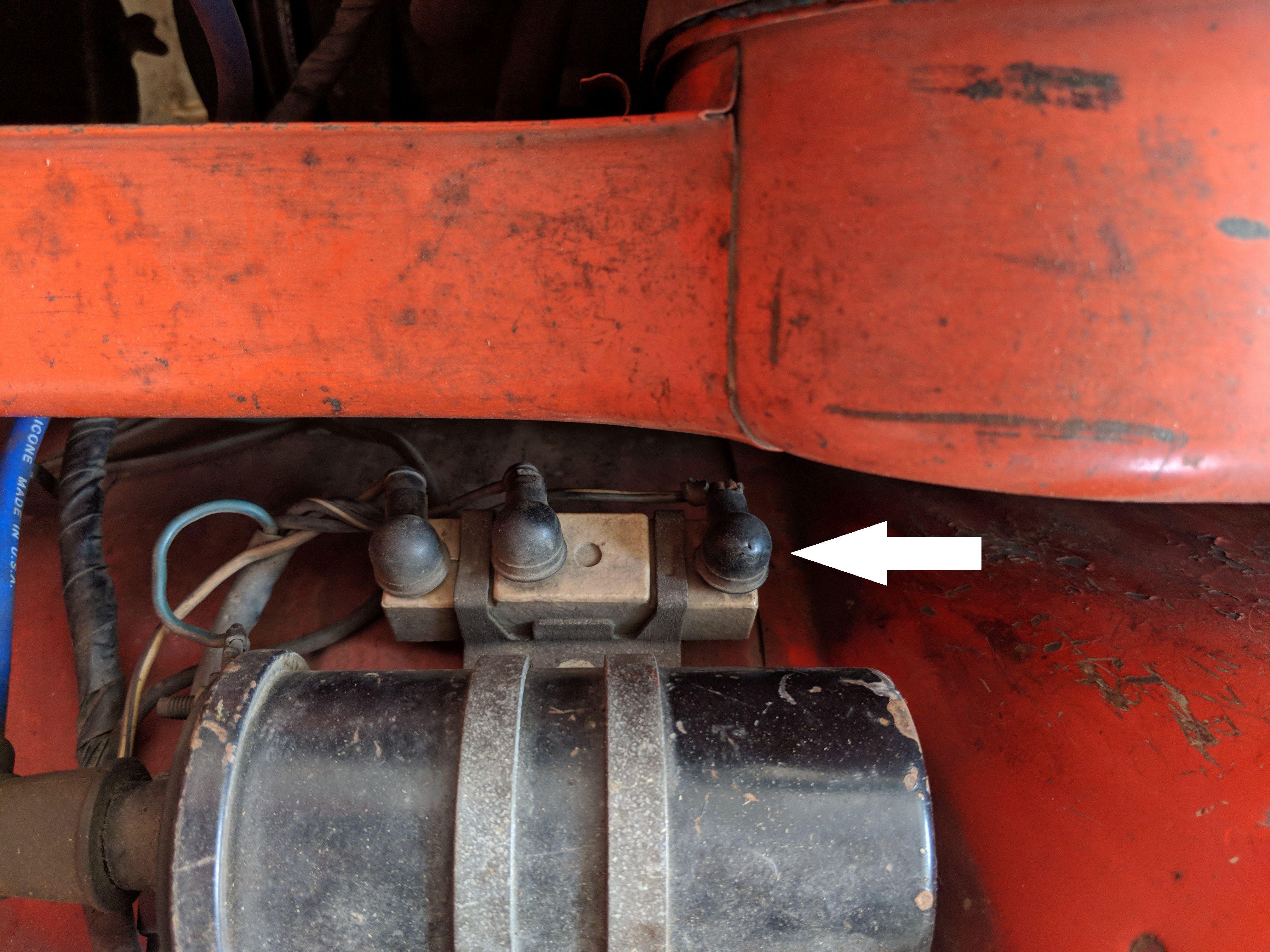

74 (early) 260Z, It turns over fine and will fire when started is engaged. As soon as the key is released it dies. I heard this may be the ballast resistor. Any  suggestions would be appreciated. I need to get this car winterized, but must get it to run again, before that happens.

There are three wires on the ballast resistor: white/black, black/blue, and black white. With the key in the On position, you should have voltage at the black/white wire. It has the arrow next to it in the picture
Lift the cap on the black/white wire and touch the pointer of the test light to the wire.
If the test light lights up, lift the cap on the white/black wire (opposite side of the resistor from the arrow) and touch the test light to that wire.
If you didn't have a light on the black/white wire, you have a loose/bad connection or bad ignition switch. You might want to talk to me on the phone about tracking that down.
If you have a light on the black/white but not on the white/black, you have a bad ballast resistor. You can move the black/white wire to the same terminal as the white/black, but you shouldn't run it long that way.

I finally got time to get back out there and it turns out one of the posts on the resistor is loose and comes right out. I am assuming this is the problem. Does anyone know where I can find a replacement for this resistor? Or should I do an upgrade?
Jeff
The 260Z ballast resistor is NLA. You might be able to get away with a 240Z ballast resistor. You would have to move the start wire over to the same terminal as the coil wire.
The problem with that is that I don't know why they introduced a small amount of resistance in the starting circuit. If you're worried about that, there is a kludge I could describe to you, but it's not very elegant.
