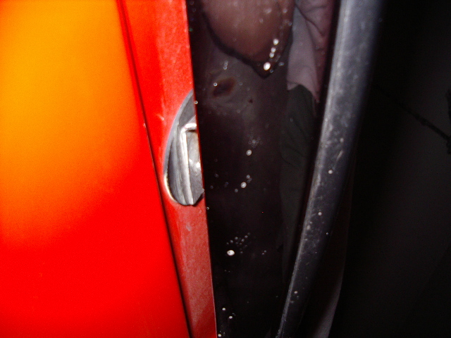

June 17, 200619 yr comment_171323 Mike W. is correct, the rubber "shims" is what Motorsport calls them and they want $16.00 apiece for them. I have been looking for some of these, since I only have one and it is in bad condition (see pics). As Mike W. mentioned, they are slipped over the metal plates that are welded inside both the front and rear bumpers and are not visible from the outside. Motorsport is the only place I could find who sells them, but I refuse to pay the $16.00 per, especially since I need 4 sets of them for 2 cars. Link to comment https://www.classiczcars.com/forums/topic/6077-bumper-mounting-question/#findComment-171323 Share on other sites More sharing options...

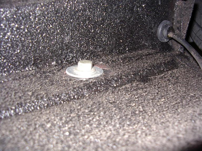

June 18, 200619 yr comment_171345 Don't spend all that money on those rubber pieces. Go to your local hardware store and get some fender washers and some rubber washers of the same size. You will save a bundle! Sorry for the blurry picture but I think you can tell what I'm talking about. Link to comment https://www.classiczcars.com/forums/topic/6077-bumper-mounting-question/#findComment-171345 Share on other sites More sharing options...
