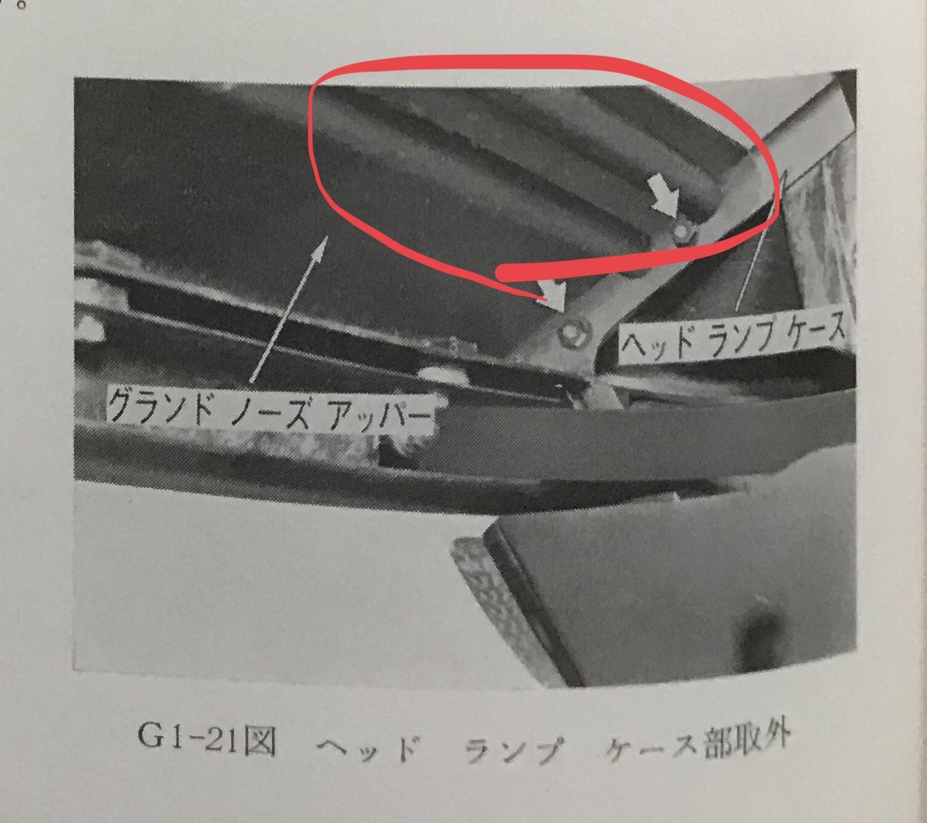

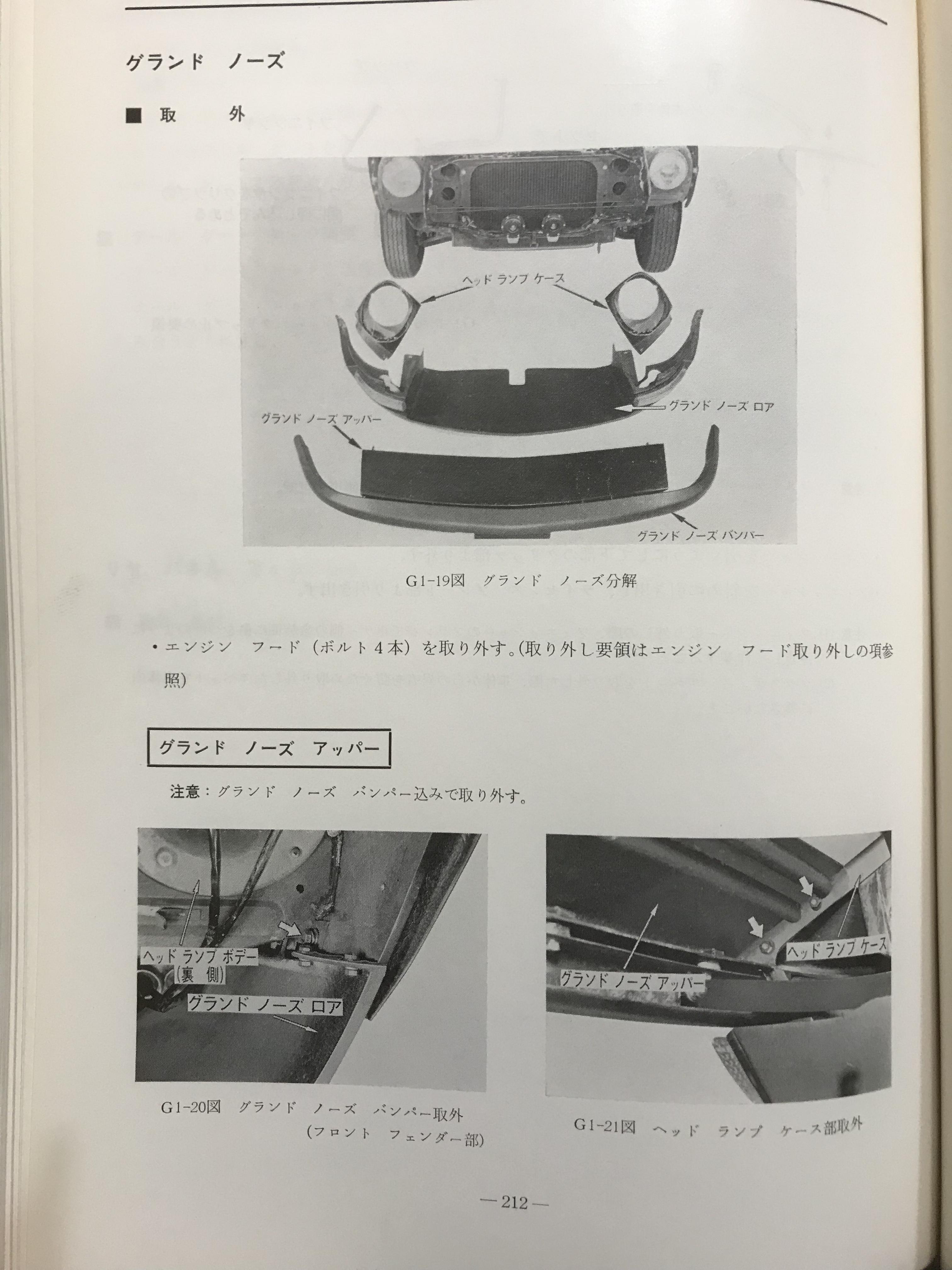

28 minutes ago, kats said:
Kats, I've always believed that shot of the underside of the bonnet extension in the factory service manual (G1-21 above) shows either an early, early production or almost pre-production panel. The horizontal strengtheners on the underside are not anything that I've seen on any of the (many!) genuine ZGs that I've had a good look at over the years, and are certainly different than the four vertical stiffening ribs that I believe were used for series production.
In which case is it another example of the factory documentation needing to be treated with caution? What do you think?

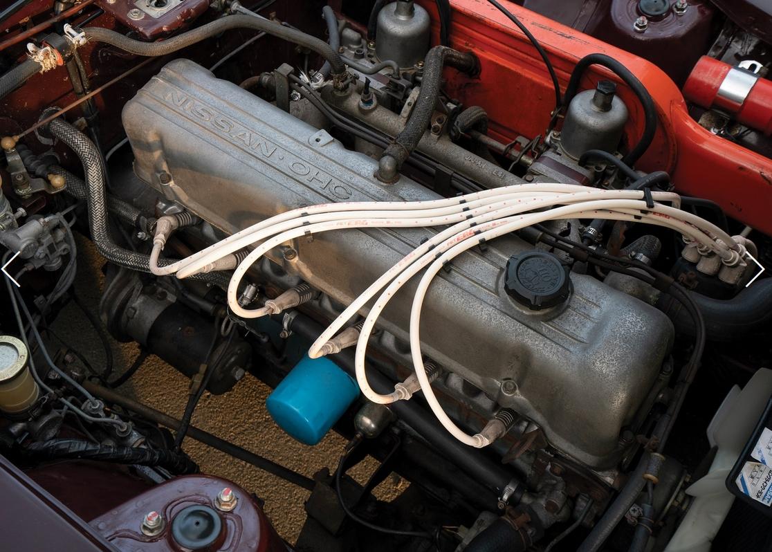

Kats,
I think you said that the intake manifold on the Bonhams car was for an automatic?  What about it would make it for an automatic?

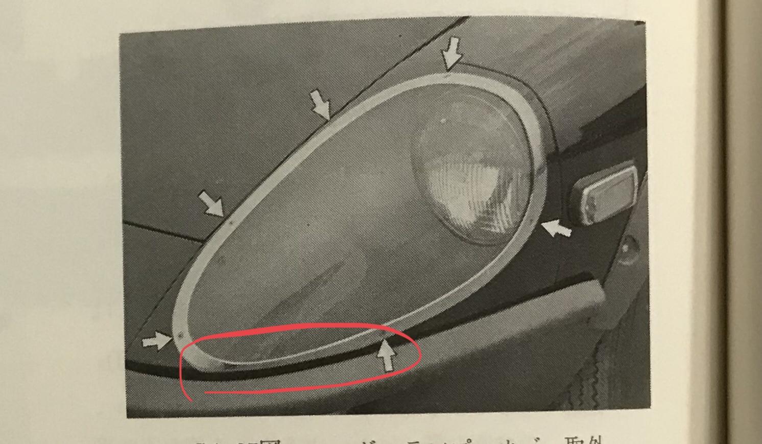

Alan , I too think  that horizontal ribs are must be prototype, very unique.
Other things which should be treated with caution are , they are I have been telling too , the difference in light cover trim ring .
The one in the picture has trimmed bottom  of the ring to be flattened for the bumper .
And the screw positioning is different from the ordinary production cars .
Kats

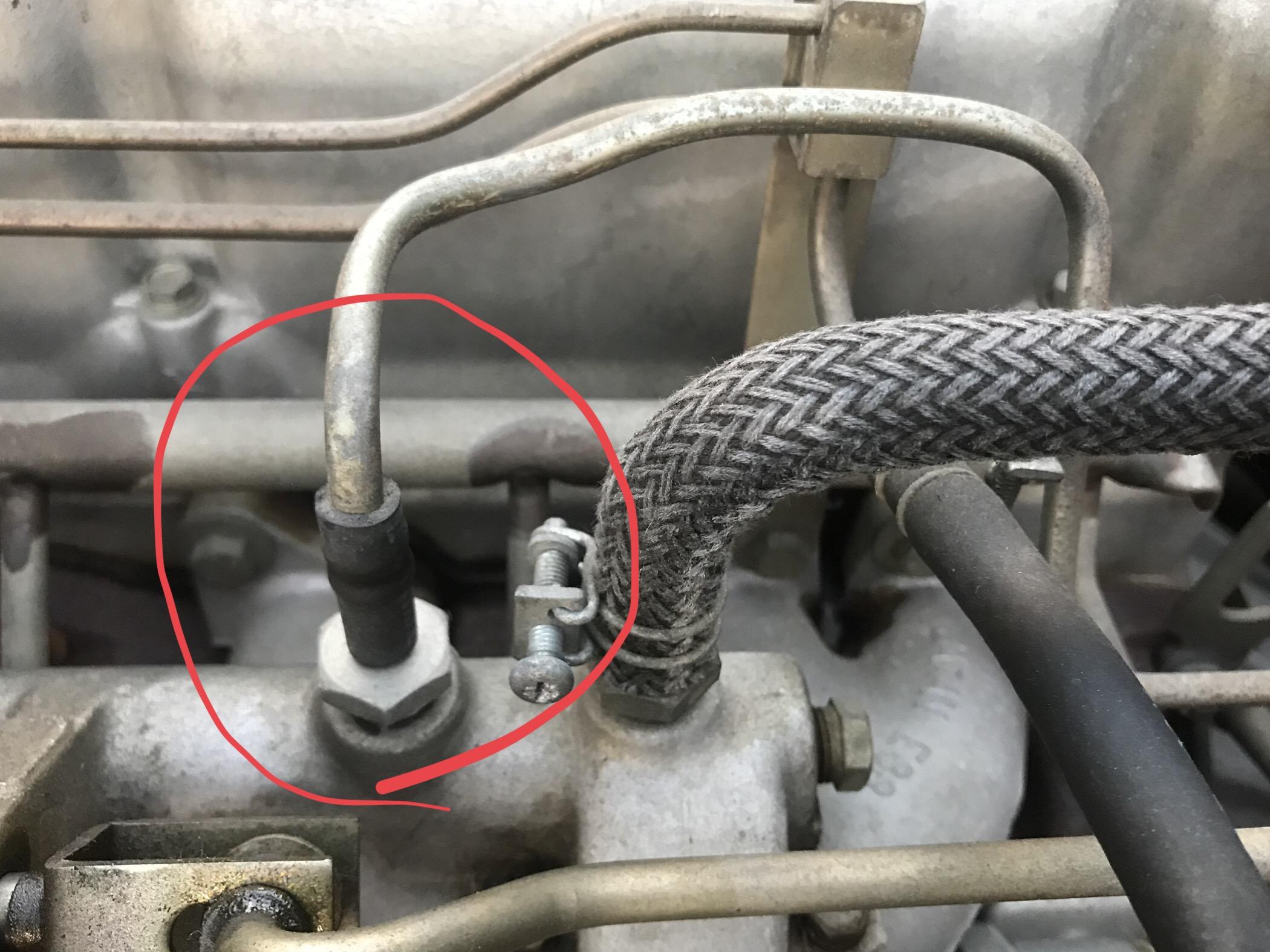

Hi Chris!
I said because the balance tube has a chopped rubber pipe , which  can be seen for the automatic transmission, automatic transmission needs a vacuum pipe for its operation. The first picture is my November 1971 car .
Kats

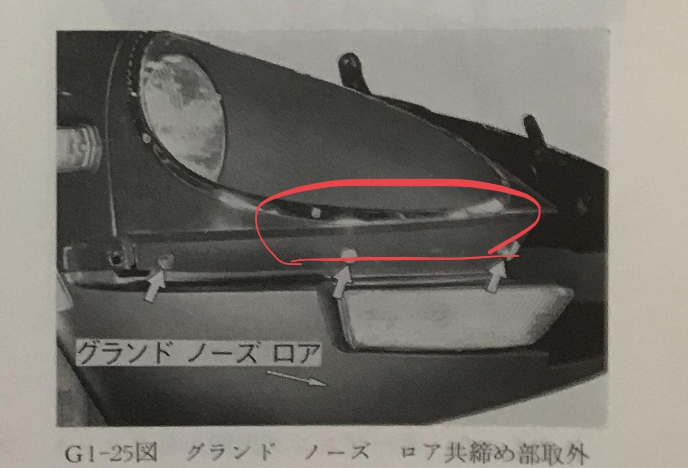

One thing about an automatic transmission,
after September 1972 ( after HS30-100001) the lower nose began to have air guides for an automatic transmission ZG .
This made me think the Bonhams ZG would be an automatic transmission car , but the story would be different, the lower nose which has air guides would be a later replacement. Many of my ZG friends said when you buying the lower nose from Nissan back in 90s , it always came with a air guides .
