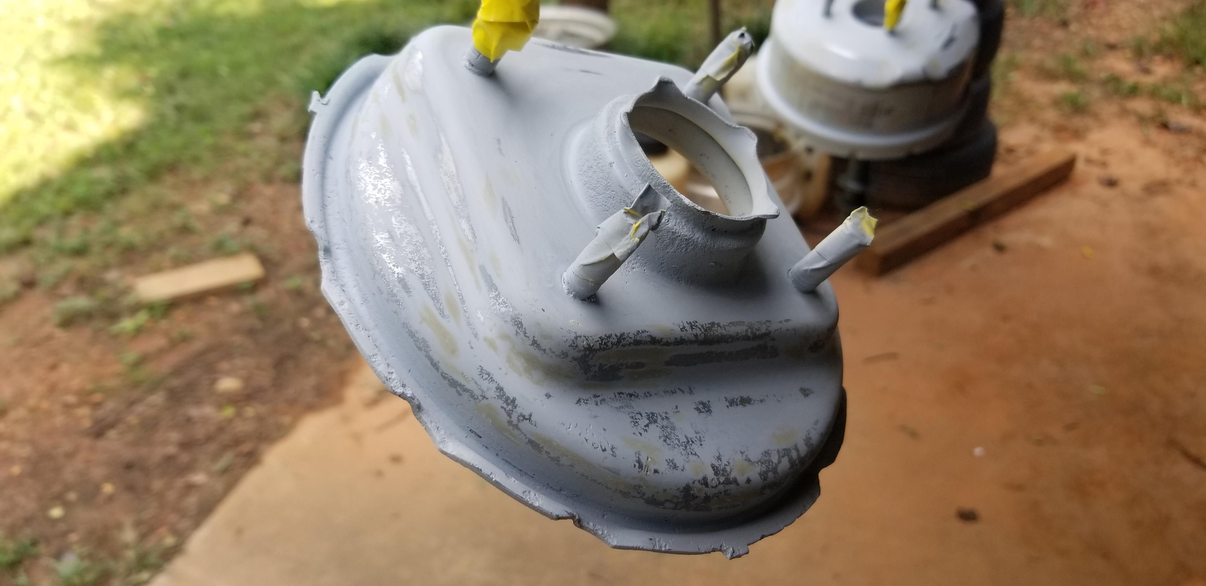

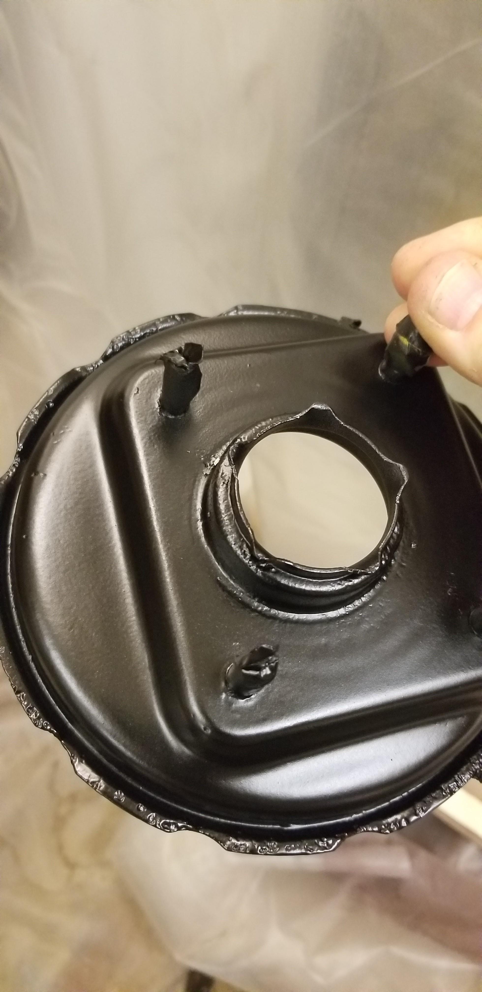

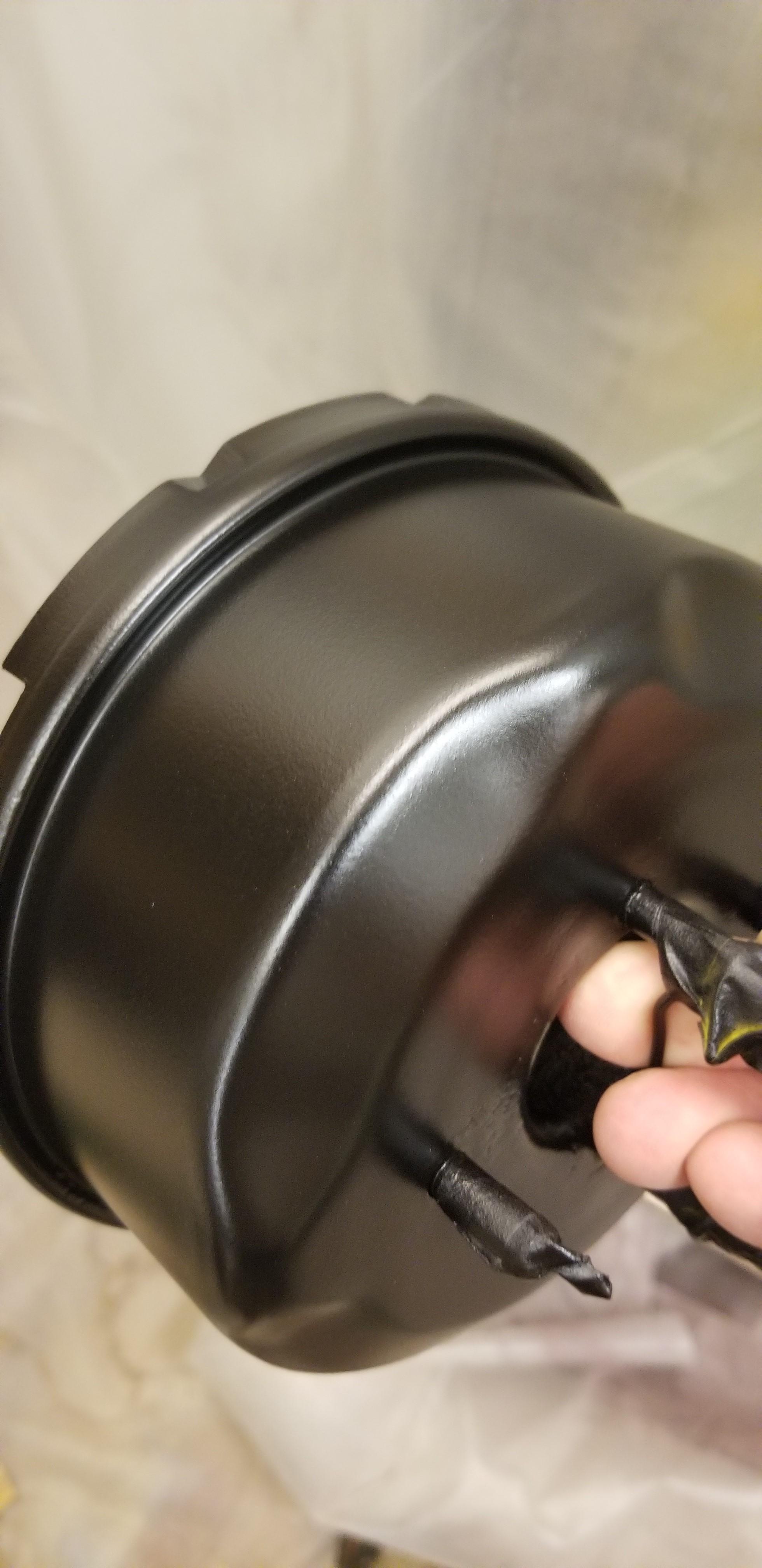

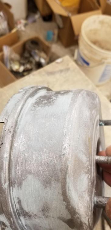

So a little fiberglass to fill the rust divots
A little high build primer
Sand to 400 grit
Then a little glazing putty
Then some Eastwood semi-gloss
I was going to try to plate the studs but my plating tank heater is dead. So maybe next weekend...
Interesting that no one chimed in on whether the boosters were yellow zinc under the black??

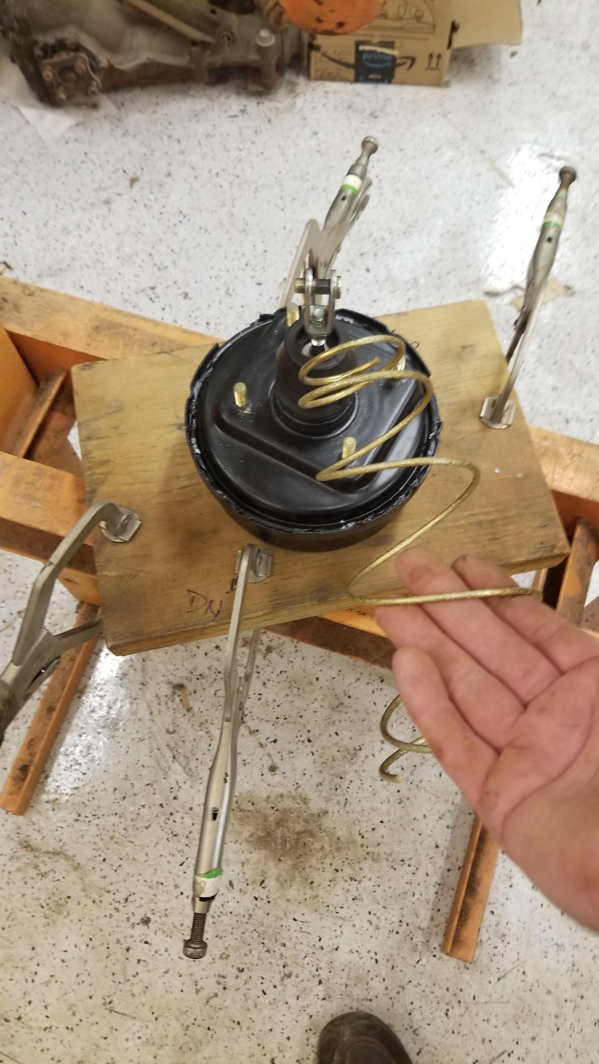

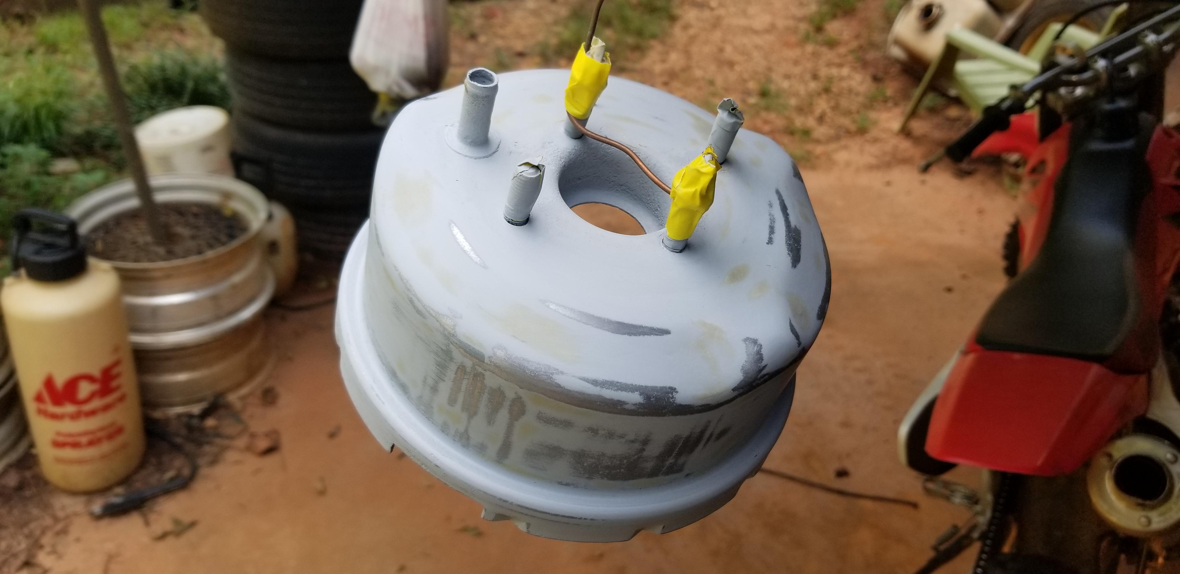

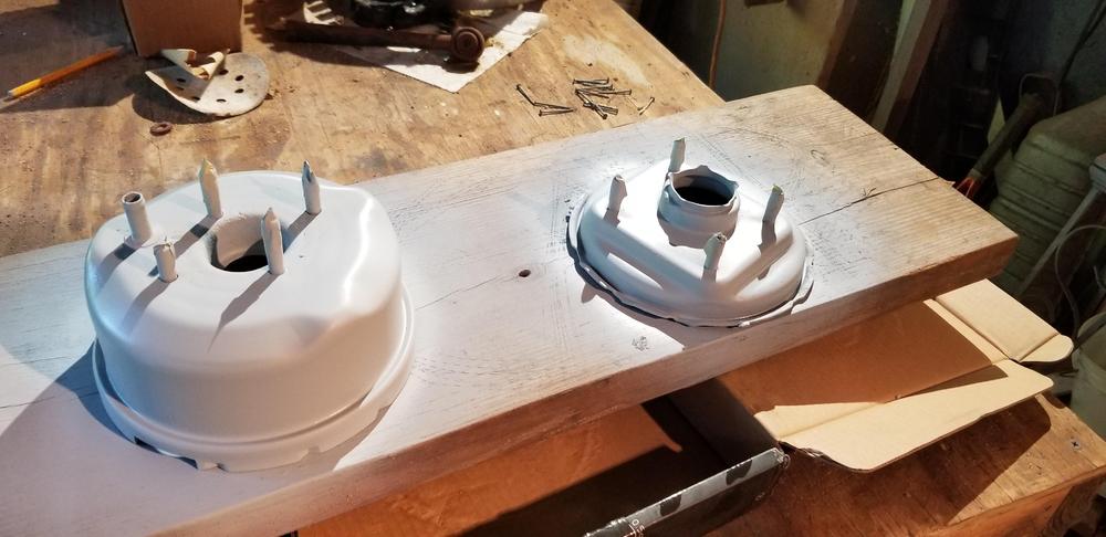

So I really wanted to protect the studs on the booster before I reassembled it. I have both halves of the case finish painted. So I plated them in place. I wired them up and suspended them in the tank
This is how the other half turned out
Now I'm working on plating the MC push rod. I'm working on removing the pitting from the rod.
I may attempt reassembly next weekend. I think I am have most everything ready for that. The MC push rod can go in after the shell is assembled.

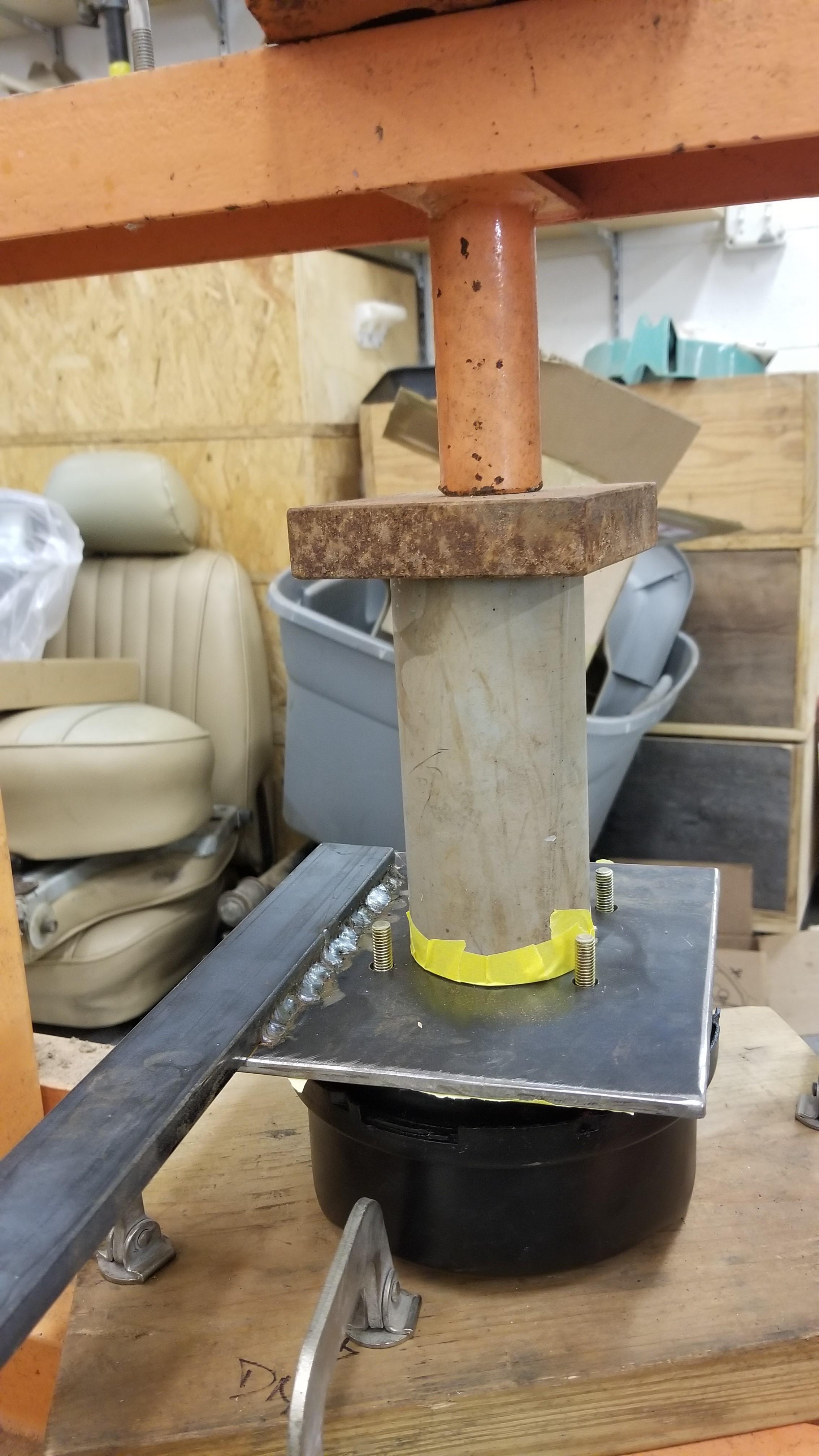

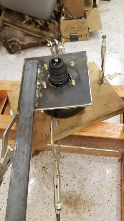

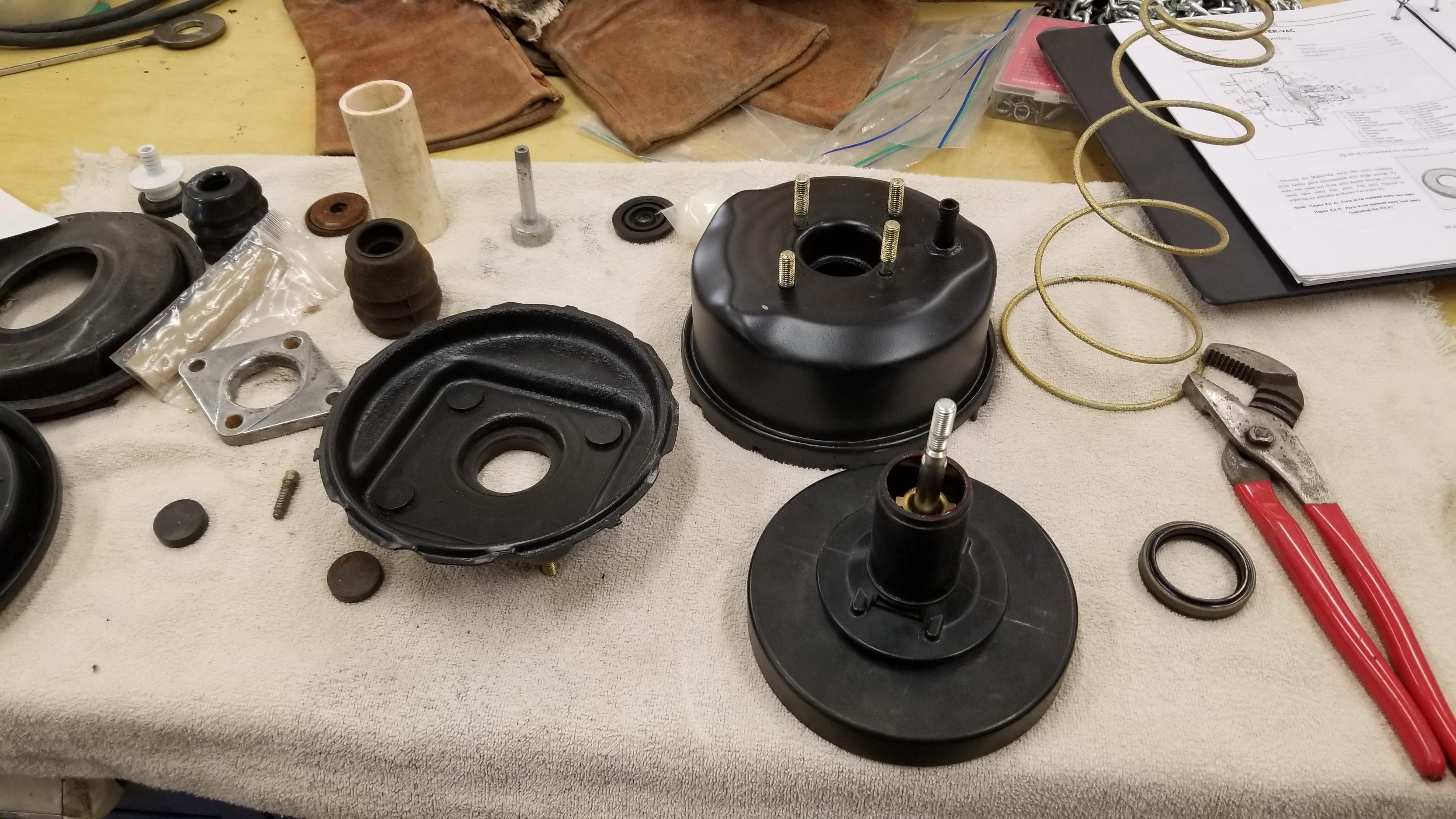

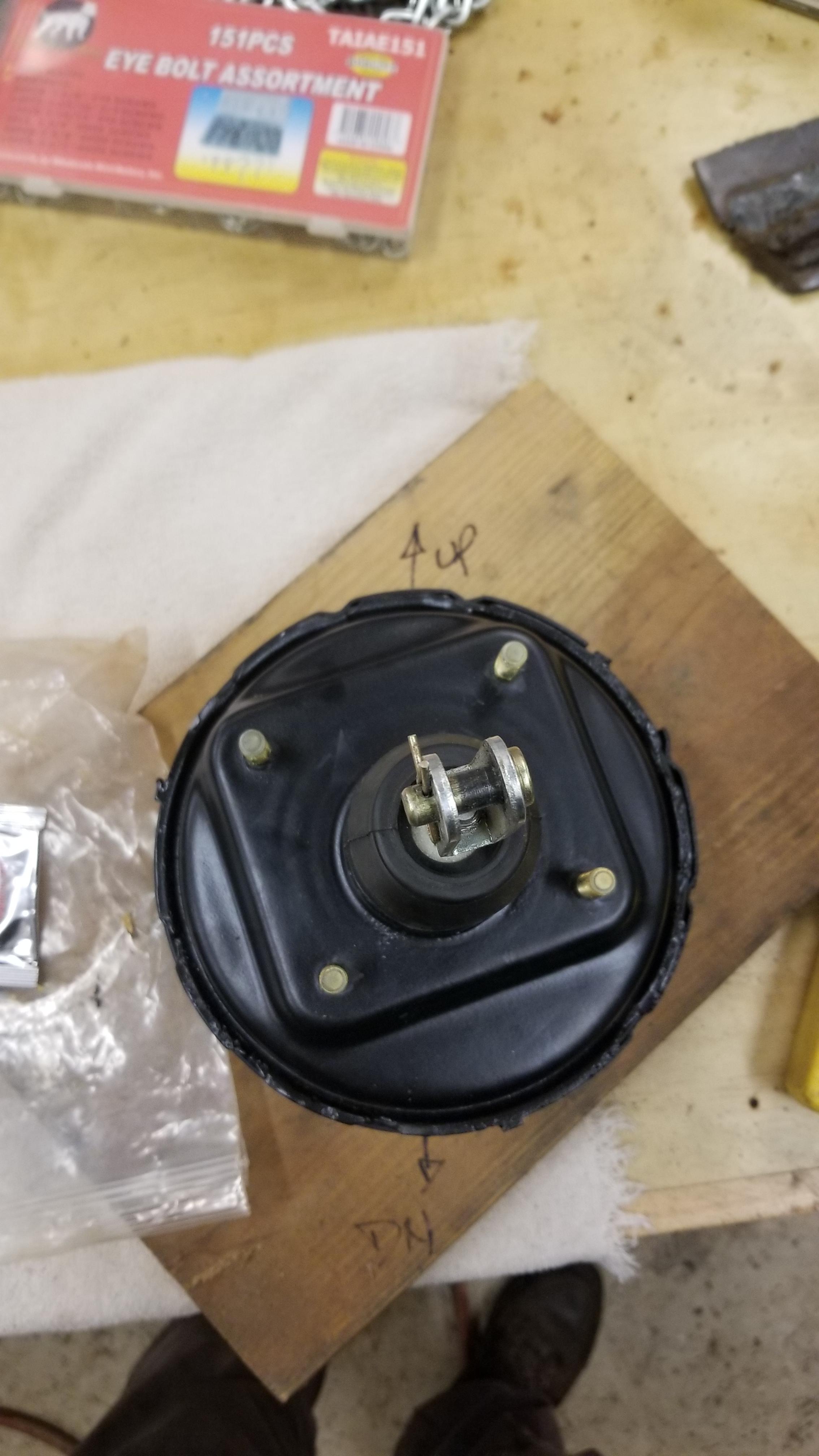

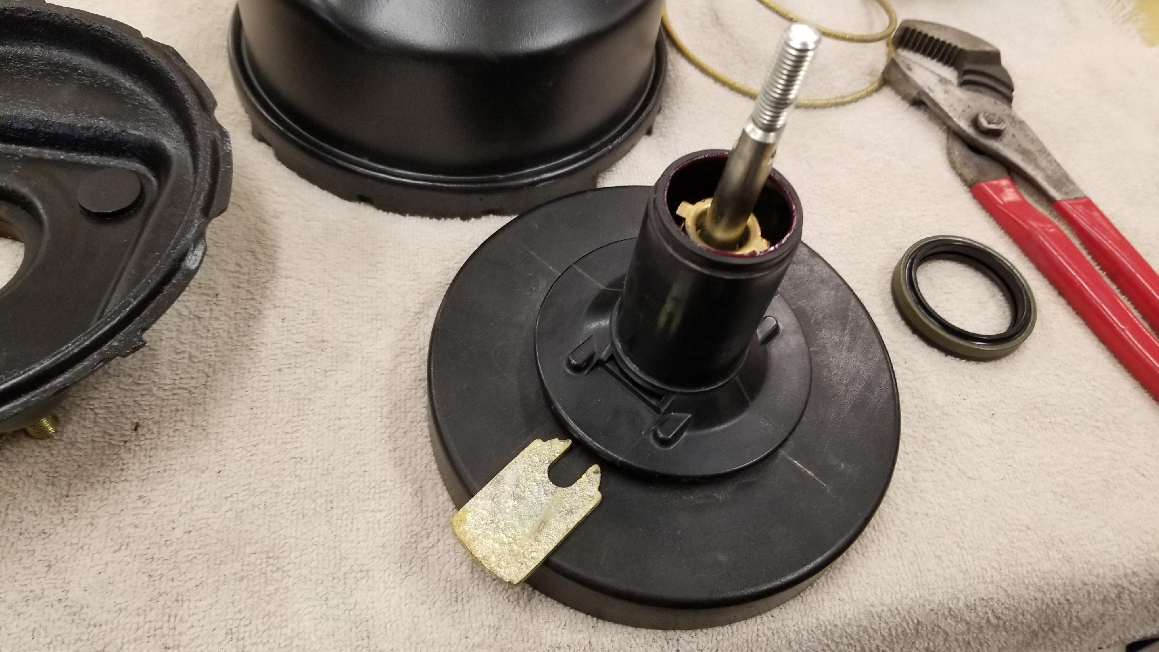

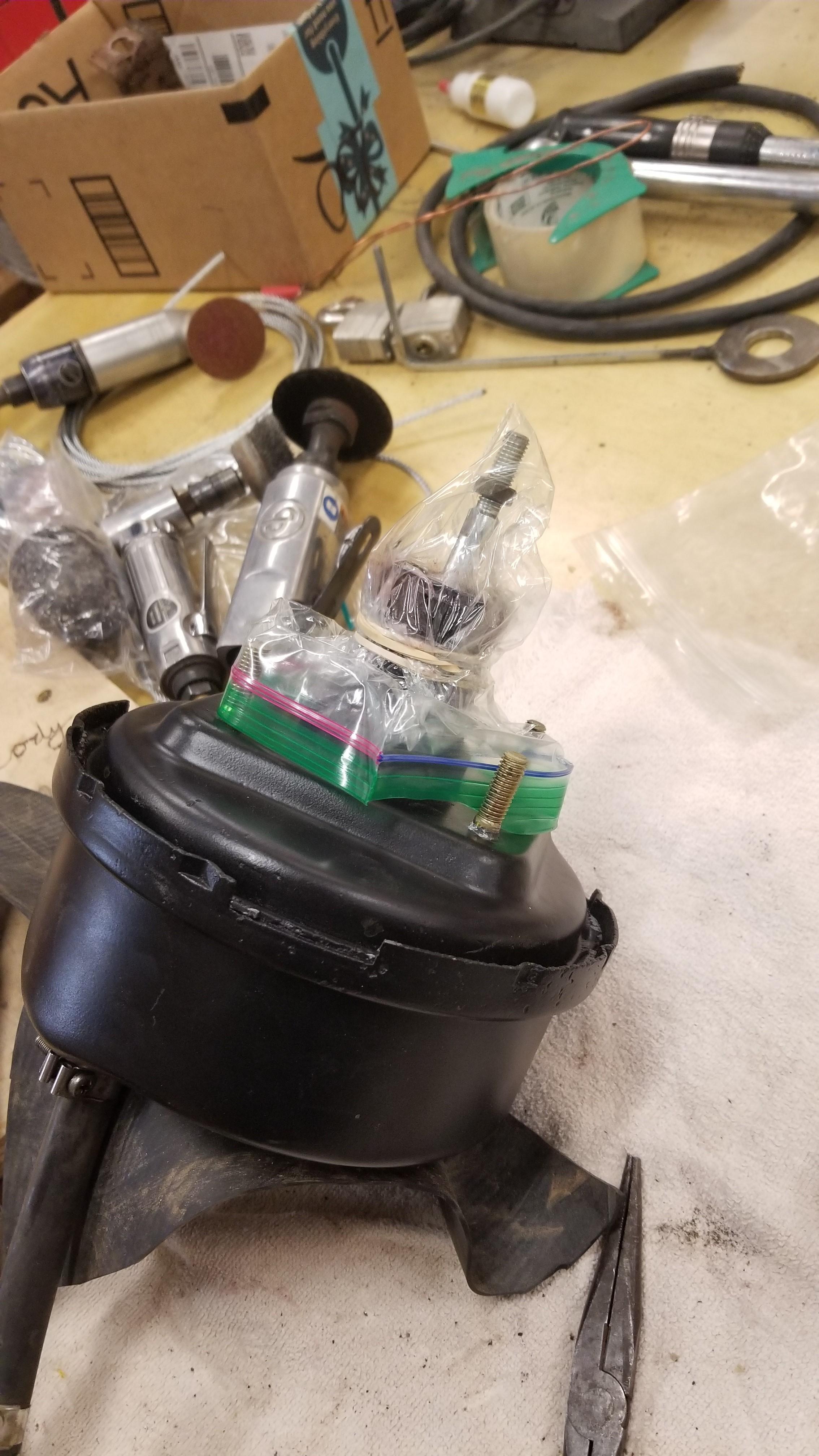

So I messed with the booster some more today. It's only been a bout 6 months. So I reassembled it. It went really well with the new lever. Almost no effort needed.

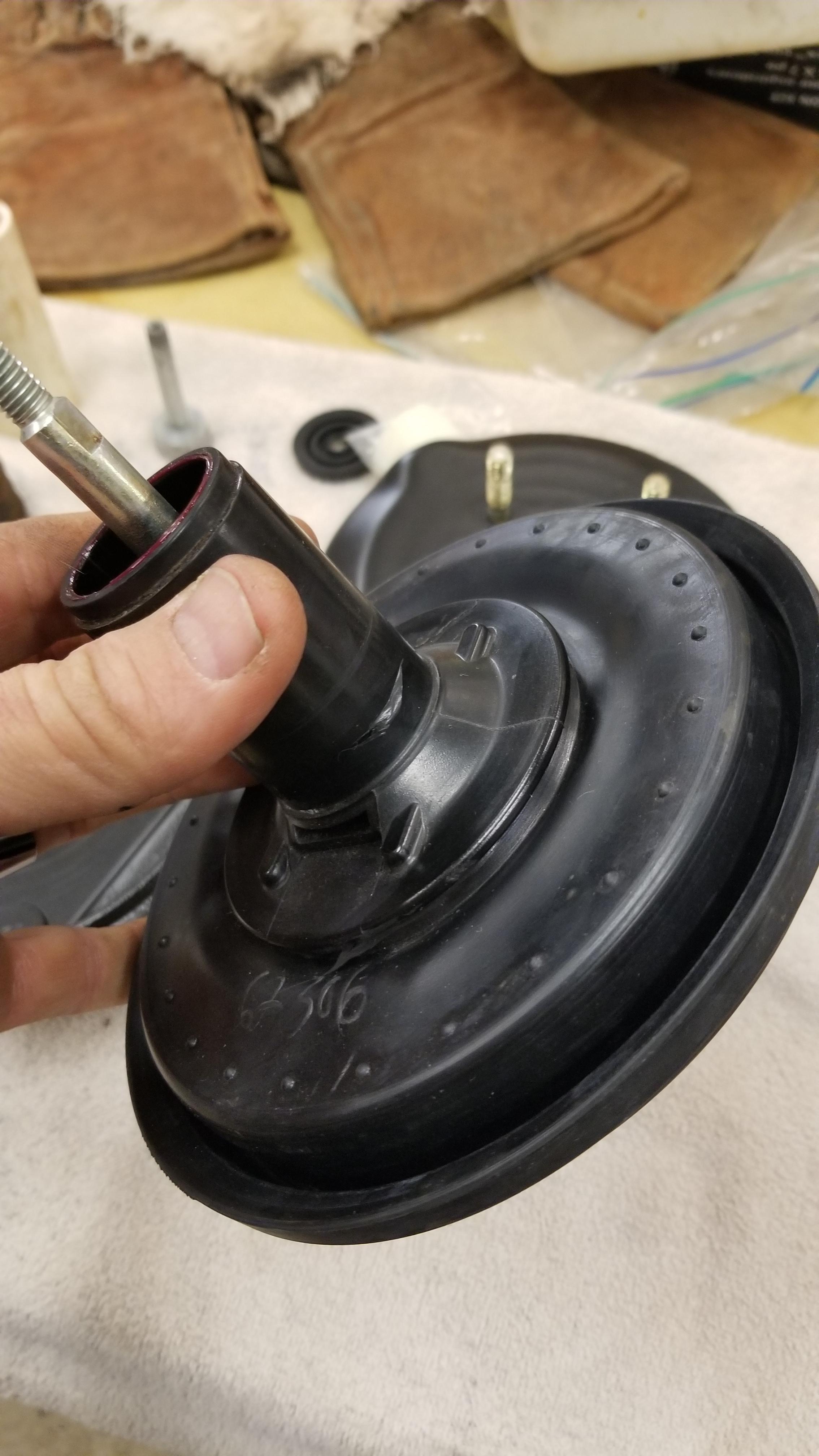

I used a mixture of old seals and new seals. The old seal that goes around the disc shaft on the passenger end of the booster was reused. I was unsure the new seal would go in or work properly. I also reuse the old bellows for that end.

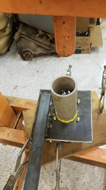

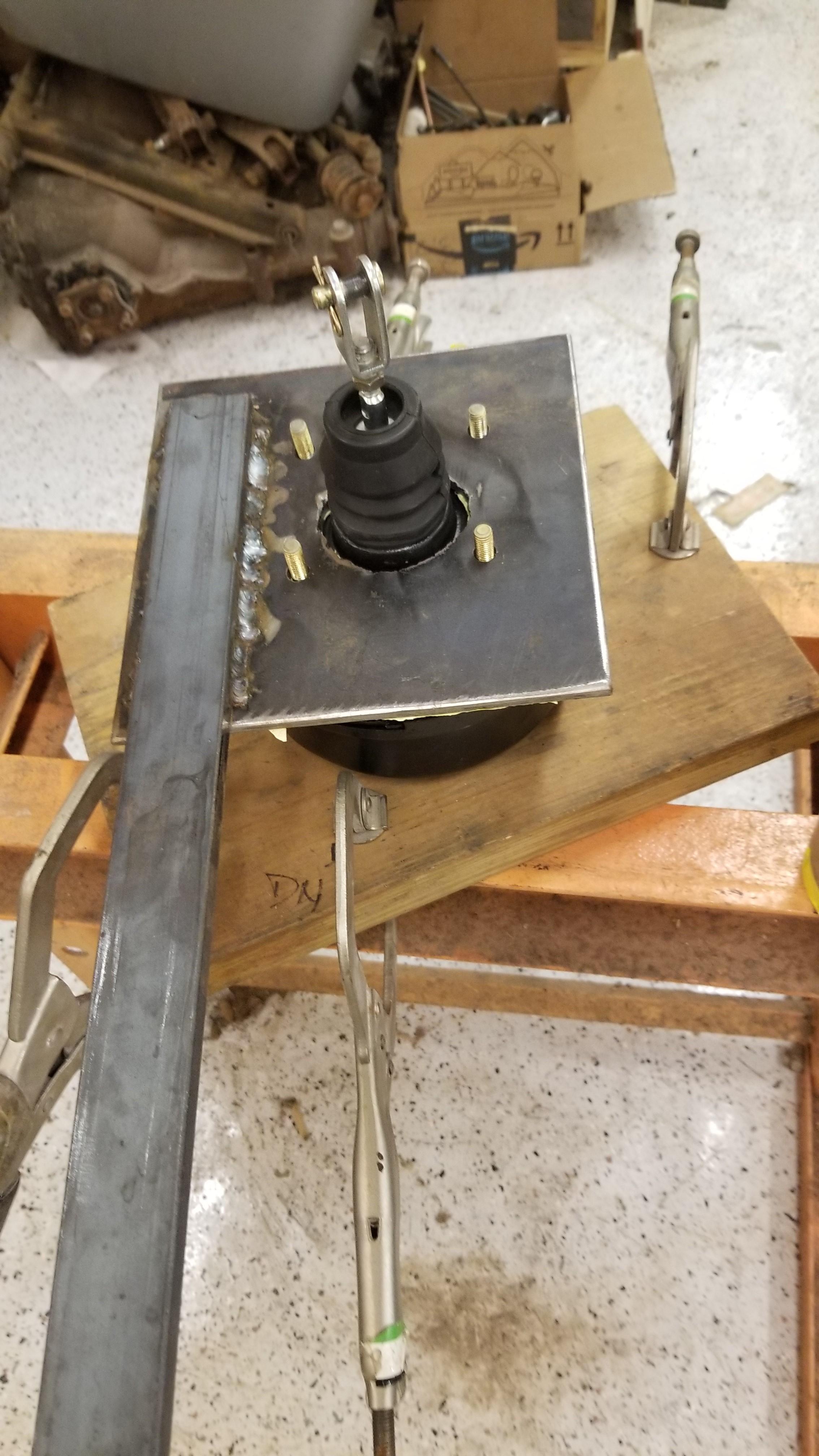

I just put enough pressure on it to get the space out between the cases

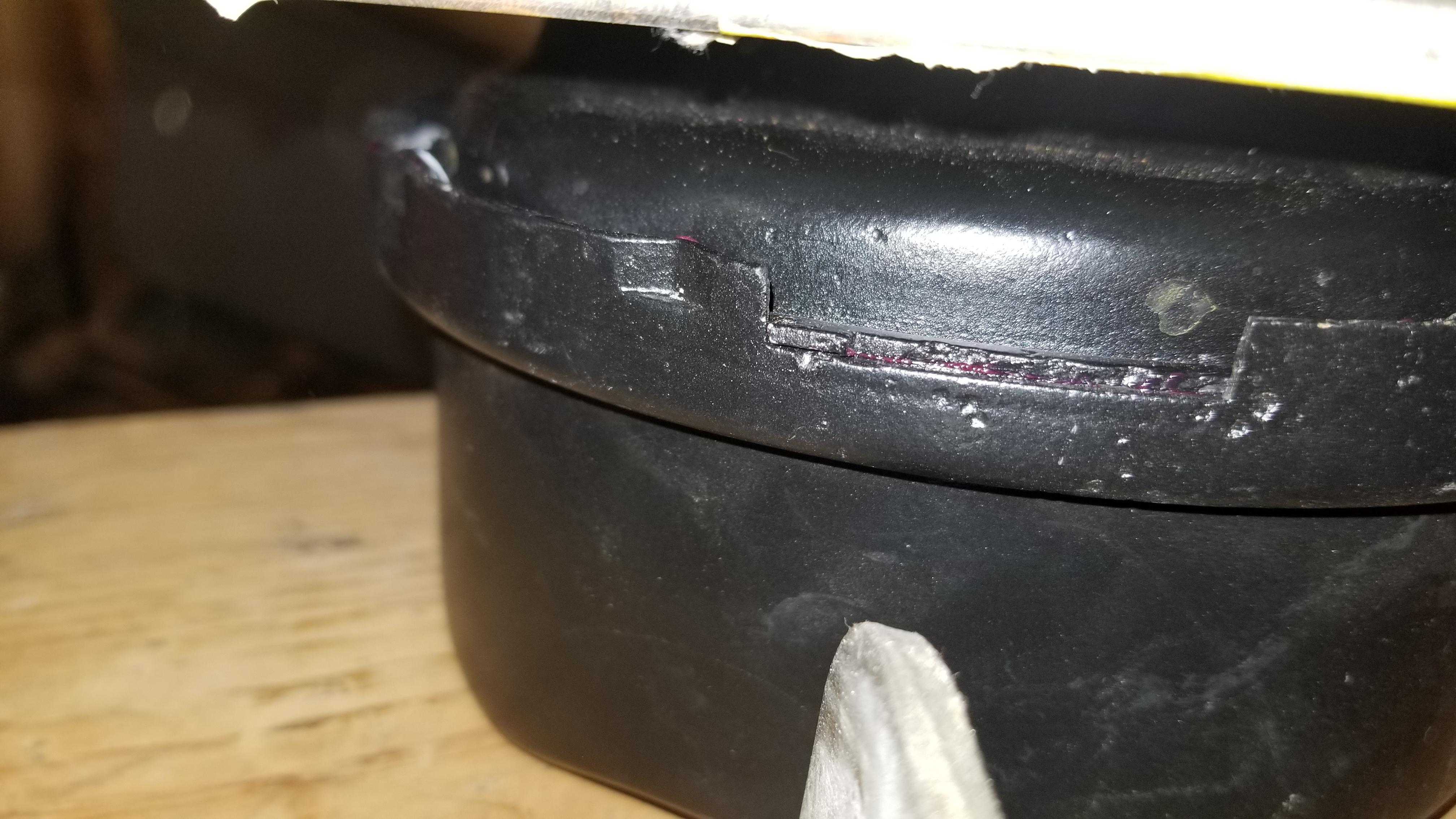

This is locked

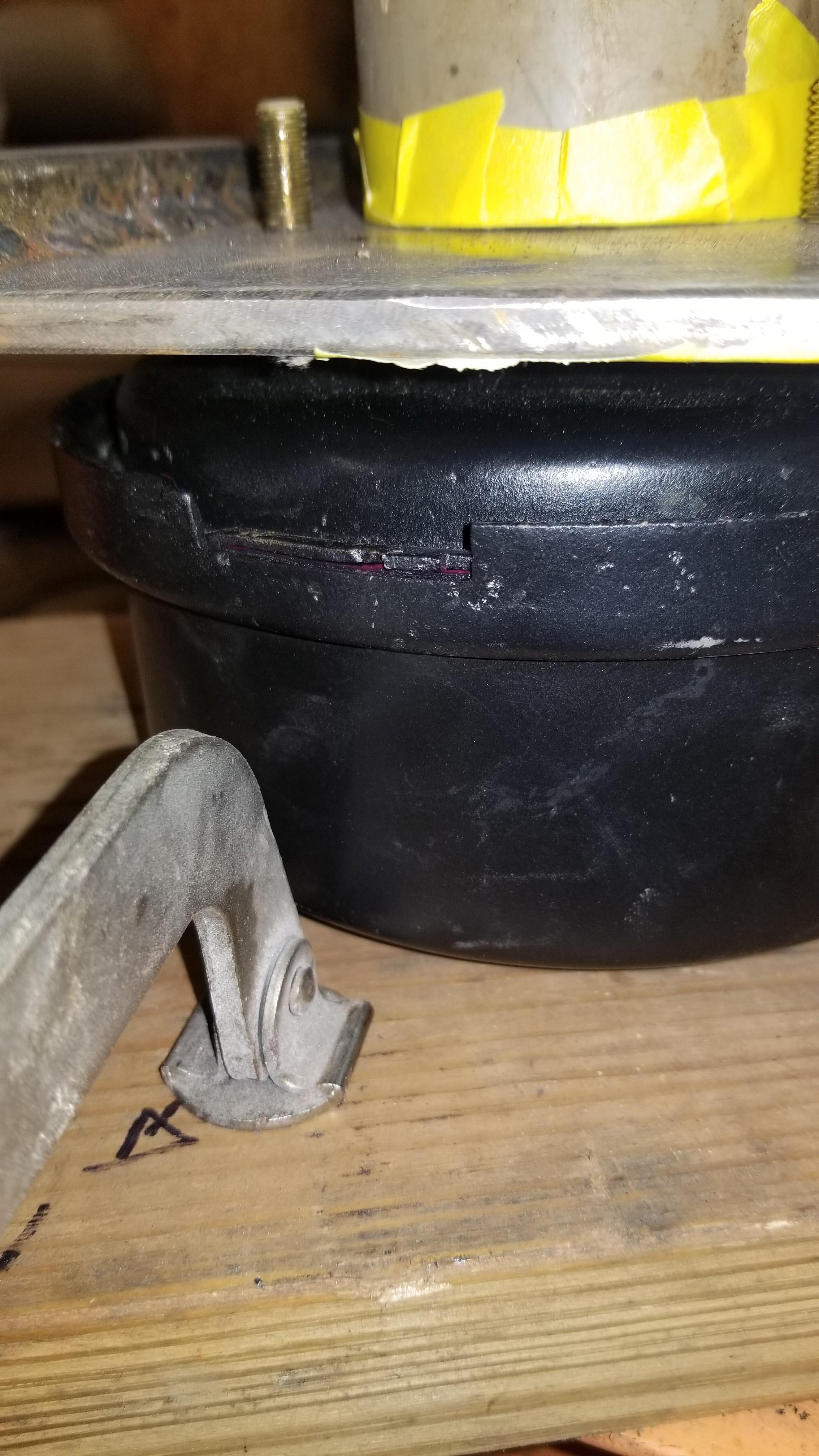

So pleased with myself until I saw this on the bench :facepalm::facepalm:
So opened it back up and did it again

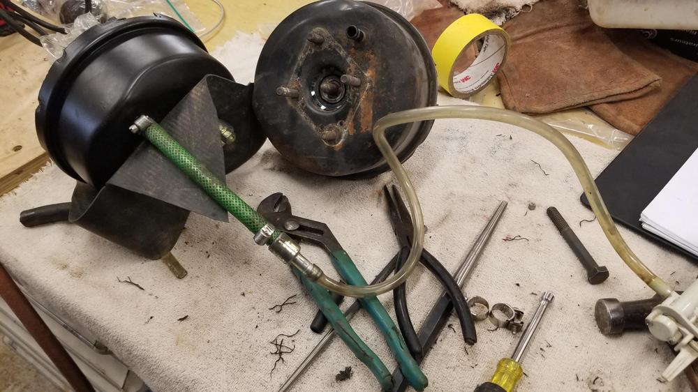

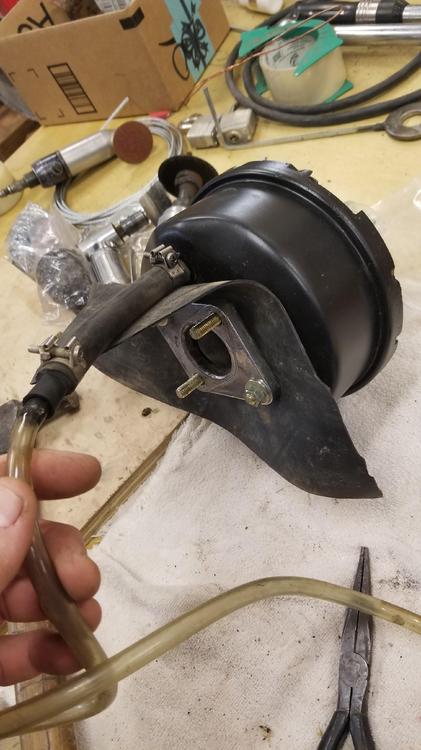

The real "chapper" is it still won't build vacuum, at least not by hand. I blanked out the MC end with some sheet rubber and it wouldn't. so I wrapped a zip lock around the plunger side and it still wouldn't build vacuum. Now the mighty vac will build and hold vacuum it I pinch the vacuum line. So I am kicking around ideas
Maybe the seals need to bed in and higher vacuum might help?
Leaks around the perimeter of the case? I sort of doubt this because the edges were good and it's pretty compressed to get it to lock close
Leaks in my testing setup?
Not able to build enough vacuum, quick enough by hand?
Leaks at the MC plunger side?
Leaks at the passenger plunger side?
I wondered if I could tap it into my S-10's vacuum booster with a gauge to see if I could get it to build and hold vacuum?
So i went back to the shop and did a little more work. There was a small leak in the mighty vac tube and one in the black line. I also found a check valve and clean it up and put it in line with the booster. If I clamp the mighty vac in the vise and work it fast I could get it to 15" of Hg. It would slowly bleed off at a rate about 3 times the FSM spec (.9" in 15 seconds). It would be curious to know if rebuilt boosters from other sources will hold the FSM spec. I suspect the old seal I used and the slight corrosion on the MC plunger are contributing to the bleed off. For now I will consider that a success. This was not the cleanest 7" booster I have. I may take another stab at it later but for now I'm moving on.
