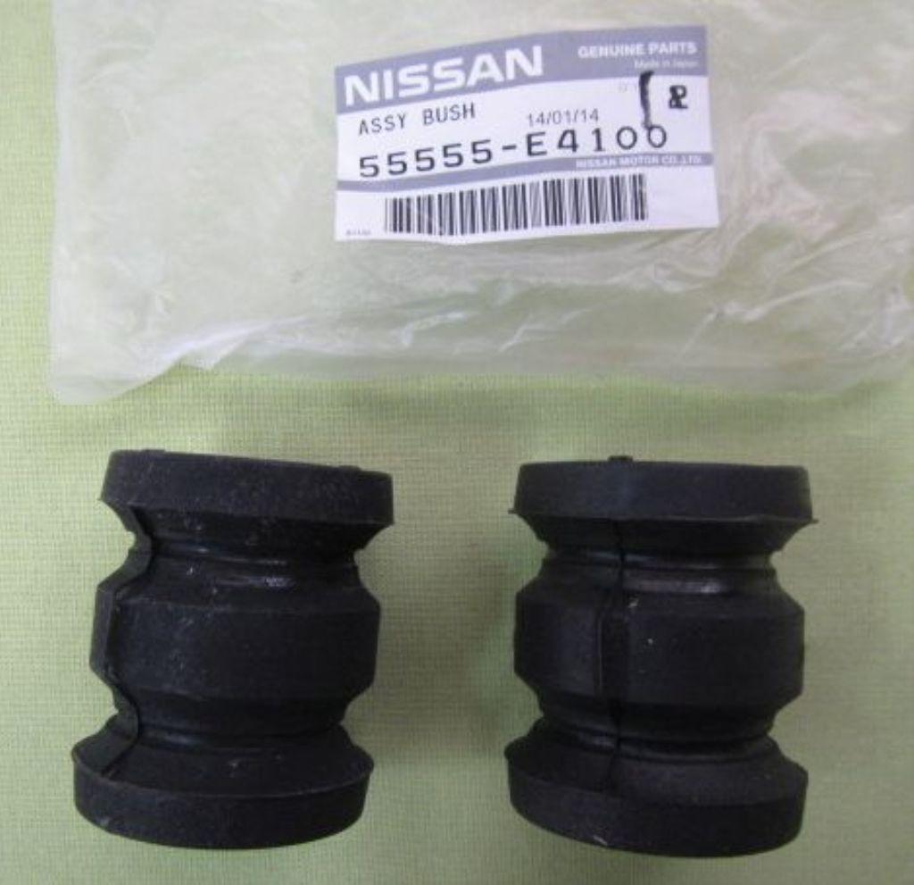

August 9, 20186 yr Author comment_554962 i only see this kit available: https://www.amazon.com/Energy-Suspension-7-3104G-Control-Bushing/dp/B000CGUJOE/ref=sr_1_1?s=automotive&ie=UTF8&qid=1533832428&sr=1-1&keywords=Energy+Suspension+7.3104G I dont think i need all of these bushings as i only need to replace the ones that were wrongly installed. The ones i need are the ones pointed in the following site: https://www.totalzparts.com/product/datsun-240z-260z-280z-rear-suspension-inner-control-arm-bushings-1970-78-nos/ Quite expensive indeed. Please confirm. Â Link to comment https://www.classiczcars.com/forums/topic/60520-rear-suspension-arms-bushings/?&page=3#findComment-554962 Share on other sites More sharing options...

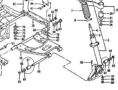

August 9, 20186 yr comment_554973 That's the wrong part. You need #57. Two for each side, about $12 each. Less than $50 total. http://www.carpartsmanual.com/datsun/Z-1969-1978/axle/rear-suspension/57 https://www.courtesyparts.com/oem-parts/nissan-bushing-link-55541e4100 Link to comment https://www.classiczcars.com/forums/topic/60520-rear-suspension-arms-bushings/?&page=3#findComment-554973 Share on other sites More sharing options...

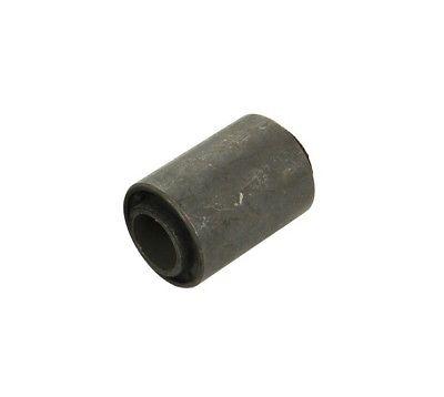

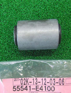

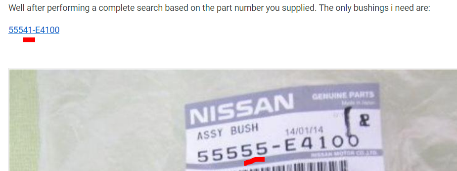

August 10, 20186 yr Author comment_555052 On ‎8‎/‎9‎/‎2018 at 12:39 PM, Zed Head said: That's the wrong part. You need #57. Two for each side, about $12 each. Less than $50 total. http://www.carpartsmanual.com/datsun/Z-1969-1978/axle/rear-suspension/57 https://www.courtesyparts.com/oem-parts/nissan-bushing-link-55541e4100 Well after performing a complete search based on the part number you supplied. The only bushings i need are: 55541-E4100  Edited August 10, 20186 yr by jalexquijano Link to comment https://www.classiczcars.com/forums/topic/60520-rear-suspension-arms-bushings/?&page=3#findComment-555052 Share on other sites More sharing options...
August 10, 20186 yr comment_555054 Your picture does not match your part number. I agree though that you only need the parts I suggested. Link to comment https://www.classiczcars.com/forums/topic/60520-rear-suspension-arms-bushings/?&page=3#findComment-555054 Share on other sites More sharing options...
August 10, 20186 yr Author comment_555064 Thats correct. Sorry. I just want to try a different option other than purchasin the energy suspension kit. Link to comment https://www.classiczcars.com/forums/topic/60520-rear-suspension-arms-bushings/?&page=3#findComment-555064 Share on other sites More sharing options...
August 15, 20186 yr Author comment_555322 On 8/10/2018 at 5:13 PM, Zed Head said: Your picture does not match your part number. I agree though that you only need the parts I suggested. I found the correct part. I guess i will need to go with the energy suspension poly bushing kit as these original nissan bushings are hard to get. Any thoughts? Link to comment https://www.classiczcars.com/forums/topic/60520-rear-suspension-arms-bushings/?&page=3#findComment-555322 Share on other sites More sharing options...
August 15, 20186 yr comment_555326 They shouldn't be hard to get. I bought 4 of them directly from Nissan 6 months or so ago 53 minutes ago, jalexquijano said: Â these original nissan bushings are hard to get. Â Link to comment https://www.classiczcars.com/forums/topic/60520-rear-suspension-arms-bushings/?&page=3#findComment-555326 Share on other sites More sharing options...

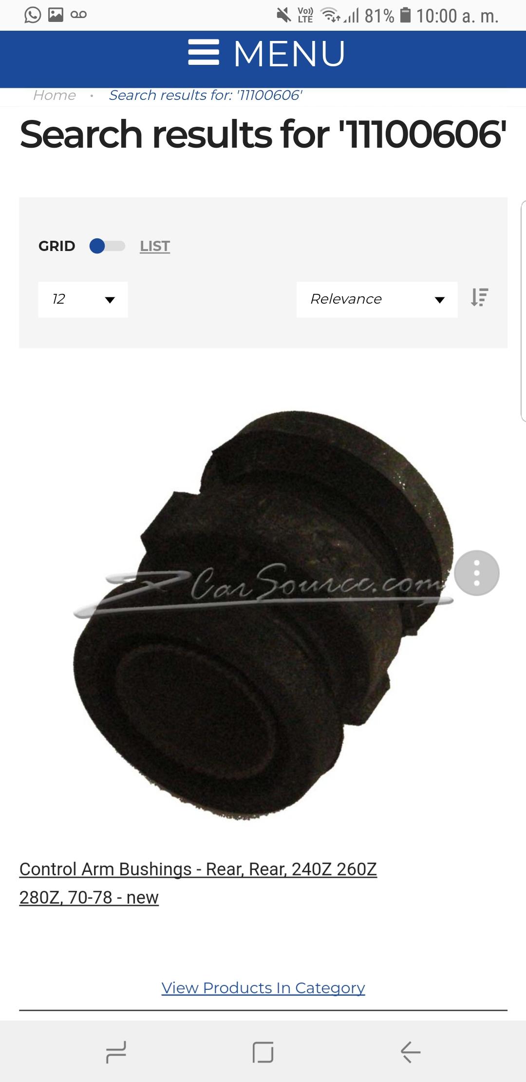

August 21, 20186 yr Author comment_555845 On 8/15/2018 at 5:50 PM, Patcon said: They shouldn't be hard to get. I bought 4 of them directly from Nissan 6 months or so ago  Z car source says i need 4 of these bushings. I guess they must be wrong as they dont look like the original bushings i previously posted. Edited August 21, 20186 yr by jalexquijano Link to comment https://www.classiczcars.com/forums/topic/60520-rear-suspension-arms-bushings/?&page=3#findComment-555845 Share on other sites More sharing options...

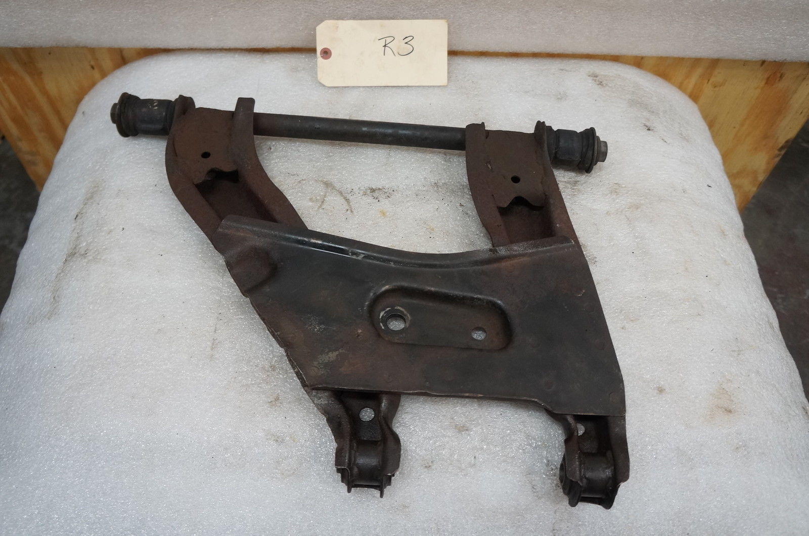

August 21, 20186 yr comment_555852 there are two types of the top, one is longer than the other you need a short and long for each side of the car on the rear suspension. not clear but it looks like # 64 in the illustration. I think the short one goes on the rear side of the inner control arm but you have it cut off so can't see the # for the front side. Just make sure you get two shorts and two longs. the lower pic is a #57 you need 4 in total all the same these go on the outer side of the control arm, two for each side of the car. the #57 can be very hard to remove, I would not bother unless they are shot. the inside ones are a bit easier as long as there is not a lot of rust on #61 bolt. Link to comment https://www.classiczcars.com/forums/topic/60520-rear-suspension-arms-bushings/?&page=3#findComment-555852 Share on other sites More sharing options...
August 21, 20186 yr Author comment_555854 I guees he is confused i need 2 of 57 for each side. Link to comment https://www.classiczcars.com/forums/topic/60520-rear-suspension-arms-bushings/?&page=3#findComment-555854 Share on other sites More sharing options...
