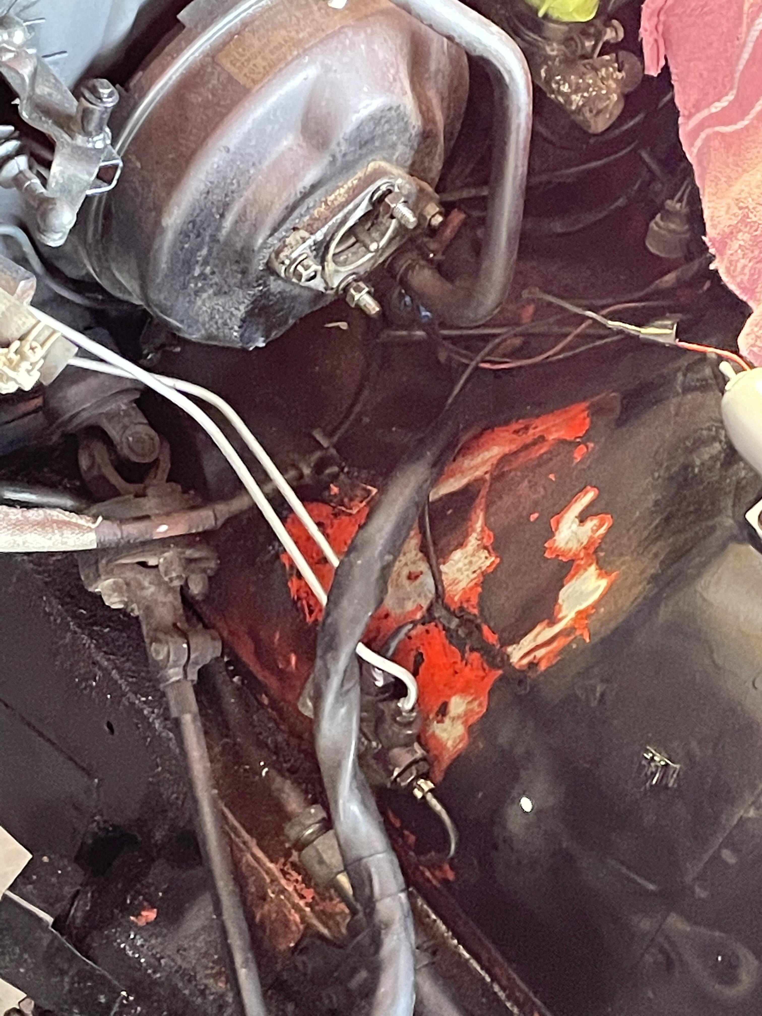

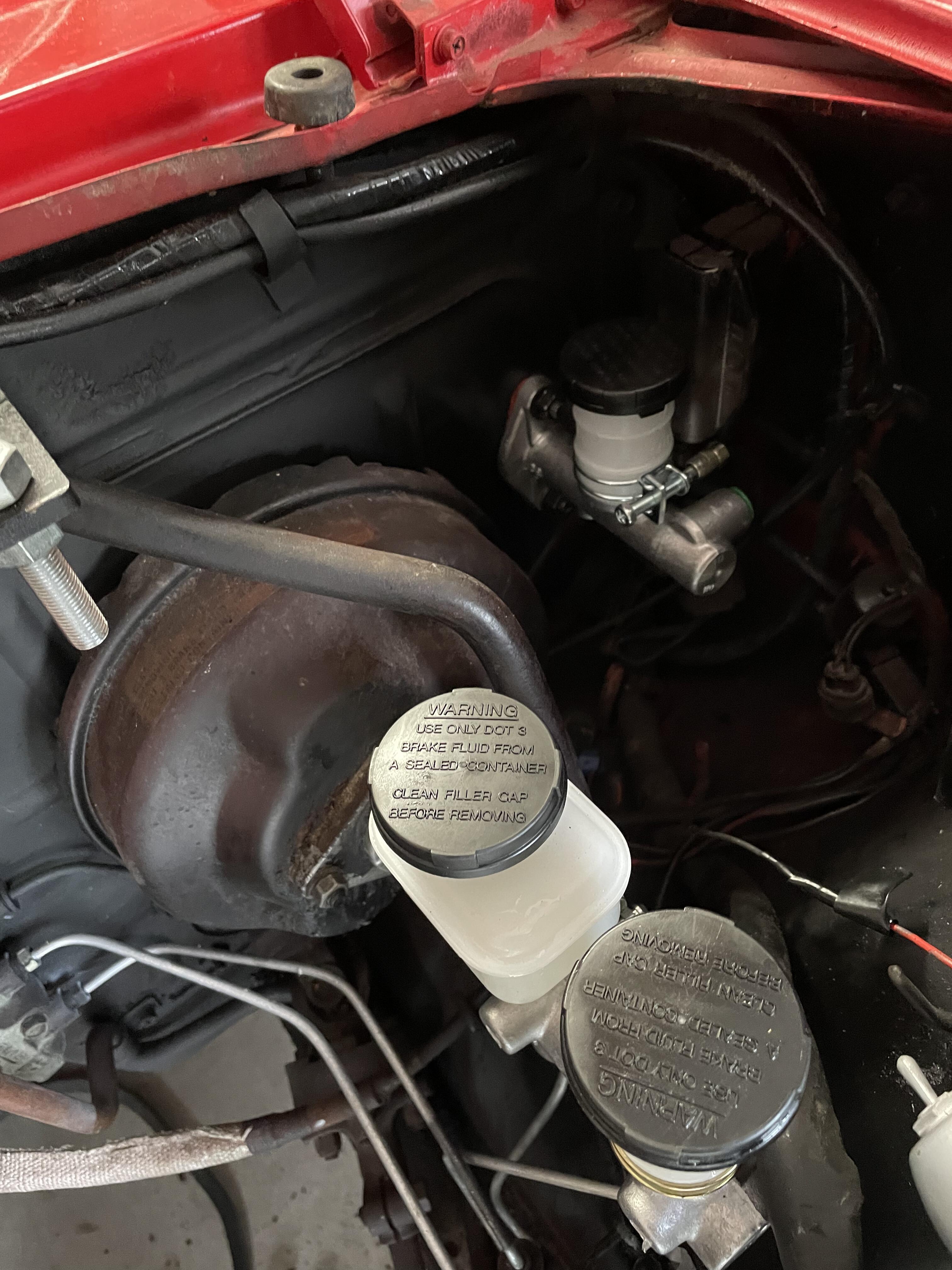

im guessing I didn’t tighten the brake lines to the BMC so it leaked into the engine bay. I’ll have to repaint. Not a big issue.
as for the bleeding, I’ll have a mechanic friend come over with his tools to help bleed the brakes… this car is DRY.

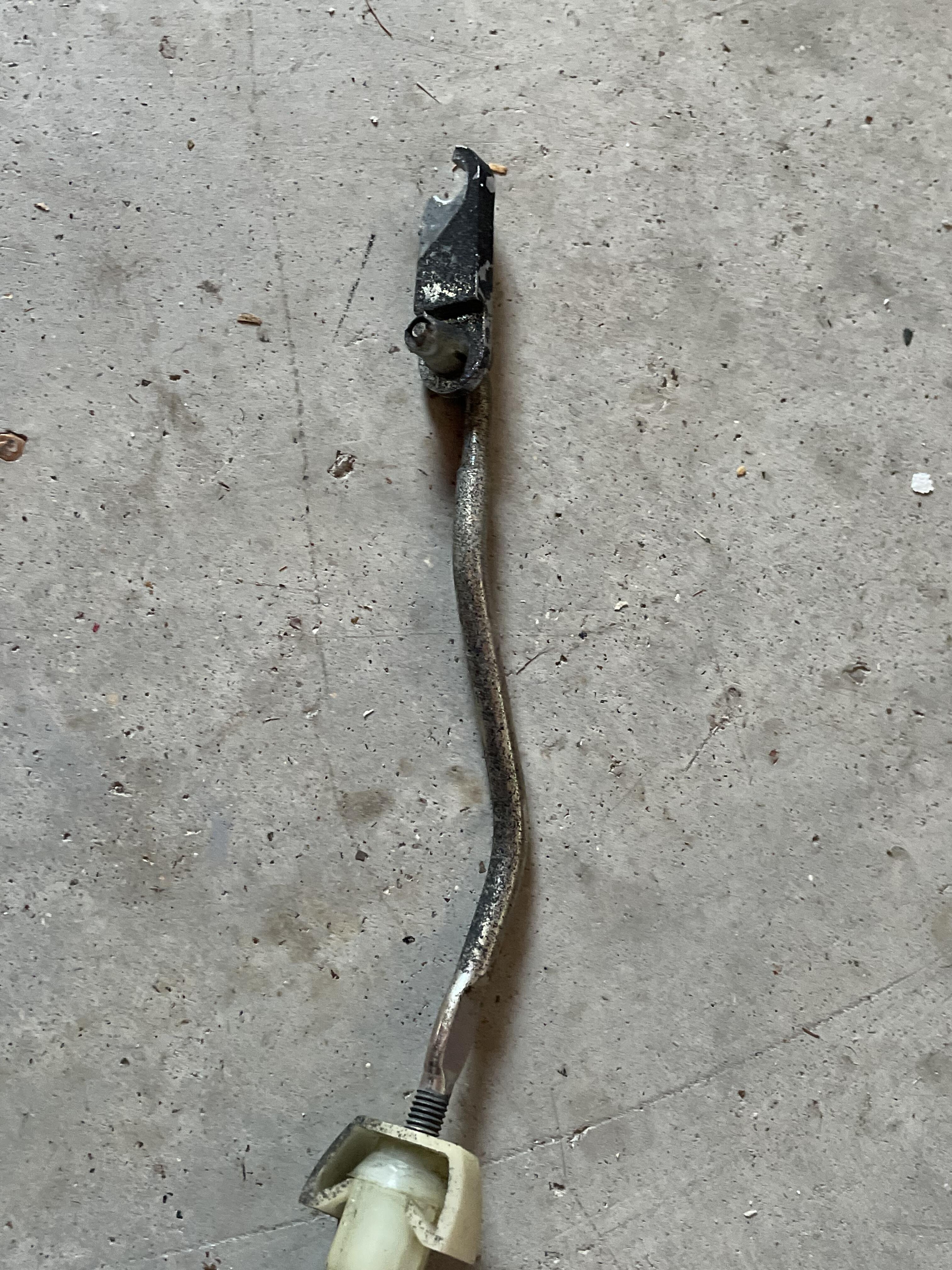

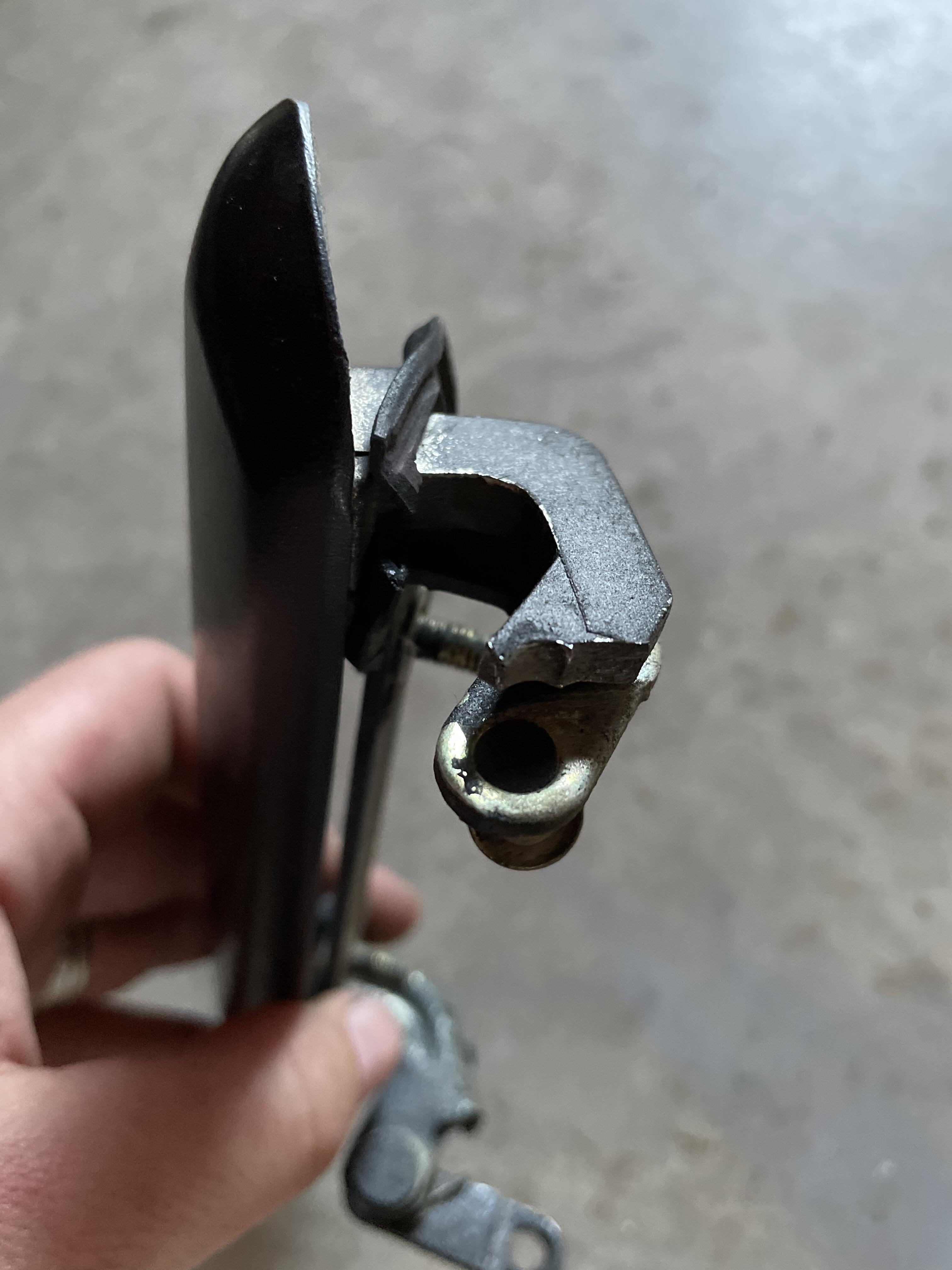

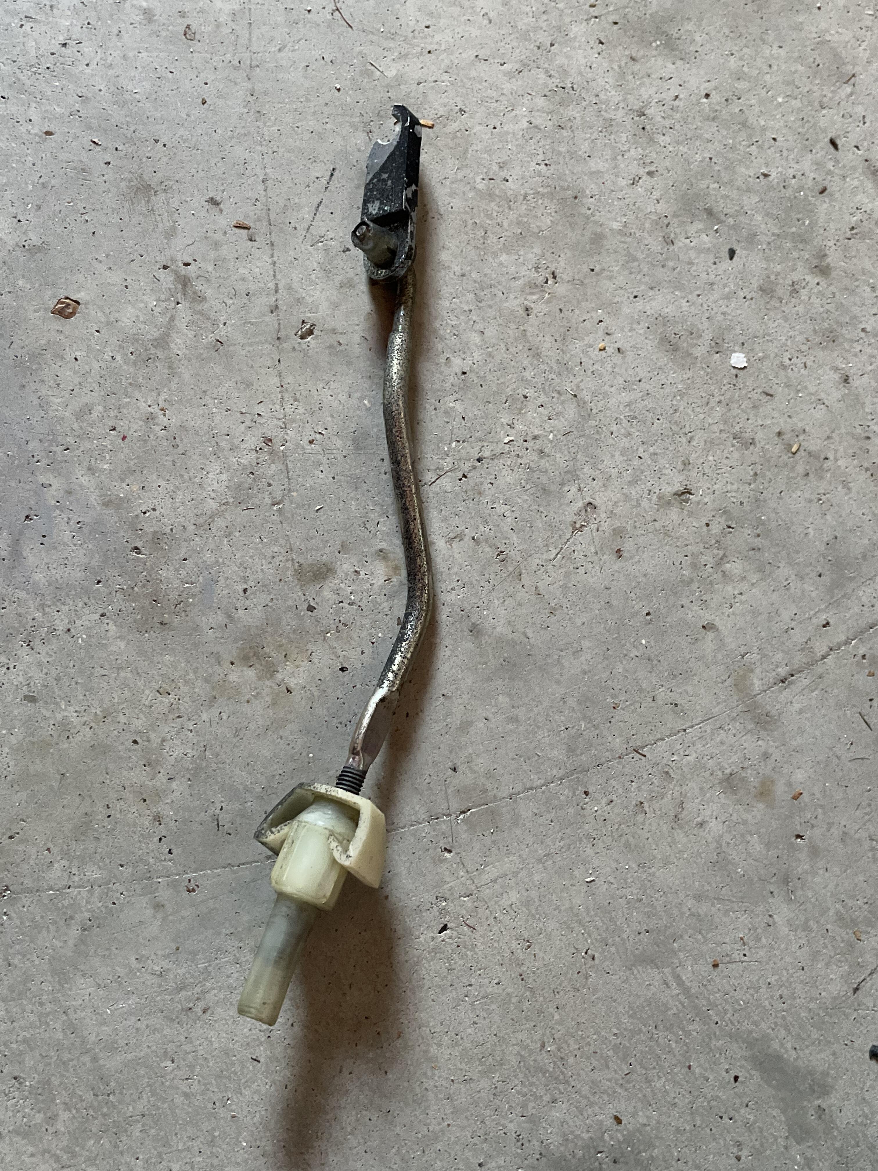

moving onto installing portions of the interior. I have door panel assemblies coming in for the driver door. I’ll need to repair the passenger door handle, the linkage is broke and I’ll need to hunt down the part.

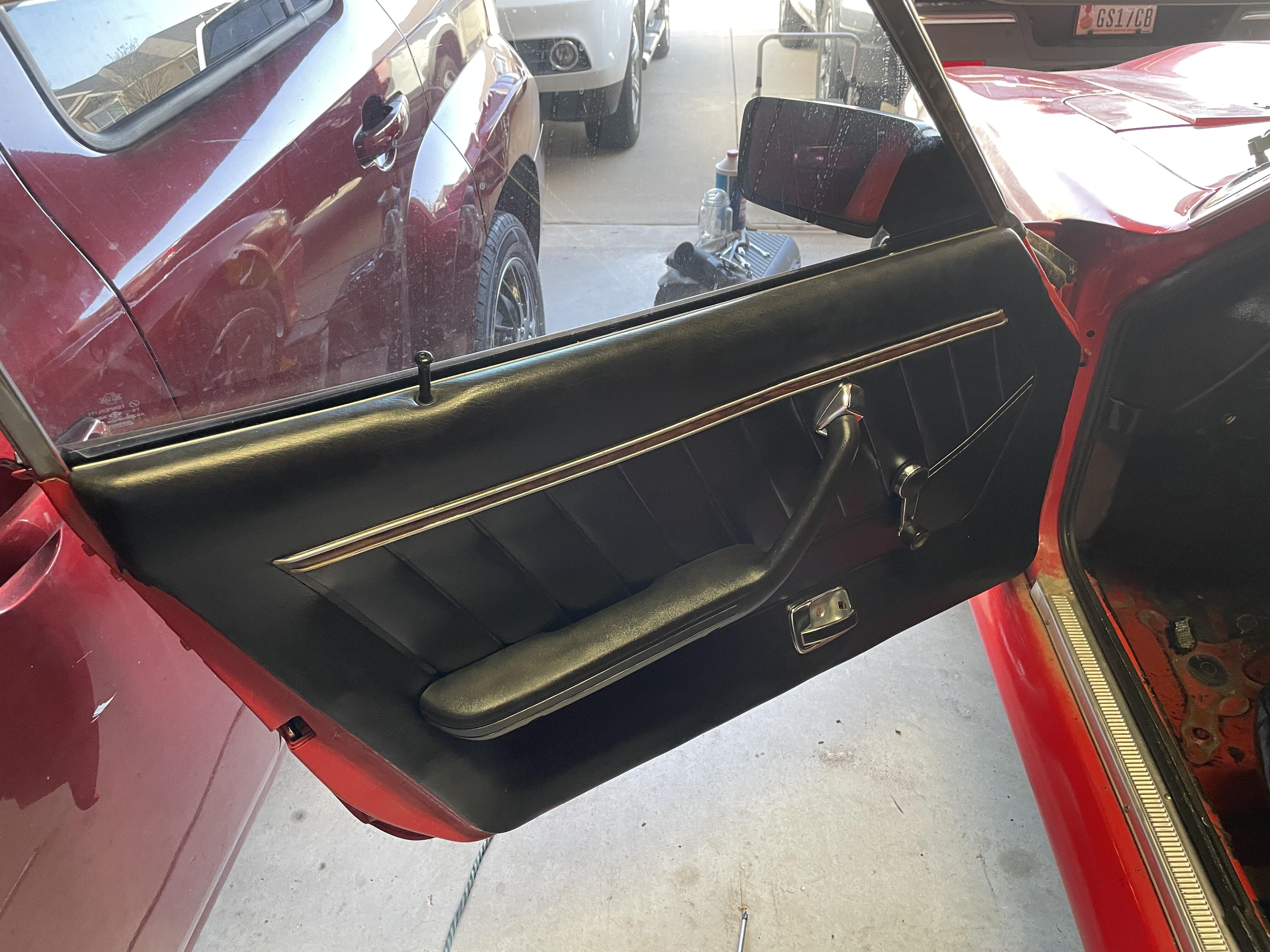

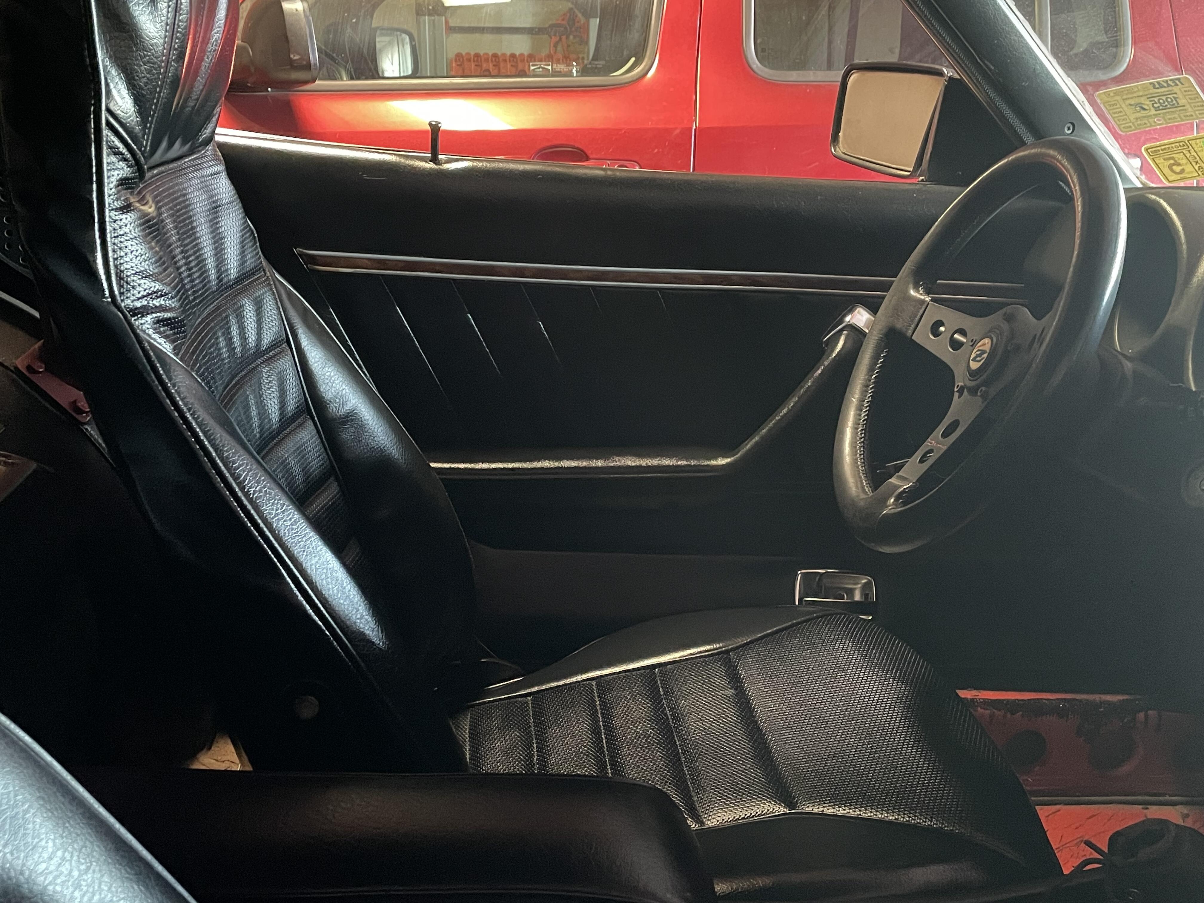

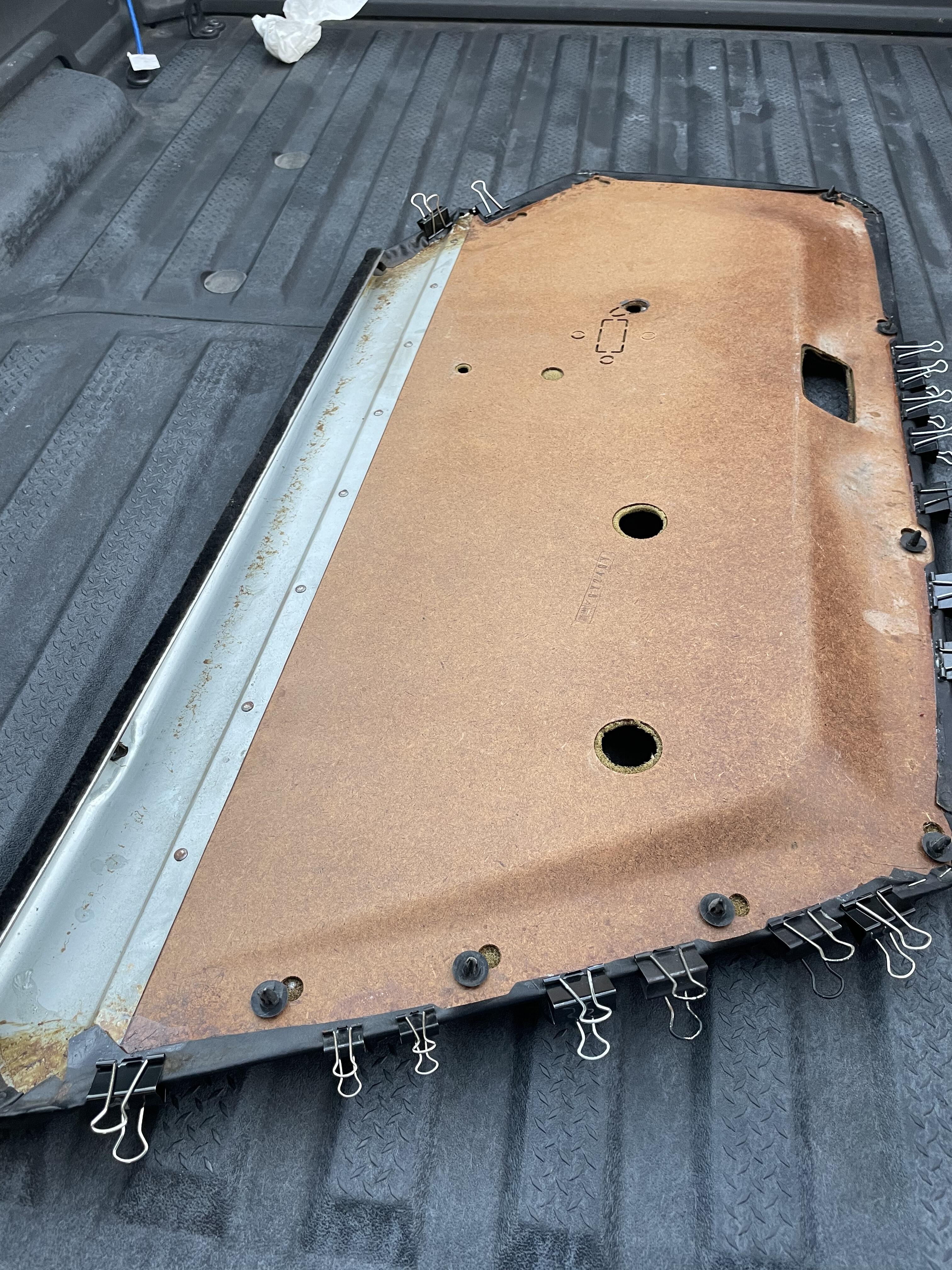

Focused on installing the interior door panels today. Parts came in! The door panels needed a bit of TLC so I used plastic glue to secure the peeling leather trim.
I tried to tape the interior trim due to peeling chrome…. But wasn’t working with the masking tape. I soft sanded the chrome trim down and hand painted the chrome silver. I think it came out ok.

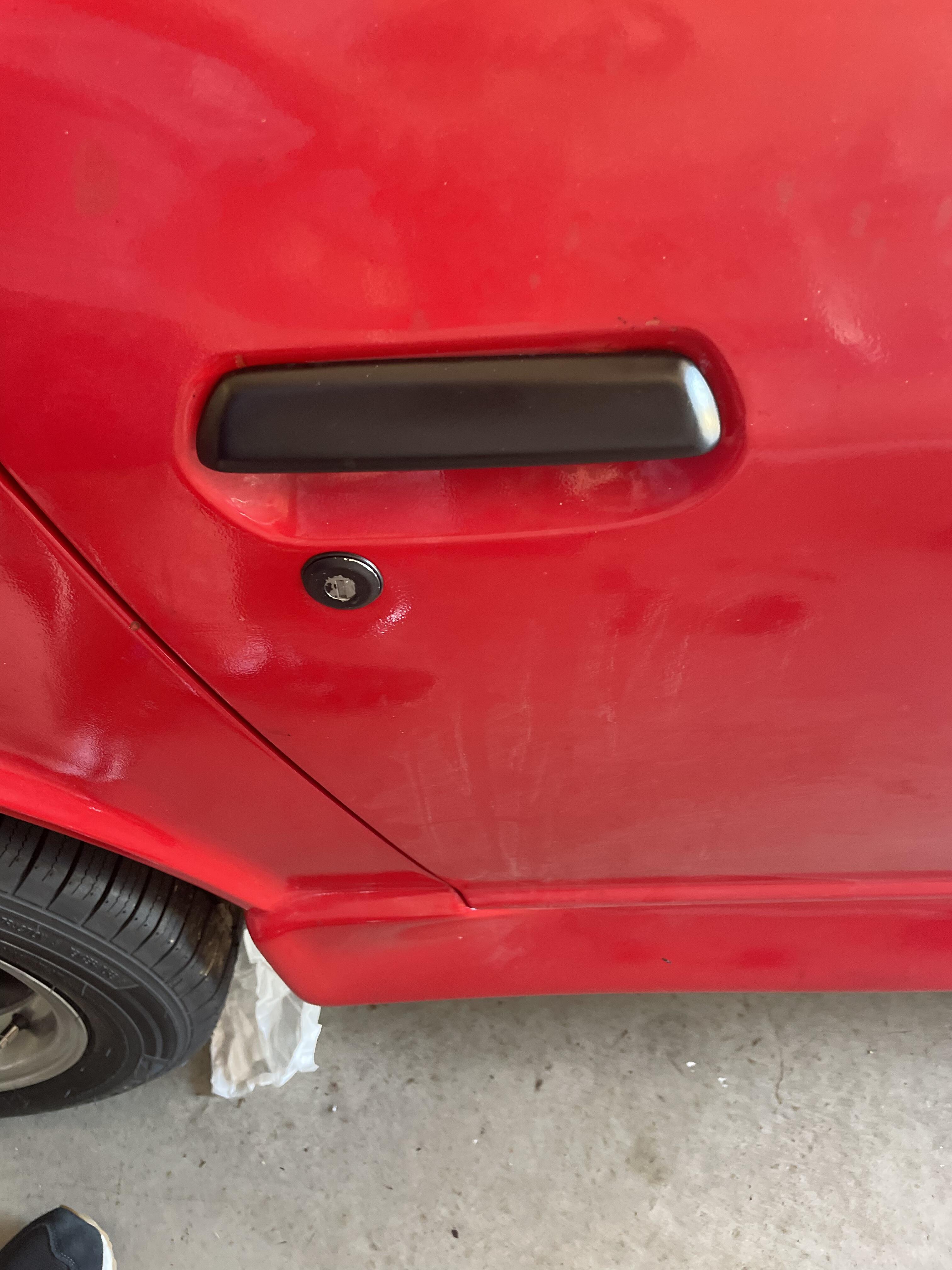

 Passenger door handle is broken. Waiting for a new handle and lock to come in to do the repair. I’ll do some more research to see if the linkage is salvageable.

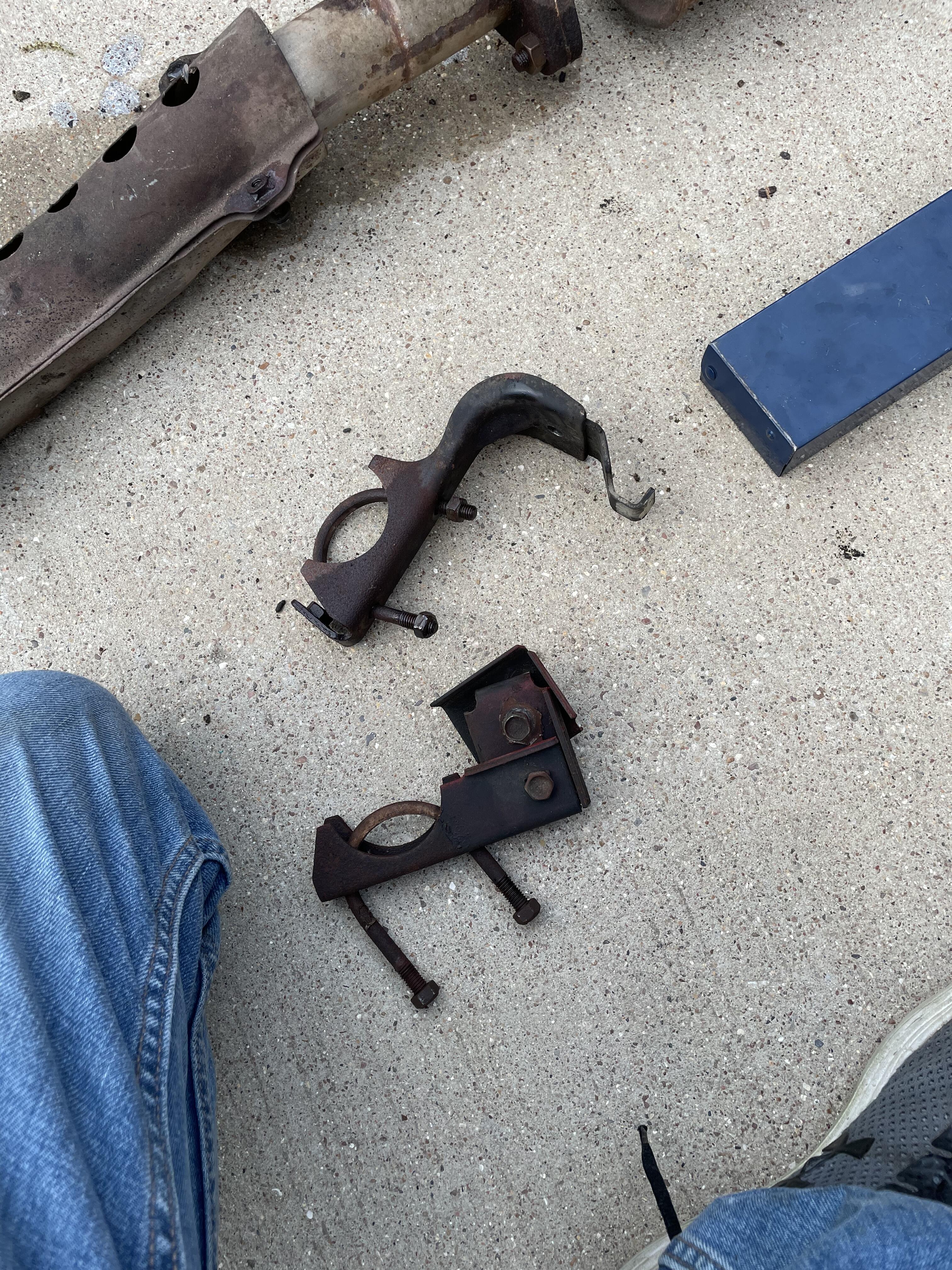

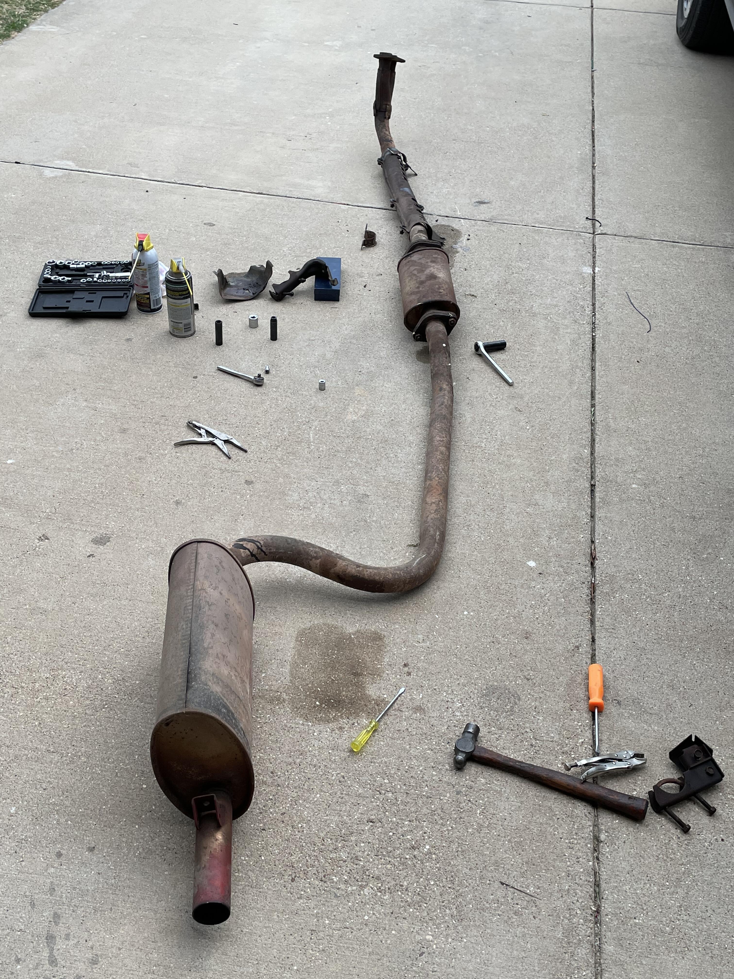

Took the time and used Vice grips to help remove the exhaust. I’m keeping these two clamp/connectors  so I can put the new exhaust onto the car.

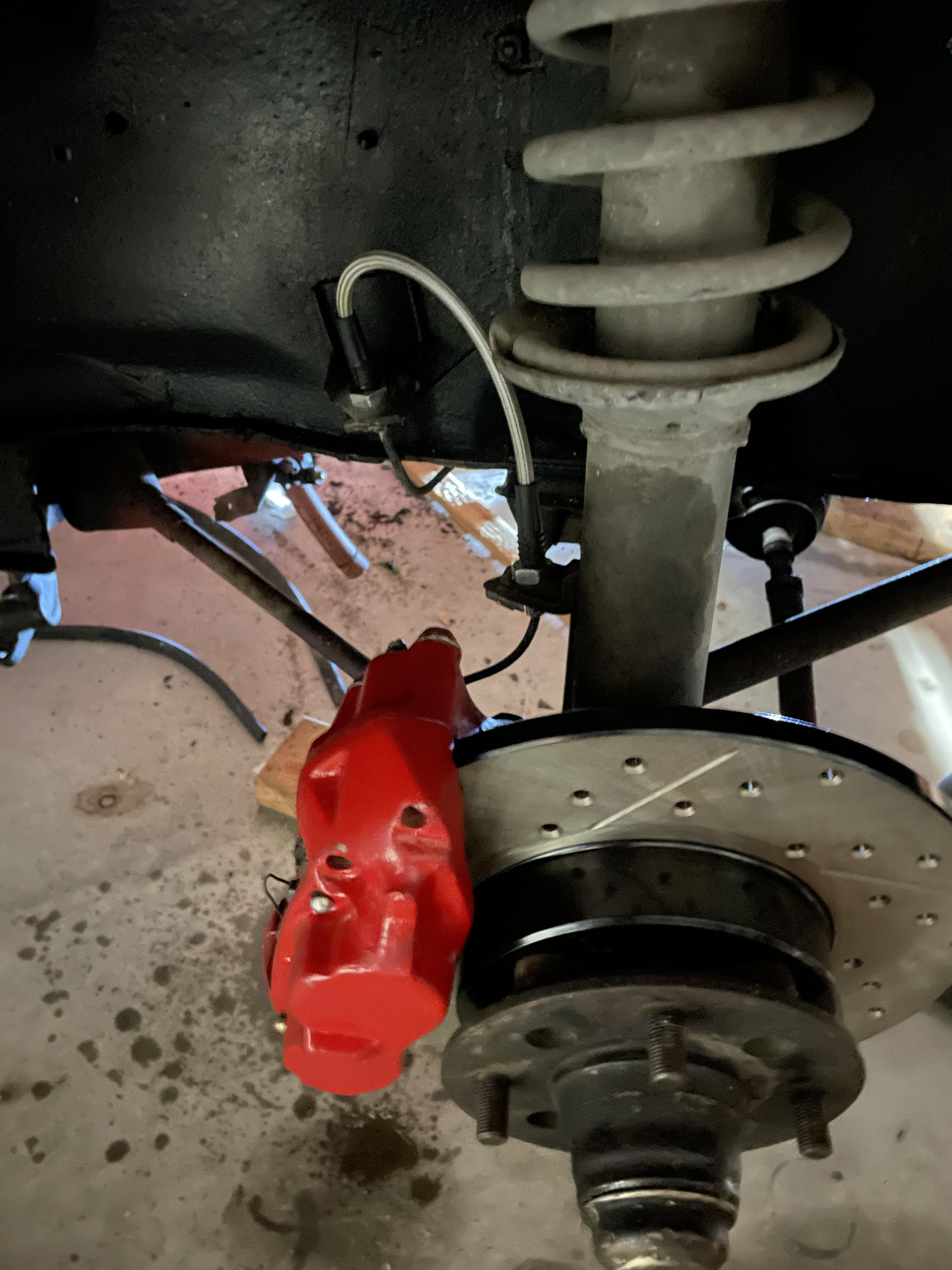

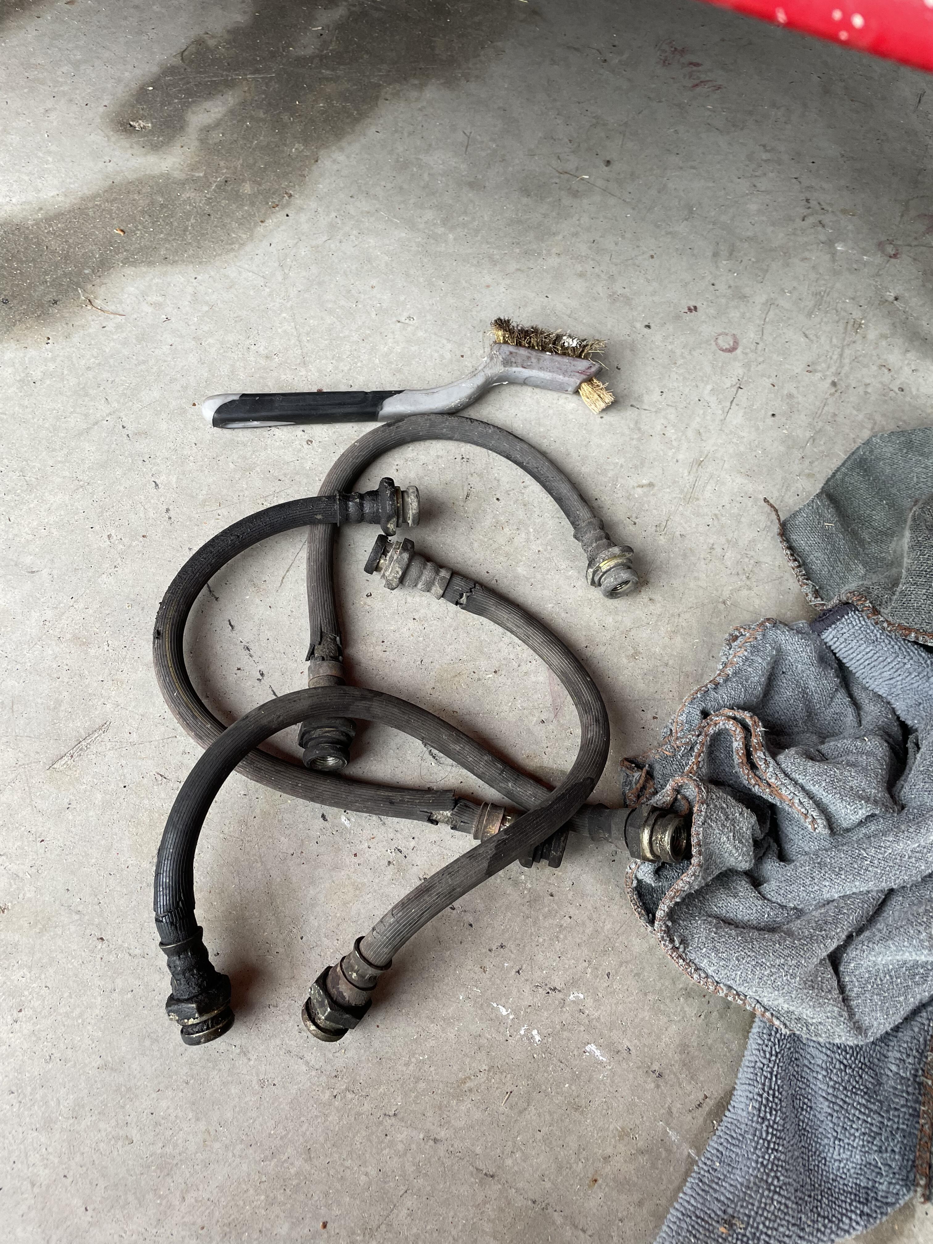

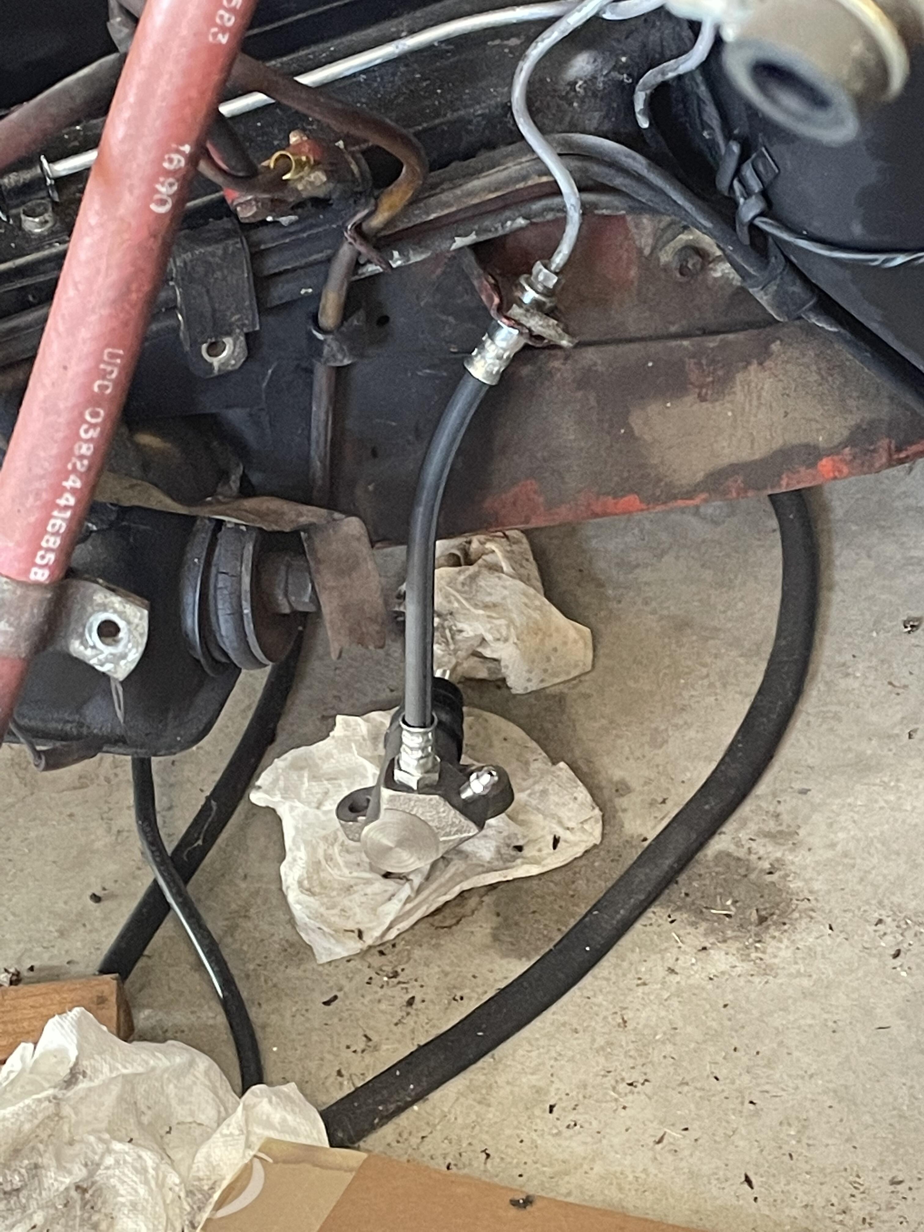

Had a mechanic friend stop by yesterday to help with the brakes. Brake hoses, which I didn’t swap out, were trashed. We ended up replacing them and we were able to bleed the brakes.
in addtion, the clutch slave cylinder was installed while I turned my back. I advised my friend “you don’t know what you are getting into” but he figured it out once the cursing started.

Additionally installed the new handle for the passenger door with the seized cylinder.  It ideal reinstalling the seized cylinder but whatever. It be like that sometimes.

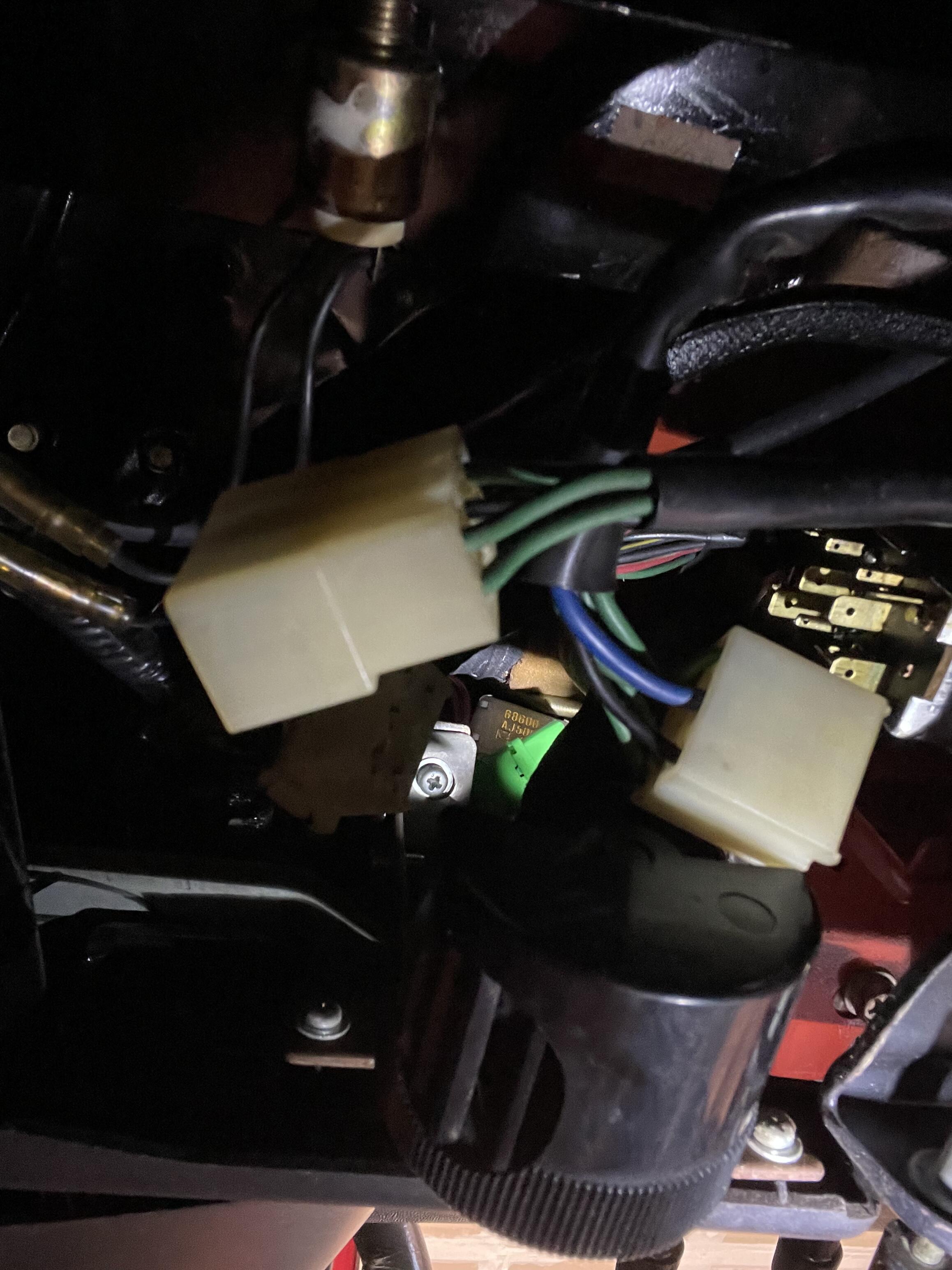

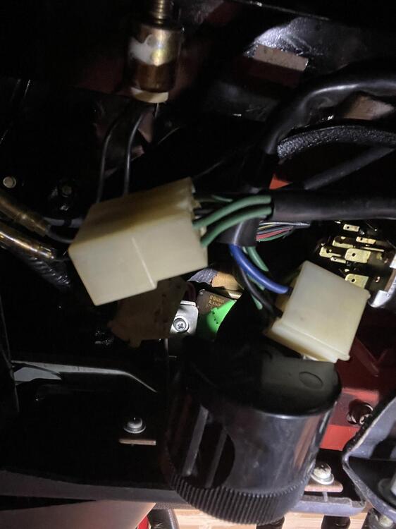

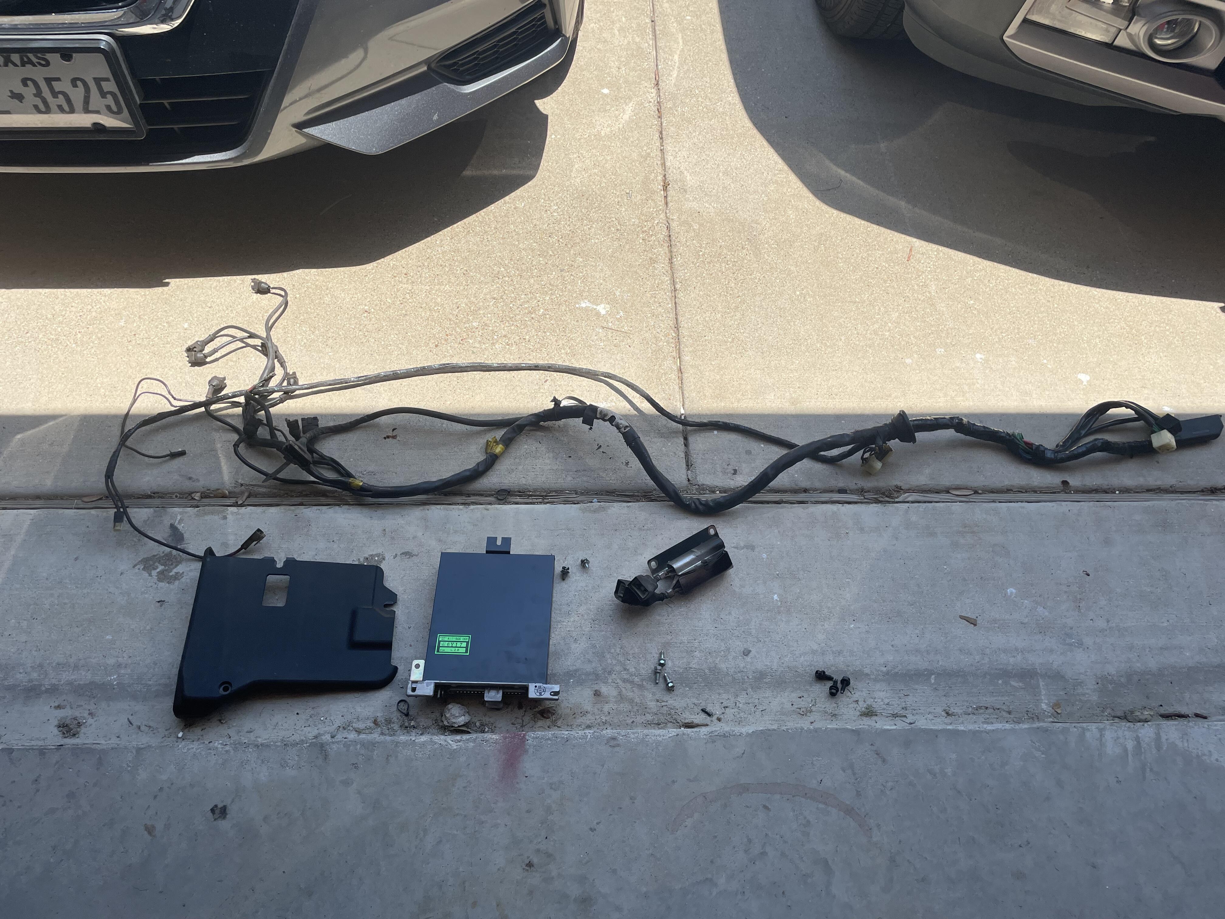

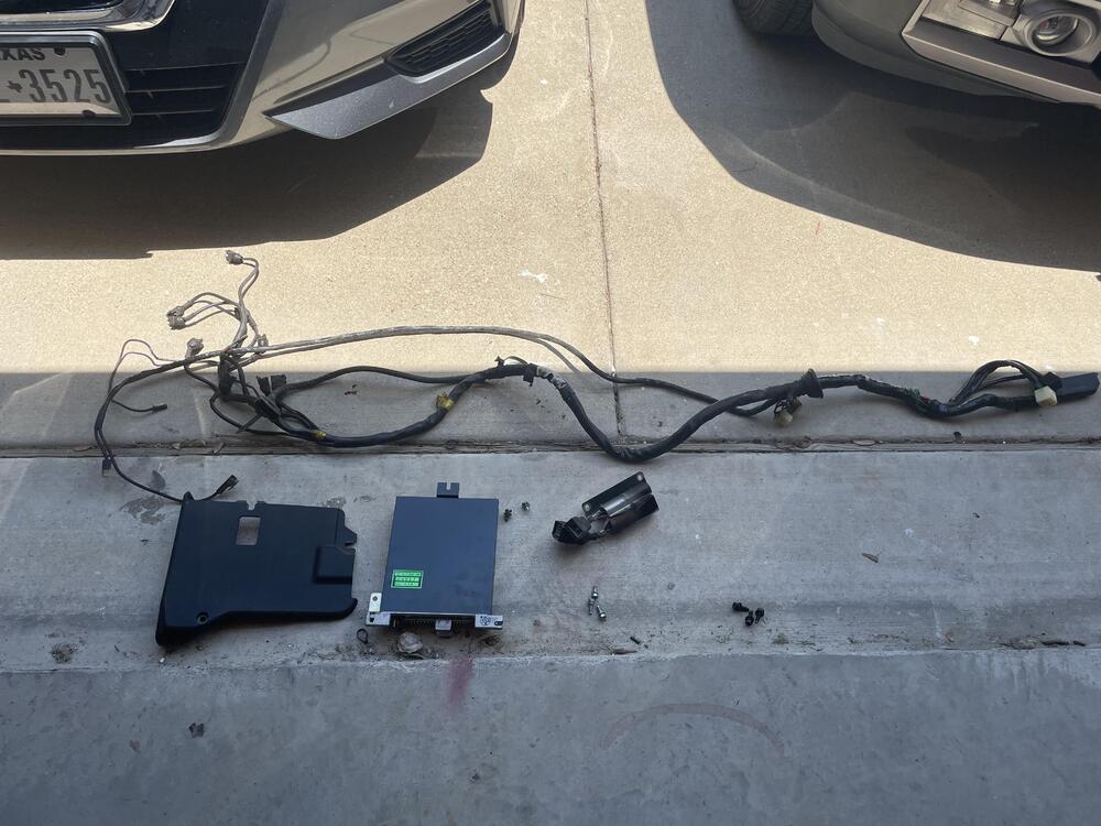

The job gave us a family day today so we can have a 4 day weekend for Memorial Day. Took today removing the EFI cables.
relatively easy, I did use a door clip remove to disconnect electric connections and fuses. Made short work of it. EFI is now removed and I’m ready to work on assembling the engine, transmission, and clutch.

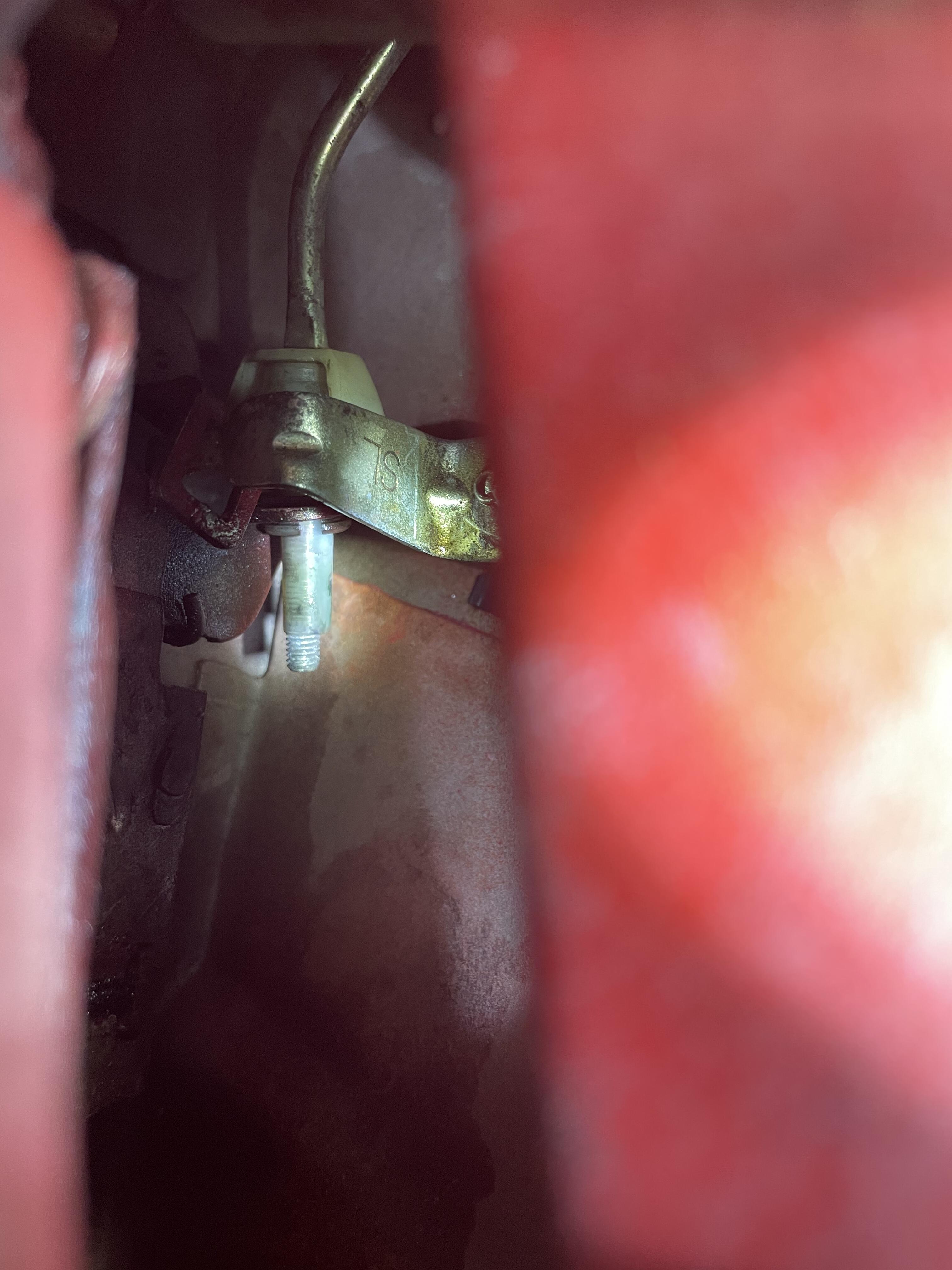

I used a rope and a wooden handle to fit up the gear shift hole to help pull the transmission up from inside the car. When I got it up where I wanted it I tied the handle down onto the tunnel inside the cabin to hold it in place. This picture may help...

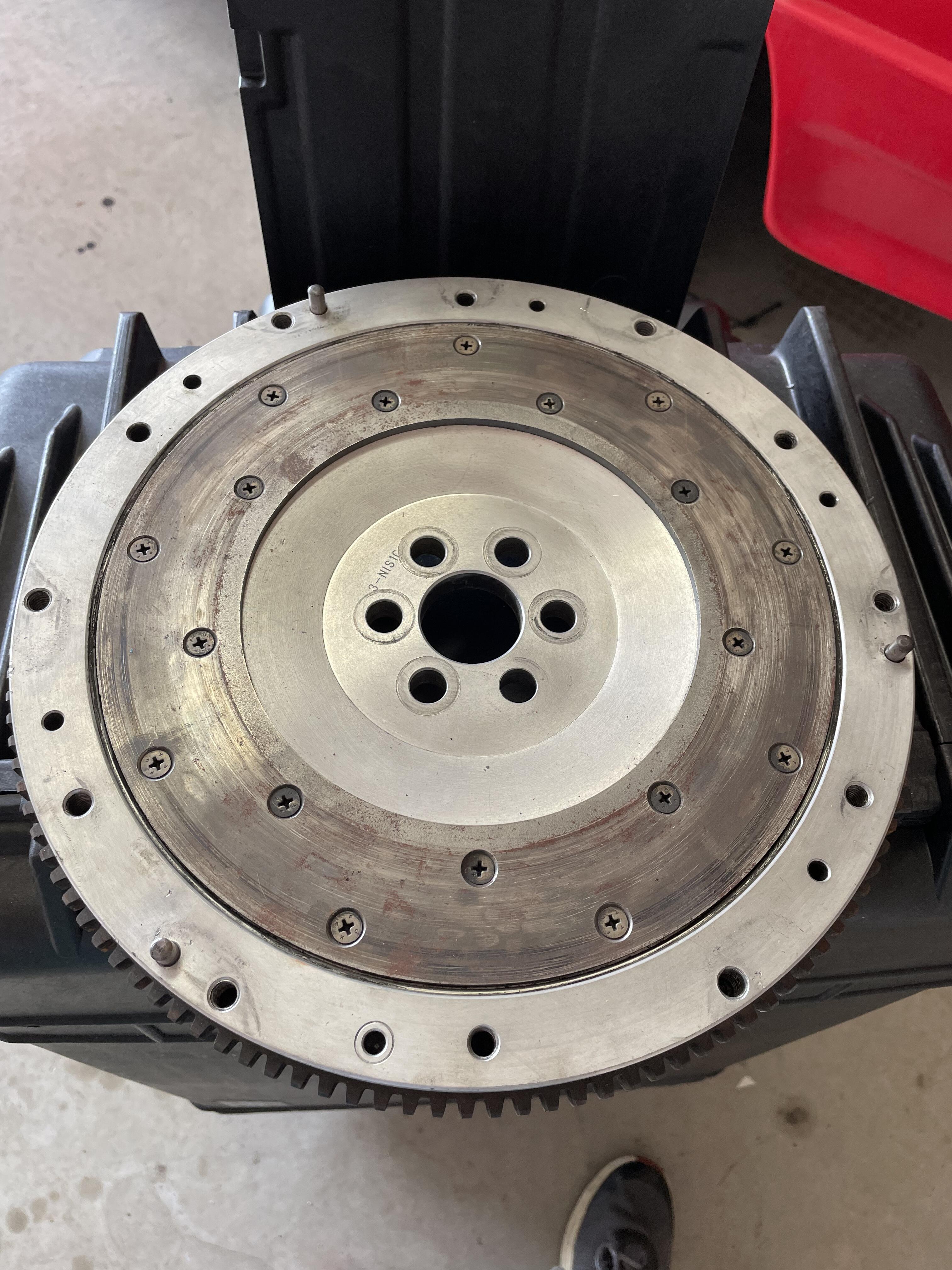

Ok I’ll keep that in mind. May need a new flywheel.
This one is a used aluminum flywheel. It does have a replaceable friction plate.. I’ll need to see where I can find one.

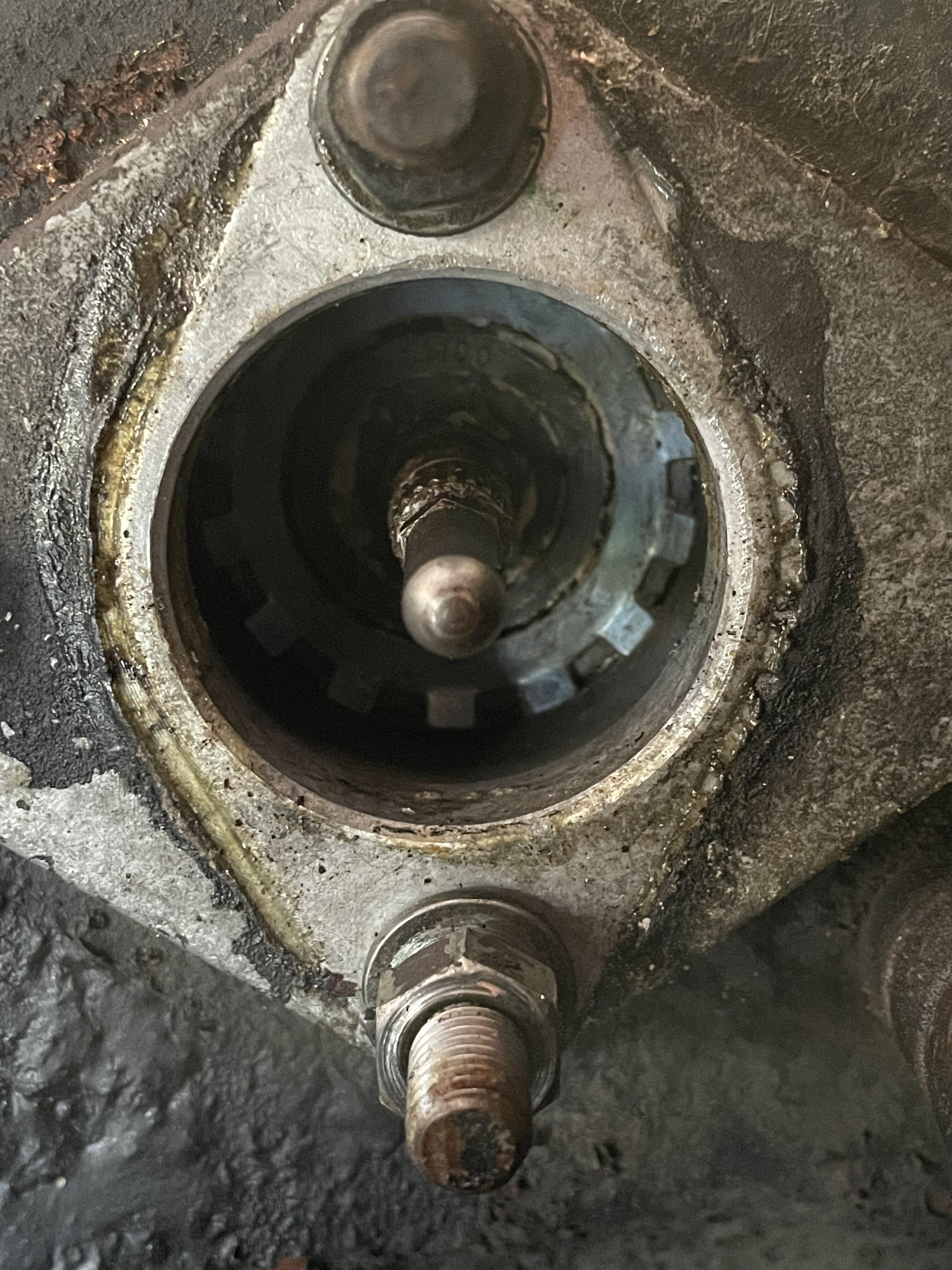

That looks like you could have it resurfaced? My machinest measured the depth around the friction disc's screw holes and said there was enough for a light cut. Hopefully your's is too. Well maybe you could just get some shorter screws. LOL
Looks pretty shallow on some???
