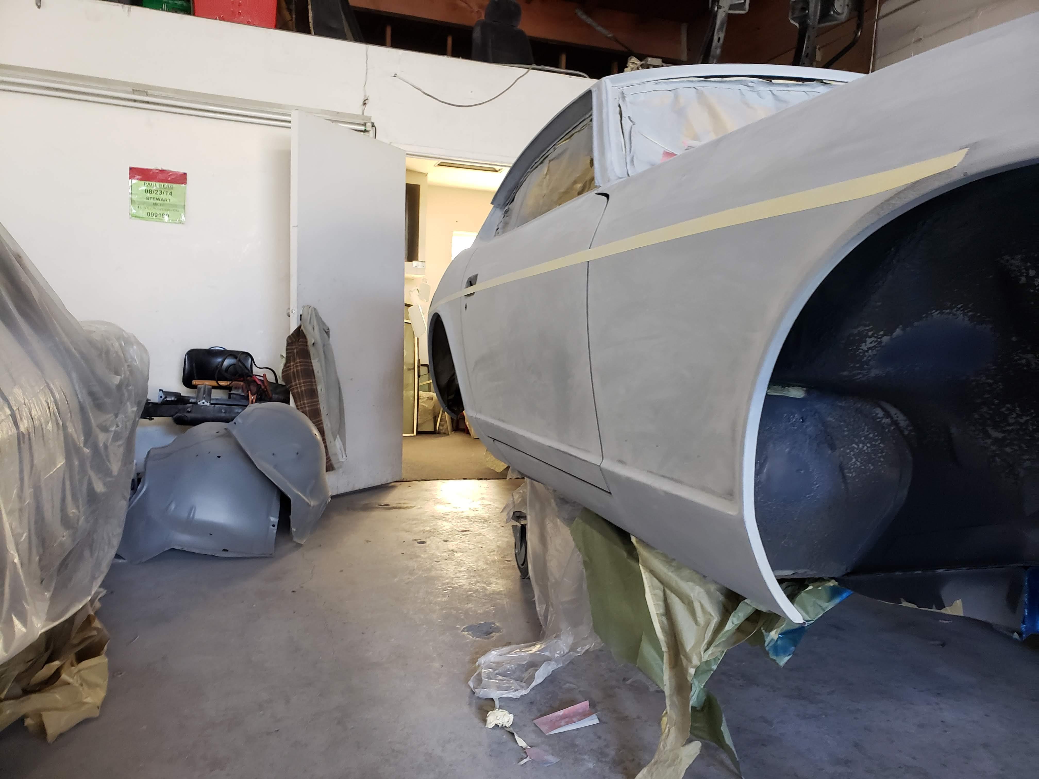

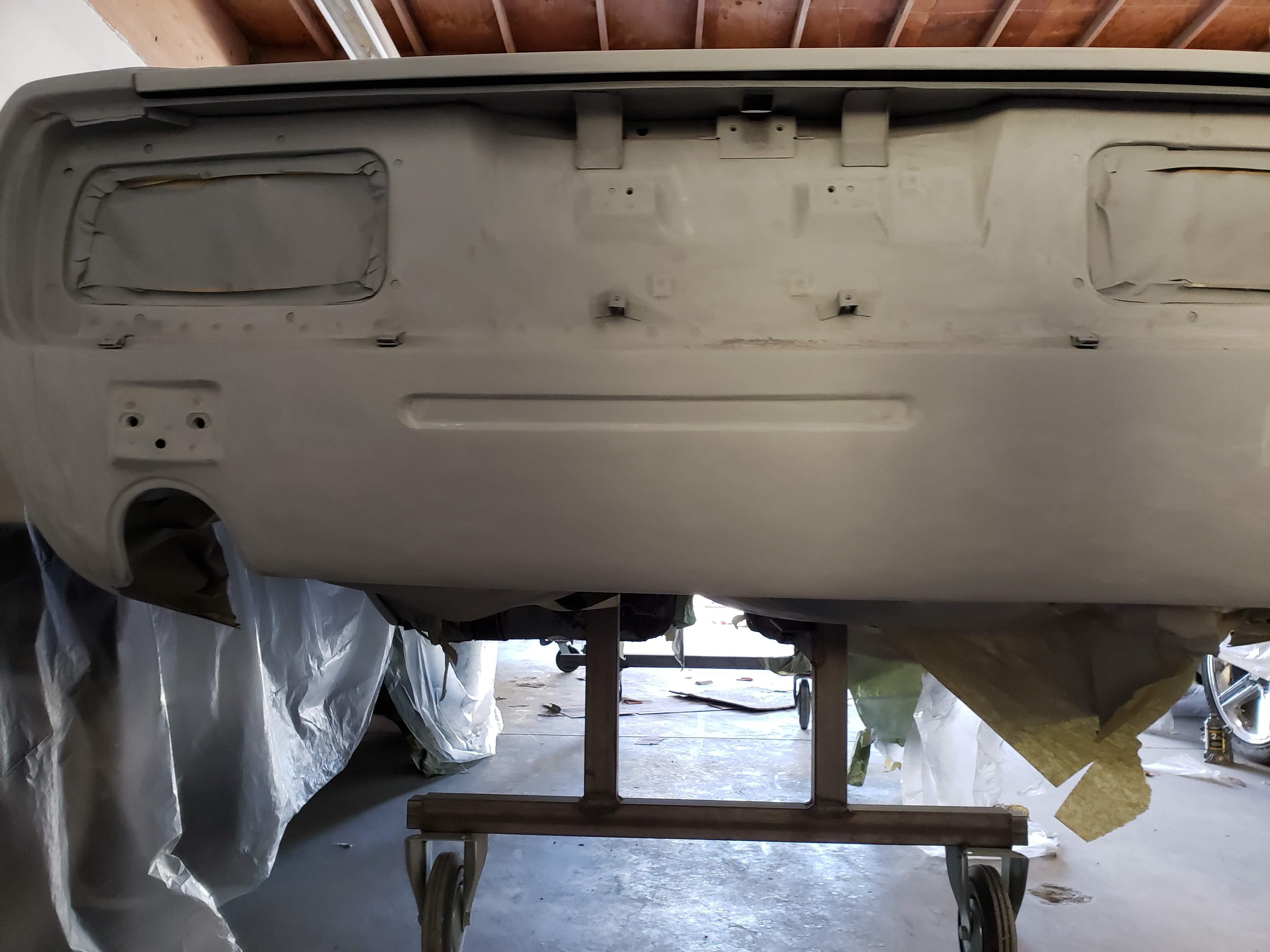

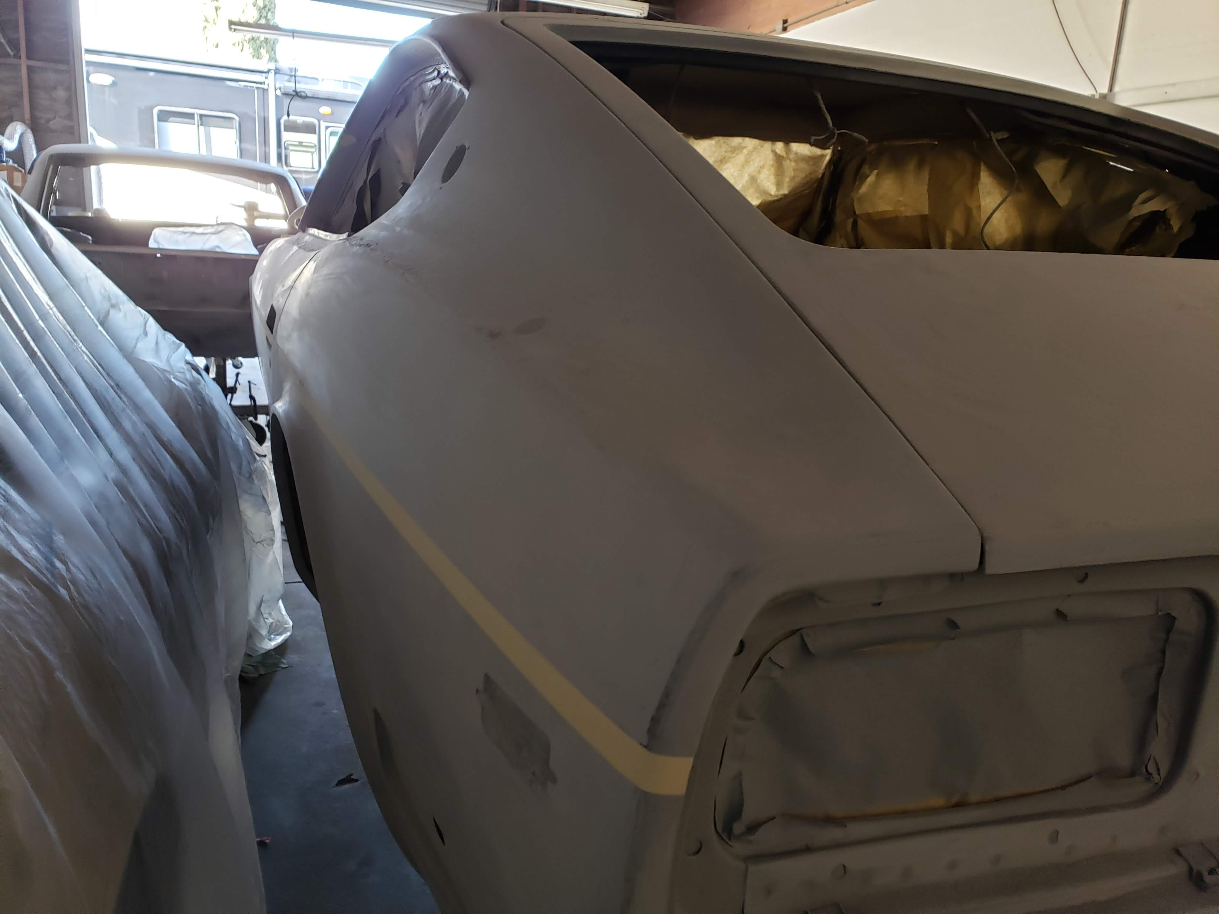

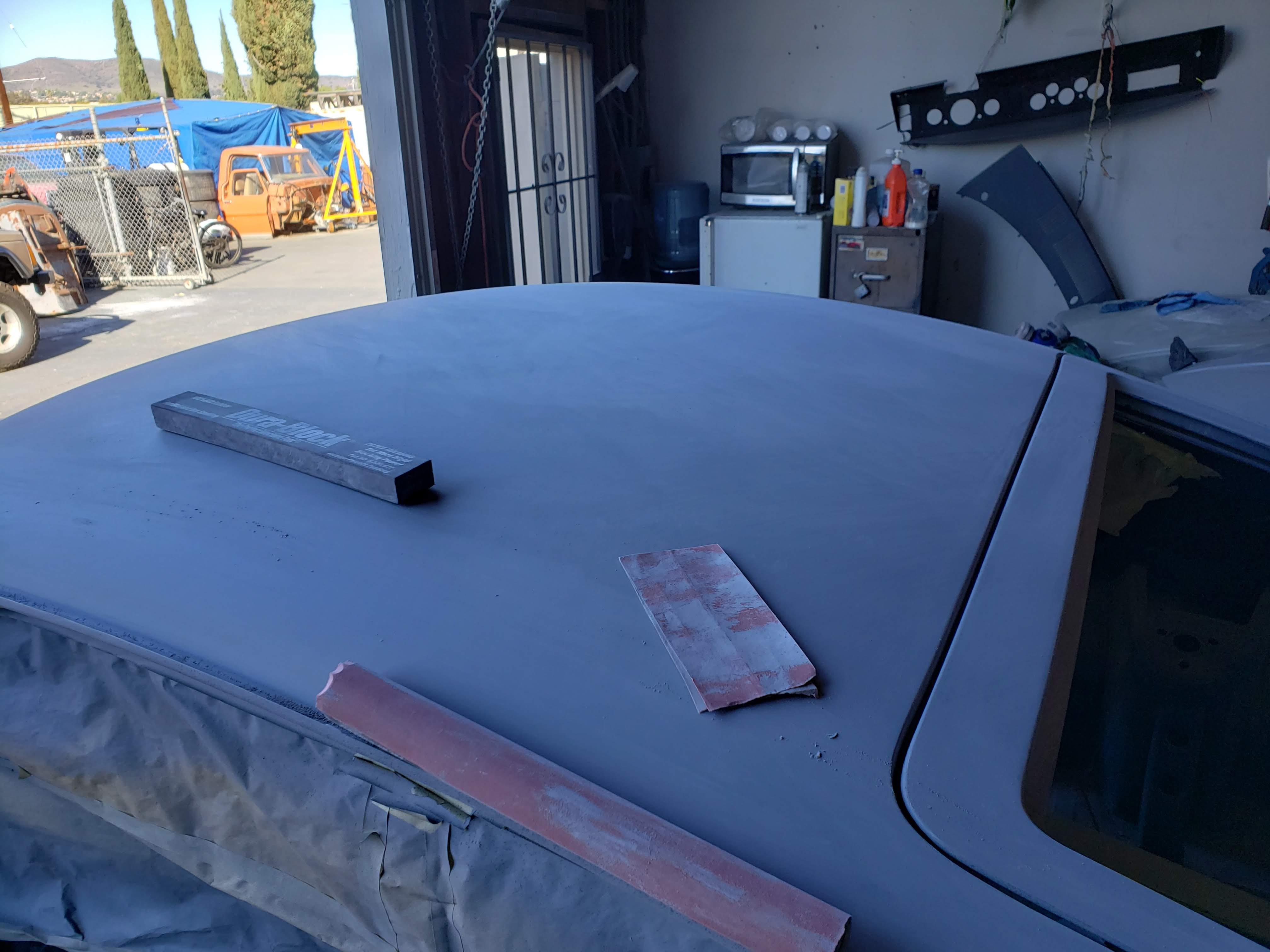

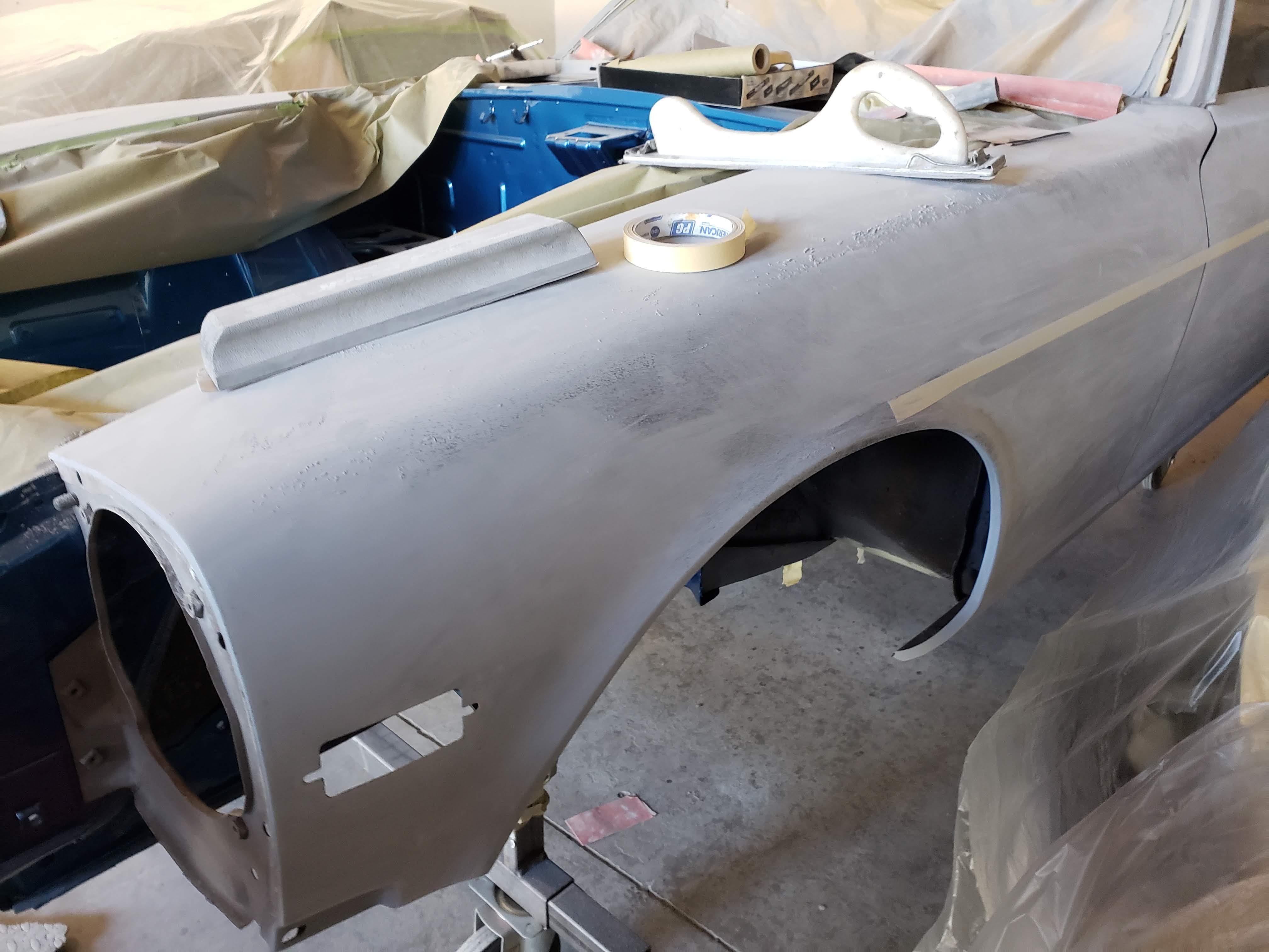

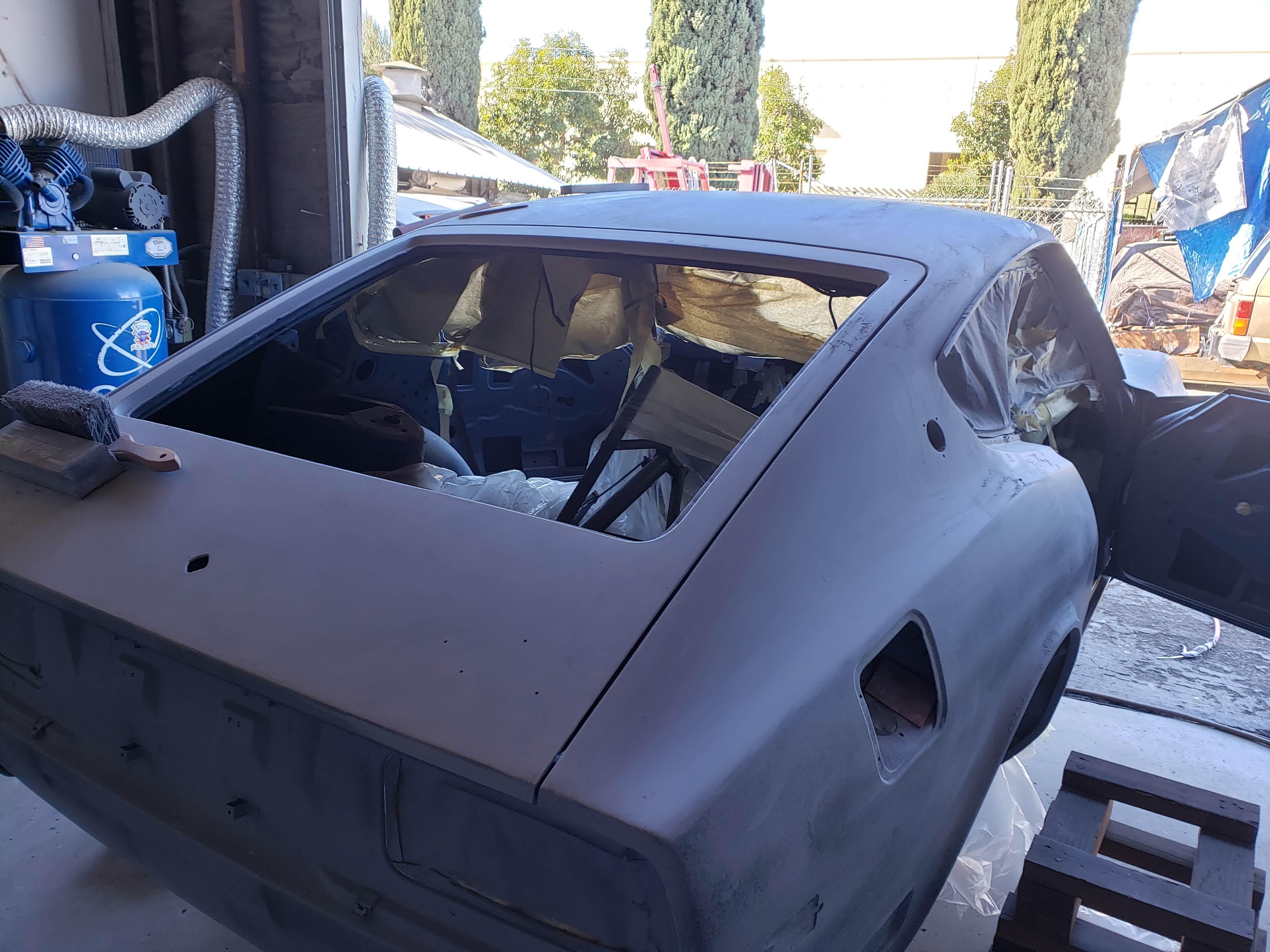

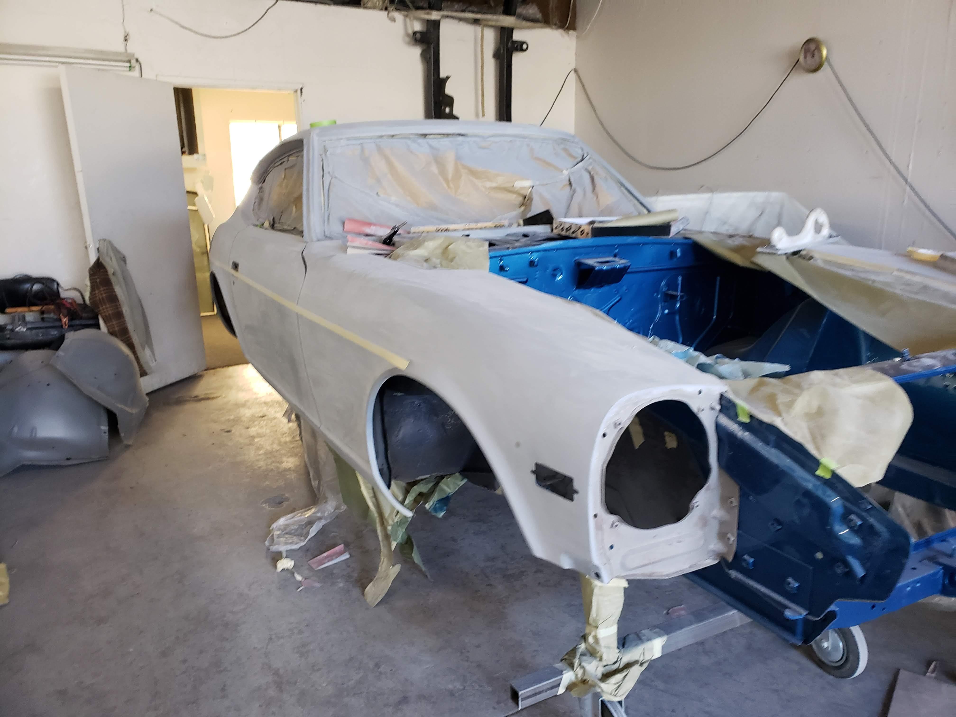

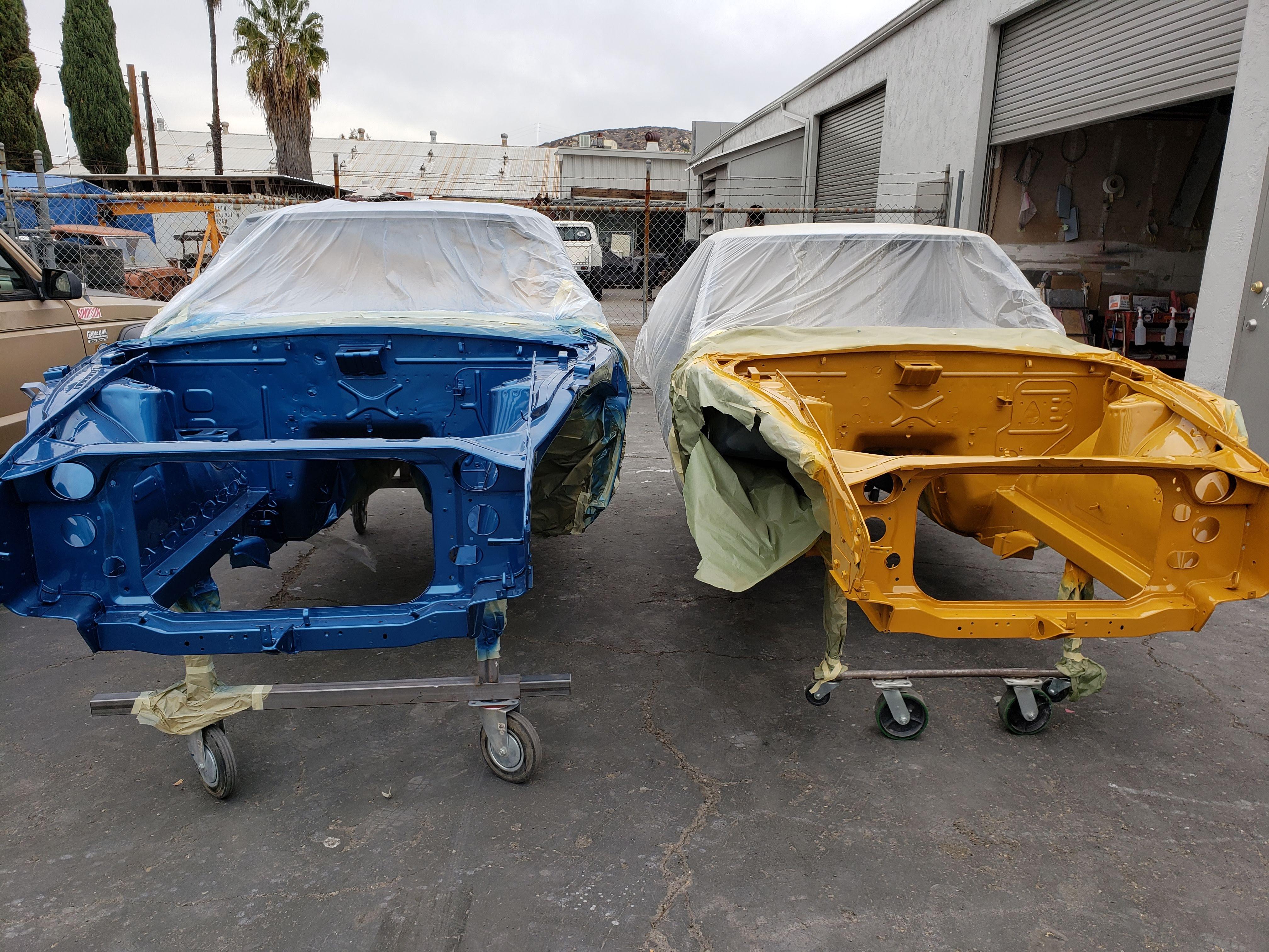

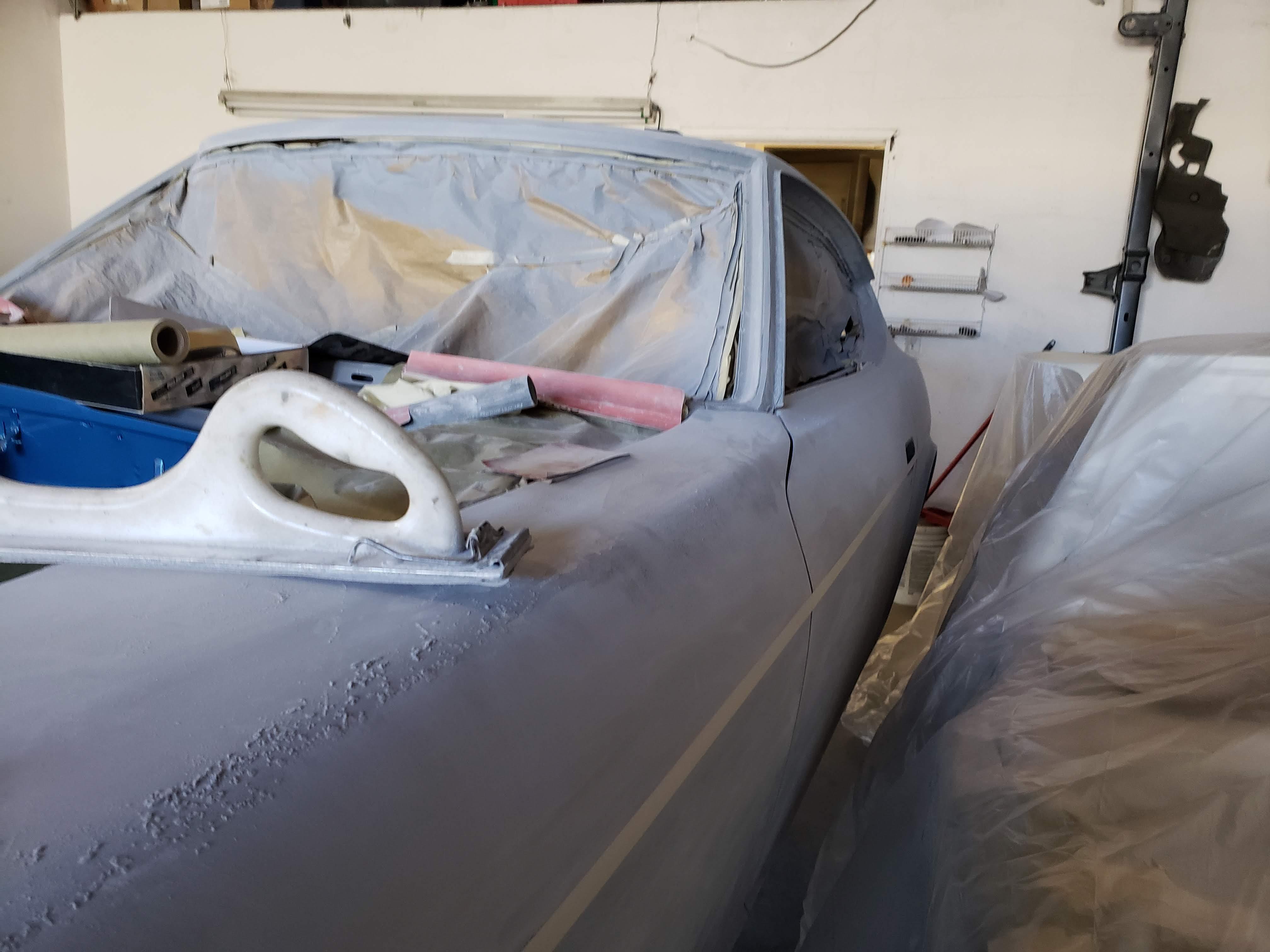

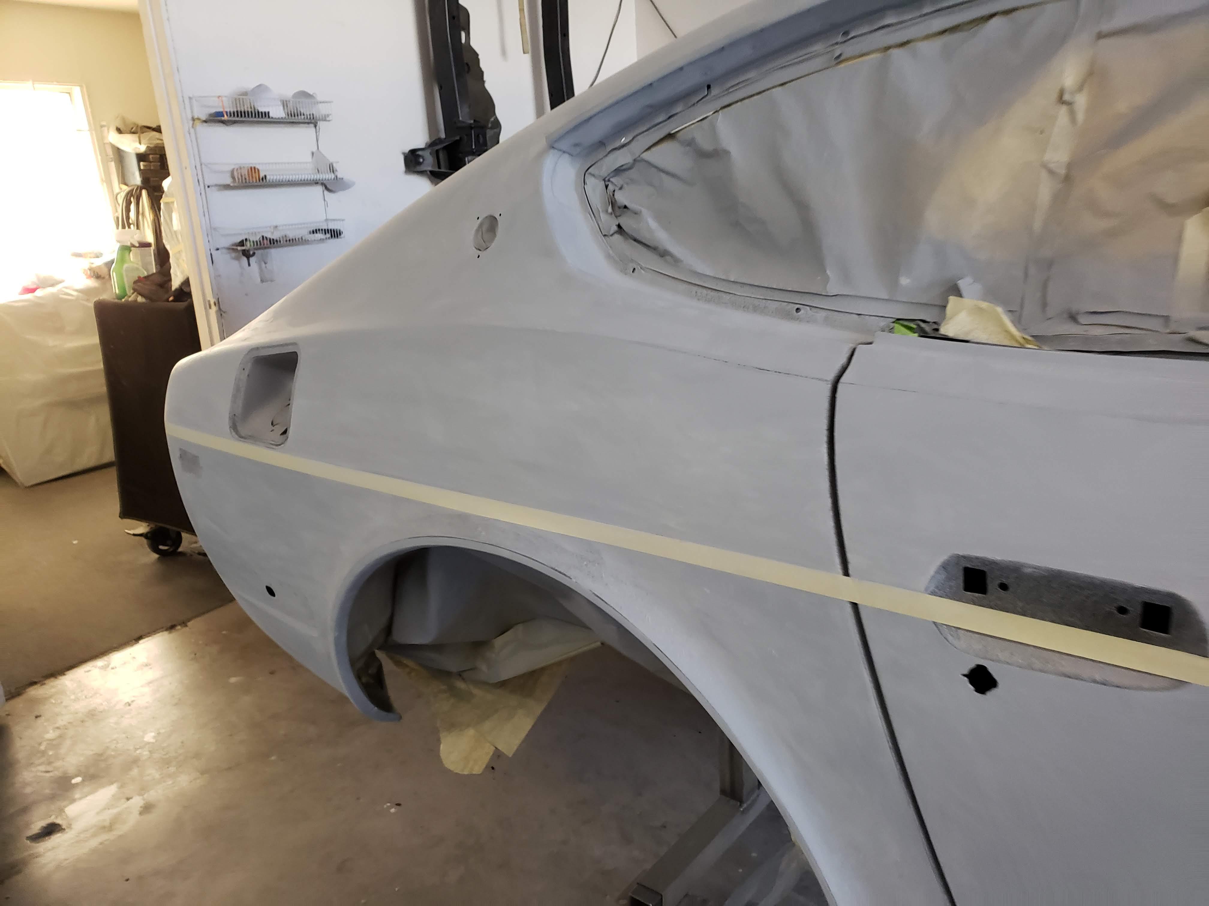

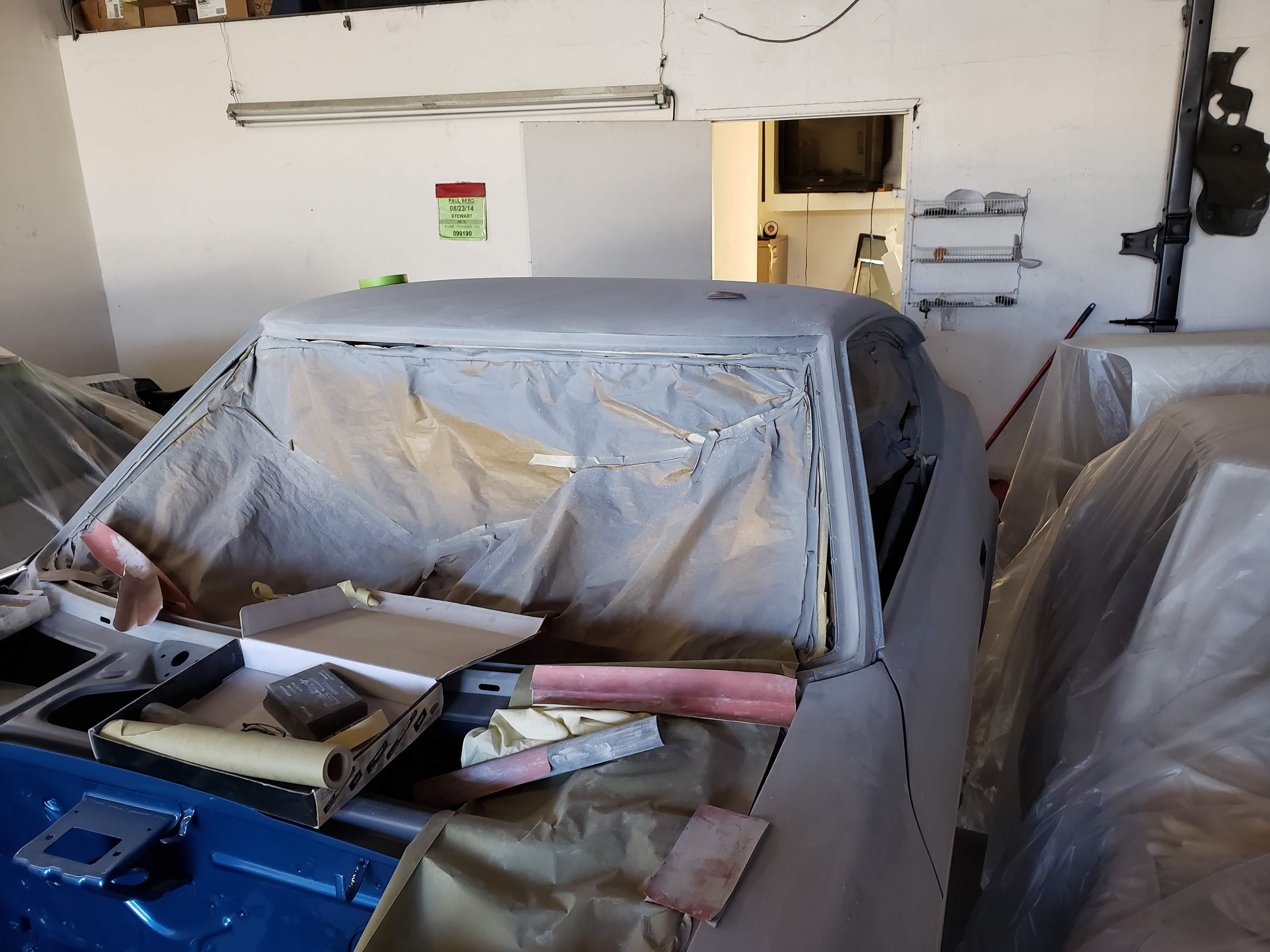

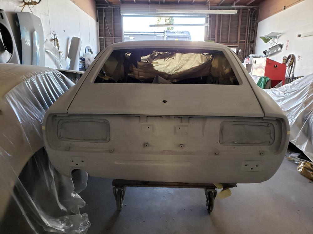

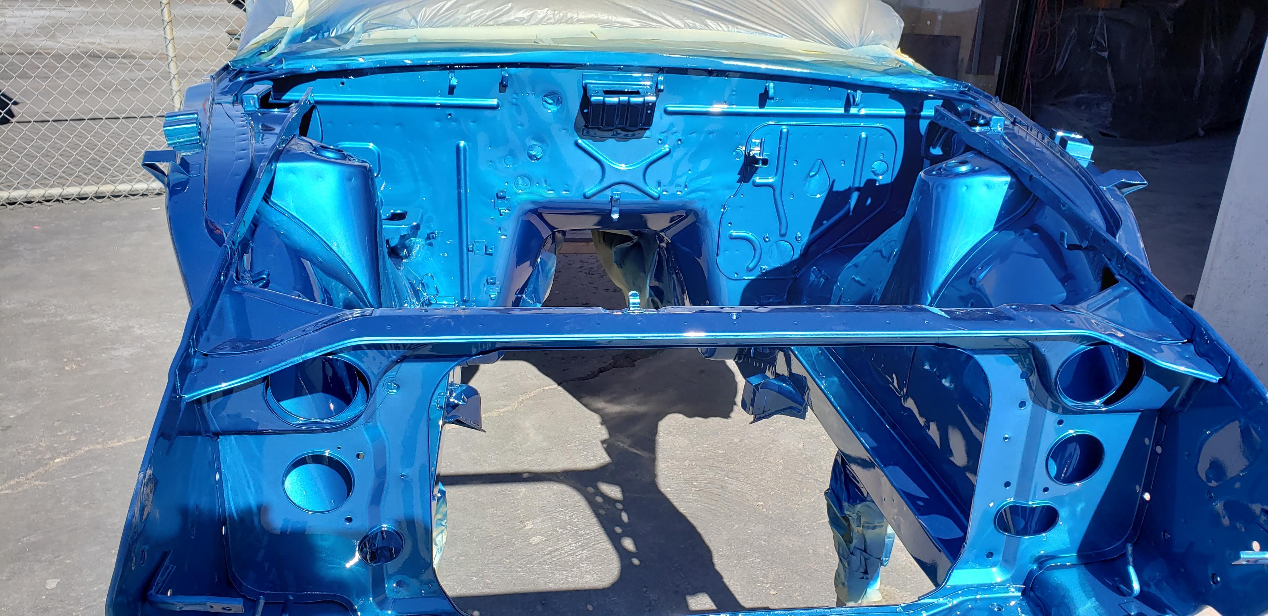

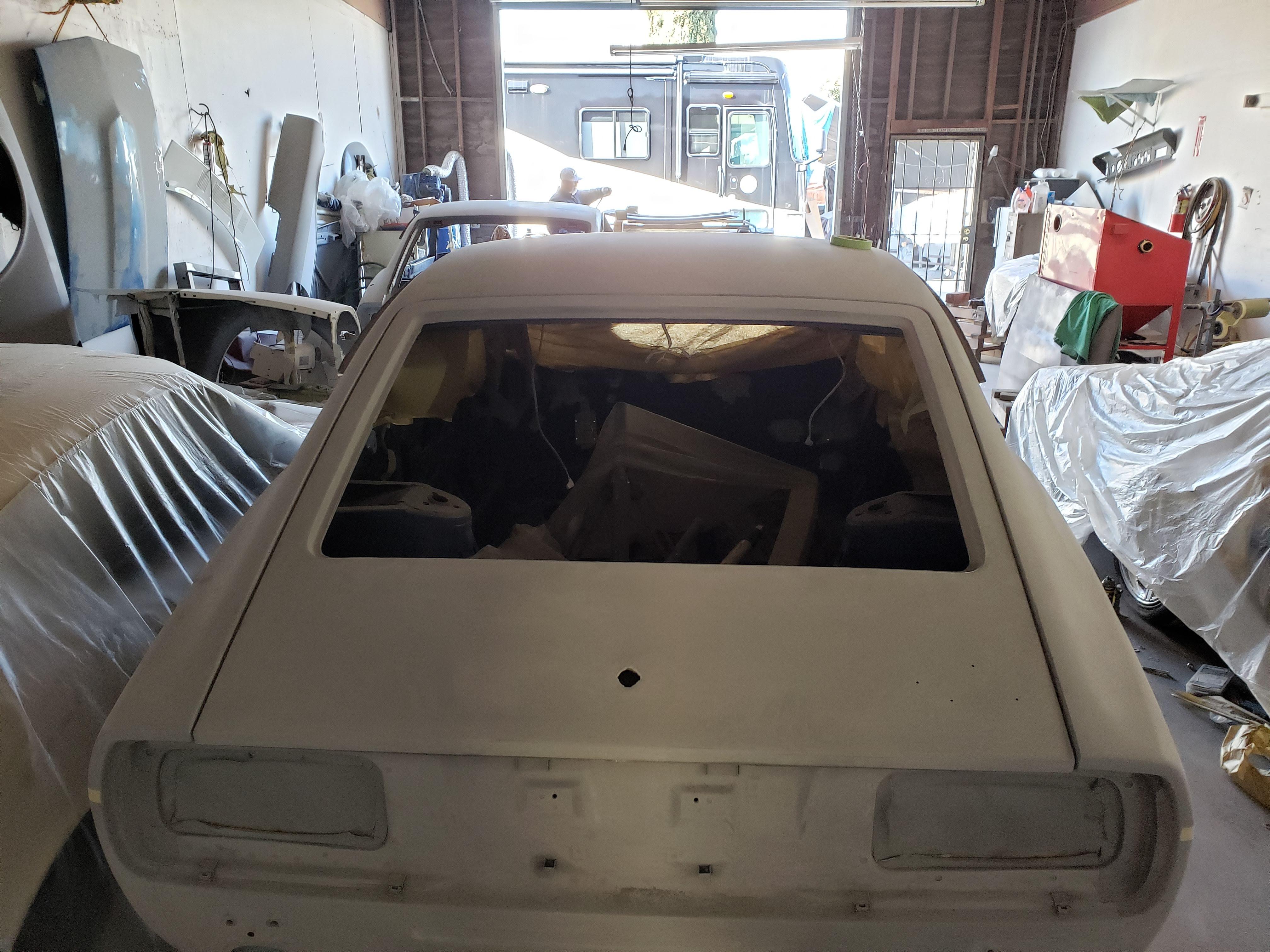

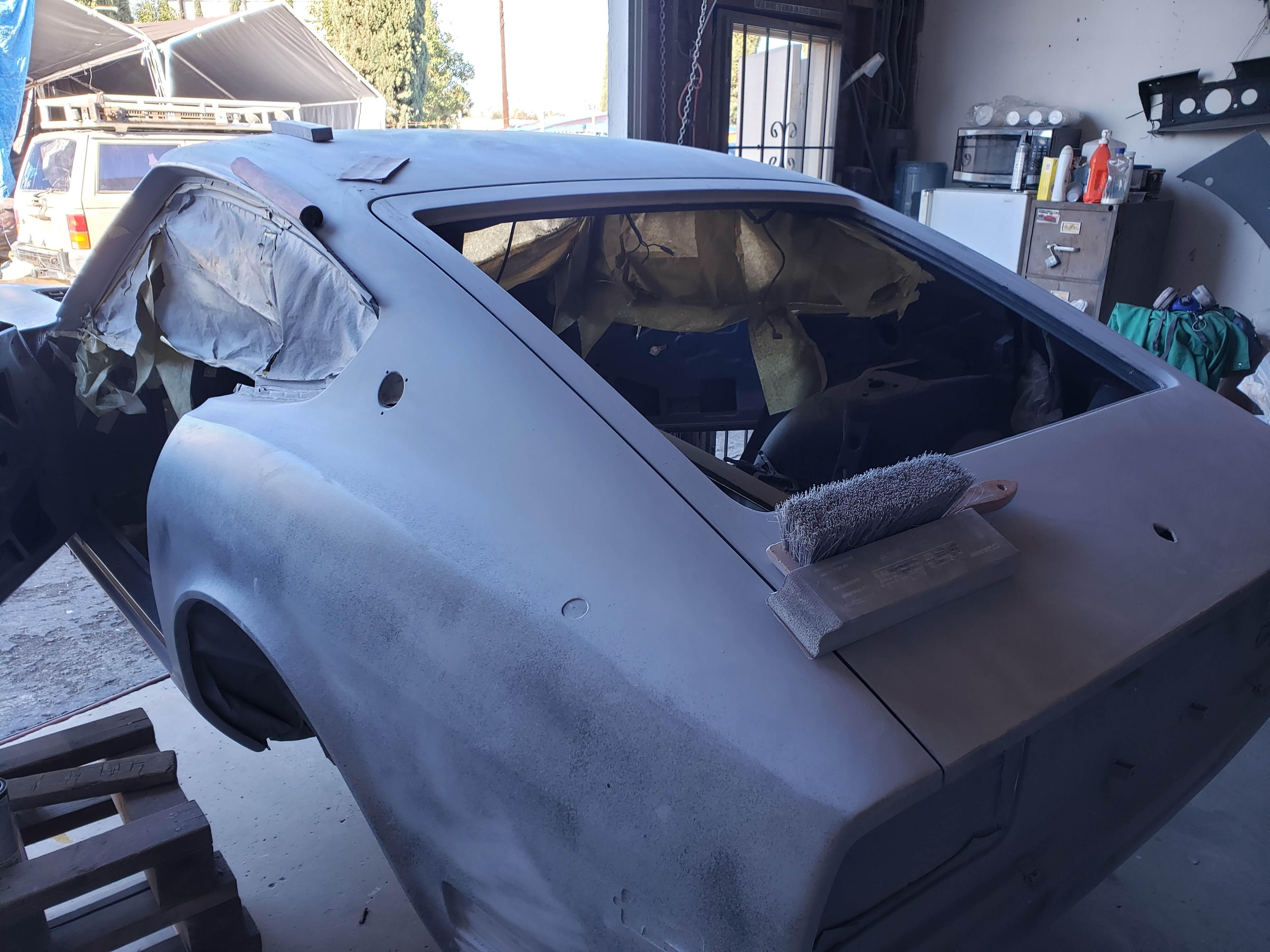

More photos from the paint shop.  Progress seems to be painfully slow as I have pretty much all of the suspension and undercarriage items complete along with the motor, but no structure to attach it to.  I am chomping at the bit to start assembling things here.  I still have stuff to keep me busy but would rather be putting parts on the car.  Latest batch of plated parts will be back in a week.  Will get working on the exhaust manifold, handbrake cable and finish up the dash here shortly.
They do beautiful paint work!! It's a shame they are so far away from me. It is always nice to have someone paint a Datsun that knows Datsun's!
Yes, it is nice to have someone with his quality of work.  The delay is due to the number of Z cars he is working on concurrently.
