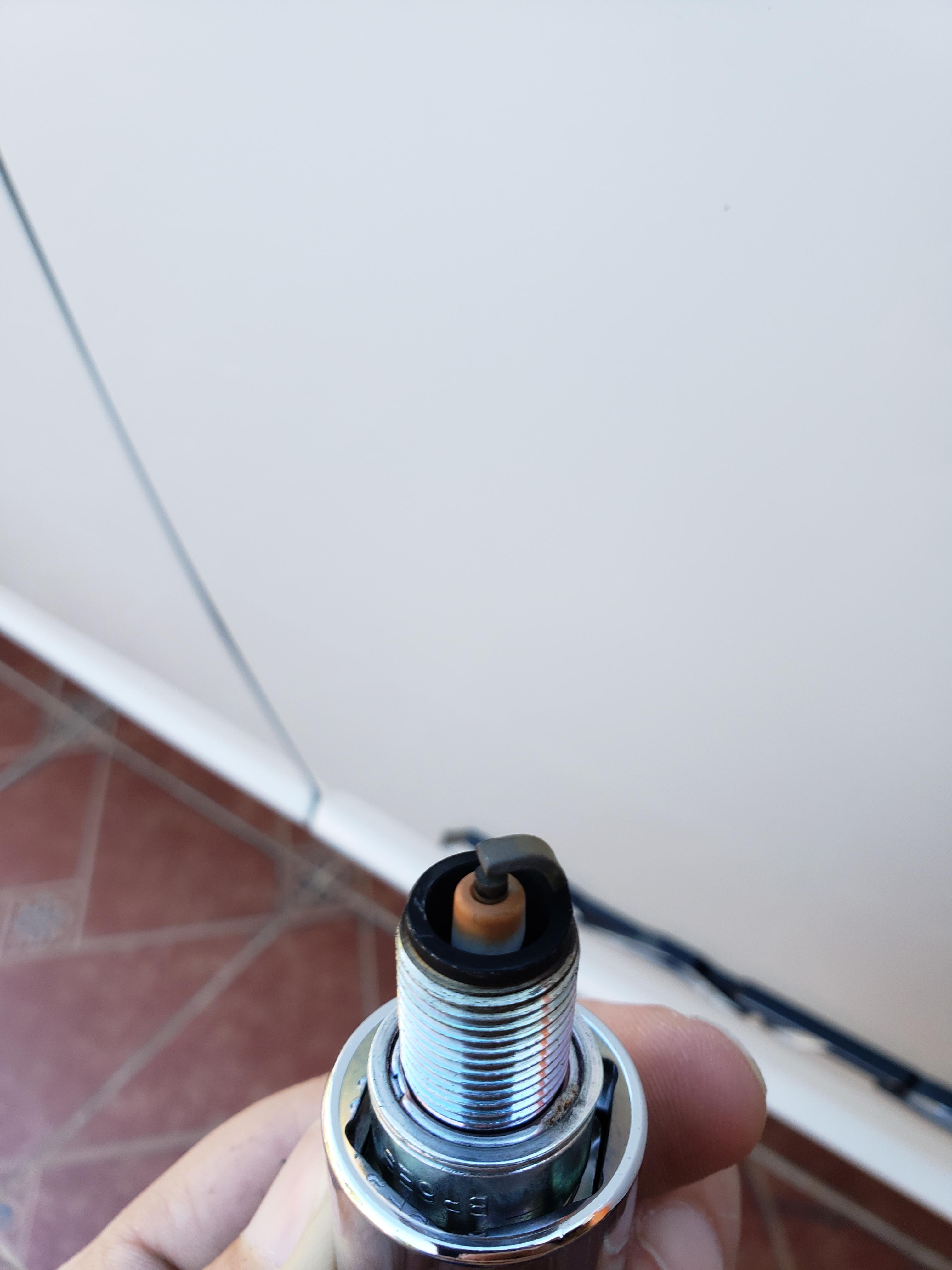

October 5, 20186 yr comment_558924 Ps your number 6 looks like it's not firing at all when compared with the others - just get some new leads - they are dirt cheap! Â Â https://www.rockauto.com/en/catalog/nissan,1977,280z,2.8l+l6,1209248,ignition,spark+plug+wire+set,7224 Â Â Link to comment https://www.classiczcars.com/forums/topic/60072-misfiring-while-cruising/?&page=17#findComment-558924 Share on other sites More sharing options...

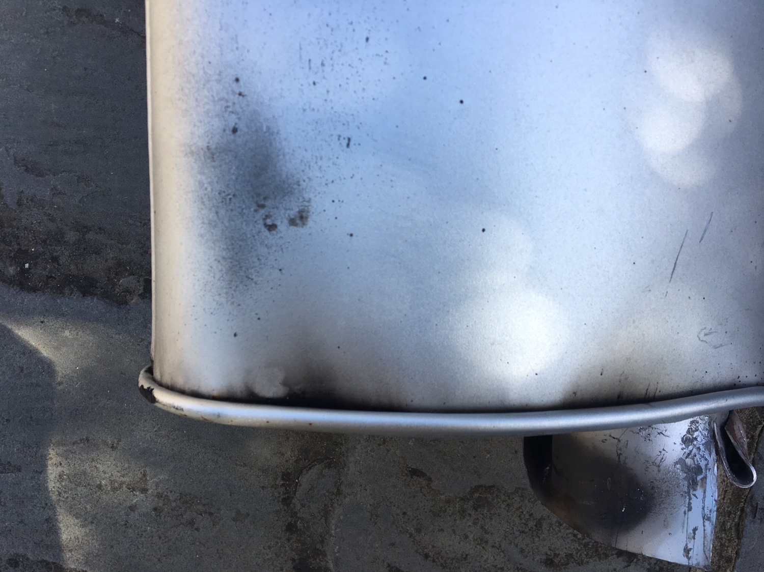

October 6, 20186 yr comment_559012 Of the list on rock auto I guess you can't go wrong with NGK. Â Glad your car isn't backfiring - mine took out the baffles in the silencer and deformed the whole thing - you can see where it started blowing through the joints!!!! [emoji14] Â Â Â Â Â Link to comment https://www.classiczcars.com/forums/topic/60072-misfiring-while-cruising/?&page=17#findComment-559012 Share on other sites More sharing options...

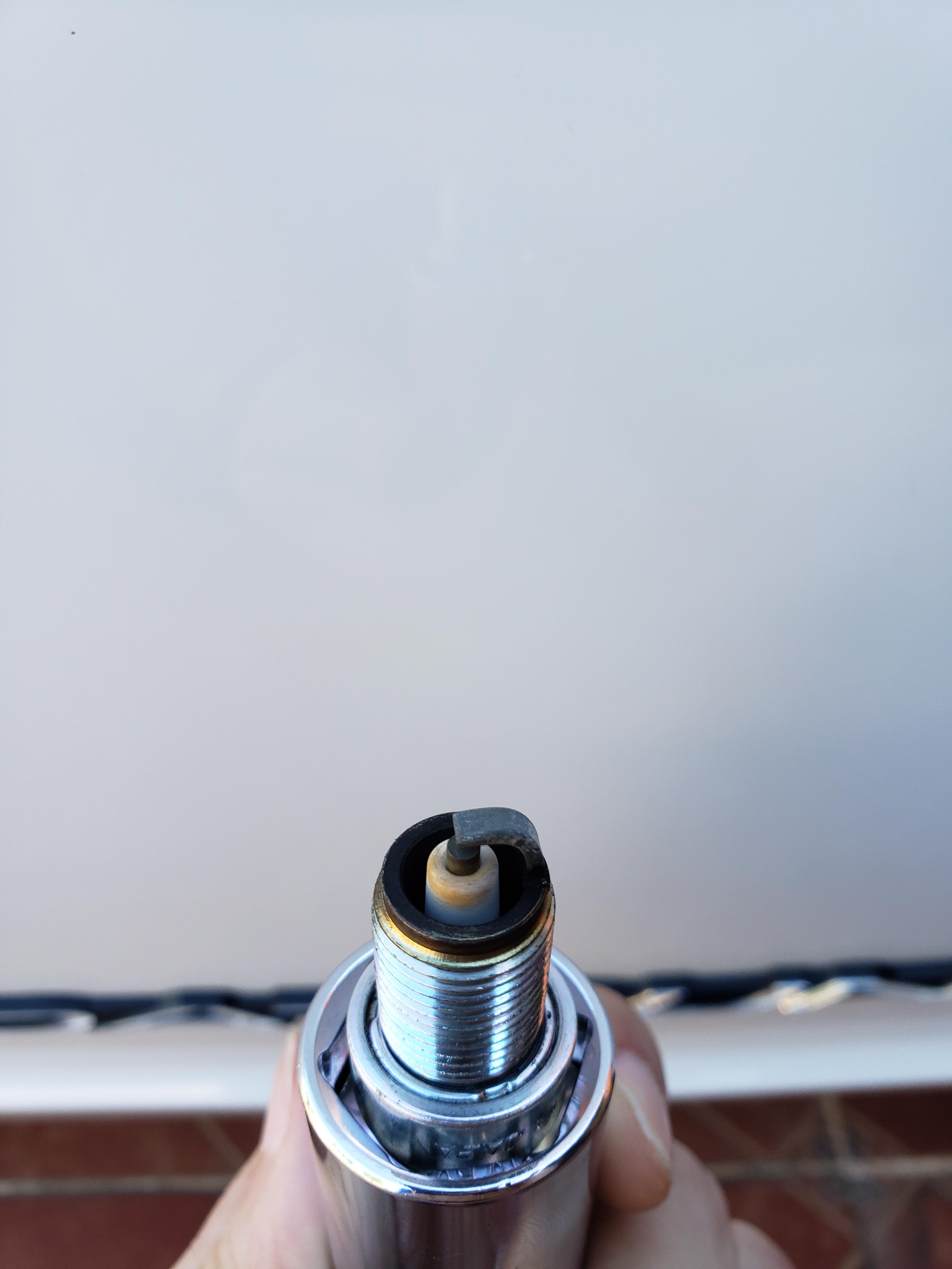

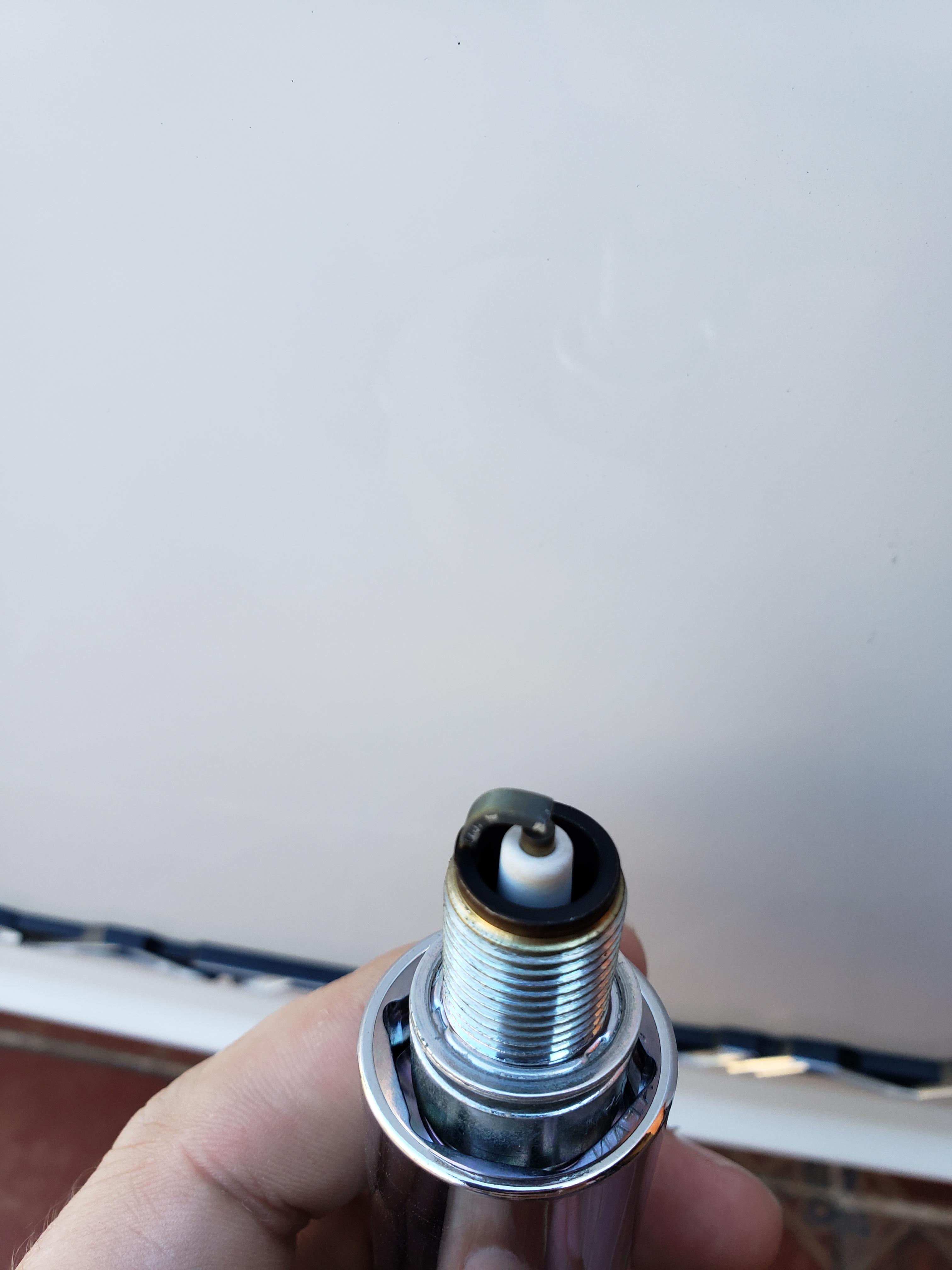

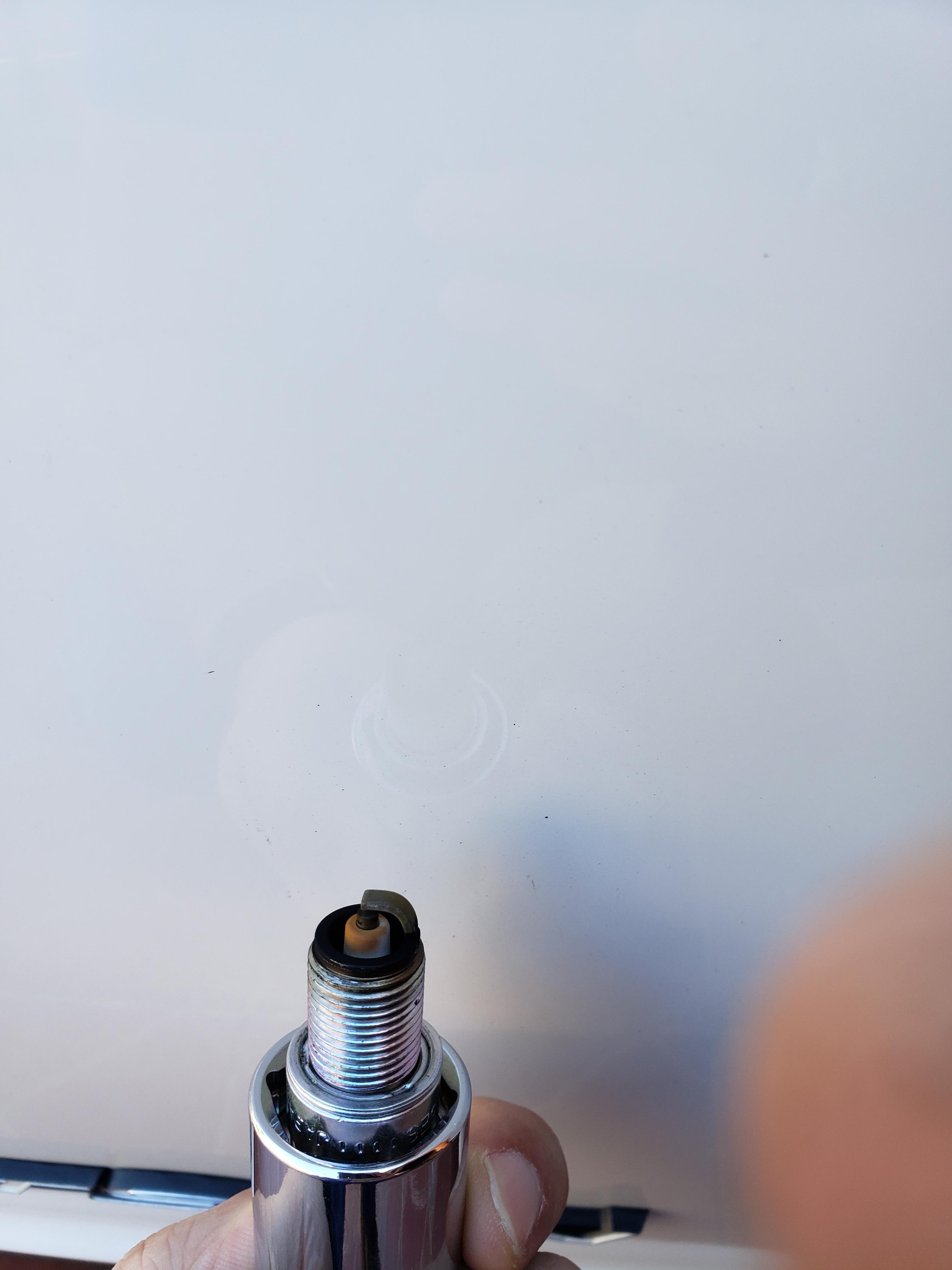

October 8, 20186 yr comment_559103 On 10/4/2018 at 4:09 PM, Mark Maras said: @jalexquijano Normally I would say no because we haven't proven them to be defective but I'm going to say yes, dump them. They're not that expensive and I still suspect the problem is in the wires or connections. Spark plugs 4, 3, 5 and 6Â at 100 mph, 3000 rpm Link to comment https://www.classiczcars.com/forums/topic/60072-misfiring-while-cruising/?&page=17#findComment-559103 Share on other sites More sharing options...
