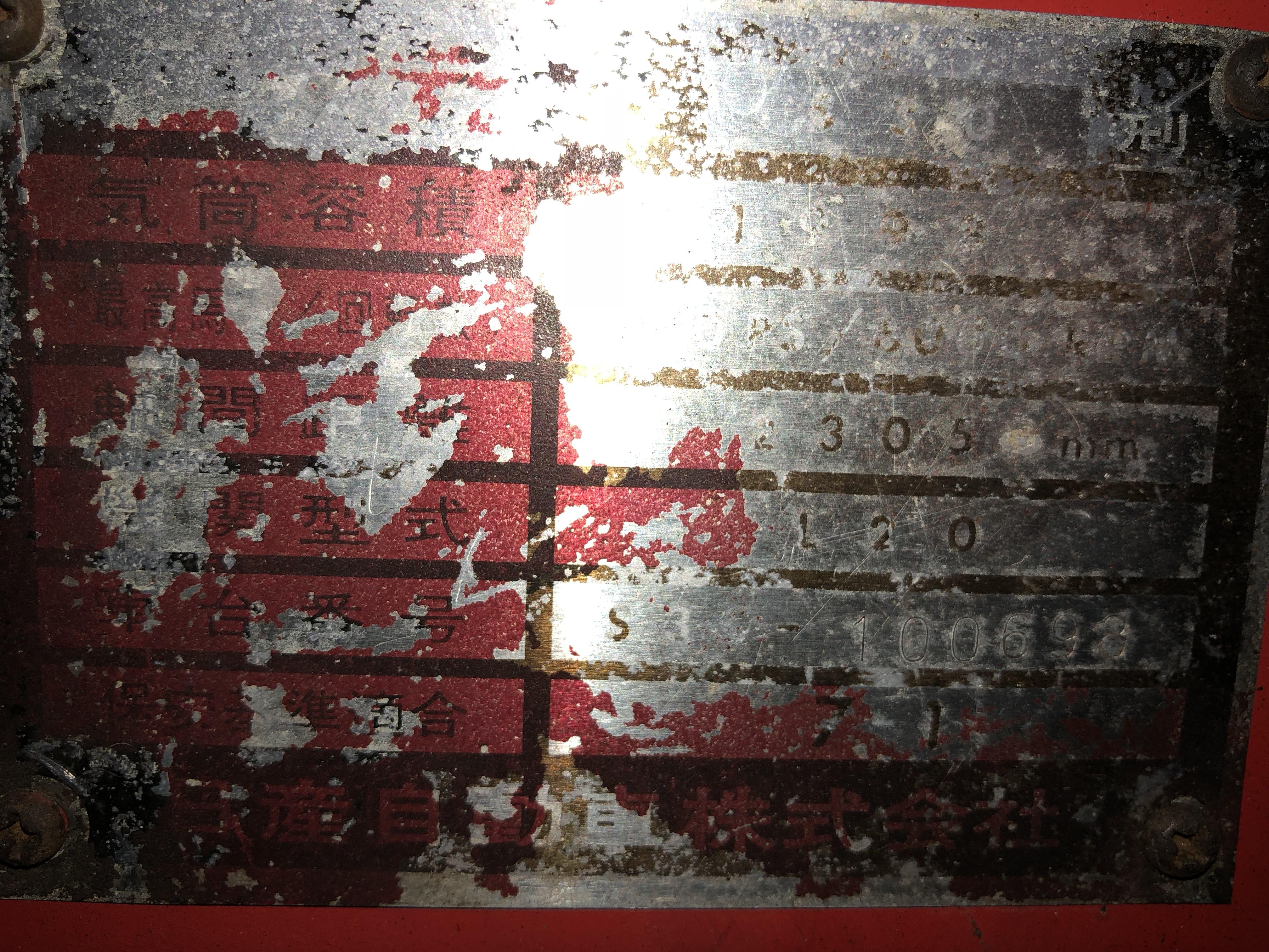

I have just purchased my first Z. - S30-100698.
I think it is a 1973 model however but would welcome some guidance.
JDM version, 5 speed, 2.0l. Believed to have come from Japan by an ex-serviceman.

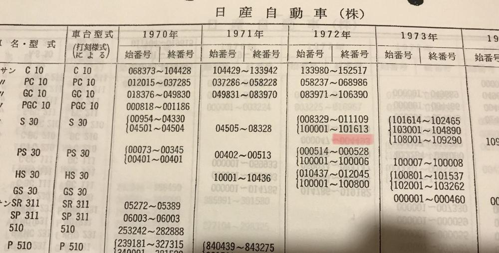

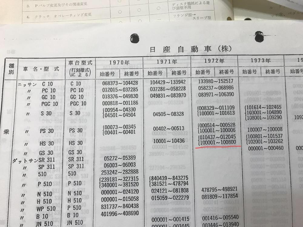

Just to complete and correct the information here.
I did further research and found the car is a 1972 version. The Member Kats San provided the following information.
Apologies for misleading you. I have the same data as supplied to you by Kats, but - I can only guess - must have made a mistake when noting your chassis number.
Glad you have the correct information to hand now.
