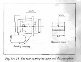

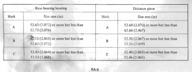

A funky distance piece would do it.  Or a strut casting.  Or a combination of funk in both.  The distance piece is supposed to get the balls centered in the races but it sounds likes yours is a bit short for the casting.
