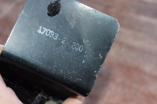

Received the bracket today. Bent, no rust, easily straightened,  but the first thing I did was drop it off at a custom rubber stamp vendor to have a stamp made to replicate the part number on the bottom of the bracket. Once that is complete I will straighten, sand blast, powder coat, and stamp the part number back on it. It will then be ready for the NOS pump. Will post more once project moves along.
