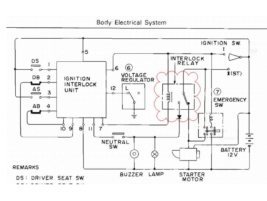

Have you looked at the logic of the switches in the BE section of the FSM?

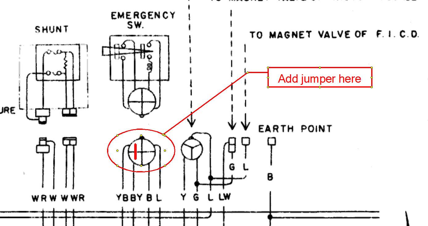

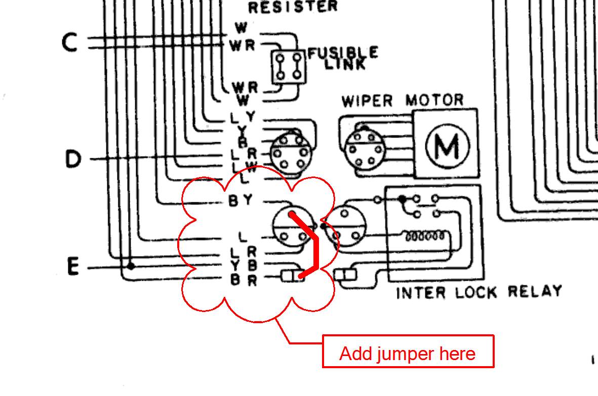

These workarounds focus on getting around the Interlock Relay shown highlighted in red in the first attachment.260Z Interlock system 2.jpg
When the coil on this relay is energized, it keeps power away from the starter solenoid. Two solutions that I am sure that would work would require adding a jumper either at the Interlock Relay or at the Emergency Switch. The jumper would go between the Black/Yellow and Yellow/Black wires.
There is one other solution that may work. If you disconnect the coil negative from ground on the Interlock Relay, that should defeat the seat belt interlock. From my reading of the wiring diagram it looks to be the Black/Red wire on the interlock unit. You want to disconnect this wire on the Interlock Unit side of the connector to prevent the chance of accidentally grounding the wire on the wire harness side.

Any of the three solutions I provided should keep the Interlock Relay from interfering with starting. Good luck. Let us know what you do and how it worked.
i see your point about jumping at the relay or the emergency switch. either method gives the current a direct path and both are a quick, easy, and immediate fix.
do we have a personal preference?
Well, if you can find another emergency switch, you can cut the connector off if it and jumper the wires together like I described. That is probably about the easiest way.

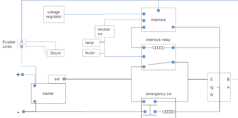

but for future reference, a clearer view of how the interlock and relay fit in
