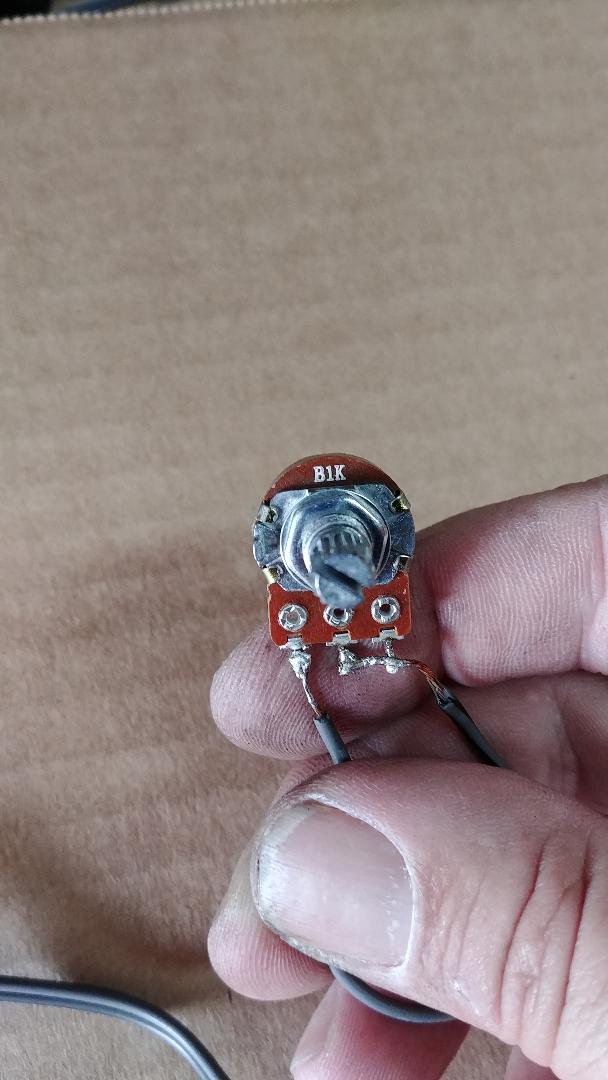

So just for SAG's I decided to install the "pot" everyone's talking about. I ordered one thru zcardepot for 4 bucks. Wired it up. Simple, took maybe 20 minutes. Half of that was setting up soldering iron, etc. Installed it in the CTS harness, again, simple. Started it up and almost immediately it started to stumble. I figured I had set it wrong and turned the knob on the pot the opposite way.
Did you measure resistance across the terminals?  Should have been about zero at one end of the rotation.
And did you solder two terminals together as one leg of the circuit?  I don't think that you need to do that.  Just measure resistance across two terminals that show zero and a higher number,with knob rotation, and use those two for the circuit.  We're not really using it as a potentiometer, it's really a rheostat.
http://www.resistorguide.com/rheostat/

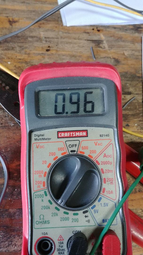

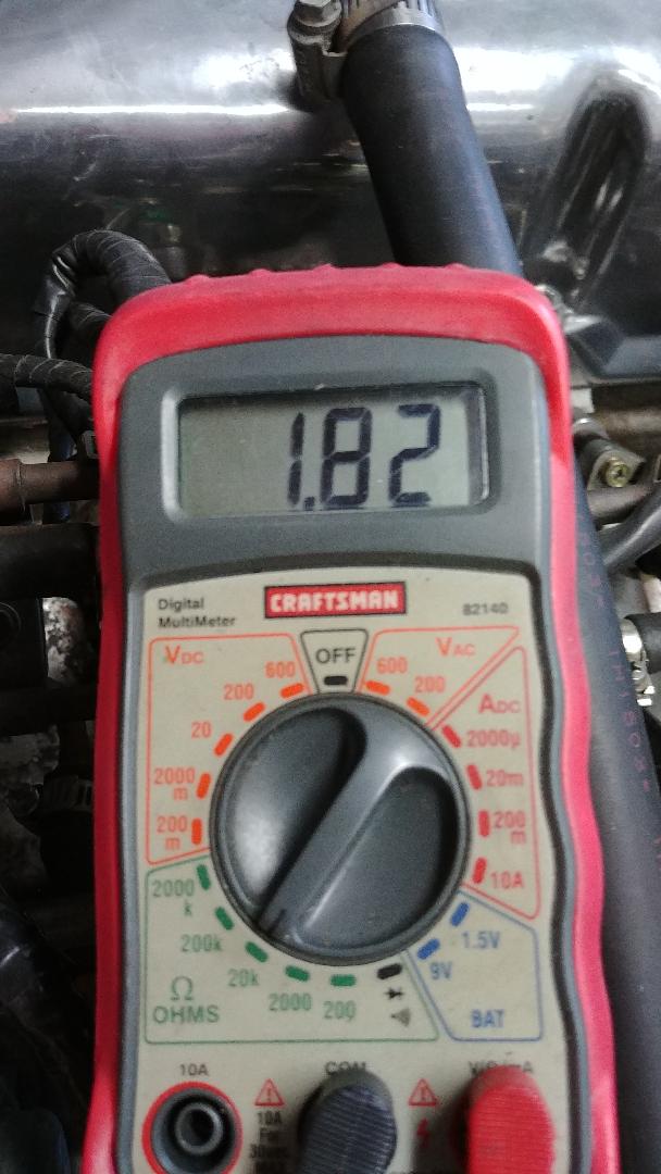

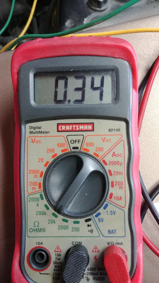

So, I connected the "pot / rheostat" again and this time I got different results. So my hunch, at 2 a.m., was correct. Guess "maybe" the connector without the "pot" was not connected. It's the only reason I can come up with as to why things happened the way they did. Took some measurements today, they are as follows.
Pot in closed position
fully open position
CTS cold reading
CTS ECU harness
CTS warm reading
And I also measured 1.82 across the CTS ECU harness after warm.
