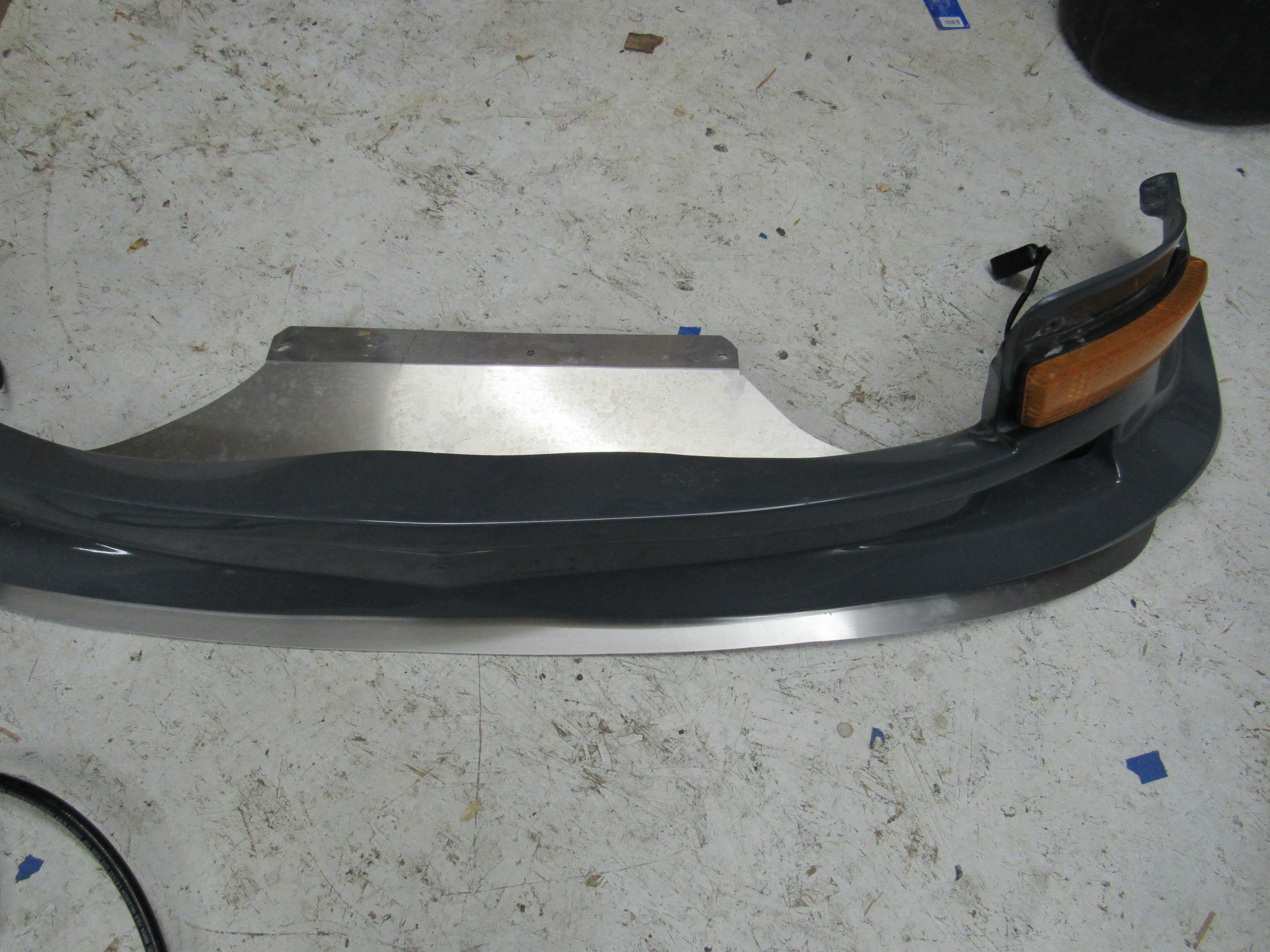

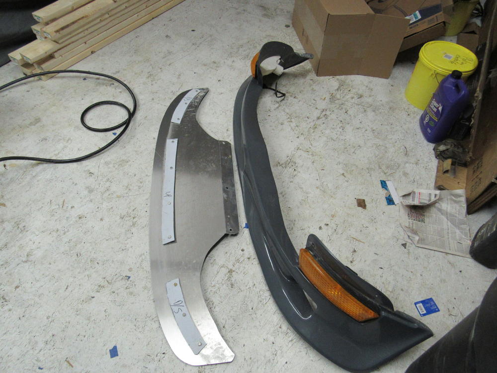

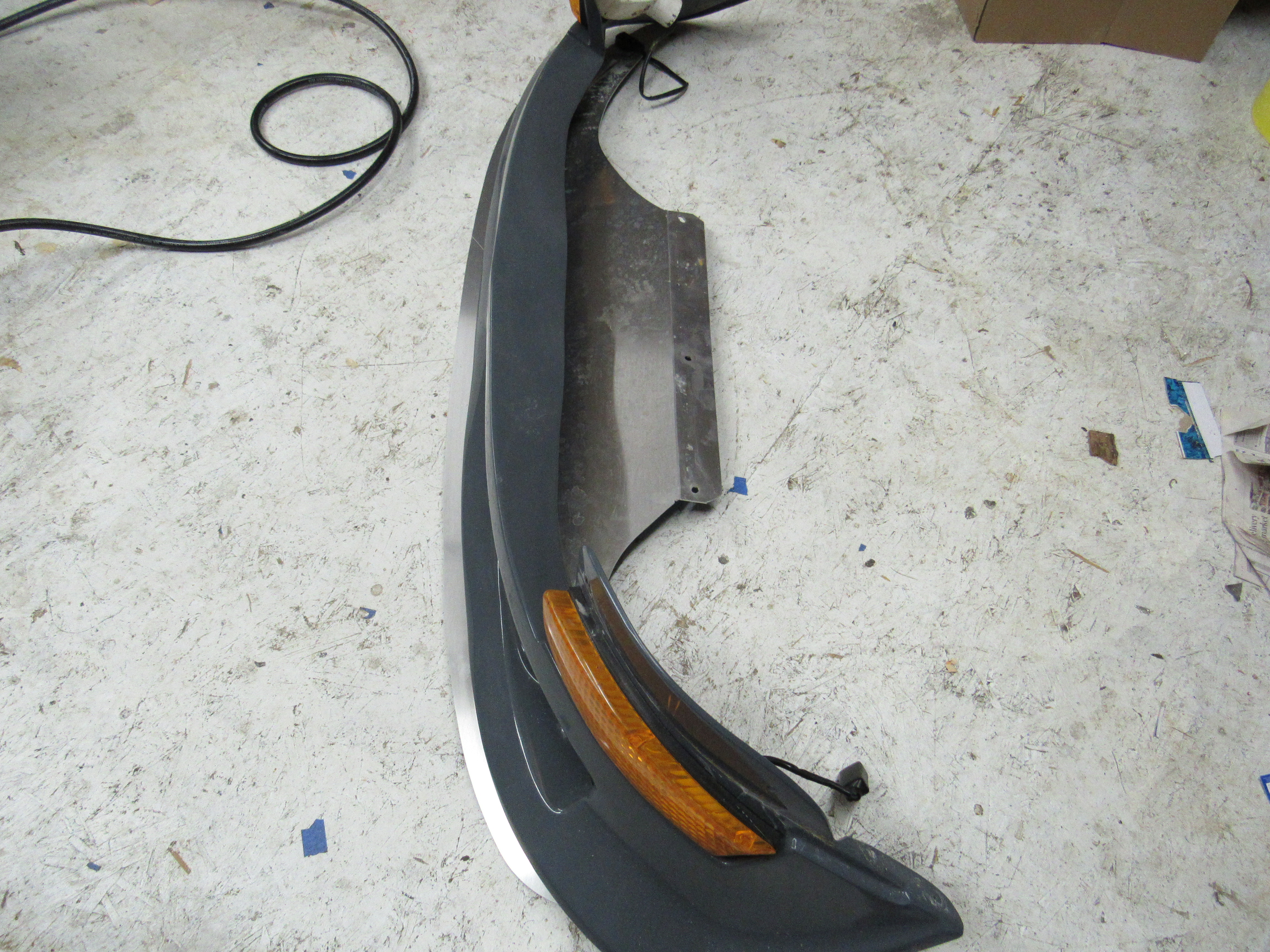

I rigged up this splitter  brace to keep the air dam stiff, those rectangular pieces grab onto the inside lip of the air dam.  It works pretty well but I didn't get a piece of aluminum wide enough to cover the full width so I will probably build another one. Hope this helps.

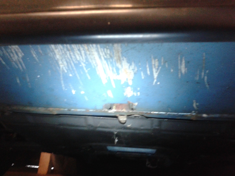

I put the bottom metal lip behind mine.  '77 280
Spoiler on top, spoiler lip (scratched up), belly pan.  Picture taken from the ground up.  Stopped my high speed flexing, vibrating.
