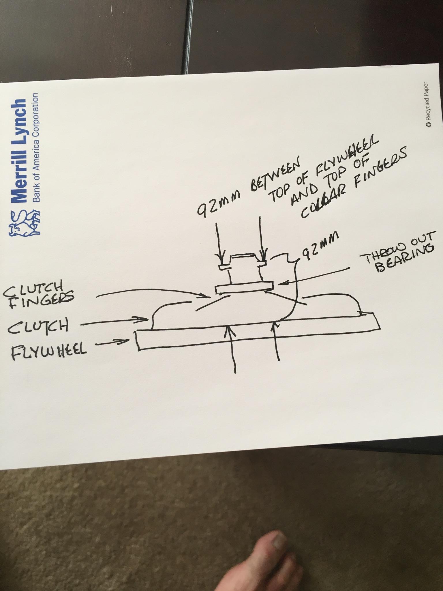

June 19, 20187 yr comment_551306 On 12/22/2017 at 11:15 AM, niushork said: I'm putting a new clutch and will make sure that the clutch collar is the correct one. Found this pic online, what do you think? niushork.....I just started following your thread.....this measurement is critical......92 mm (3 5/8 inches) and you are good to go. Edited June 19, 20187 yr by Diseazd Link to comment https://www.classiczcars.com/forums/topic/59215-372-datsun-240-z/?&page=3#findComment-551306 Share on other sites More sharing options...

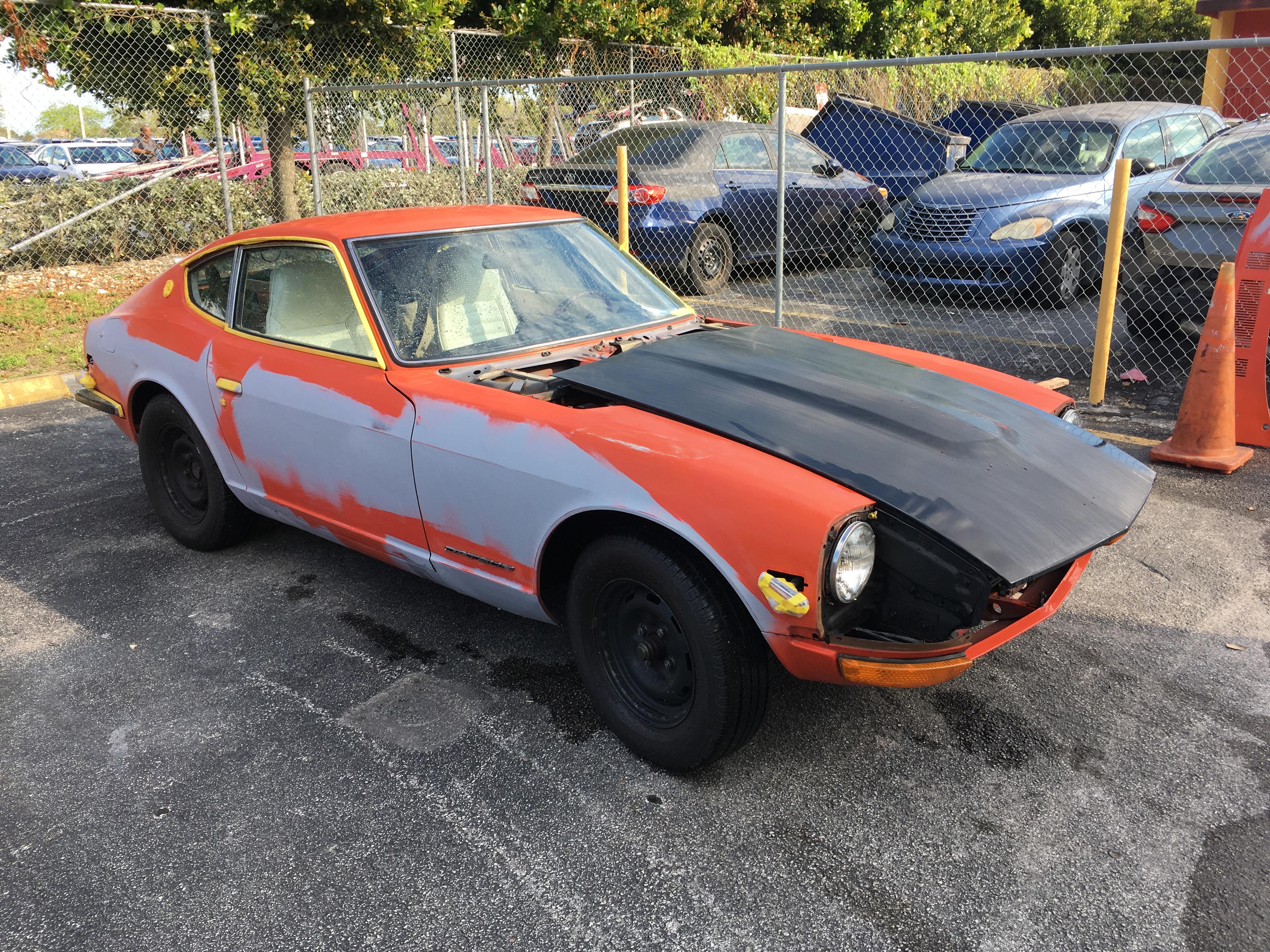

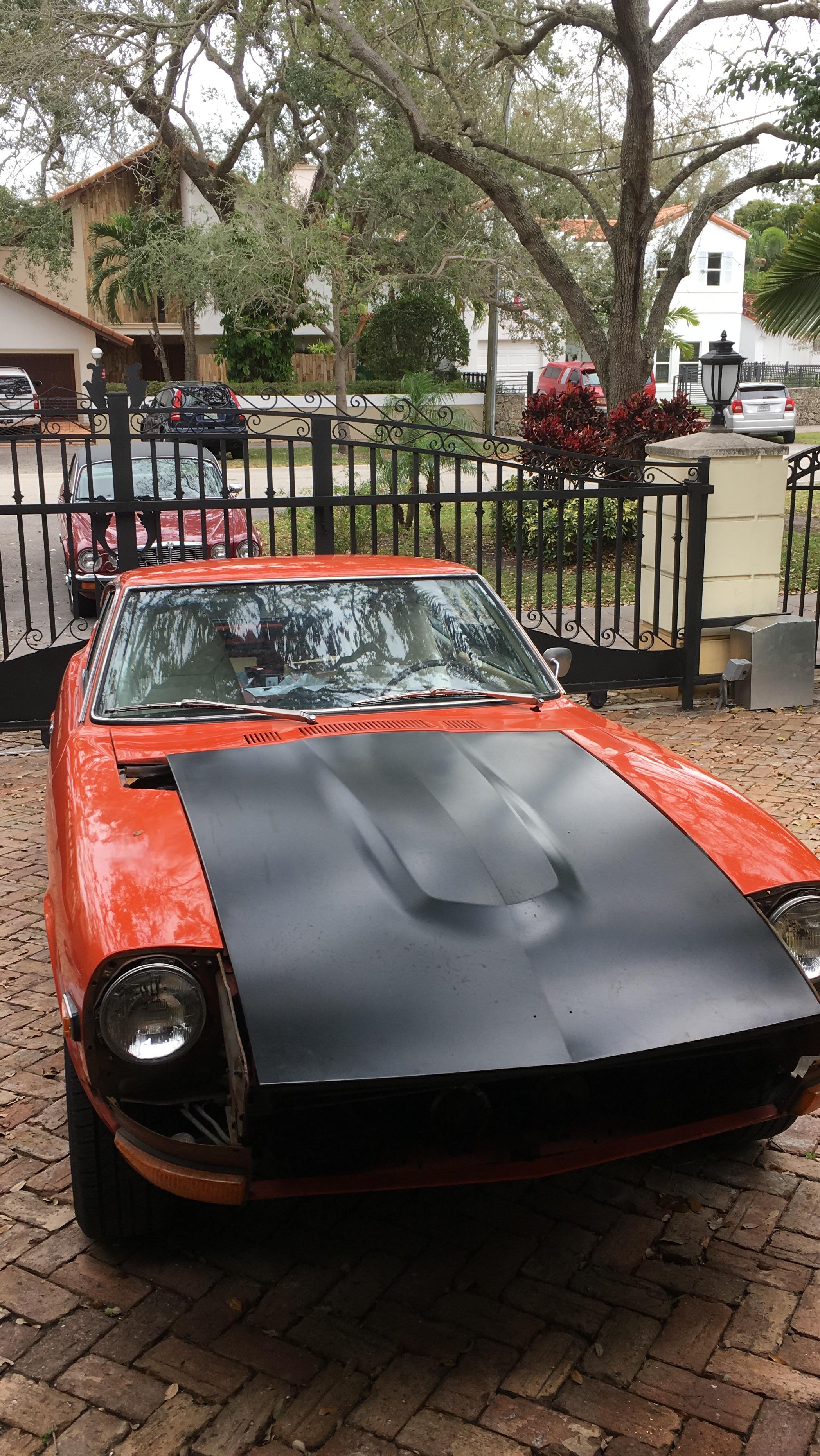

June 24, 20187 yr Author comment_551638 Thanks to all that have shown interest and also in many ways helped with this project which started really bad when I bought a car that looked one way and was clearly something else as I have explained before. Here some pics of the work done over the last 6 months and the final pictures 2 weeks ago. Hope you enjoy it Link to comment https://www.classiczcars.com/forums/topic/59215-372-datsun-240-z/?&page=3#findComment-551638 Share on other sites More sharing options...

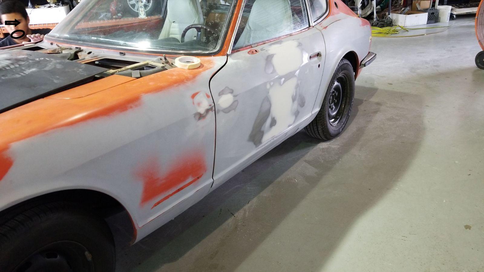

June 24, 20187 yr Author comment_551639 Pre-paint work Link to comment https://www.classiczcars.com/forums/topic/59215-372-datsun-240-z/?&page=3#findComment-551639 Share on other sites More sharing options...

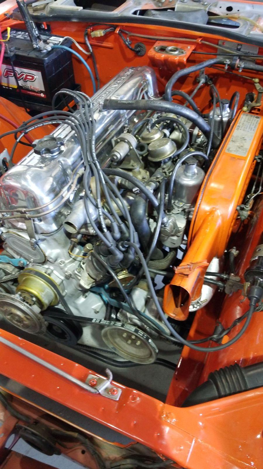

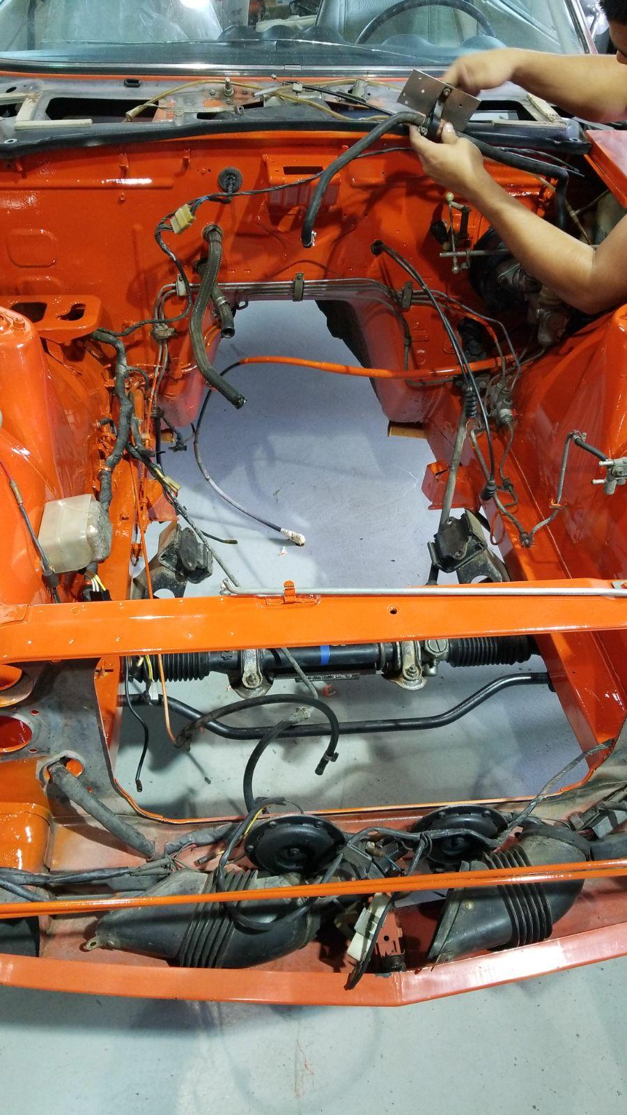

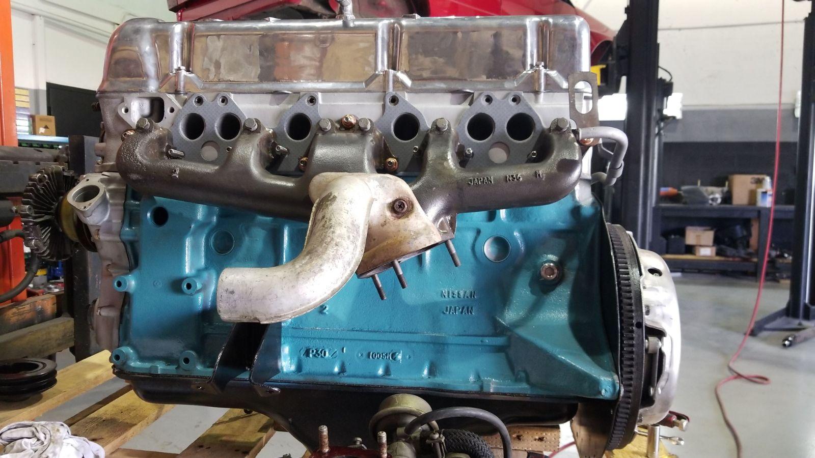

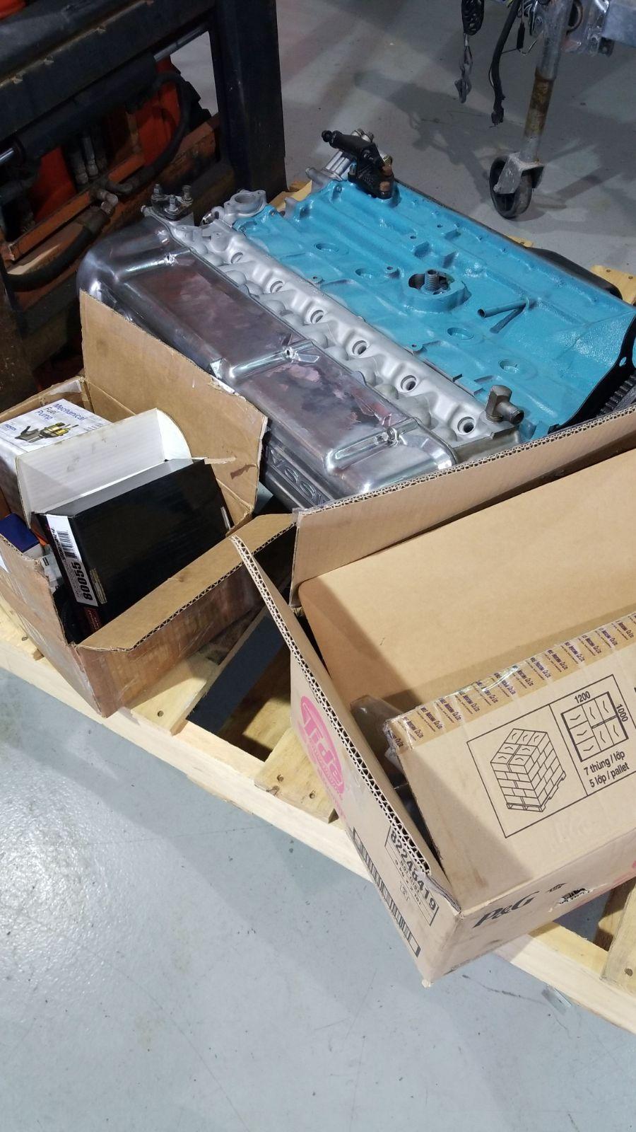

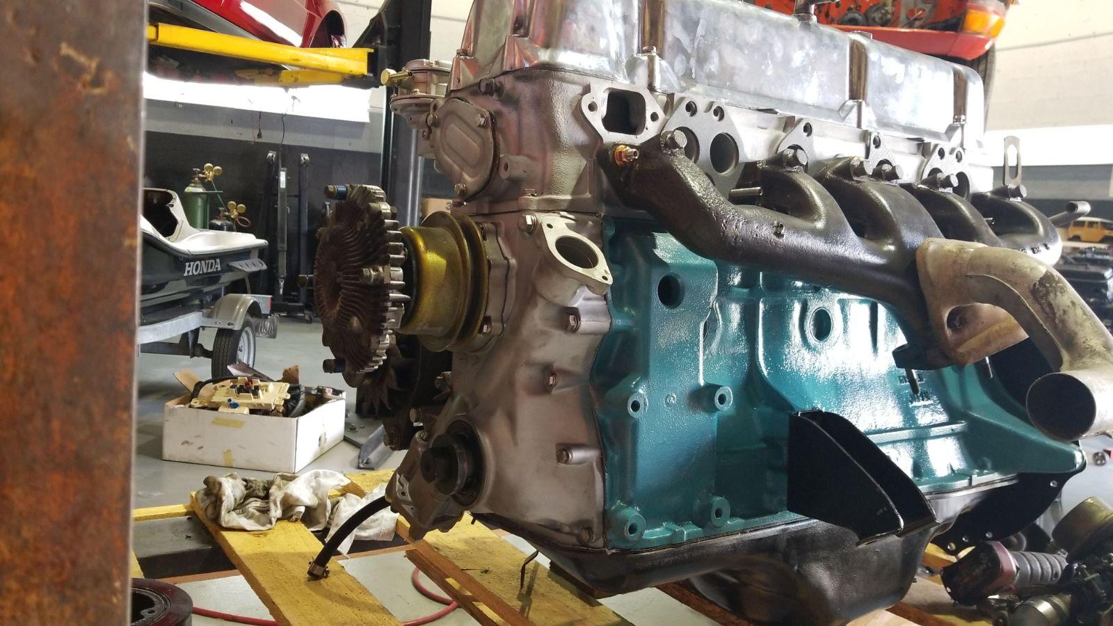

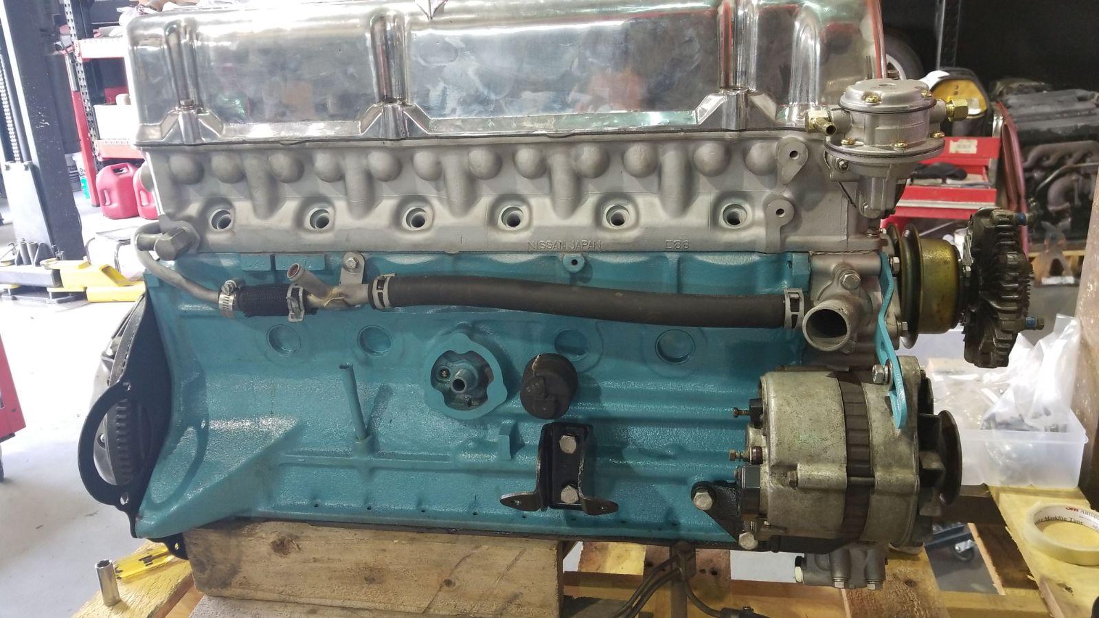

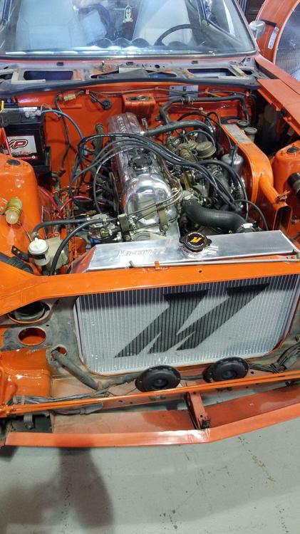

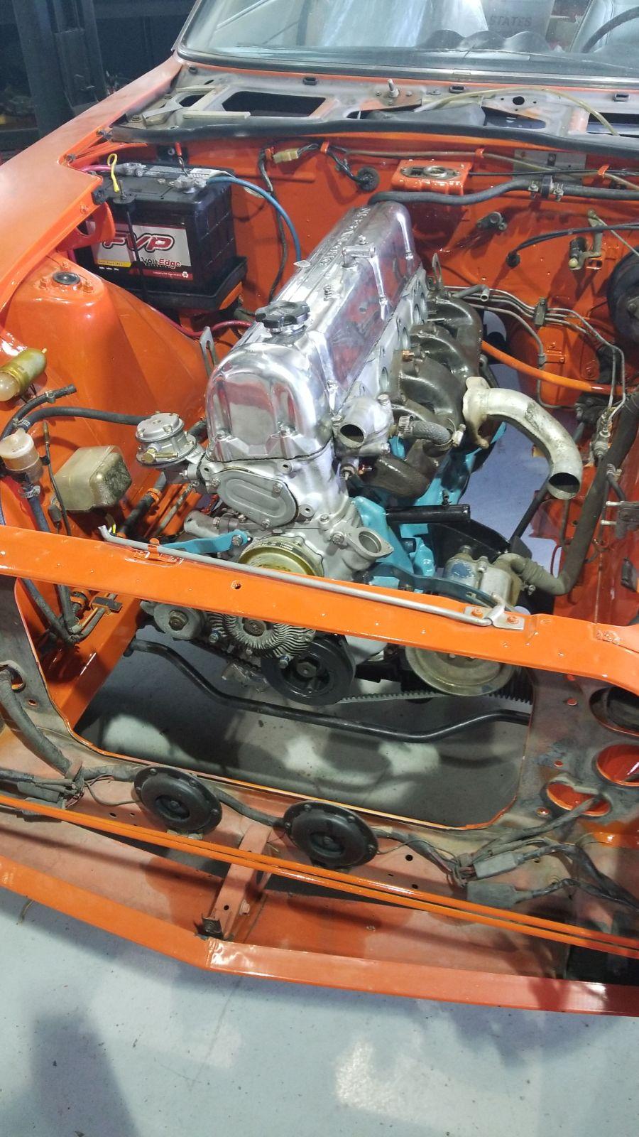

June 24, 20187 yr Author comment_551640 Engine work Due to the issue with the engine that the car came with (a 280) we did an engine swap with a proper 240z engine with all correct parts. The 240 engine was machined, new pistons and the whole lot. The only departure was the installation of an all alum Mishimoto radiator that fits right in. Link to comment https://www.classiczcars.com/forums/topic/59215-372-datsun-240-z/?&page=3#findComment-551640 Share on other sites More sharing options...

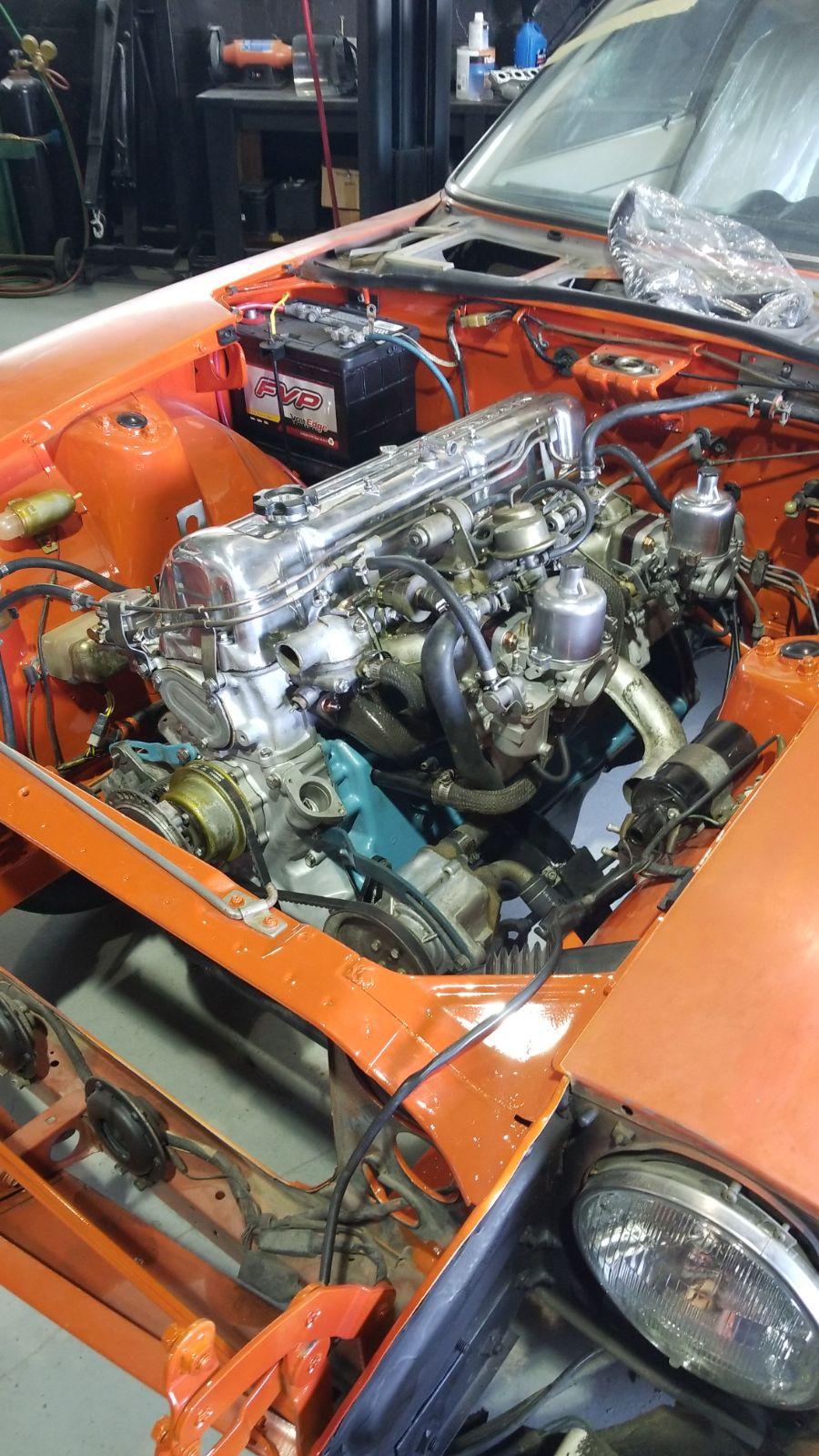

June 24, 20187 yr Author comment_551641 Here the final stages Link to comment https://www.classiczcars.com/forums/topic/59215-372-datsun-240-z/?&page=3#findComment-551641 Share on other sites More sharing options...
